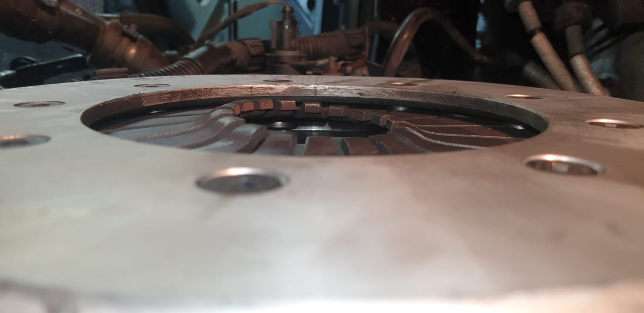

So put the old clutch back in today, bled straight up and all is working as it should again. This is how the pressure plate looked whilst still in situ on the car...
Not good at all, you can't tell once it's off the car but hopefully when they test it back at the manufacturer they will see the issue straight away.

must be so frustrating for you mate , can clearly see something is very wrong with that
Yeah it's annoying mate, not driven the car since last Wednesday and when I drove it last I drove 15 miles with no clutch at all haha. Yeah definitely doesn't look right at all so hopefully just got a bad unit. The lads at aks seem decent enough
