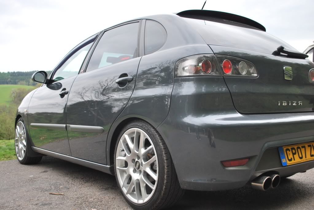

Off a mk3 golf?
If so they are exactly same as mine so et43 5x100 2 piece splits
they look sweet man really tidy( good site innit :p)
yer they just pop out really easy but Bbs centre caps are like 25-30 :)

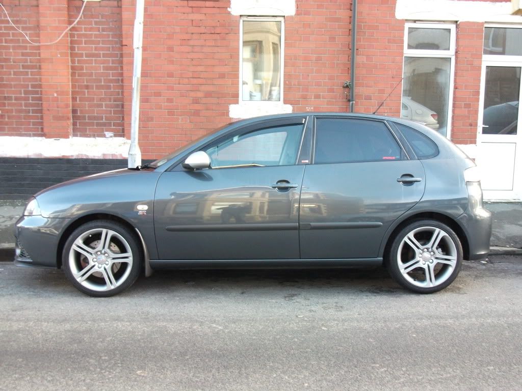

what about some polished (or anthracite) TT Comps (17x7.5)
pic of gooner_mikes car (hope he doesn't mind)

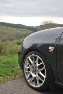

or some BBS RC (Style 5) (17x7.5/8/8.5)
