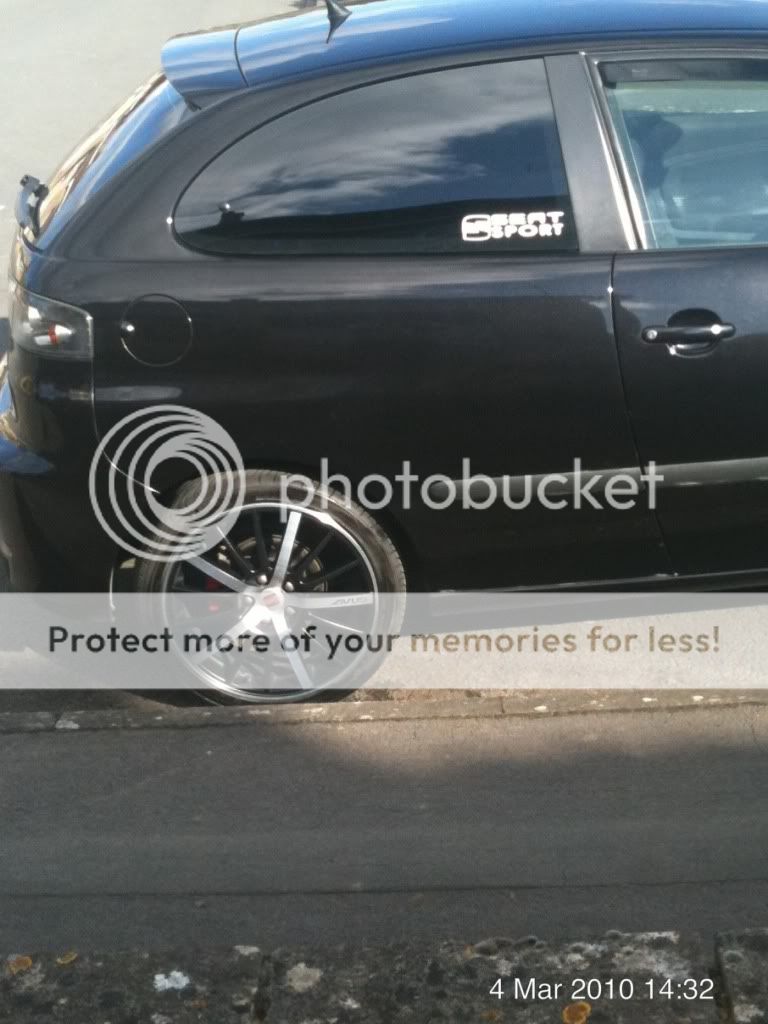

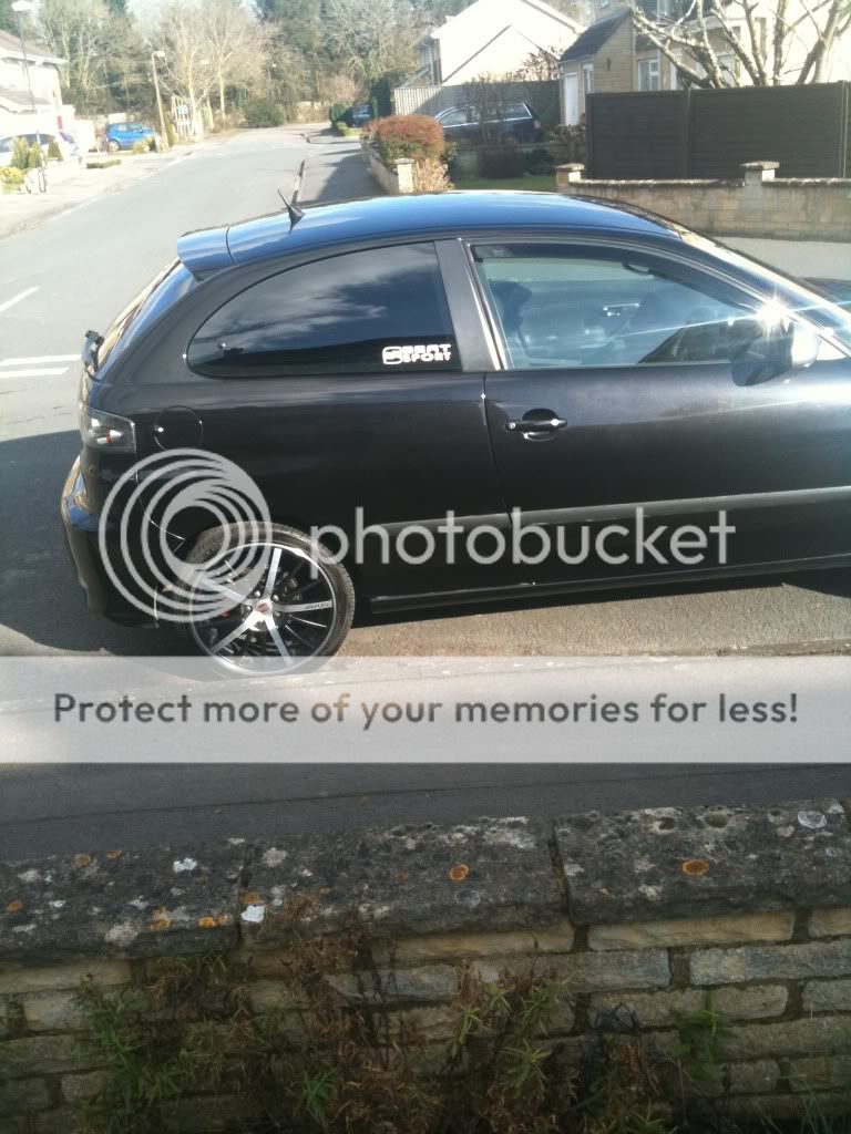

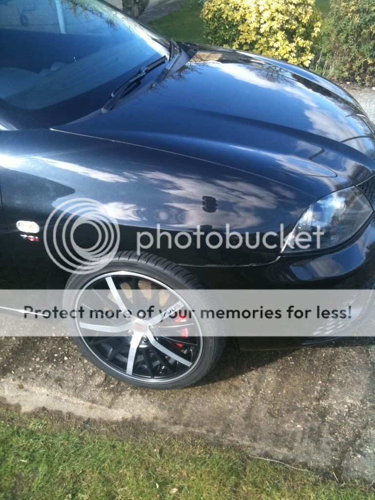

Few pics :)
Gave my car a wash today, here is a few pics.
