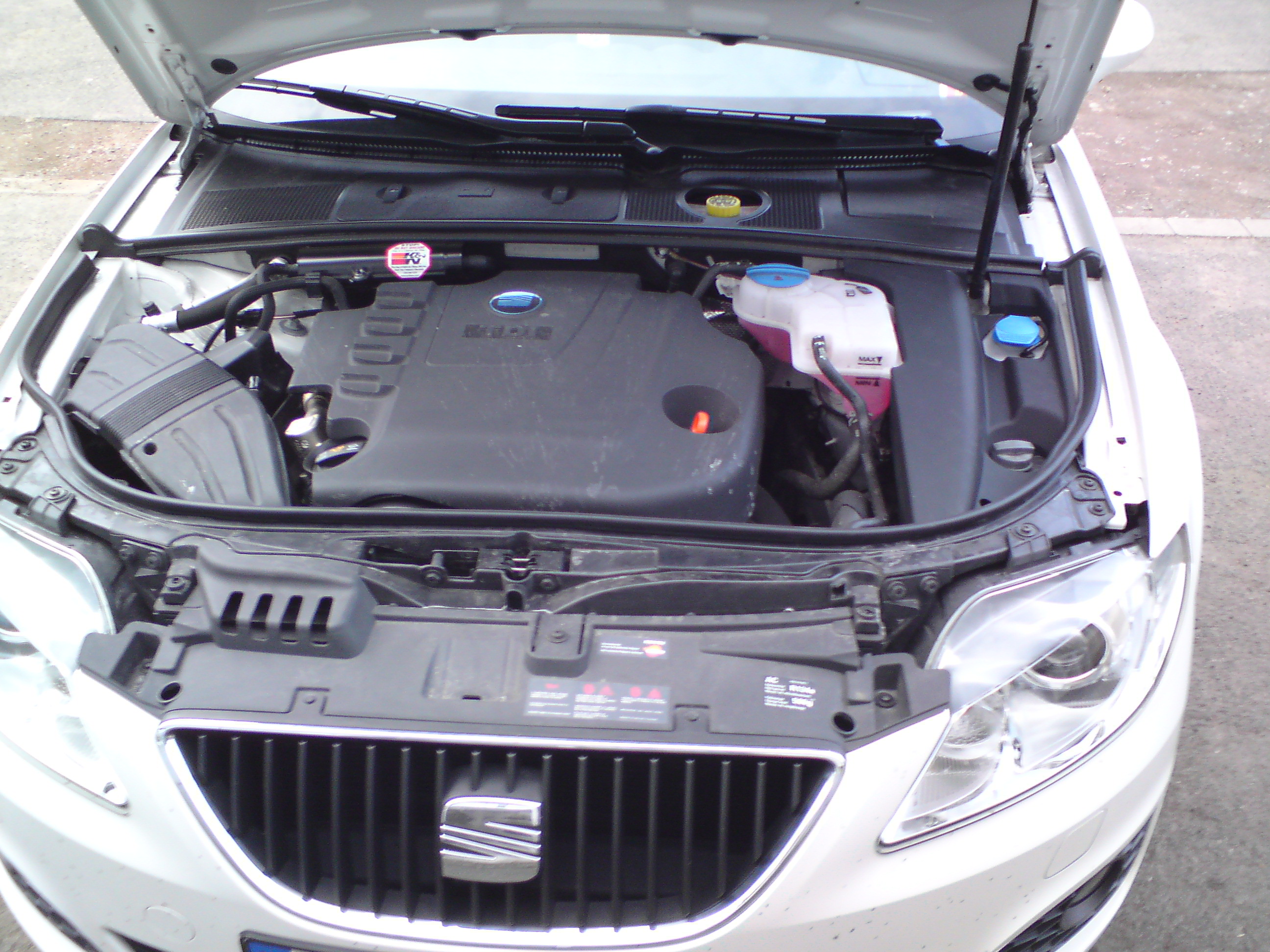

Normally its secured like is illustrated below:
picture.php
Unforntunately my tank looks like this:
attachment.php
I've also installed a rubber gasket (8E0823731B) around the engine compartment to prevent dust/sand entering the engine:
Note: the above images are not from my car but from a German forum (http://www.seatforum.de/forum/showthread.php?t=59377)

It's an Audi part no. and it's easy to install.
The covers for the ECU and battery fits no matter the type of engine.
It only the cover around the washer fluid reservoir the can give some problems with securing it.
