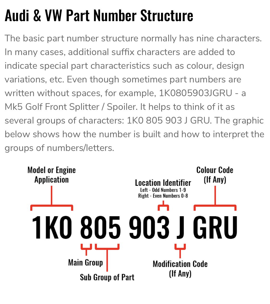

On our previous VAG cars that had these COPs, the manufacturer, their part number and date code and the VW Group part number were all printed on the upper surface, same with my wife's current 2015 Polo, but with my 2011 S4 with its red COPs, I've yet to find any part numbers or anything else.
One thing that I do like about owning and fixing VAG cars is the availability of online parts listings that you can trust, and VAG parts numbering system is logical - probably due to the intervention of the British Arm after WW2!
black_sheep
Mar 10, 2013
1,252
587
Alas, the parts numbering system pre-dates Maj Ivan Hirst - albeit, the REME are always hosted very well in Wolfsburg.
