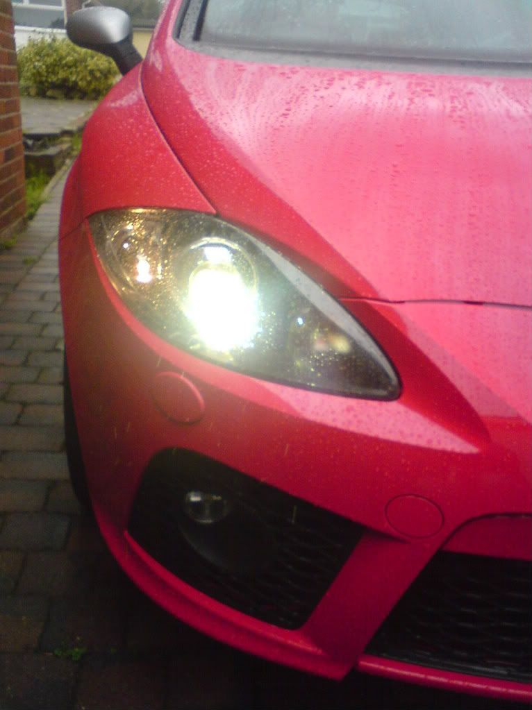

I'll post picks asap. They are 100% xenons :) they seem to work ok although perhaps slightly low, just no self test and no movement when turning. Do you think it could just be a VAG COM fix?
Do you have the headlight height adjust switch next to the main headlight switch? :p
Here we go guys a quick pic, excuse quality and size. Guess what when i was taking them they moved:p very odd hopefully they are ok.
