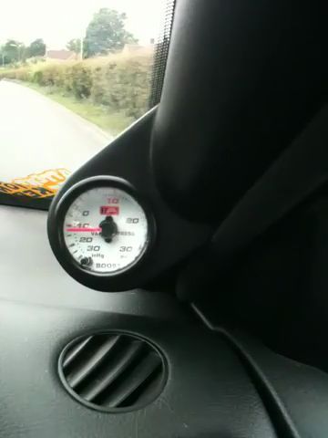

This is my problem.!!!!
42b6a6e3.mp4
Mine boosts up to about 5psi. Im sure it must be the n75 thats ****ed. Did you just mask out and paint the silver ring on your gauge satin black?
Yer it just feels like someone has switched the turbo off at 5psi. Im gonna chuck a new n75 on it tomorrow as they are about £40. See what happens
Changed my n75 and it seemed to have cured my problem. Just need to set up my Forge actuator now as its only boosting to about 15psi. Should peak around 22psi
