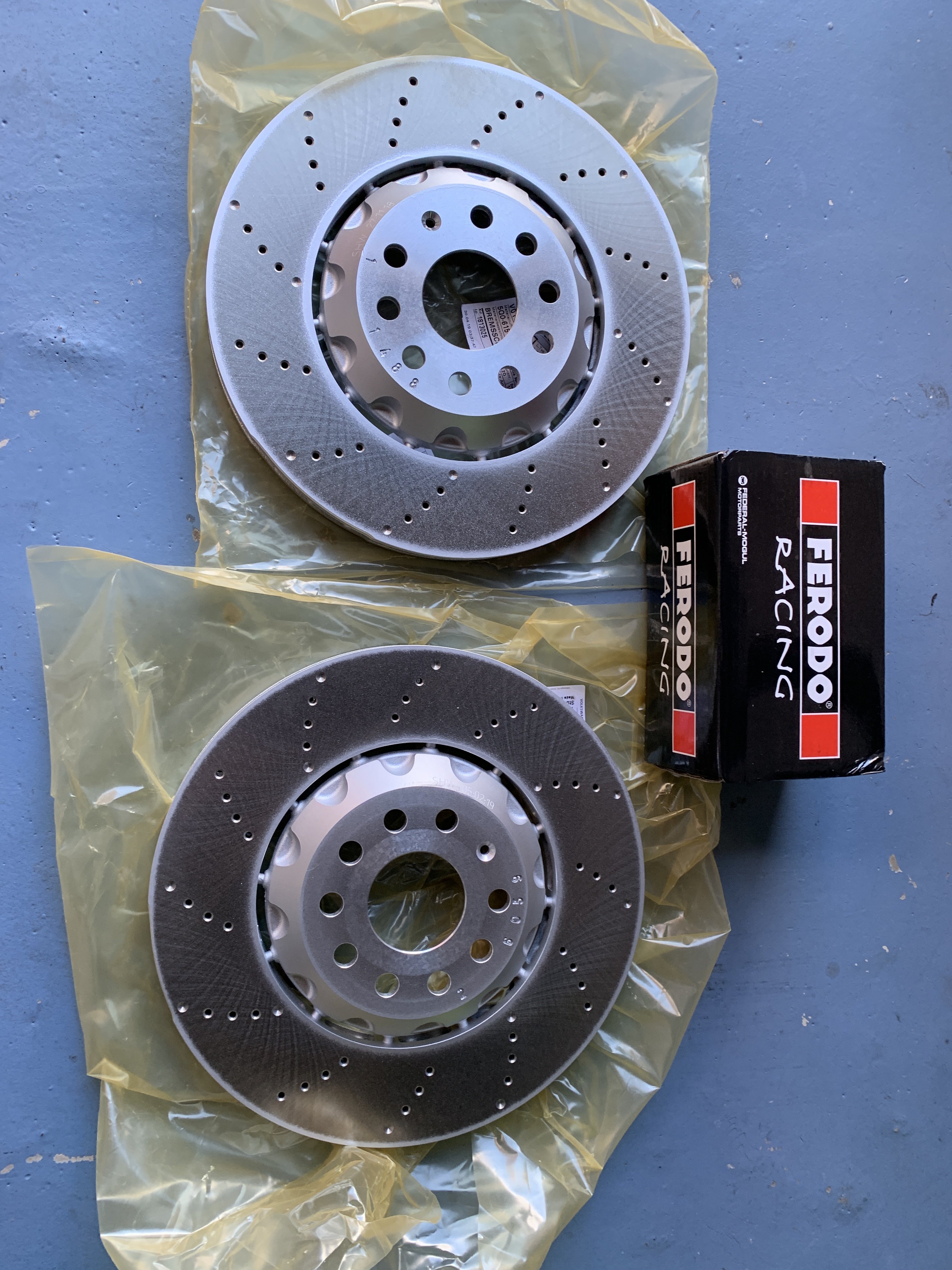

I just fitted clubsport s discs and ds2500 pads tonight
Just went out to bed then in and bloody hell are they better than standard
They were 800g lighter than 10k mile old disc so guess they would be around a kilo lighter like for like with a new OEM disc
They were 800g lighter than 10k mile old disc so guess they would be around a kilo lighter like for like with a new OEM disc View attachment 7961
I was looking at drilled discs but thought they would be better used for track which I'm not planning to do at the moment
