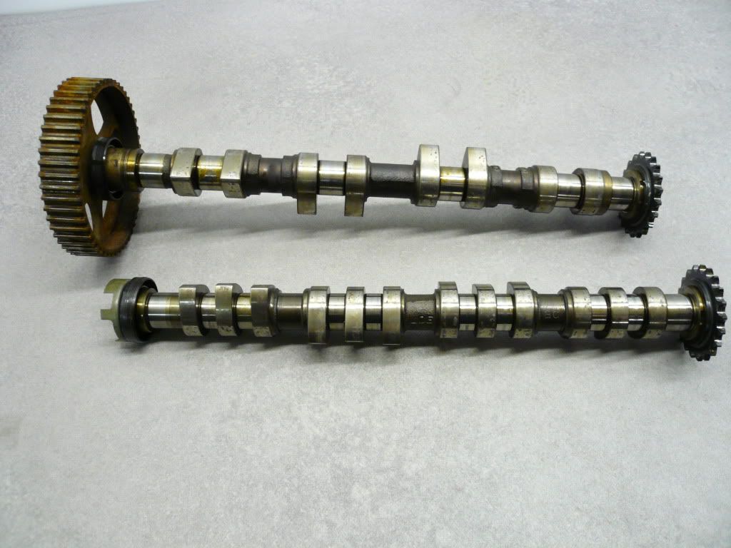

After measuring my ADR cams and realizing they were standard turbo cams I went on the hunt for some N/A AGN cams..
Turbo cams:
Inlet- 7,67mm lift,
Exhaust- BAM 9,3mm lift,
N/A AGN cams:
Inlet- 8,41mm lift,
Exhaust- 10,4mm lift,

I very much doubt you will see much gains if any atall on a k03.. who knows though! There not very expensive so its well worth a try, if not just remove them and sell them on.

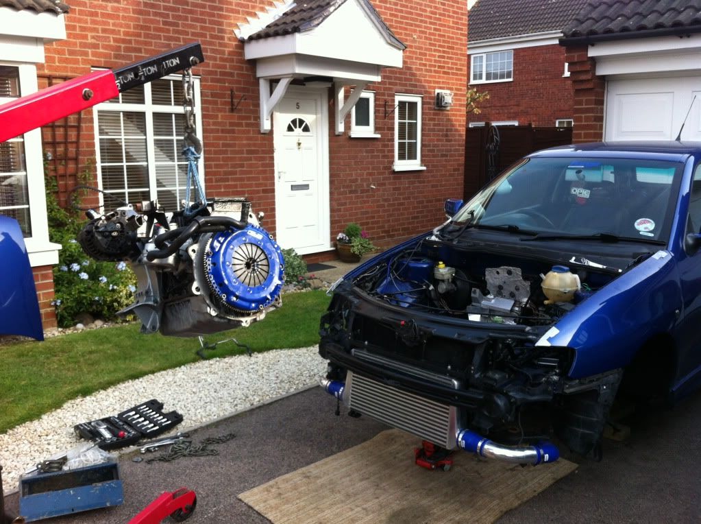

And out she comes again..
engine is fully stripped now just awaiting some boregauges and micrometers to arrive to get checking these tolerances.
