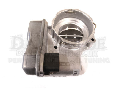

There is an anti shudder valve on most diesel engines, looks similar to a throttle body on a petrol car.

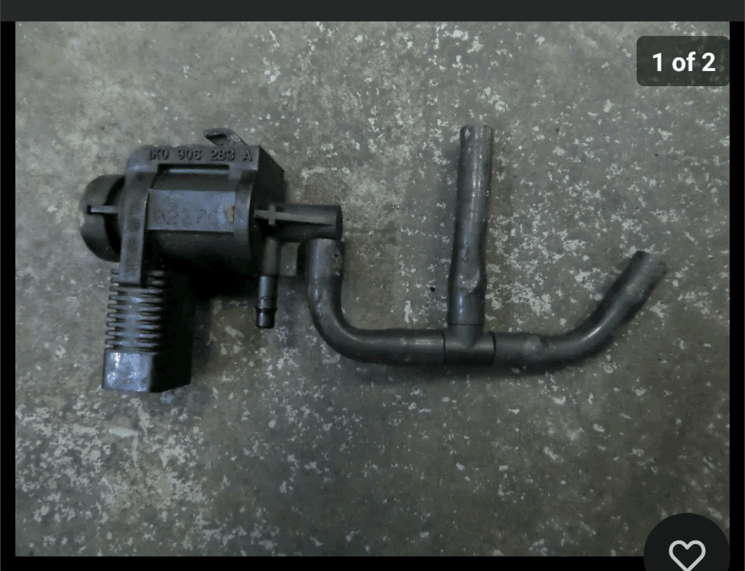

Hi, I think it's to do with the inlet manifold flap solenoid on the left of the ASV. There's no vacuum line(s) coming from it...not sure where they attach to. Any ideas?
Luke this eBay pic. I don't have that hose and not sure where it goes...

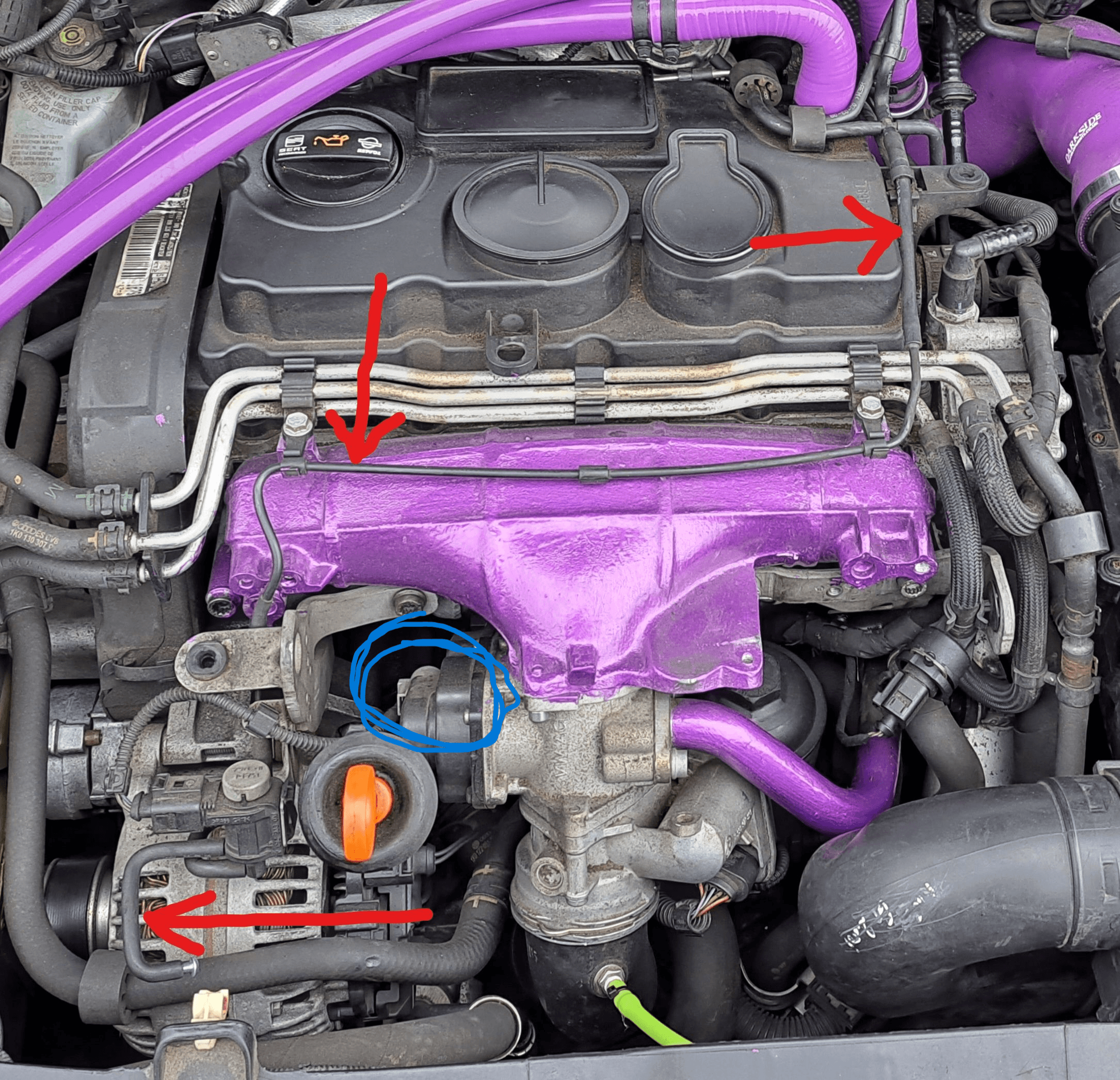

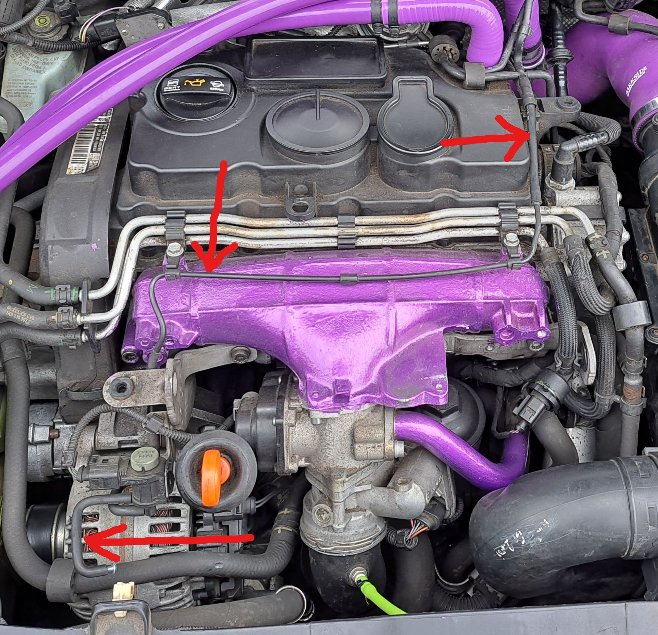

It should be set up as pictured. When the swirl flap actuator is removed you just block off the pipe as done by the bottom arrow. However as yours doesn't have either of the pipes, I'd b tempted to see if yours has been blocked off closer to the top arrow. If it has then I'm not sure that would cause the issue you are having

Those hoses don't relate to the EGR, certainly not the ones indicated by the arrows. Has your hose been blocked off closer to the top arrow? Also, I see a question earlier on in this thread from mty12345 about your ASV plug. Have you got the connector plugged in that is slightly above the dipstick in my picture? It's the grey one going in to the black unit on the ASV (circled in blue)

Ignore that, the plug you should be looking at is the one just above the green hose at the lower of the picture

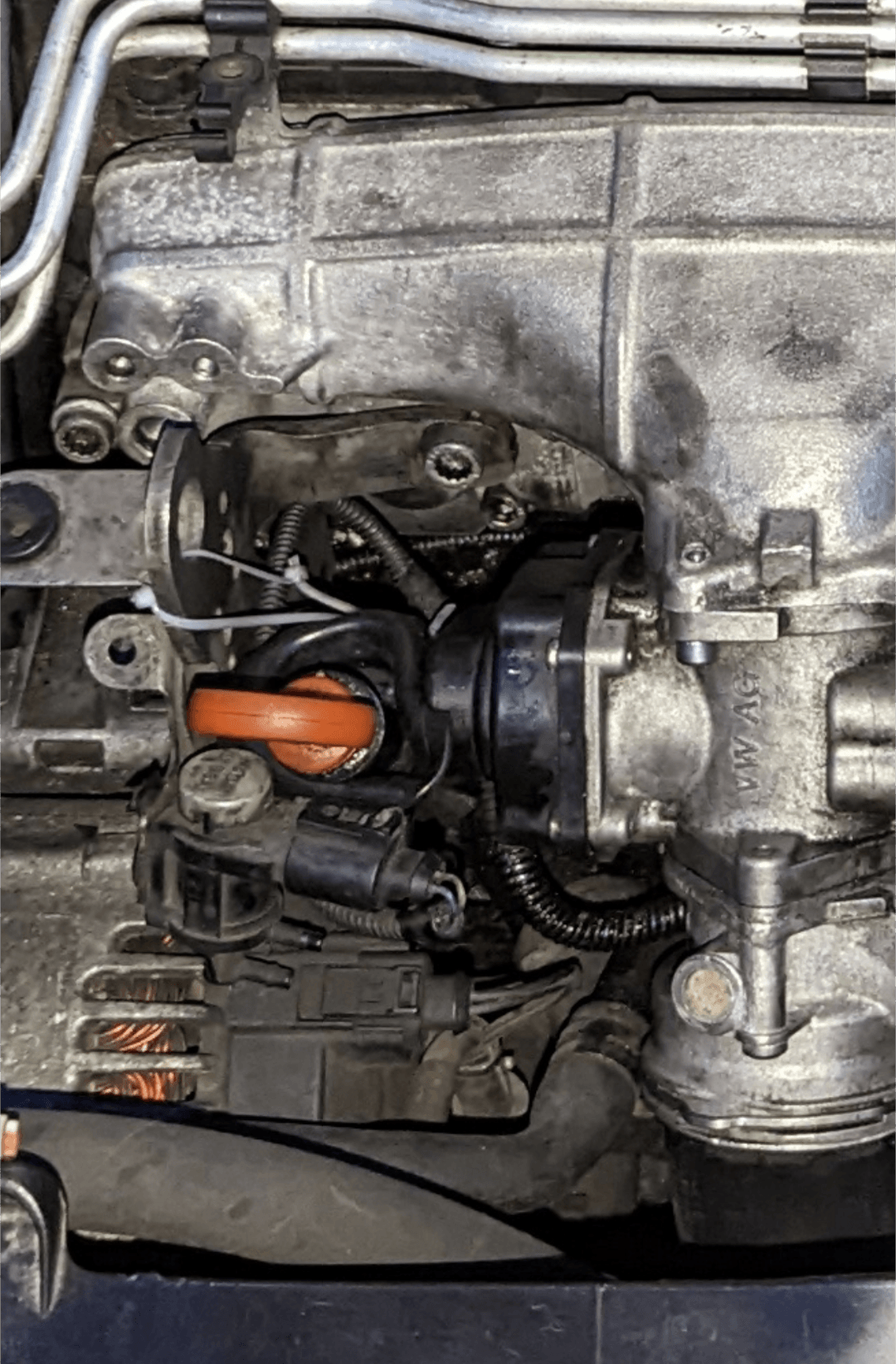

Yeah connector is in. When I take it out then put the plug back there's a relatively loud buzzing noise coming from it, normal?
And yeah it looks like the vacuum hose has been blocked off.

I dont know if its normal. It could either be the valve just powering up or maybe the valve is stuck and the buzzing was the motor not being able to move it. Best bet might be to take the valve off and seeing if it functions by hand
