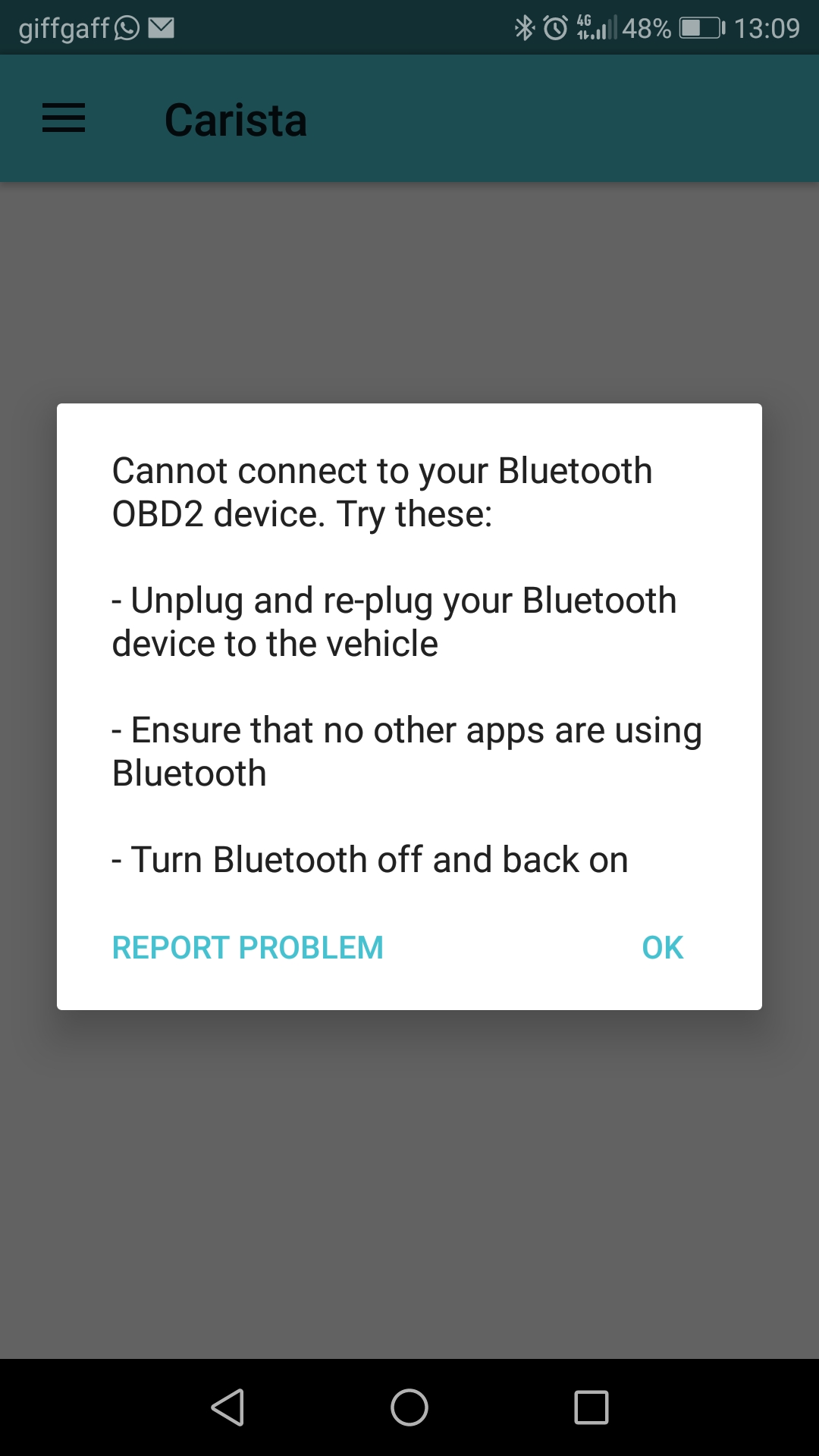

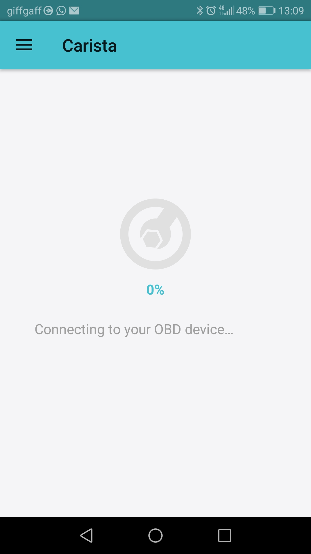

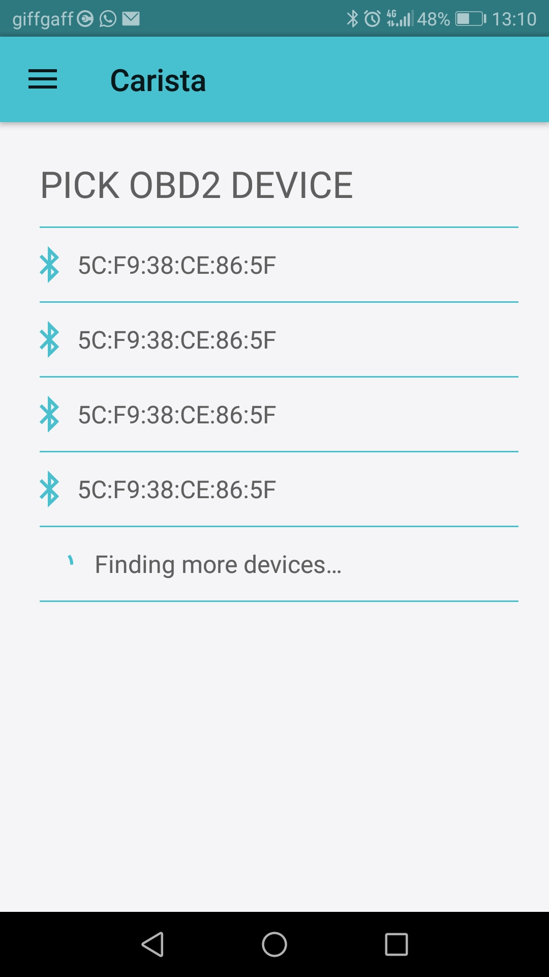

I did that and it still doesn't work :\ I got these screenshots..

Have you switched the ignition on as in one click of key or push of start button without foot on brake? Don't start the engine.
Is that list of bluetooth devices only appearing when you are in the car? Maybe click one, see if it connects? The device should be flickering blue/red if inserted within the port correctly.
Lastly, maybe turn off your cars bluetooth used for wireless phone interface, and don't have it plugged in via USB.
Other then that, I'm out of answers, sorry!

Hi bgb,
So quick update on what happened to me. I contacted Carista costumer service and had to send them a report of my error trough the app. Then they replied to me saying that I had a faulty OBD dongle. They sent me another one, received yesterday but only had the chance to try it this morning and everything is working now!
