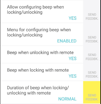

When you enable the beep when locking/unlocking the car, it would use the cars horn if there was no alarm system. Not quite the same effect as an electronic beep!! I'd assume that if you don't have an alarm in your car, you wouldn't have the two ultrasonic sensors up by the rear view mirror, where the map reading lights are. When you activate the beeping feature with Carista, it tells you to go to the infotainment menu and enable something like 'Sound accoustication'. I can photo mine if you need it. Just means that you can enable/disable the beep from the infotainment rather than messing around with Carista.
Also, there were several options within Carista to enable this feature. Might be where the problem is. Check these.out:

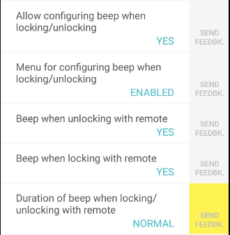

Thanks I have all of those options selected as well as the option ticked in the infotainment, I have just applied for the beta so will give that a go one it goes through. It certainly have the 2 sensor holes up by the map lights but cant determine if there is anything behind them. I assume not and its just a case of 1 facia / trim panel for all models. I cant believe that the alarm is an extra on a car of this price range, or that it wasn't ticked as the car was to be a demo model. But I did have to spec the alarm as an extra on my vRS.
