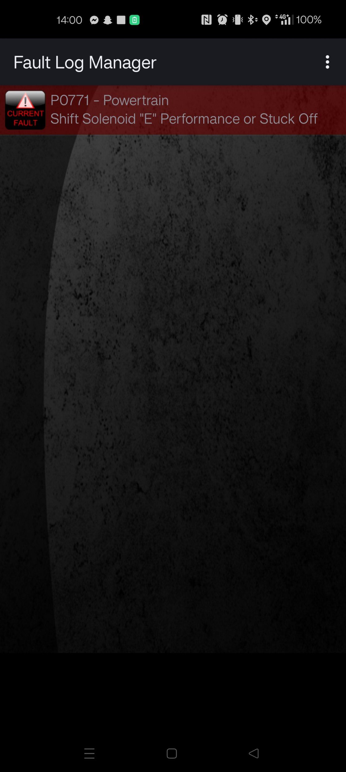

Last year I had gearbox issues and it turned out to be the switch so I replaced it with the white one (genuine part from Seat) and all was well apart from having to readjust the switch a few times over the months.
Today on my way home from holiday I lost all drive a total of 9 times and had the code p0771 - Shift Solenoid 'E' Performance/Stuck Off come up, this is the same as last time so I readjusted the switch but it kept happening.
Could it be the switch has failed or could it be something in the gearbox that has gone this time?
While researching the last time a few folk had said if the switch doesn't fix it then it's the solenoid in the box but they both give the same code so there's so way of knowing, no idea how true that is.
Any help or advice is welcome.
