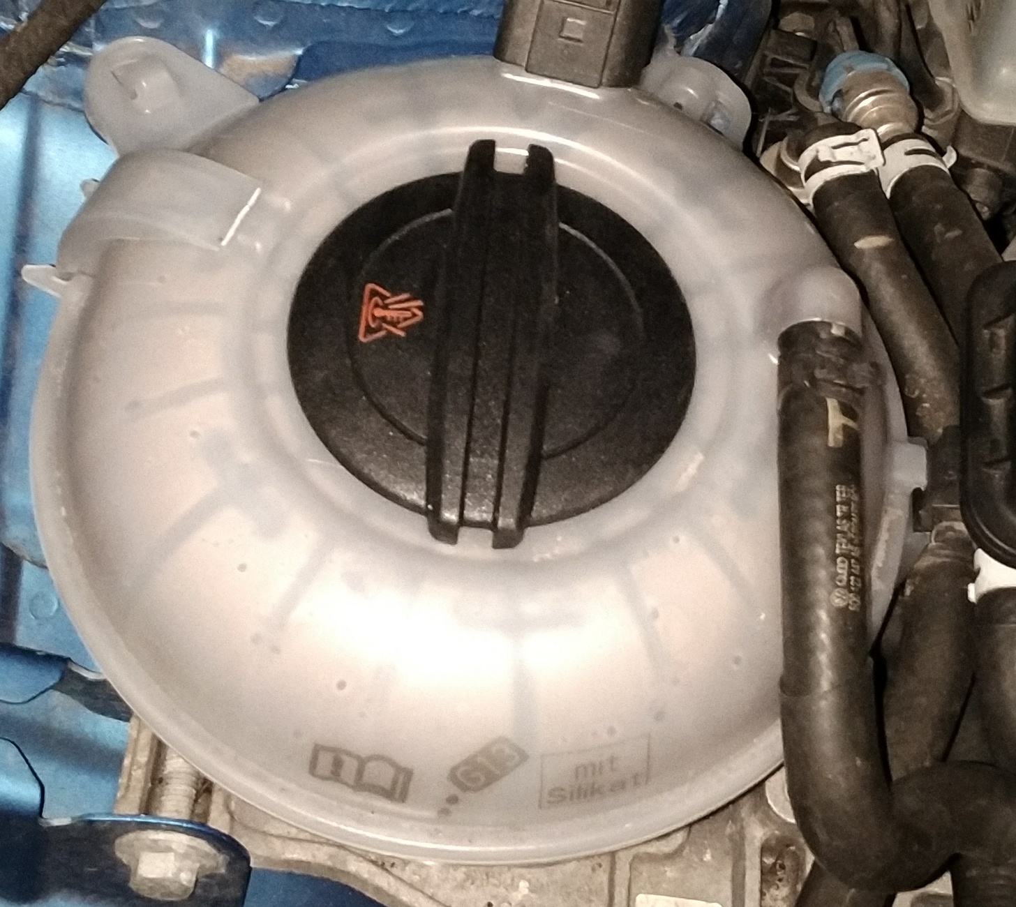

Can you send a photo of the coolant bottle? Also does the coolant smell almost burnt?
No smoke and head gasket is 100%
