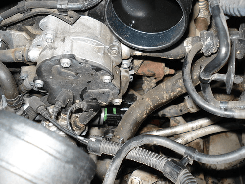

Coolant level sensor or temp sensor ?
The level sensor is in the header tank.
The engine temp sensor is near the vac pump
The temp sensor. Cheers mate, looks a tight space but should manage it. Much appreciated. This car has been a nightmare. Thought my issues were solved but they've came back again. Car goes into limp mode and traction control, tyre pressure, start stop and parking sensor lights all come on.

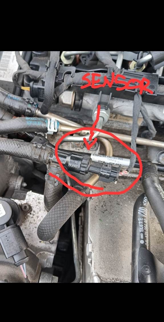

Anyway, can anyone tell me what sensor this is:
Why do you think a footwell lighting error code is actually a coolant sensor and MAF fault?
When I google the error code I get and when I use the carista app it gives me coolant sensor and MAF plus my footwell lights work fine.
