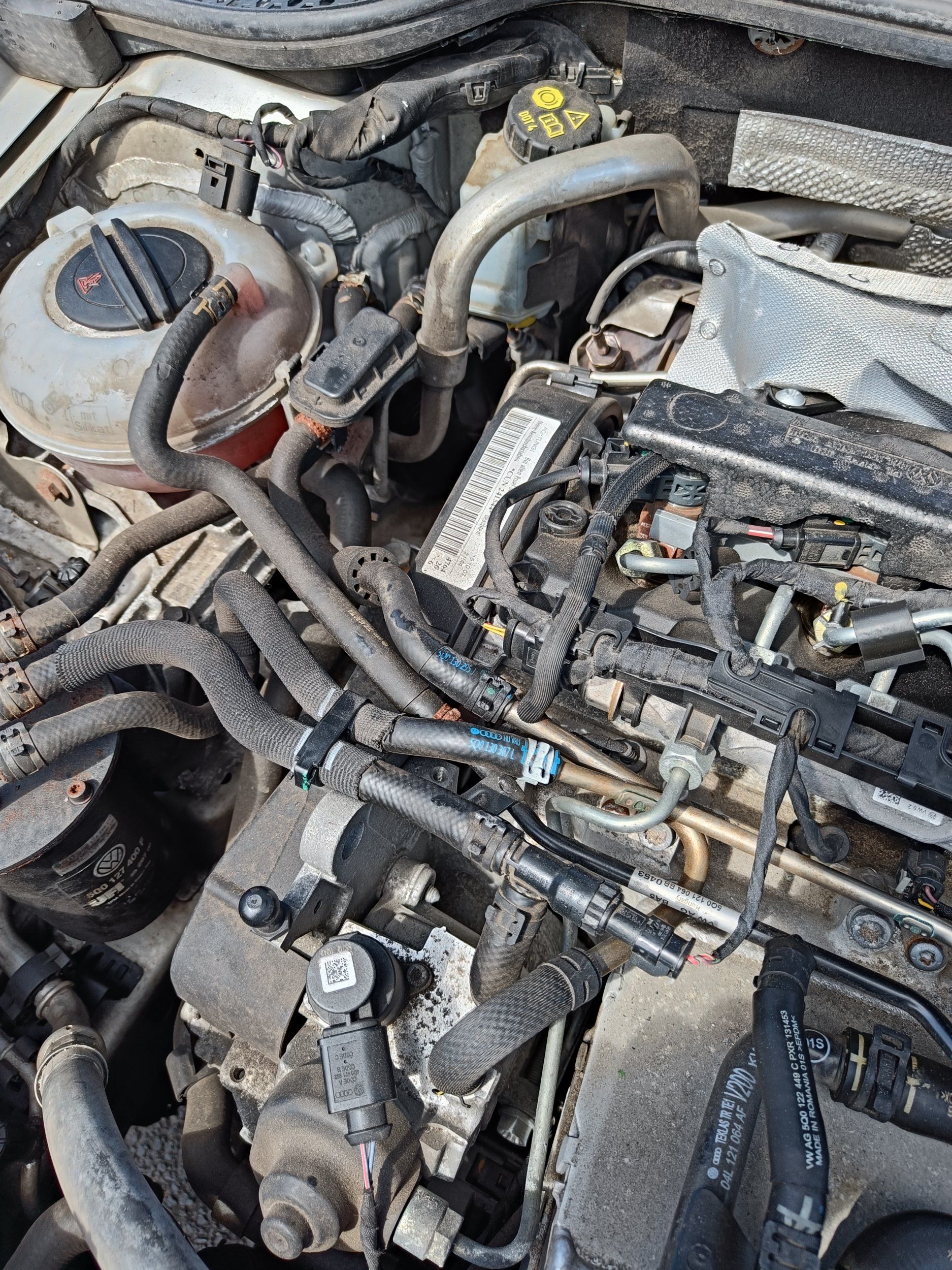

Got a replacement coolant temp sensor but still can't find it on the car. I've removed the air box to give me more room but still can't see it. Followed the coolant pipe but got a feeling the sensor is at Rear if engine. Any help would be appreciated.

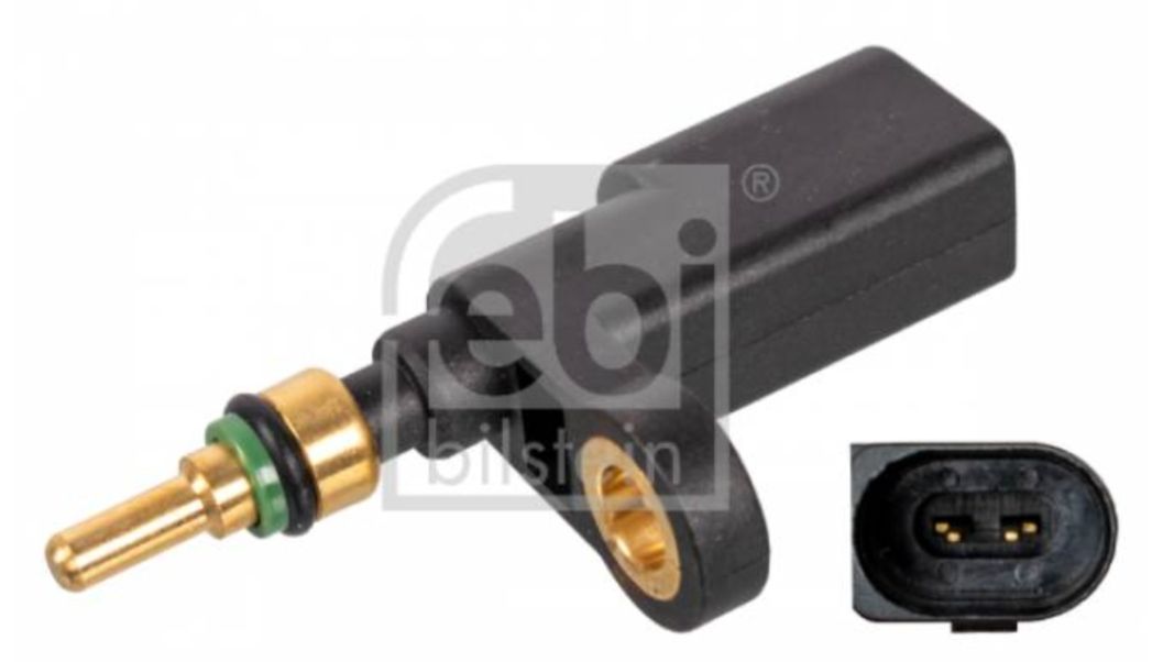

The picture you posted shows a straight sensor.
The one above is a right angle sensor
Yeah I posted the wrong picture, my apologies. It's definitely the right angle sensor I have.

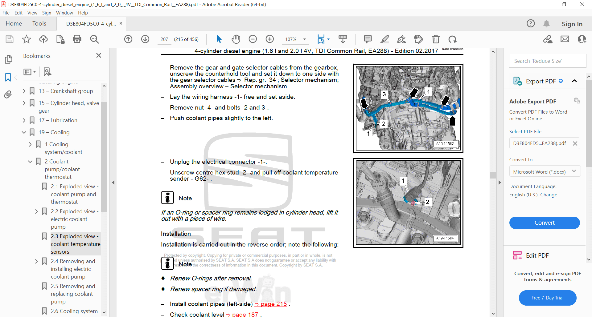

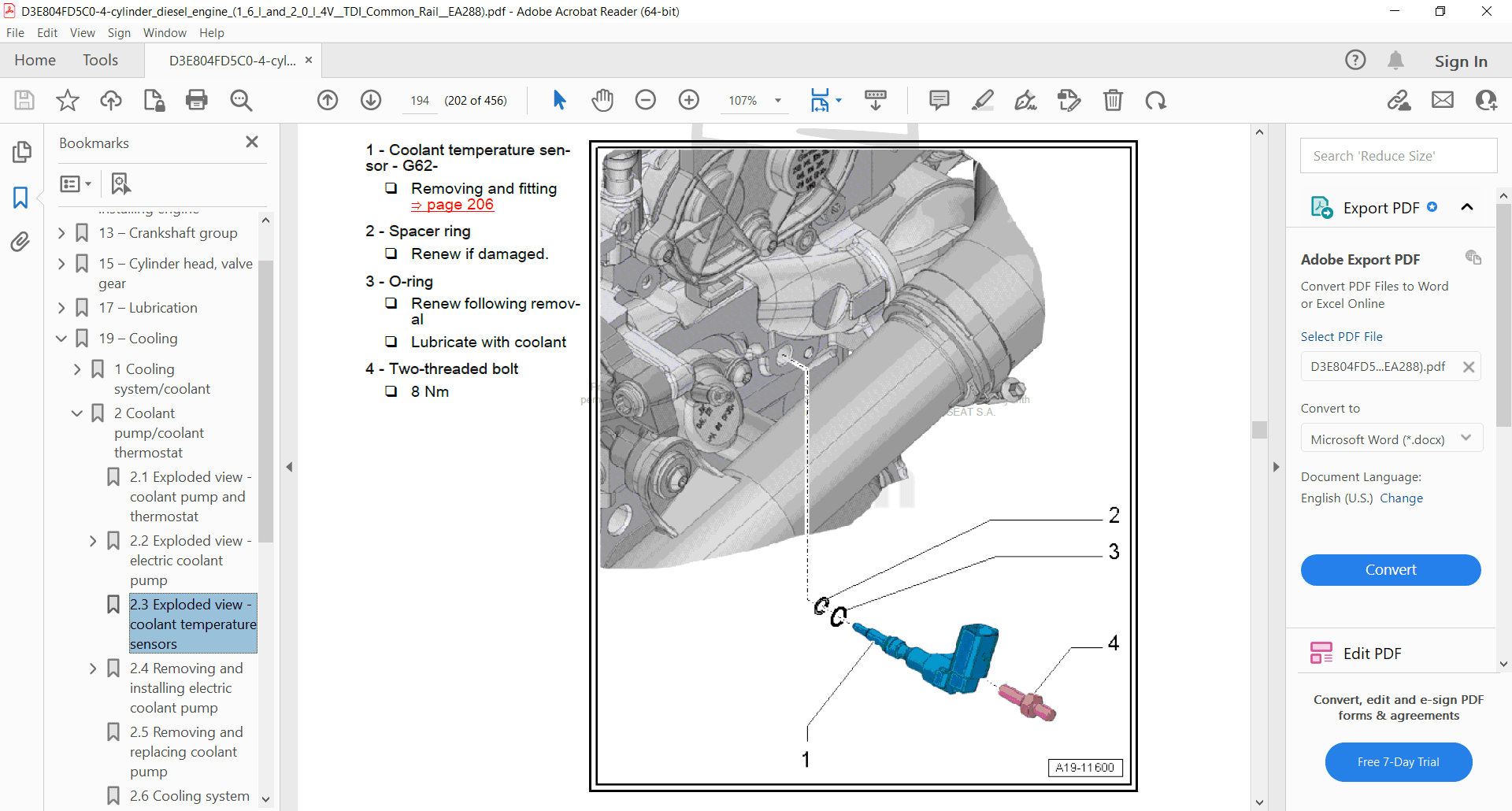

Going by the page from the manual I dont get the removing of gearbox cables. Didn't think it would be that involved just to change a sensor.

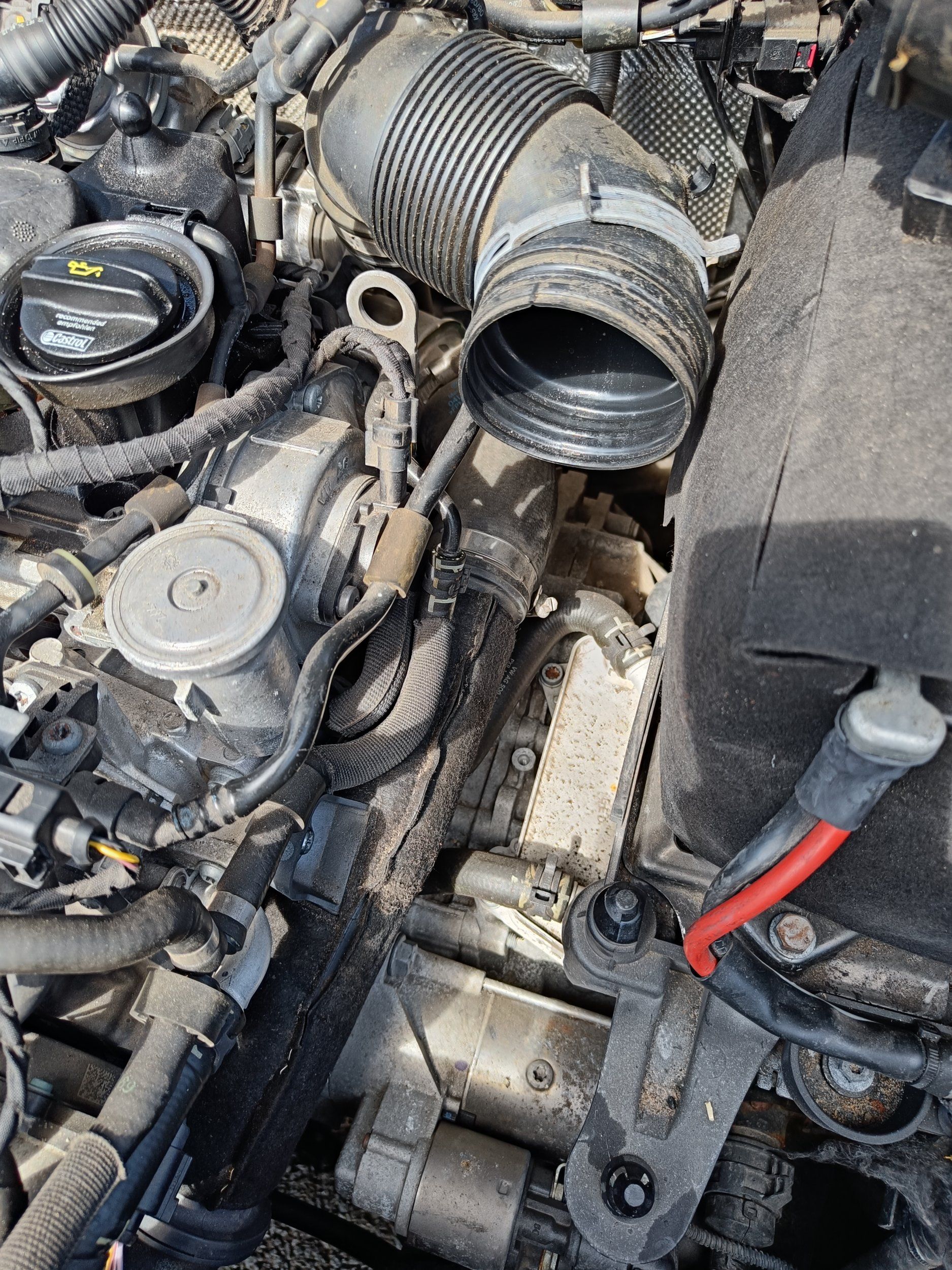

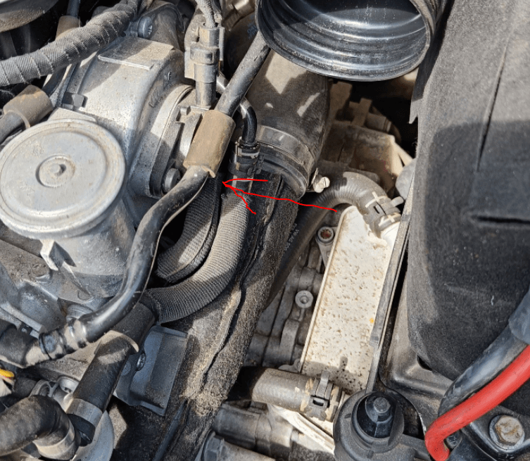

So going by the pictures of my engine I posted, where roughly is the sensor? I know I'm being a bit thick but I've always used garages and never tried any mechanic stuff myself until I had this car and the garages couldn't fix anything.

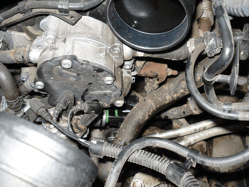

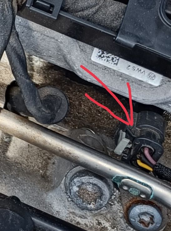

Your coolant sensor is here:
Cheers, had a look and thought it was there. So I take it I have to remove that big hose and the smaller ones?
My mechanic had to remove the fat (air intake?) hose to get to it. The bolt that holds it in the block also holds another bracket in place, so it's a real faff to get out. He said it was a real b@ll ache.
Just pray you never have to replace the thermostat housing or EGR cooler. More VAG witchcraft.
