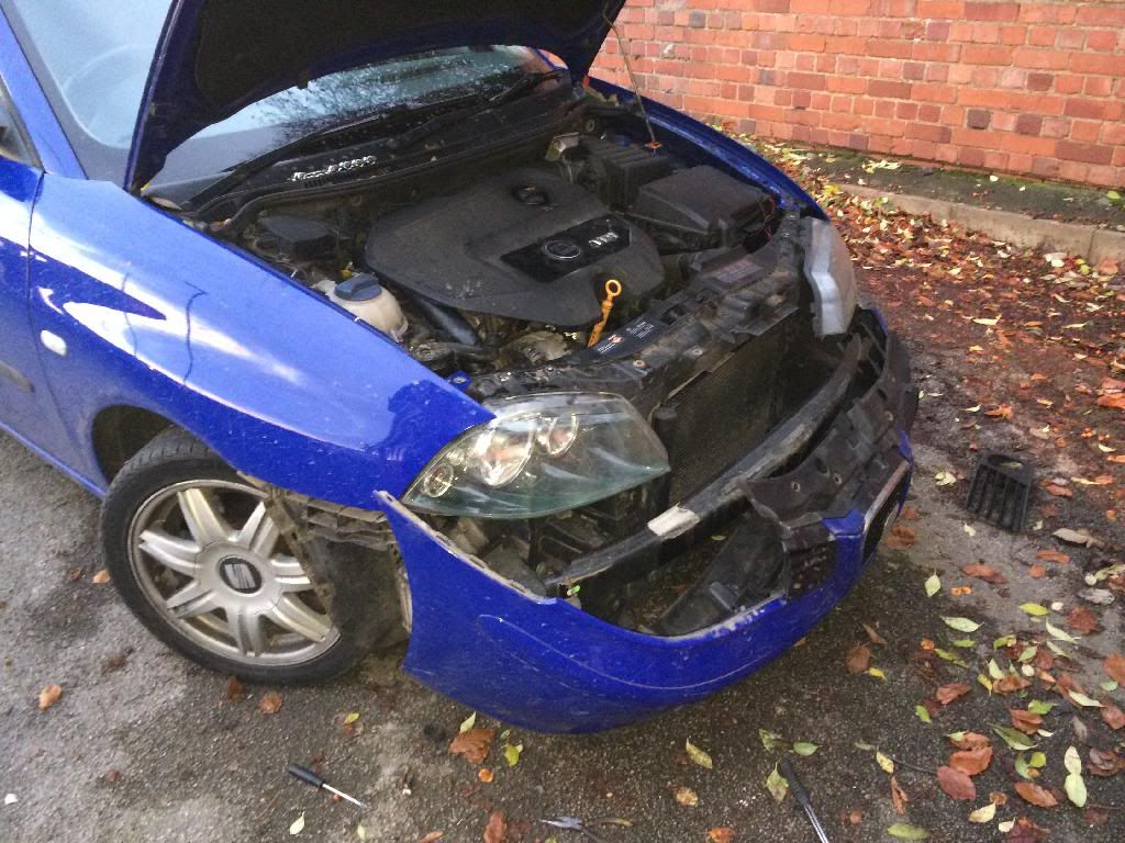

Rechecked all boost pipes which meant my car looked like this...

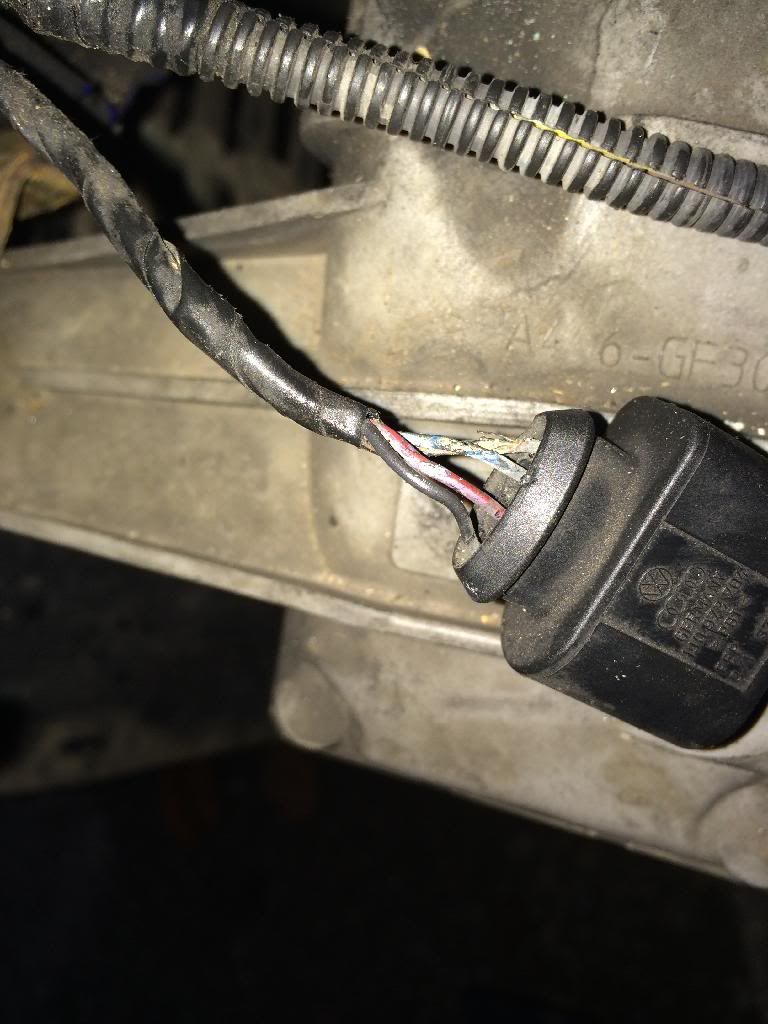

After looking at the MAP sensor wires, it was evident what my issue was;
The wires were twisted together and over the years, wire 1+2 rubbed together, and shorted, giving the ECU iratic readings causing my car to overfuel. After a quick WD40, dry and wrap in insulation tape, I took the car out for a spin and wow, such an improvement!

Doesn't look drastic. Wouldn't hurt to clean it mind you.

Perhaps I should protect that bit of wiring before it happens to me
Ideally that section of wiring needs extending a few inches to protect it as it's pretty stretched already.
Perhaps next time I'm in there I'll do this 'mod'. Shame we can't source a socket and plug and make a plug and play job to make on the car fitting quick and simple...
