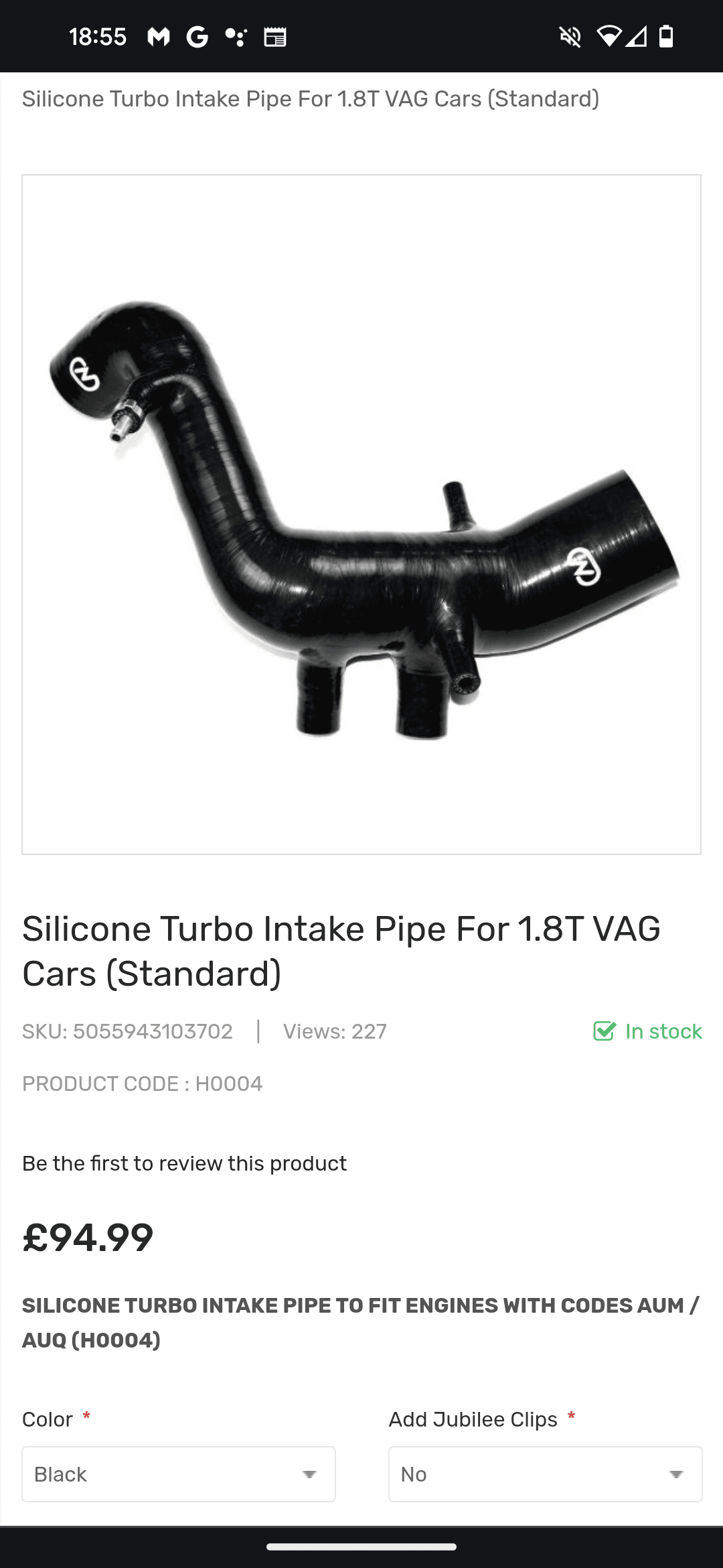

Confusing, it's definitely fitted to an AUQ engine in the pics on their website. https://creationsmotorsport.com/silicone-turbo-intake-hose.html
The 225bhp cars with the K04 turbo (BAM and AMK engine codes) have completely different intake manifold layouts. The TIP for those engines look like this https://www.amazon.co.uk/Silicone-Turbo-Intake-Cupra-H0145/dp/B08H2GSR8H?th=1

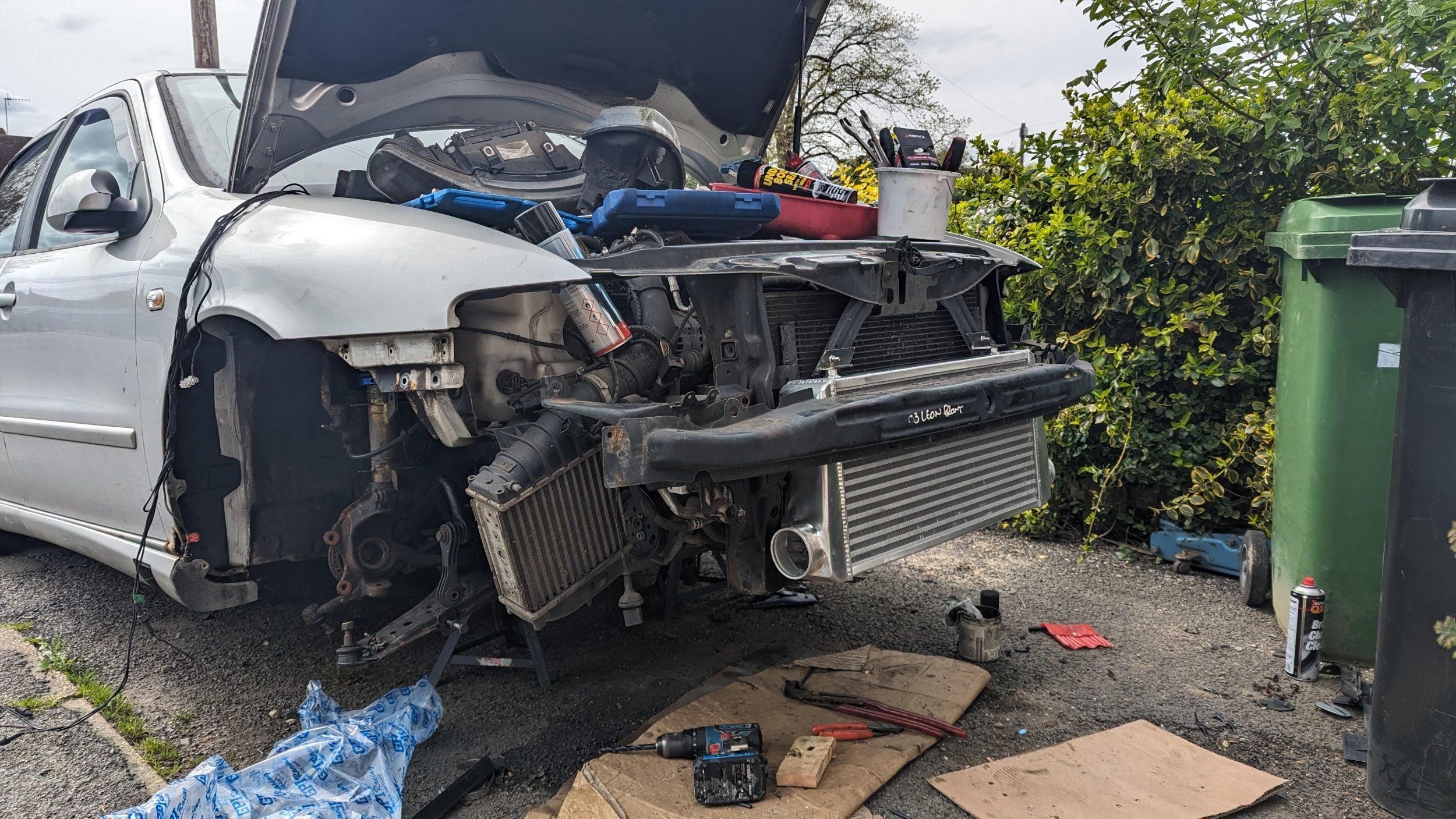

So, I've managed to order the correct pipe for the AUQ engine. It fits, but it's definitely snug against the gear linkages. I could realistically cute some more of the end, but I have a bit of PTSD after the last time ?.

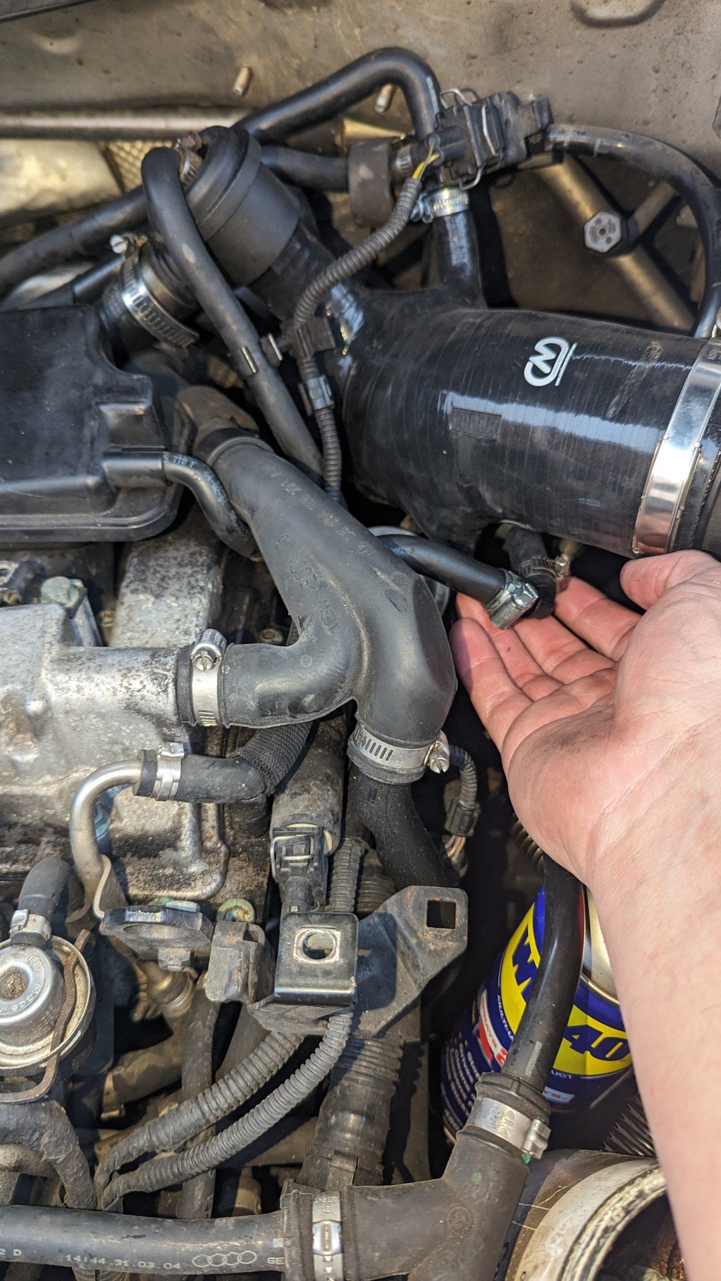

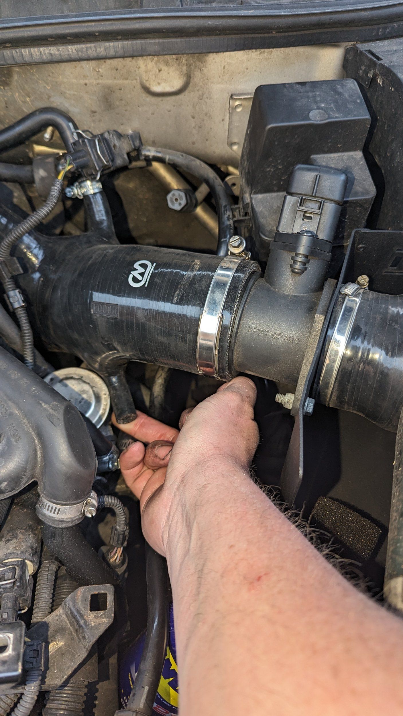

I've hooked it all up, but I'm convinced it's got an extra hose..
The pipe I have in my hand on the 2nd picture I've routed to the section of the TIP with the metal fitting, but referring to picture 1.. and also pictured in picture 3... I can't remember anything going in there...
It's a 5mm(ISH) internal diameter fitting so I'm gonna block it off and hope for the best.
I wouldn't usually have a problem remembering, but I've stripped so many parts off this car now ?.
