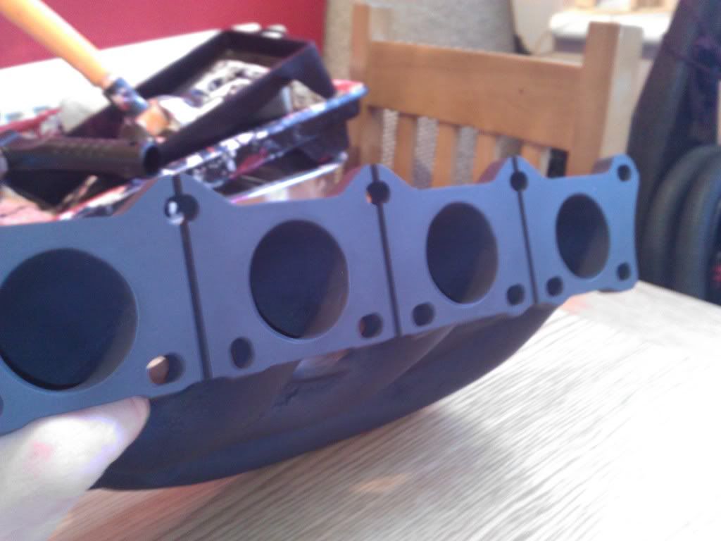

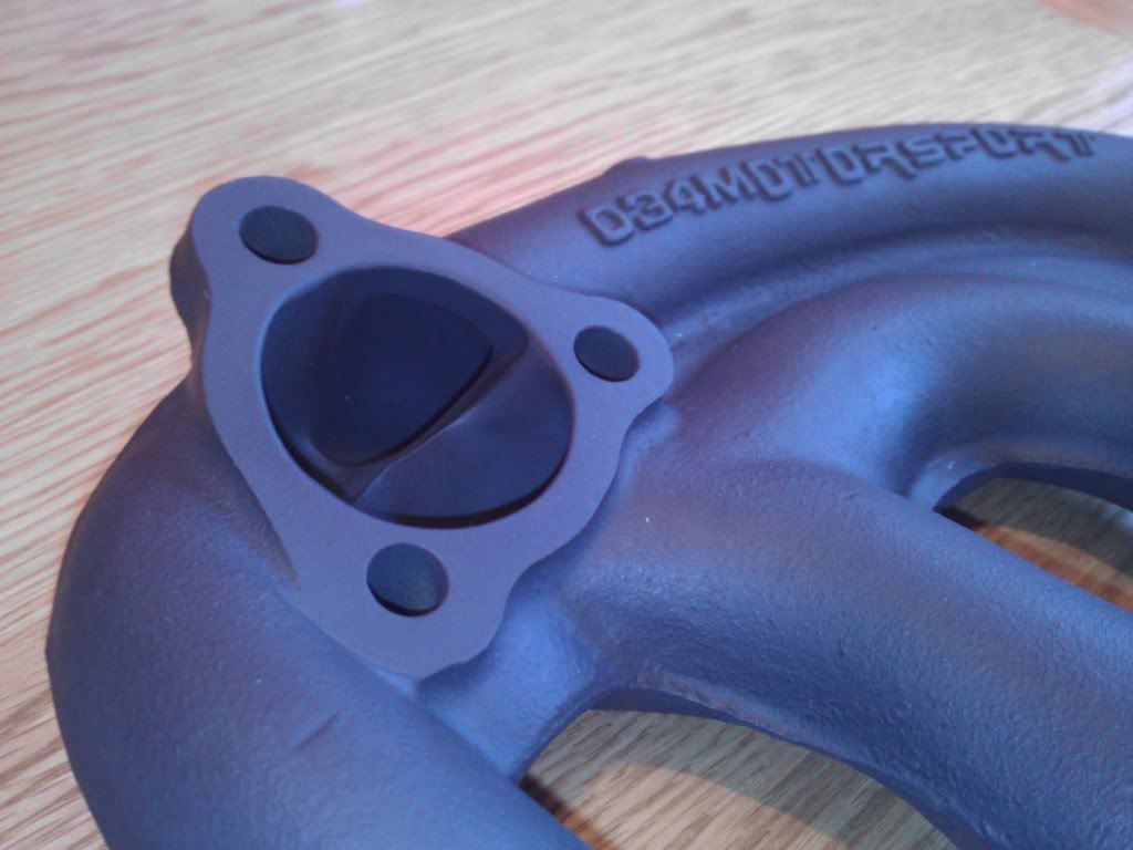

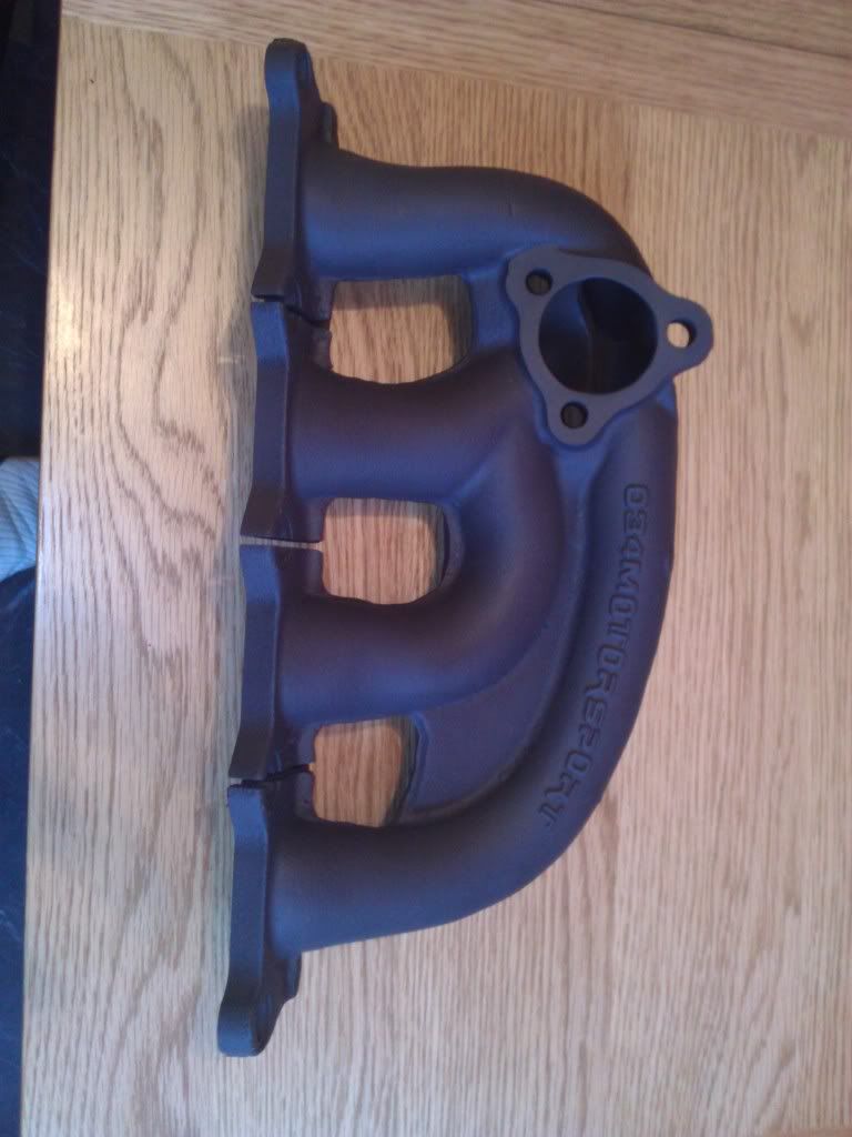

This was My New thingy Dan...Its a INA Ceramic Coated (Grey) K04 Uprated Manifold & Gasket...
Its amazing Quality and Is Really well made and by the way it drives it is worth ever single Penny in Development and Purchasing Amazing Engineering TBH....
The only Downside was getting too and getting the Old one Off which was a utter ****ing Pain....So Big Thanks Issam for this manifold...
It made 288bhp without the INA Manifold So its back on the Dyno Mid january for a Resit and looking and Feeling the way it deleivers the Power Is Immense...[B)]

Danny this is a bit of a random move as everyone else is staying clear of these till the 'issues' are sorted out.
I'd be interested on hearing the thoughts behind ceramic coating the sealing faces, very strange!!
Are these coated inside and out?
The one that welly had was cracked.which was uncoated I'm showing that a ina coated manifold will work as it has worked for the USA lot.im not sayin anything more on it as the old issue has nothing todo with my build thread.
And yes its ceramic coated throughout.

good luck with that manifold... will be interesting to see how it fares..
Hat off to you Danny. Hope it all works out well
