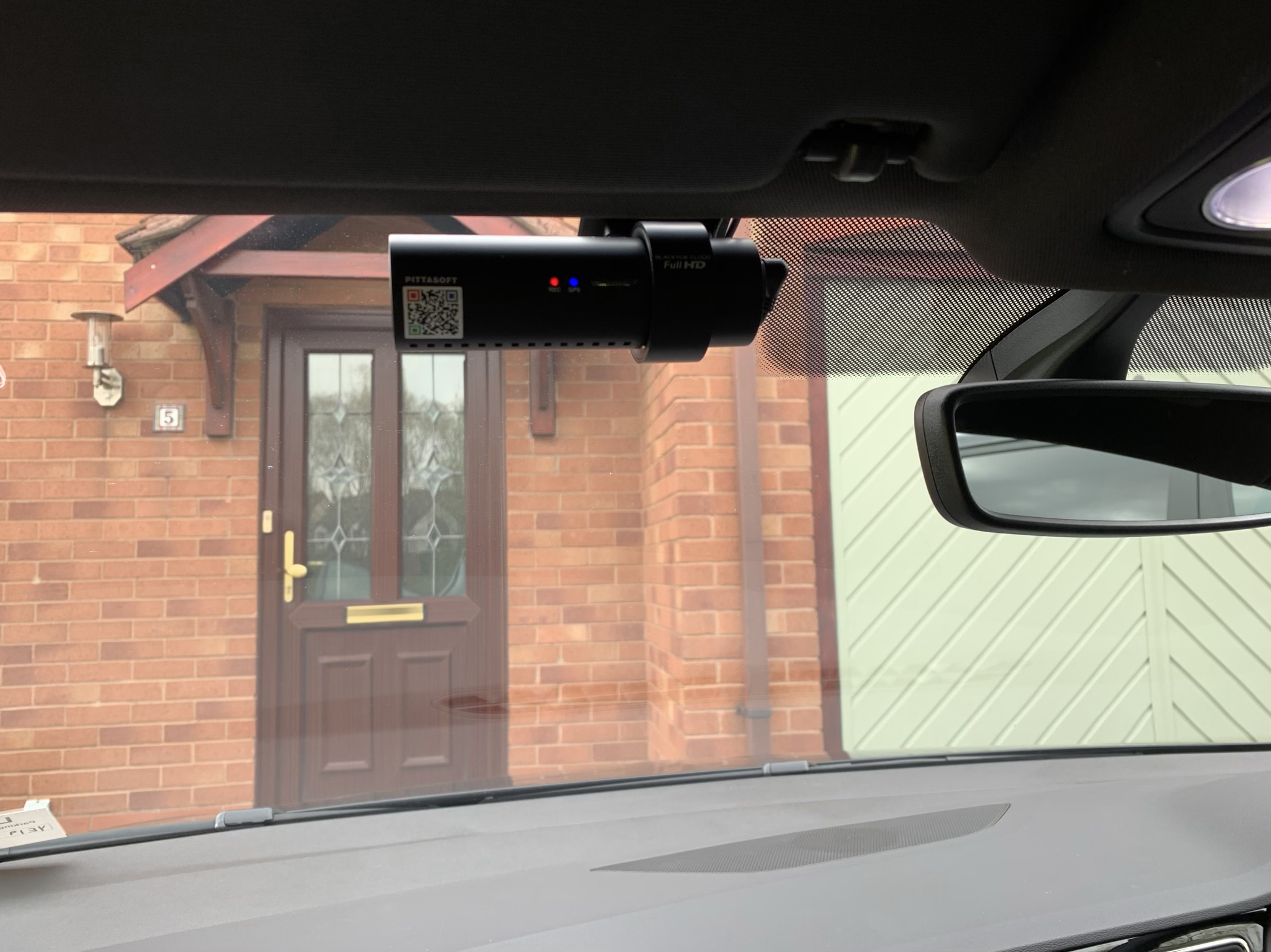

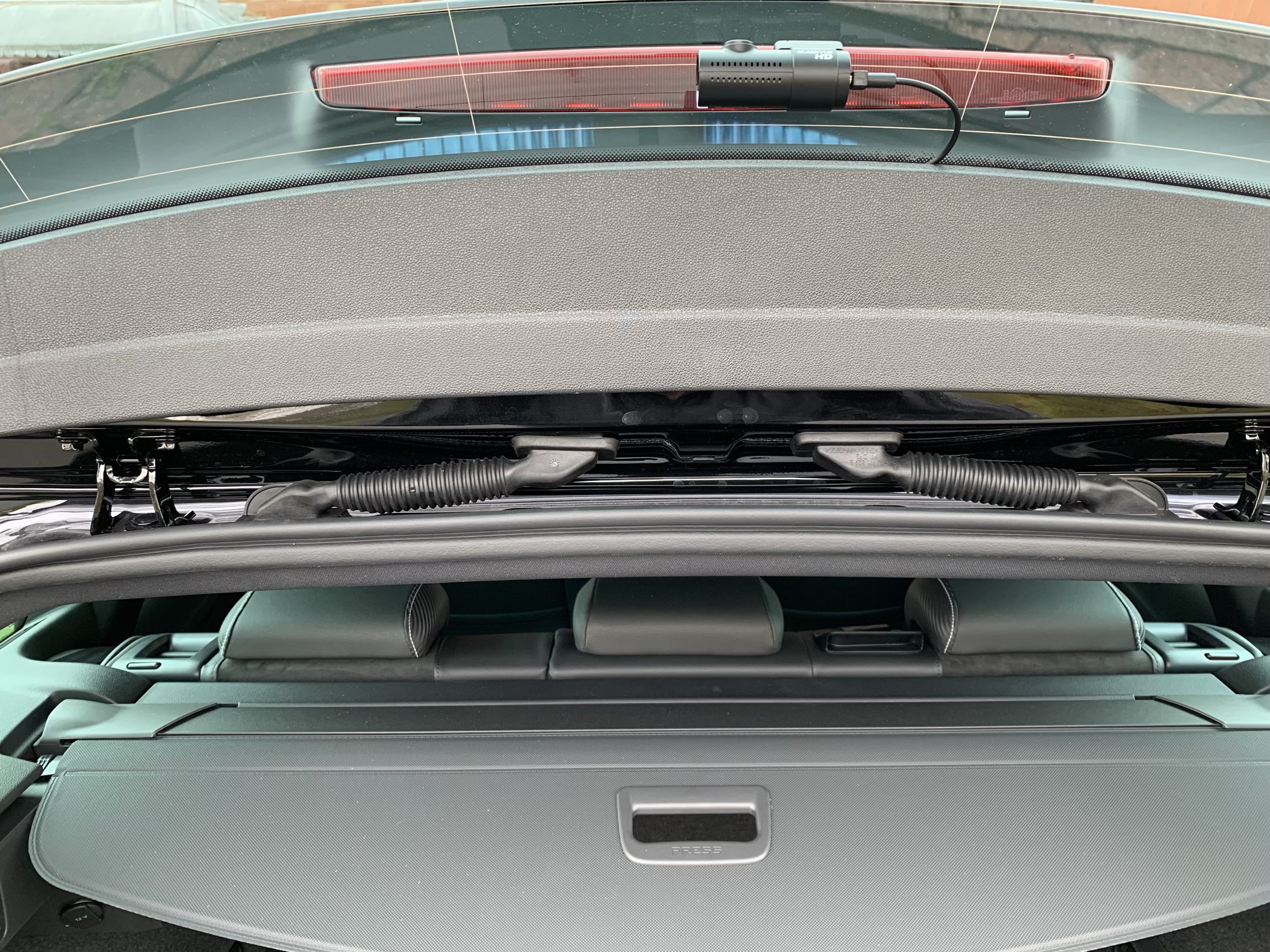

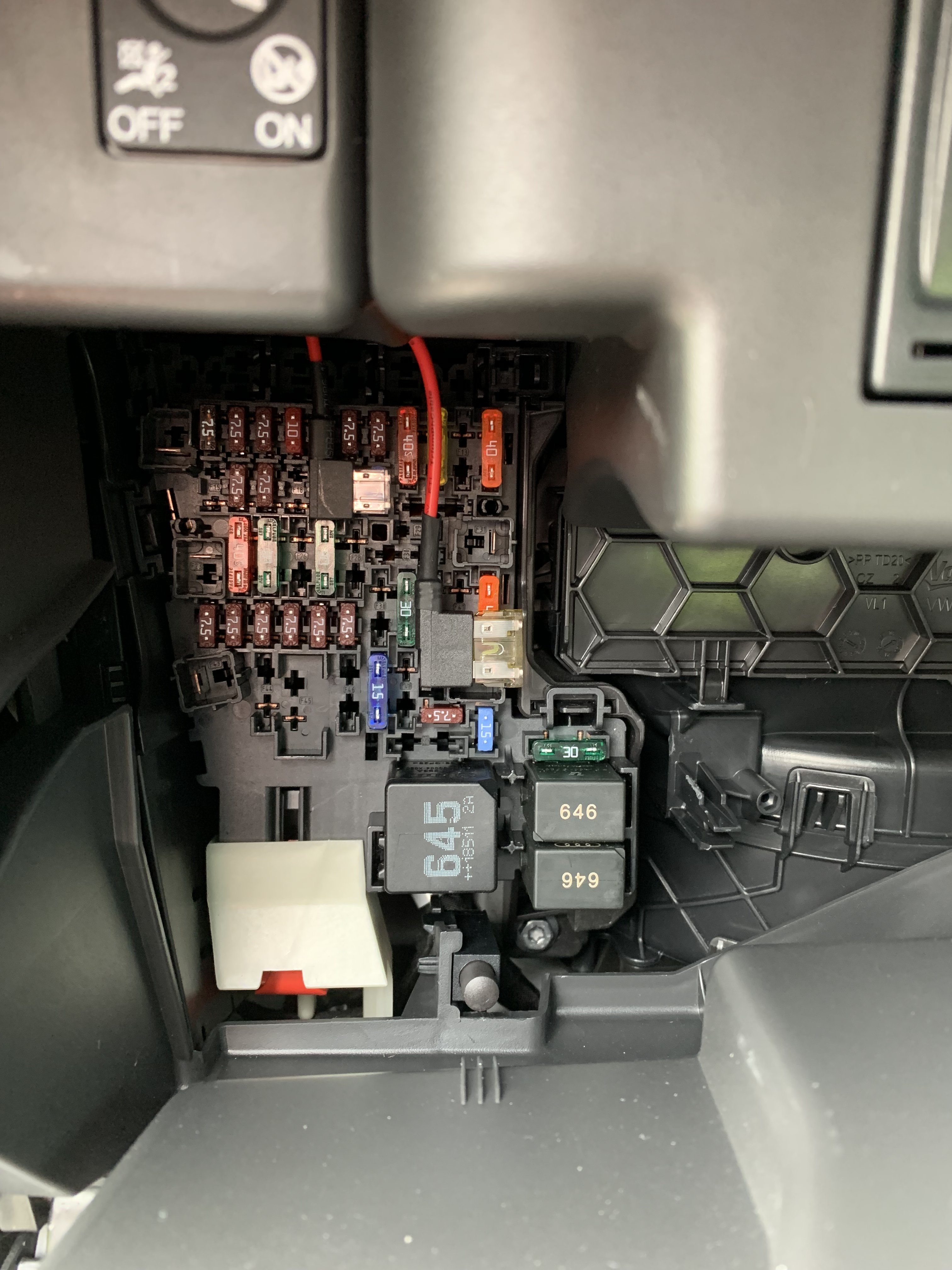

Great help this thread. Just fitted a BlackVue DR650s-2CH.m to my Cupra ST. The rear camera was a pain, mainly due to the stiffness of the rubber seals and having to strip all the rear plastic. I fitted a Power magic pro power supply so had to fit a permanent live. I used a spare micro fuse. It’s important to get the polarity correct for the tap-in fuse adapter if you use an existing fuse.

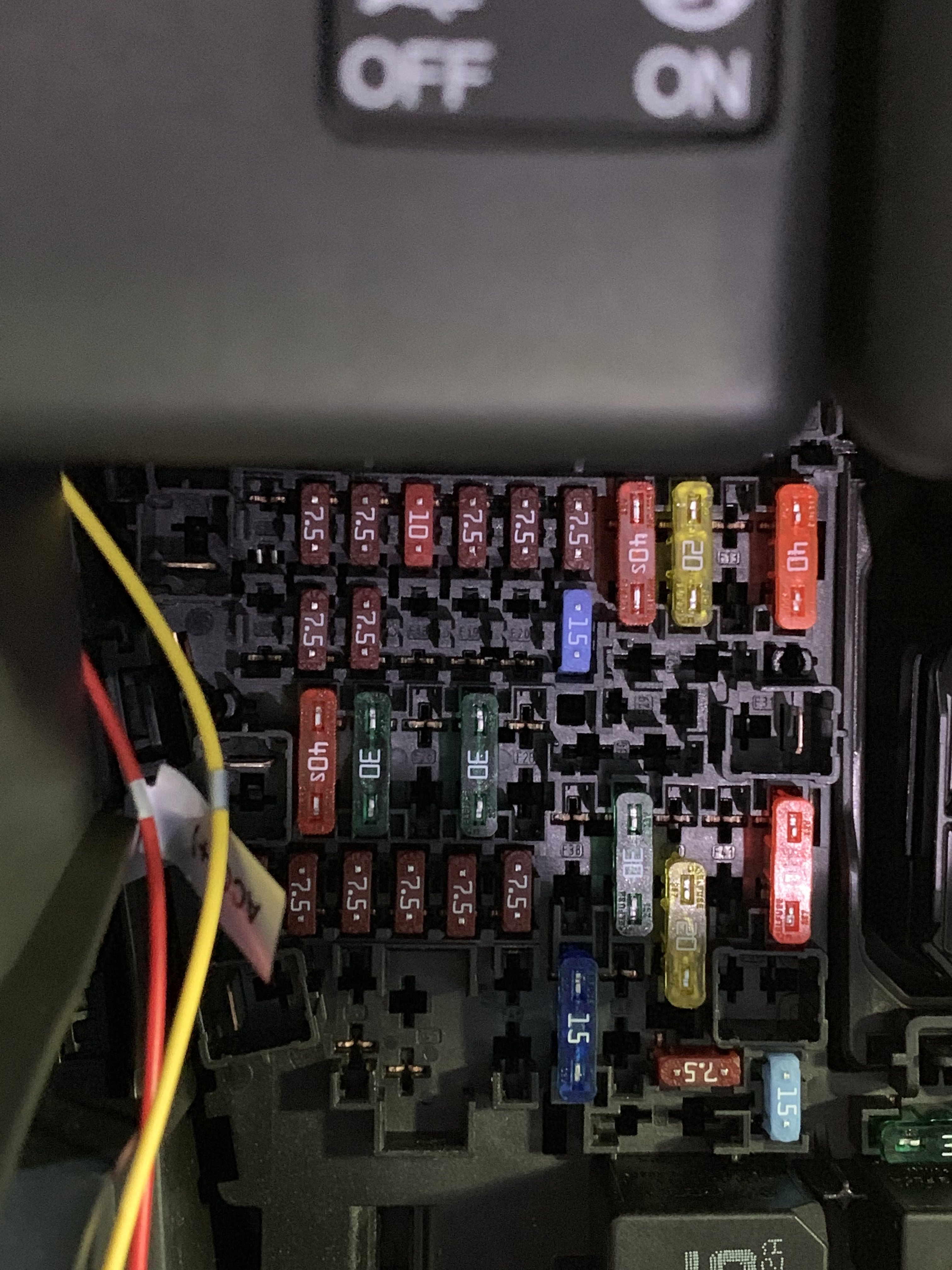

On my quest for a Perm. Live, would the attached pic and fuse position/theory on moving up one notch be applicable and the 'done' thing? On a Skoda forum it seems to be correct for the Octavia VRS, and a MK7 GTI by looks of it.
My Thinkware F770 seems to have the necessary gubbings to know when to activate parking mode, and switch off if the battery volt level gets too low..
