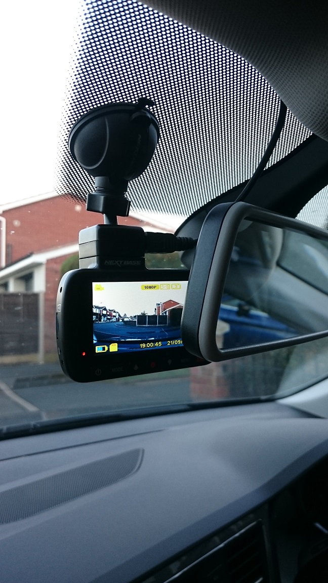

This is my Blackvue...stealthy...
Really like that! Would a NextBase hardwire kit power one of these? Or are you using the OBD2 power lead?
I’ve got an OBD power lead and the cam is left permanently in the car. The standard nextbase mount wouldn’t work.
From the outside it’s pretty hard to see too. Easier to see the sticky mount!!
Same, had mine in a car for over 5 years now. Just forget about it. I have a mobius and they are small, no screen so quite discreet. I cannot see it without ducking down as the mirror hides it completely.

I did consider mounting mine behind the mirror, and actually bought a stealth mount from ebay so it would be a smaller setup, but then decided if I want to take the camera off, the rear view mirror would be in the way.

After daniel_ley's post, I have decided to relocate the camera though. It sits behind the rear view mirror now, which I prefer as the cam is virtually out of my view, and it is still removable. More importantly though, the mount sucker is now in the black dotted area of the windscreen, so is not visible from outside.

That's exactly where I have got mine positioned, means I have to move the camera angle when connecting to wifi etc but it's not a big problem. Can barely see it from the drivers seat
