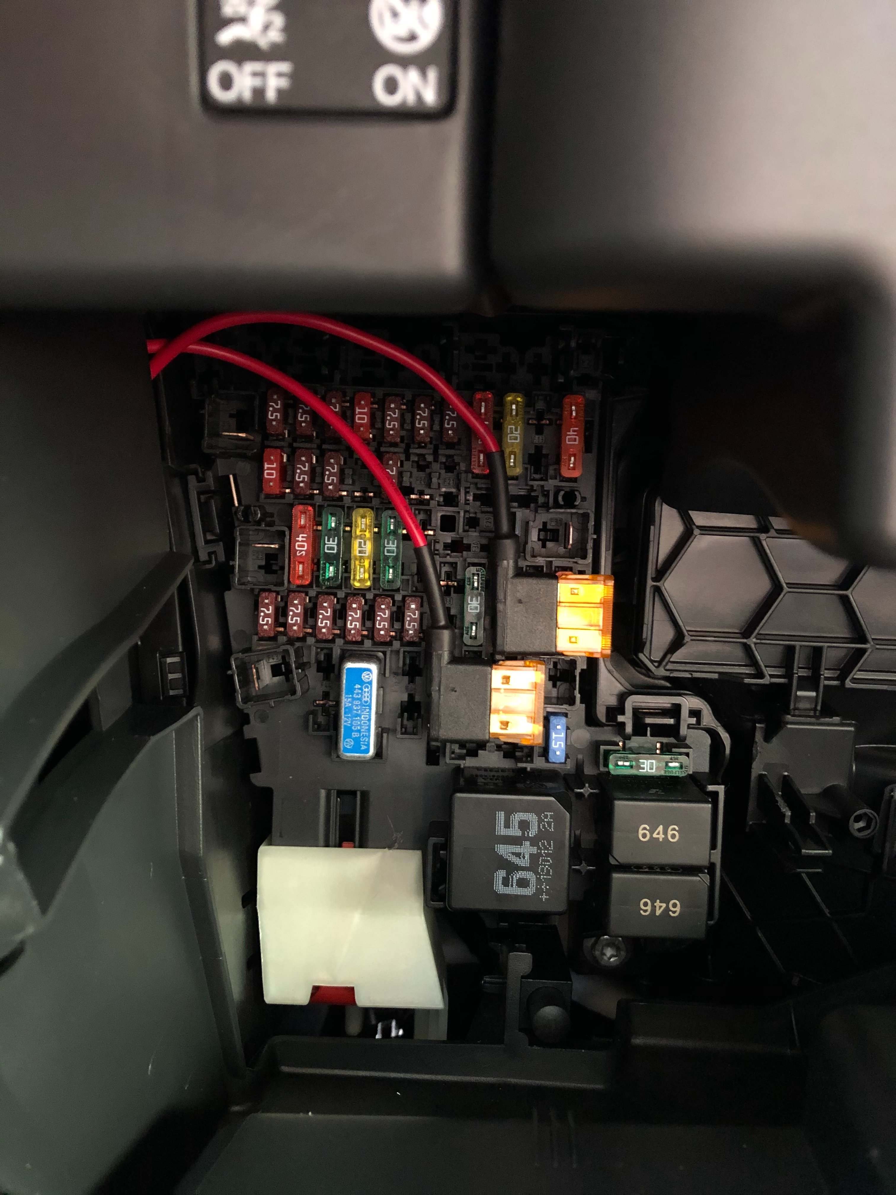

Recently had my Vantrue N2 Pro hardwired into the fuse box of my MK3 Leon by my local dealer. I specifically asked them to wire it into a perm live socket.
The attached pic is where they have wired it... Where the 'red' wire connects. I suspect this is the wrong place as my Dash Cam simply refuses to enter parking mode when I turn the ignition off. I have Parking Mode 'On' and G-Sensor set to 'Medium' on the cam itself, but looking back at the MP4 history I can't see any activity from where my car was parked at work all day yesterday and last night?? I am only seeing normal driving activity files within the 'Normal' folder.
Can anyone please advise where I should move the cable too?

Sorry, yes.. It has motion detectors/sensors as well as the G-Sensor. So if a vehicle, person or object of any kind moves within range of the sensors then it should trigger recording. I find it hard to beleive that a person or car has not moved in front of the camera all day yesterday while it was parked?? So was asking the question regarding the Fuse box connectivity, cause I notice that the cam say's 'Goodbye' and turns off pretty much immediately after I turn the ignition off..??
So, reading back through this thread it looks like my dash cam is hardwired into the wrong type of fuse socket, Mini as appose to one of the Regular fuse slots.
Am guessing that the connector being used currently won’t now work in a regular socket and will need to be changed to a Regular type along with a reg 20 amp fuse to connect in the side of it. Don’t think the guys that fitted it left the other connector types with me. These easy to get hold of and change once it’s already been wired?
Then I’ve also seen comments about positioning of the plug.. level with the others, red wire pointing up/down??

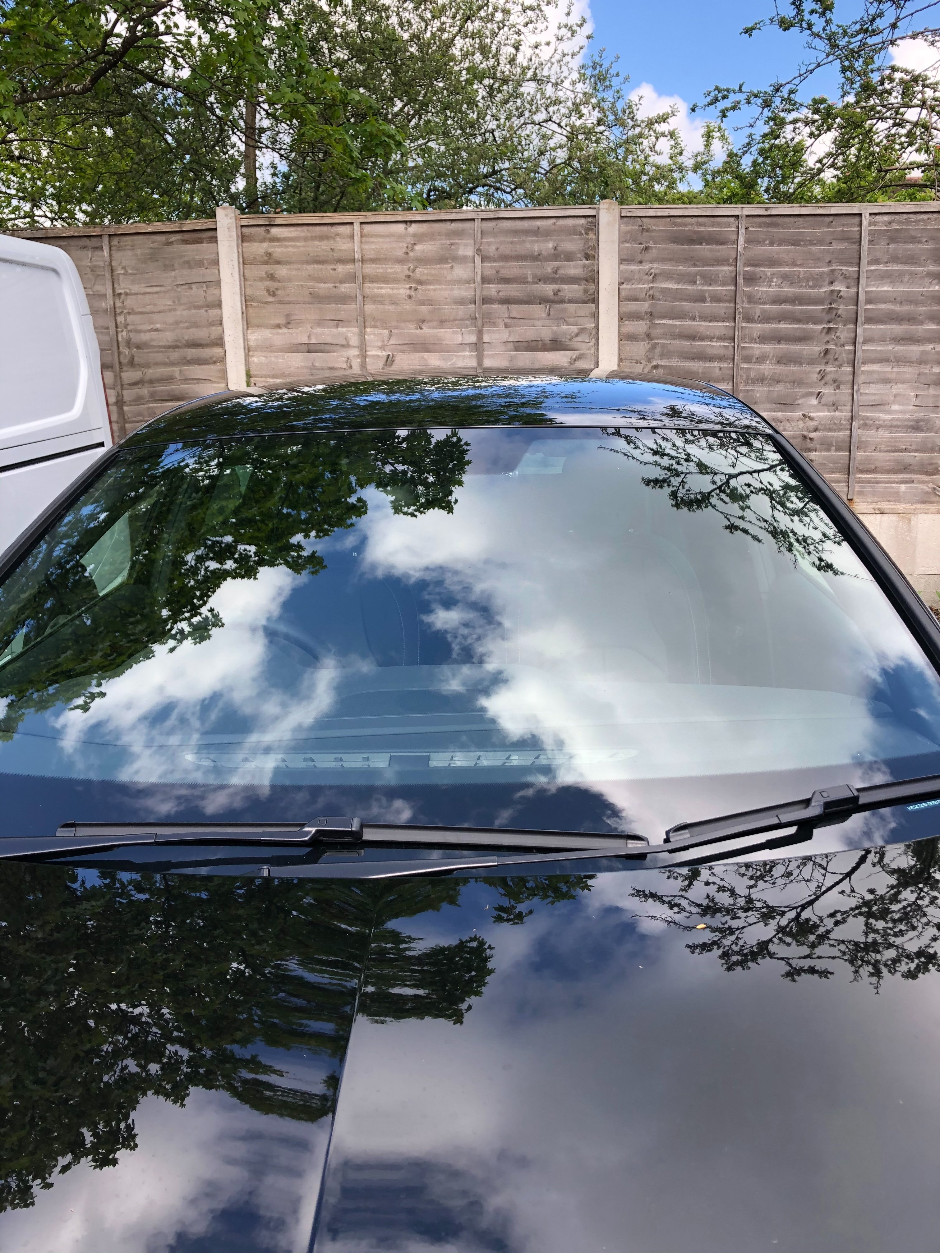

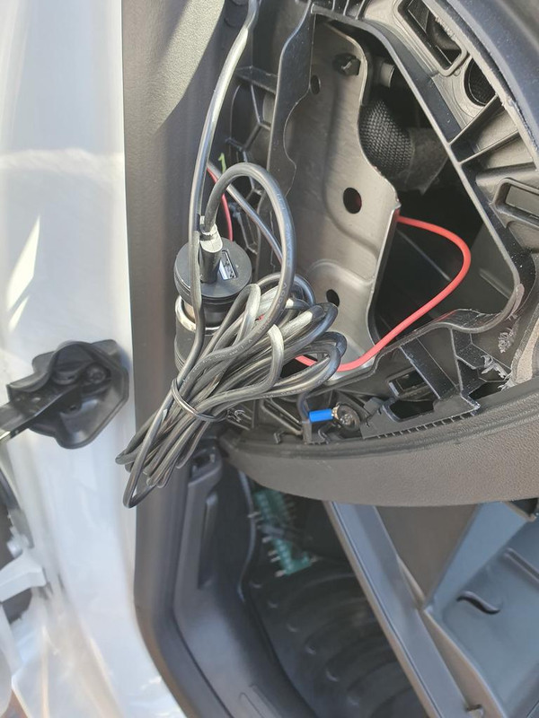

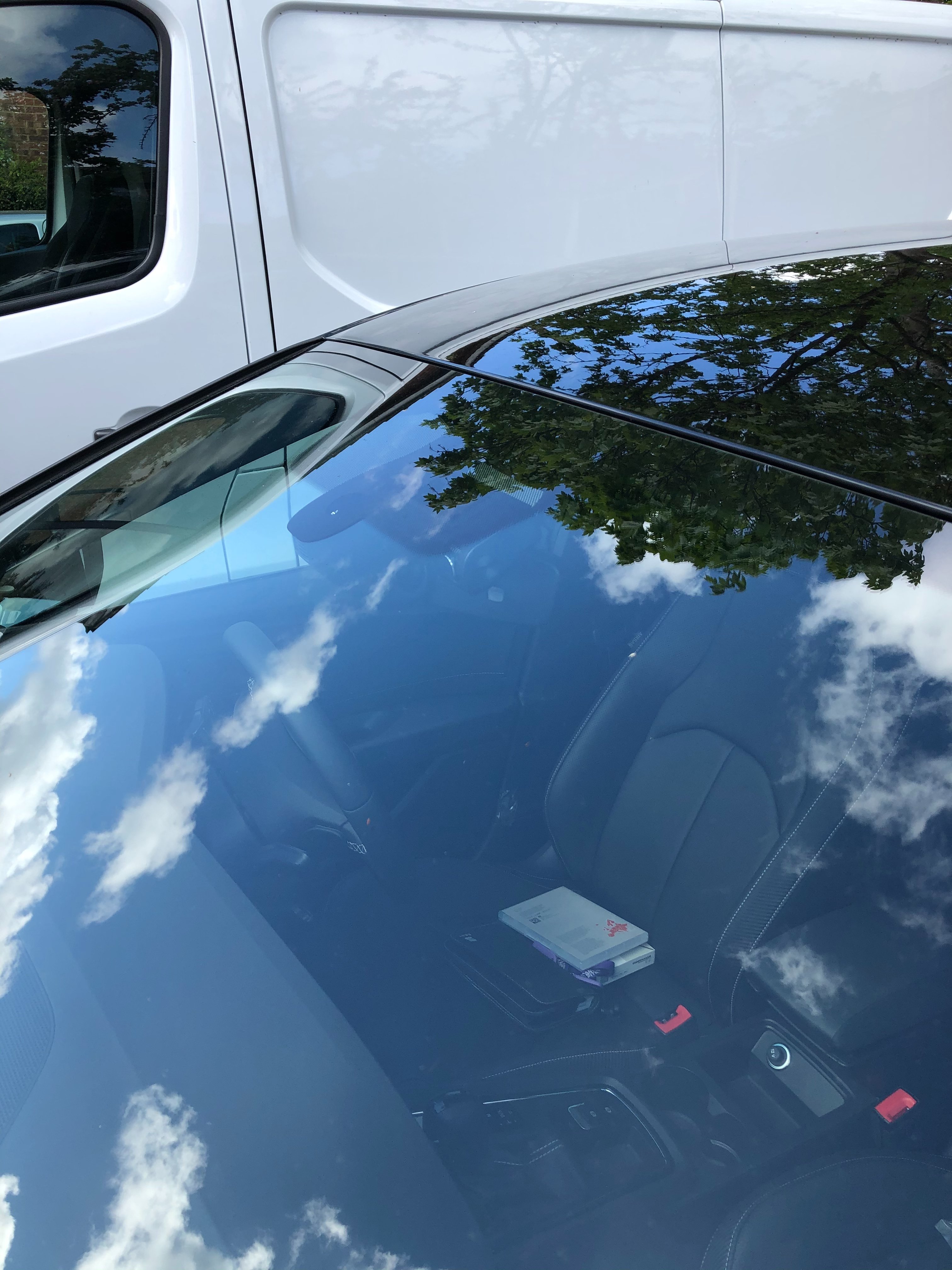

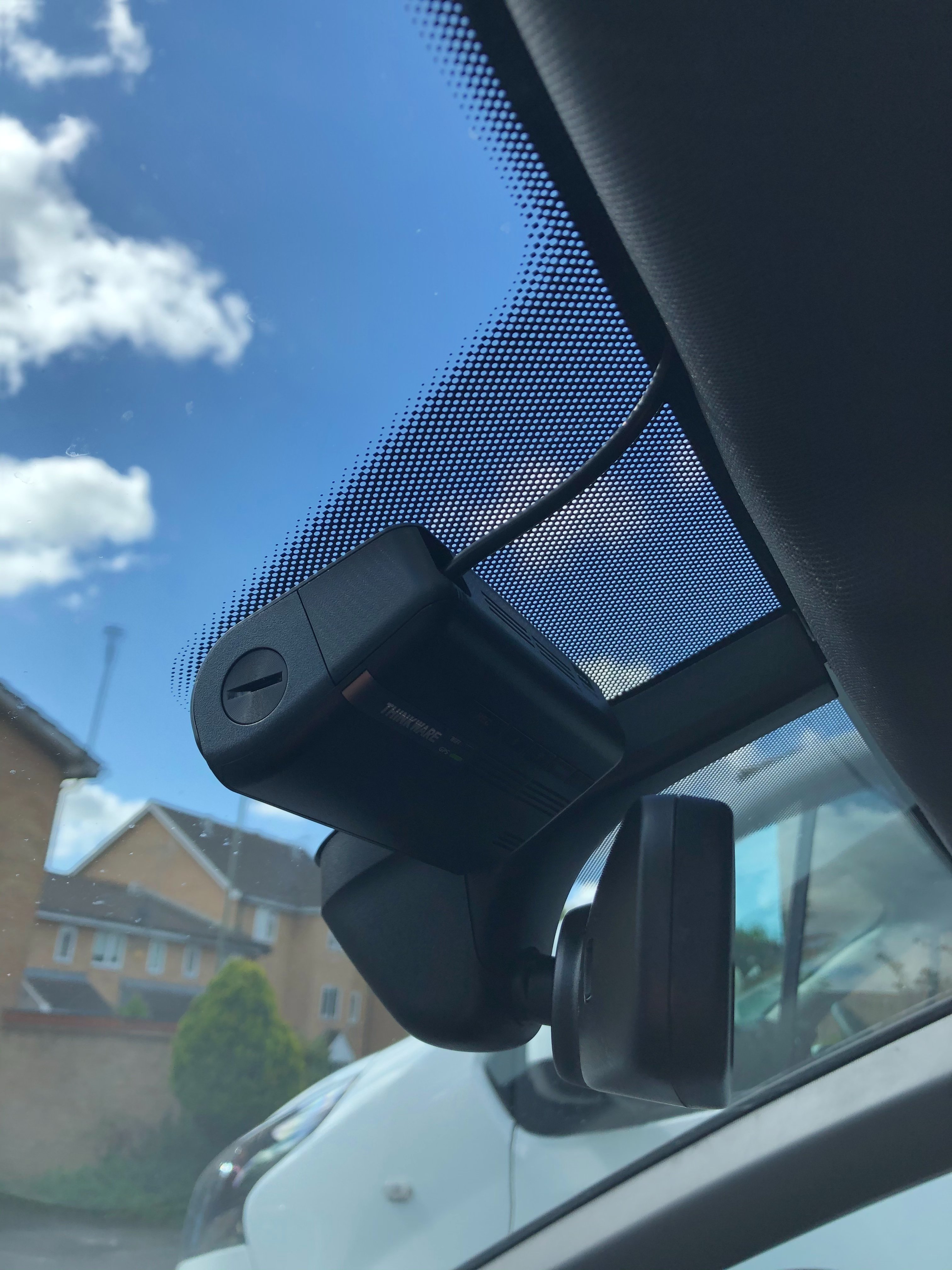

Here’s my instal of a Thinkware F770 2Ch (front and rear)
The hardest part was getting around the B pillar, and still haven’t found how I’m dealing with the excess rear length cable. To be finished another day..
Fuses used were the 12v socket moved to constant power, and the rear windscreen wiper (No. 47) as my switched.
All works as should once I messed around with the parking bit within app, ie sensitivity for motion.
As a “FYI” i installed on the left of the rearview mirror to avoid seeing it... I now can’t unslide the unit haha.
It’s not coming off anyway, but just a side note!
OH and also, used two 5A fuses on the split connector. Probably should use 3A but only had 5’s at hand.

Hehe.. Yeah, the last thing you want to hear is a cracking sound when trying to pry something off!! , But I managed to get it off in one piece and thus was able to replace the piggyback fuse tap to a different size, so that I now have my dash cam wired into the 12v perm live socket. :coolthumb:funk:
