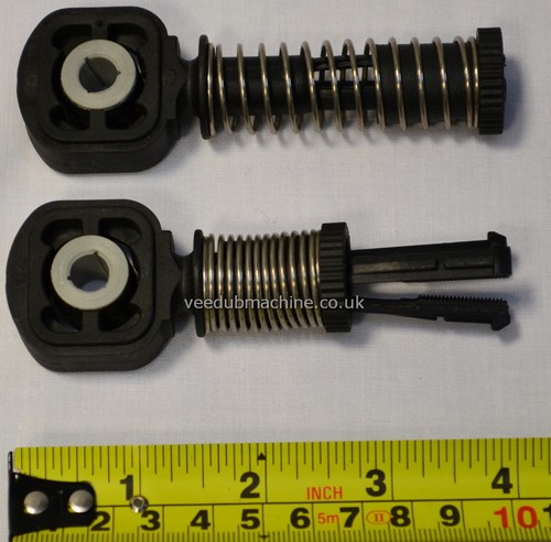

if the tt short shifter fit the mk4 golf (i know its a slightly bigger car) but it has the same engines and gearboxes, wouldt the tt one fit the mk4 beeza?
I don't think it would as the gearboxes are different than the Ibiza and probably also have the different types of connectors, same as the Leon.
Its the connectors that were different on mine. Ball and socket on mine and pin type on Golf/Leon/TT as far as I know.
Guys, really would like a shortshifter but have not the abilty to make it like in this tutorial.
Isn't it possible to change the connectorarms?
Like this:
So you take other shifter cable ends:
and a standard 5-speed VAG short shifter:
