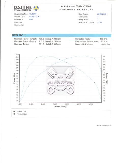

Well I finally managed to get the car on the rolling road after having ran a DPF delete and map for about 6k miles.
standard graph and video can been seen here, in my Progress thread...
http://www.seatcupra.net/forums/showthread.php?t=232990&page=2
Here is the DPF delete graph
and video
http://www.youtube.com/watch?v=Hf59_P197UY
Note the mass amount of exhaust smoke :p
Just want to get the mainland boy's thoughts on it as the car has been done here in Northern Ireland. How does this compare to other's and in particular the amount of smoke...?
The one thing which is stopping me getting DPF delete - the amount of smoke!!! :)

BHP Figure above is quite low compared to the rest of us running Milltek's but your torque figure is almost same as mine
I notice that in the graph the max bhp is at a lower rev range than the CC/JBS maps which may point out to the lower bhp figure?
any links to CC/JBS graphs? I should probably state now that i run a standard exhaust setup apart from the miltek downpipe but 15bhp would be a lot to gain from an exhaust.
Can anyone comment on the smoke? Seems to be quite a lot considering the power. Are the people running 230+bhp experiencing similar amounts of smoke or even less perhaps?
If you look in the JBS section under the thread (DPF Delete - Mild and wild) you will see most graphs.
I had mine done by them (Mild Map), came off the rollers at 222.8bhp and 342lbft torque. Standard exhaust.
Now have milltek exhaust and WILD map and feels faster so should be 230+bhp. never managed to get rolling roaded due to JBS's workload :(
Smoke i would say on mine is slightly less, not by much. On standard exhaust there was less smoke than yours
My graph: http://img683.imageshack.us/img683/2724/graphjz.jpg

cheers for the input guys! I had a look at your graph BIGG addicted, and i dont think max power is lower in the rev range. It's at 4201rpm and yours is at 4120rpm :confused:
Its hard to compare my 2 graphs as standard one reads just past 4000rpm but DPF delete goes on past 4500rpm but it seems like i dont hold the torque for as long as i did when standard. Is this normal?
Your spot on bud, apologies. Yeh i noticed your torque drops off a bit but will be the nature of the graph, JBS say the very aggresive throttle response on there maps is needed to get the big BHP figures, but 215bhp is still a lot compared to satdard!:)
I keep seeing this aggressive throttle response crop up and i can honestly say i dont think i have that at all... Maybe I do and don't realise? But from what i remember, it just seems to be the same as when the car was standard, only with more power now...
Maybe since mine is less aggressive, that's why I am seeing the far better than standard fuel economy??
it rolled 185.9bhp standard so i've still got a gain of nearly 30bhp but it would be nice to have it sitting at at least the 230bhp mark :)
