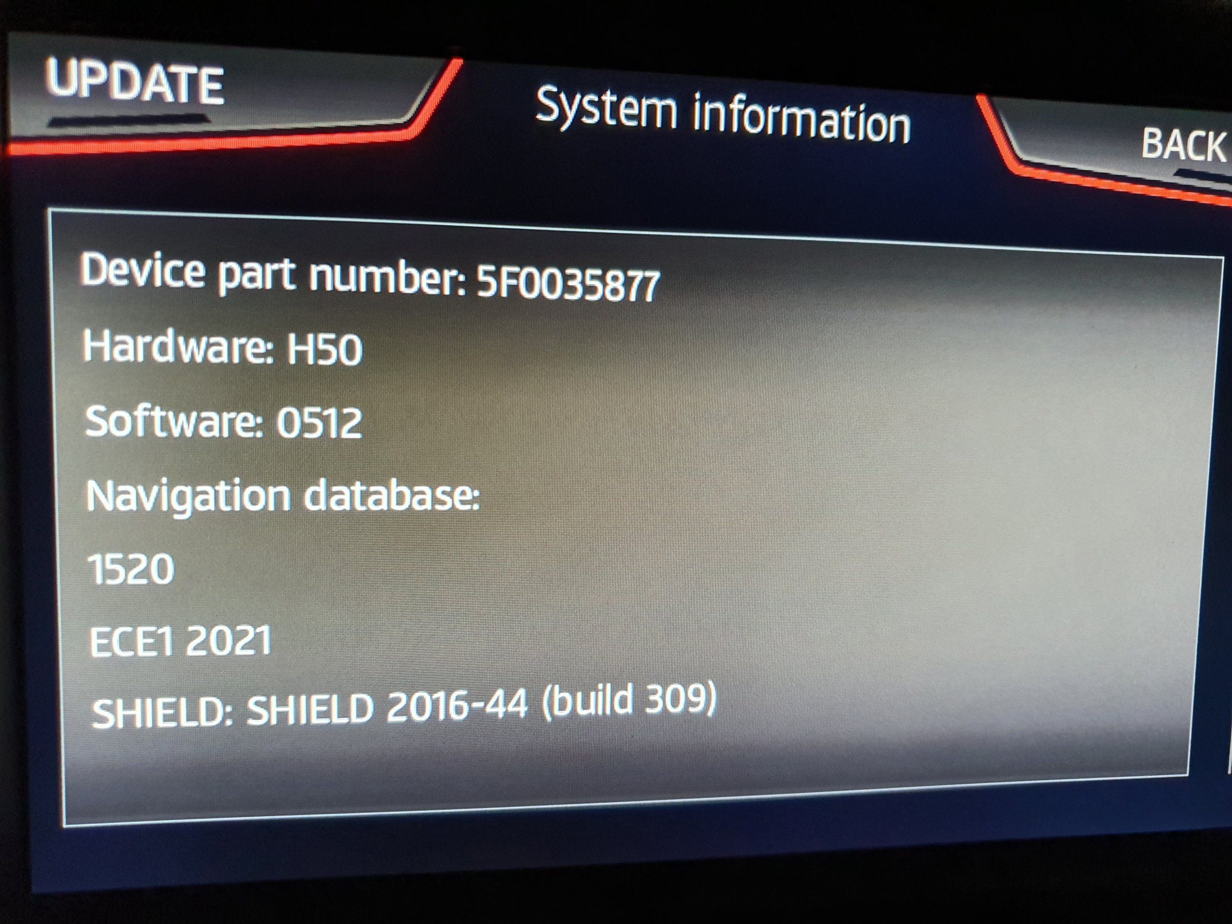

Hmm do you have the mib2 firmware 515, suspect so, if it's a number a few digits below (512 say) then you can upgrade to 515. Never done it myself since I have a high unit. That is said to fix Android Auto errors and is recommended for that. Sold for £20 by retrofitters up in Yorkshire via a link, they provide good notes. Think you may find it on those libraries referenced on the software thread although I haven't looked. It works similar to the mib2 high map update, keep the engine running to power up the infotainment unit without a break
Obdeleven tells you by module whether you have the latest software in the modules based on what it's seeing across users. That can be useful in keeping a tab on releases. I pass on how easy or not DIY activities in reprogramming units other than the infotainment unit. Feels a bit dangerous to me - had my original dealer do it when the motorised tailgate was shipped with a faulty control unit. The small incremental infotainment firmware releases is more straightforward for DIY activity but not always straightforward for those that are on very early releases, there are chain sequences you have to follow and you can't generally go backward. 512 -> 515 is fine.

Here's what I have. Is this upgrade going to void my warranty? I still got 2 good years on it.
What sort of problems did people have with android auto on 512?I'd only upgrade the firmware from 512 to 515 if you have a problem with Android Auto, failing that, no point. That's what it's suppose to sort out.
You could be on a sticky wicket with the dealer if it wrecked your infotainment unit and you asked them to sort it out. If it went without an issue you would be fine. Retrofitters sort out units after people mess them up with DIY activity.
I have 2 problems that show up rarely. 1 screen glitch, where all colors are inverted and hazy. 2 sometimes the system just restarts itself. But again these are rare problems
