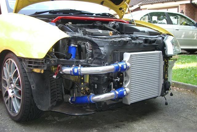

SEAT sport intercooler:
Allards intercooler:
Forge cooler:

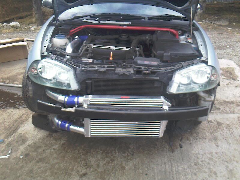

Alllards and Forge:
If I had to choose one, money being no option, I'd say SEAT sport. It's designed for the car by the manufacturers, it's cheapest, and it's biggest! (well, MUCH bigger than FORGE) and it's a lot better setup than Forge too....
And the SEAT sport needs no cutting of the crash bar, whereas the FORGE needs LOADS (very poor design) and Allards requires a bit and a lot of hard work.

I think the bloke that had my Forge intercooler before had a big turbo and was getting around 70 degree intake temps.....whereas now he has the Allards set up and doesn't see about 40.
The Forge inlet/outlet are too close to each other to start with, you have to cut away a lot of the crash bar, so if you have an accident it'll fold easily as the crashbar isn't working the way it should.
SEAT sport fits behind the crashbar and the inlet/outlet are further apart (which also makes it easier to fit the bumper. The forge setup - the pipes catch on the fog light housing slightly = BIG pain in the arse.)

TBH hhe forge intercooler looks to have not been thought through very well!!
Look how close the two pipes sit in relation to each other, soon as the air goes in it can come back out with no heat transfered unless the pipes are split by a baffle in the end tank?
I think the Forge model is a dual pass, so yes the air is forced all the way around the IC
