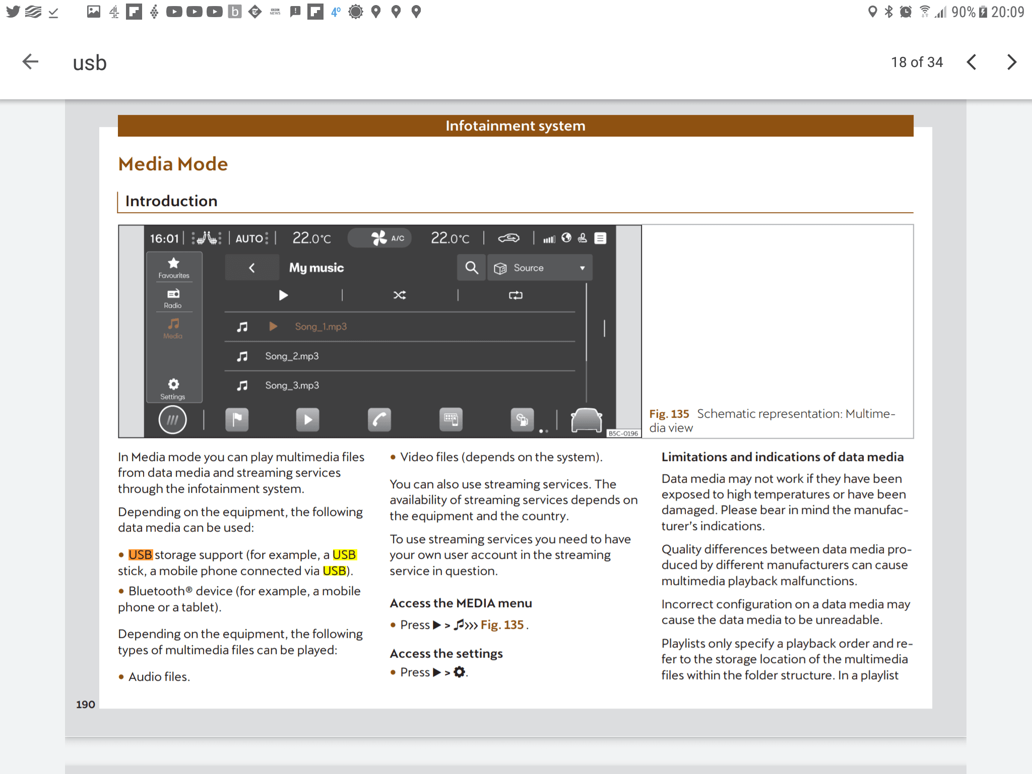

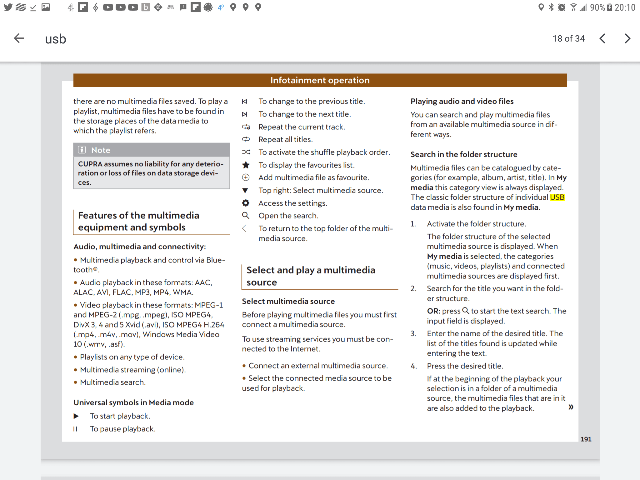

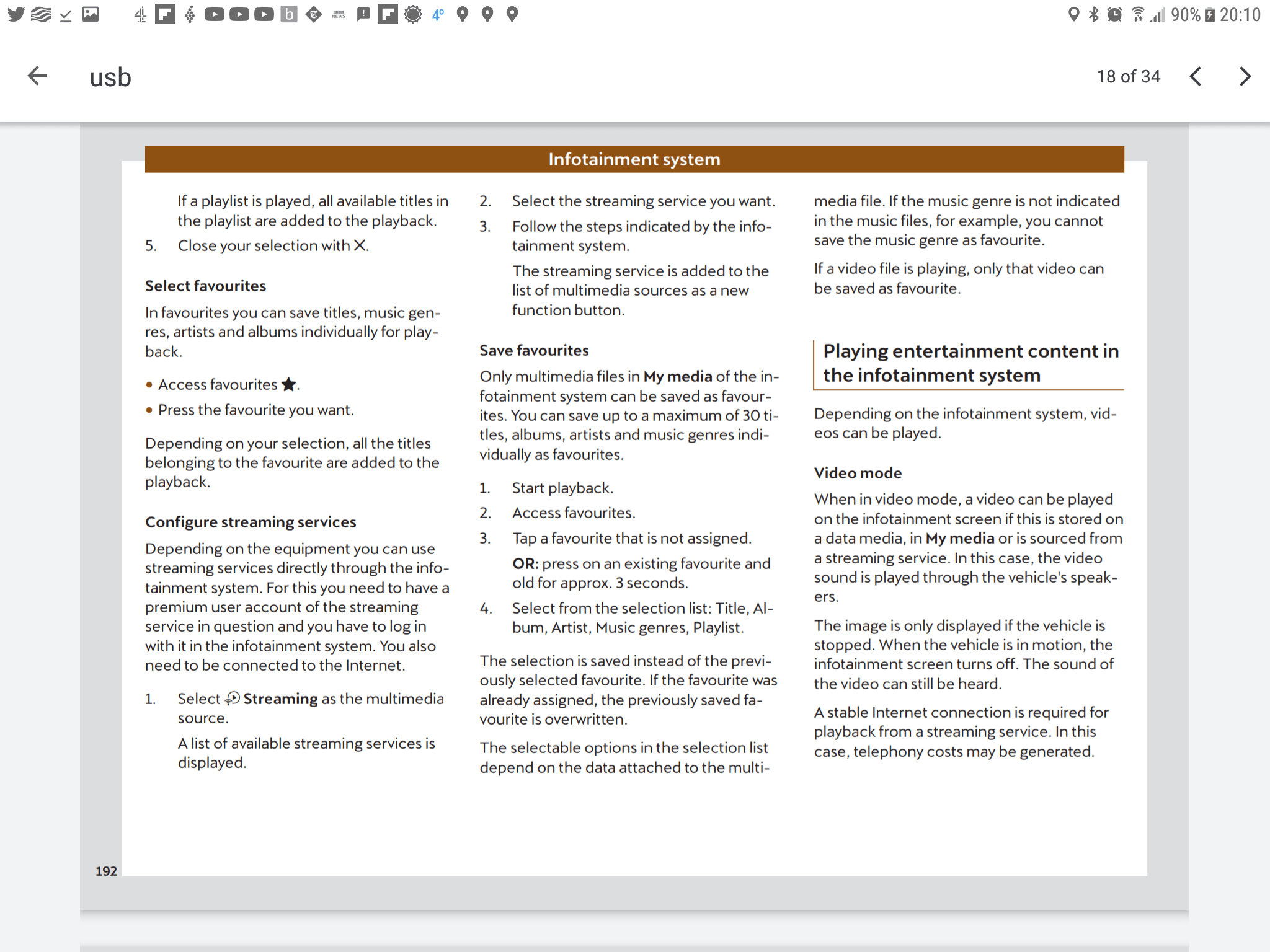

On usb format and playing pages from the Formentor manual where they are silent on restrictions of how many files you can have in sub directories etc unlike mib2 which suggests that constraint which was a programming one has gone with mib3. It manifested itself in mib2 by not showing those over the limit.
The mib2 limits were these:
– Playlists must not exceed 20 kB or more than 1000 entries.
– Filenames and paths that do not exceed 256 characters.
– For memory cards, a maximum of 4000 files and a maximum of 1000 files per directory.
Somebody with an enterprising mind can test that out by breaking the limit. I'm assuming that limit has gone since its not mentioned. Use to catch out people with big mp3 libraries. Anything over the file limit it would not see.
Formentor pages:
That's all the manual says..
