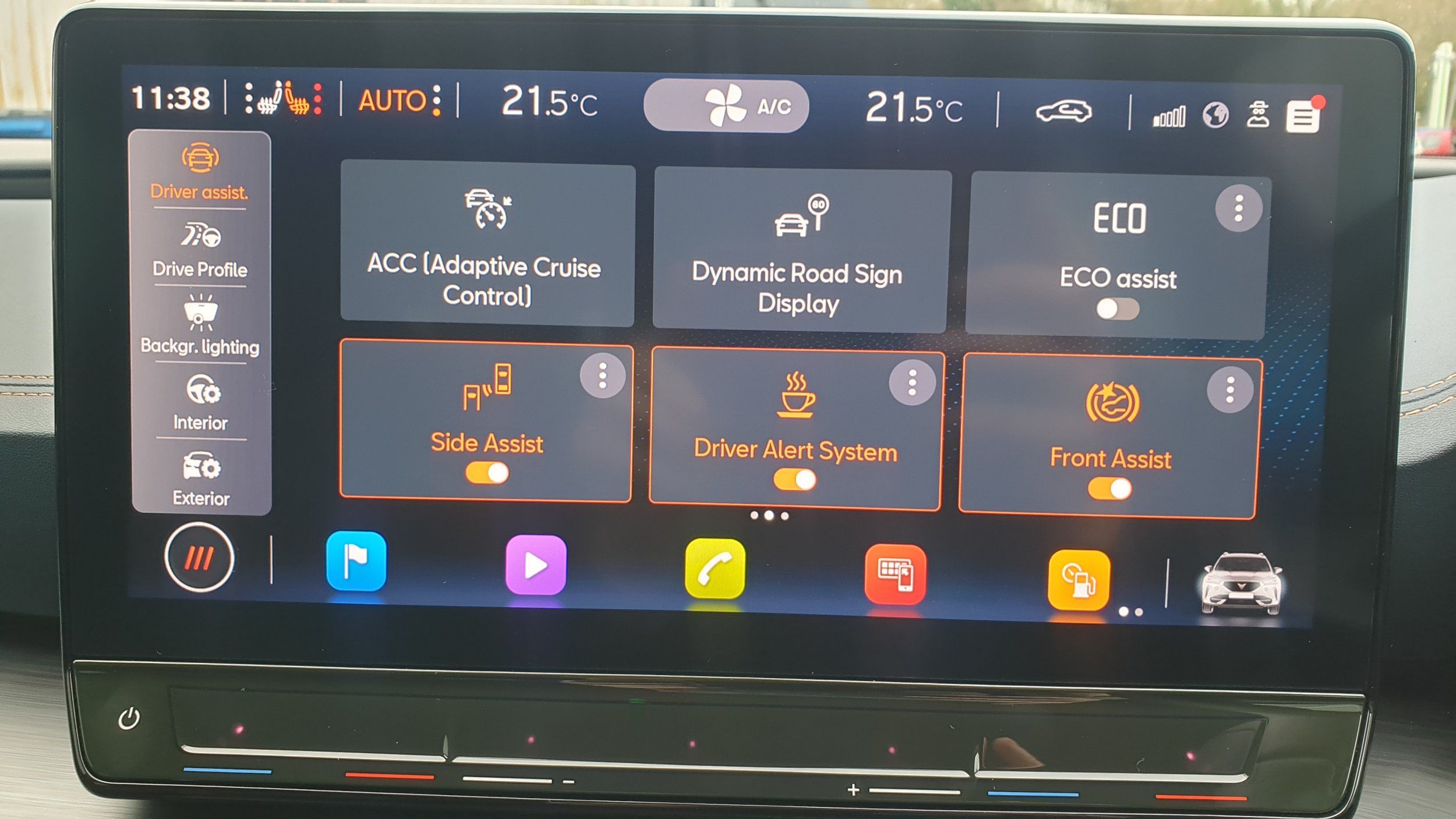

John Wick
May 12, 2022
138
68
New version of Infotainment, requires more clicking through options, than previous one. To switch off assitance annoyances, you have to click Car and then Smart Assitants. Only then, there's set of tiles with different functions and you have to scroll to the right. Previously, it was on the main screen, after clicking Car icon.
I don't see quick way to switching off all gadgets.
Older version.
Newer version.
https://www.seatcupra.net/forums/attachments/22918/
https://www.seatcupra.net/forums/attachments/22917/
Can anyone answer when you update from 1672 to 1896, does it change the display from the 'text' type display to the more visually appealing graphic display as shown above?
