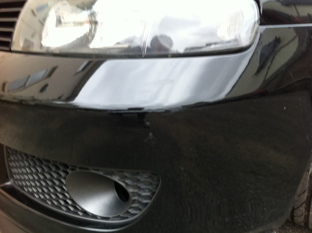

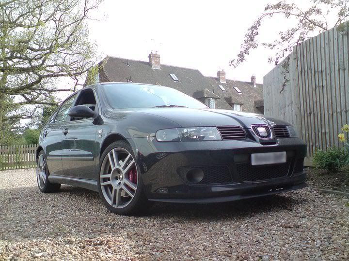

Heres the car when I first bought it. Already had the fog lights removed and a slight scratch on the front bumper (soon to be getting re-sprayed). I found out later on that she has a Blueflame system and a B&M quick shift stick.

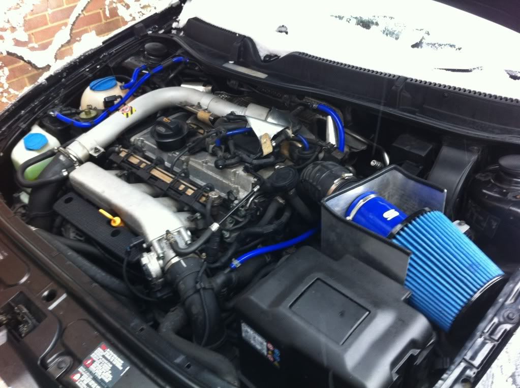

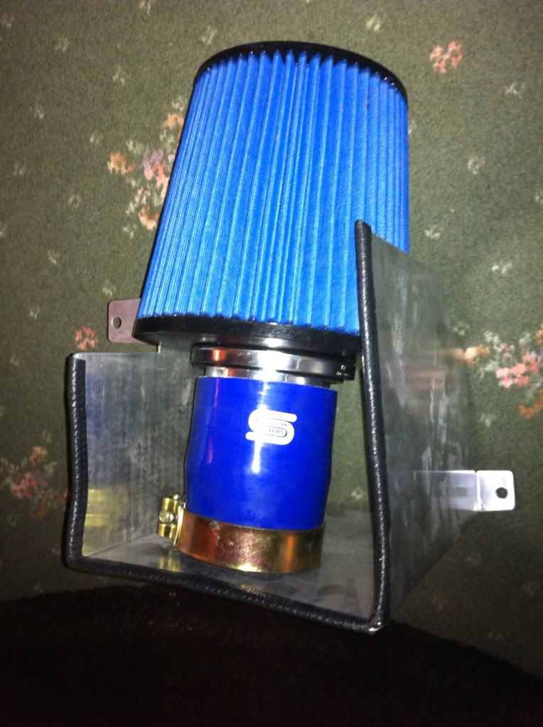

The next modification was to fit a JR open cone filter extended to the wing and custom heat shield. Was easy to fit, looks great and sounds even better! The car feels more responsive.
While fitting this I replaced some of the silicon hoses, which were a right pig to remove.

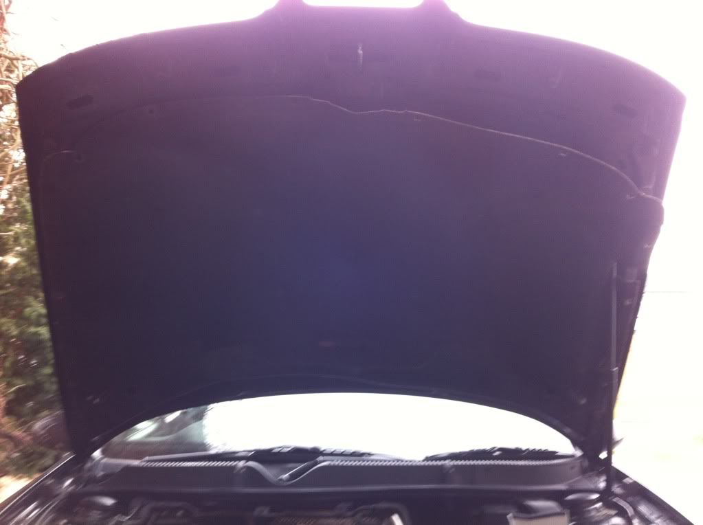

I also removed the sound deadening from underneath the bonnet to reduce heat soak.

Little thing here, you've removed the under bonnet lining, this will have the opposite affect to what you want as the heat shield is designed to press right up into it creating a seal.

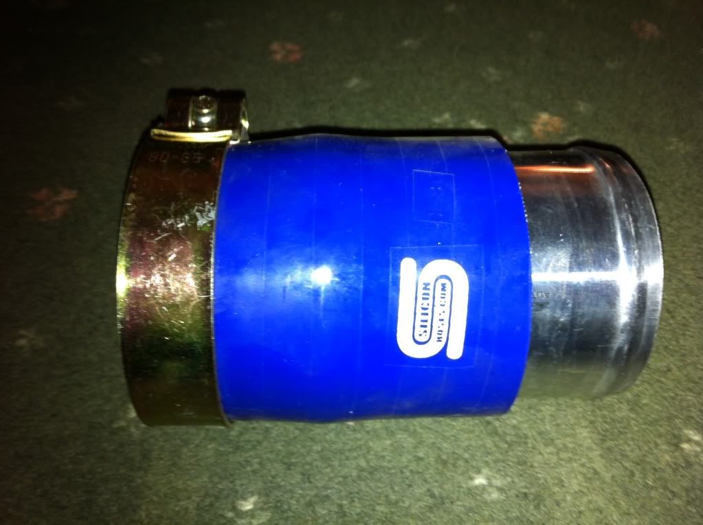

After that i went about fitting the badger 5 TIP. It was very easy to remove the old one, bit messy tho.
Had a bit of a problem fitting the new one. Needed a lot of trimming. The MAF end was too long with the heat shield i have and it caused a kink in the bottom curve and for it to pop off the billet at the turbo when i tightened it.
It is on and looks good however i will be trimming it at some point to get a better fit.
