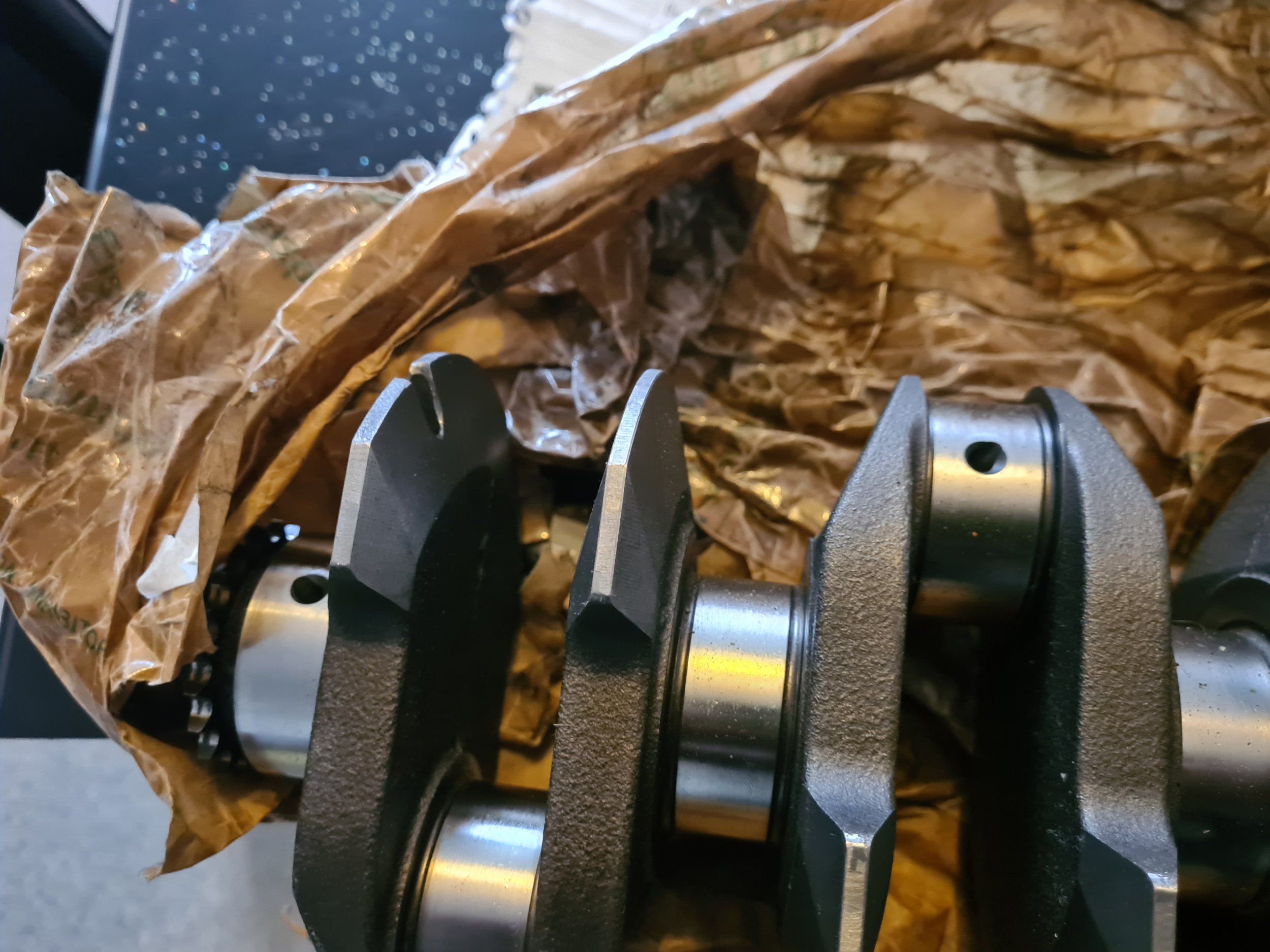

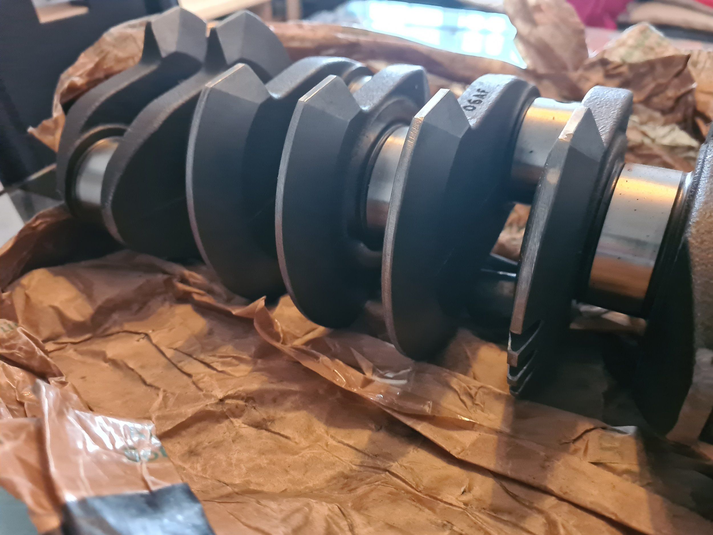

Right had a delivery today. The tfsi crank is back.....
It's been slightly dewebbed to reduce weight and rotating mass. Thus helps rev up and also to slow the engine down.
Also the remain of the Webb has been knife edged. This has many theoretical plus sides. Like it reduces drag threw the oil mist in the crank case. Some also say to help cut threw the oil on the sump( only if you over fill it tho ).
For me it was more weight lost and if any of them theory's are right it can only help. I can't really see it being and down side really
And it looks good
All the work was done bay larton engineering up in morcombe. Andy was really helpful and really really well priced. If you need any machining work done I would highly recommended him

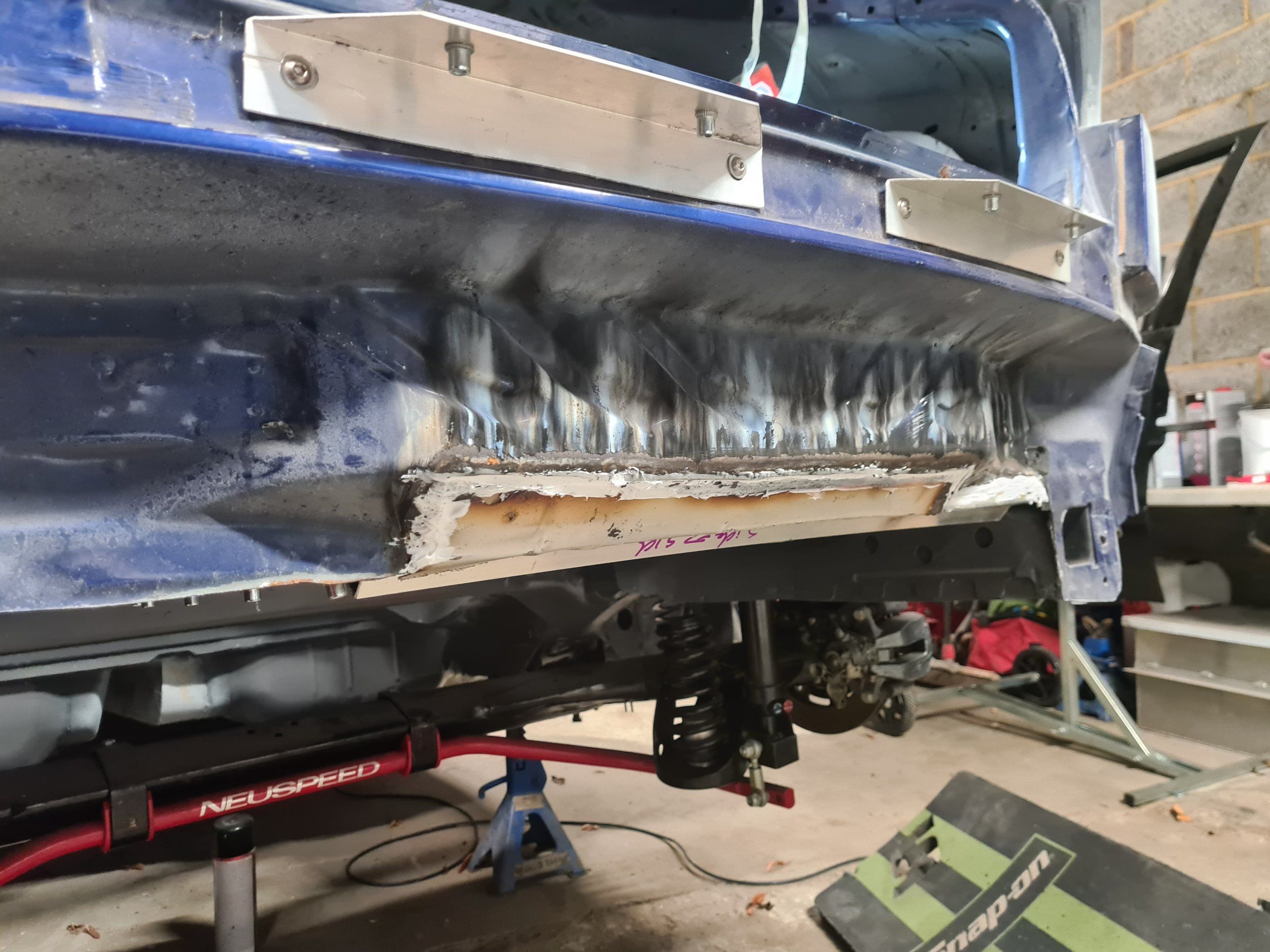

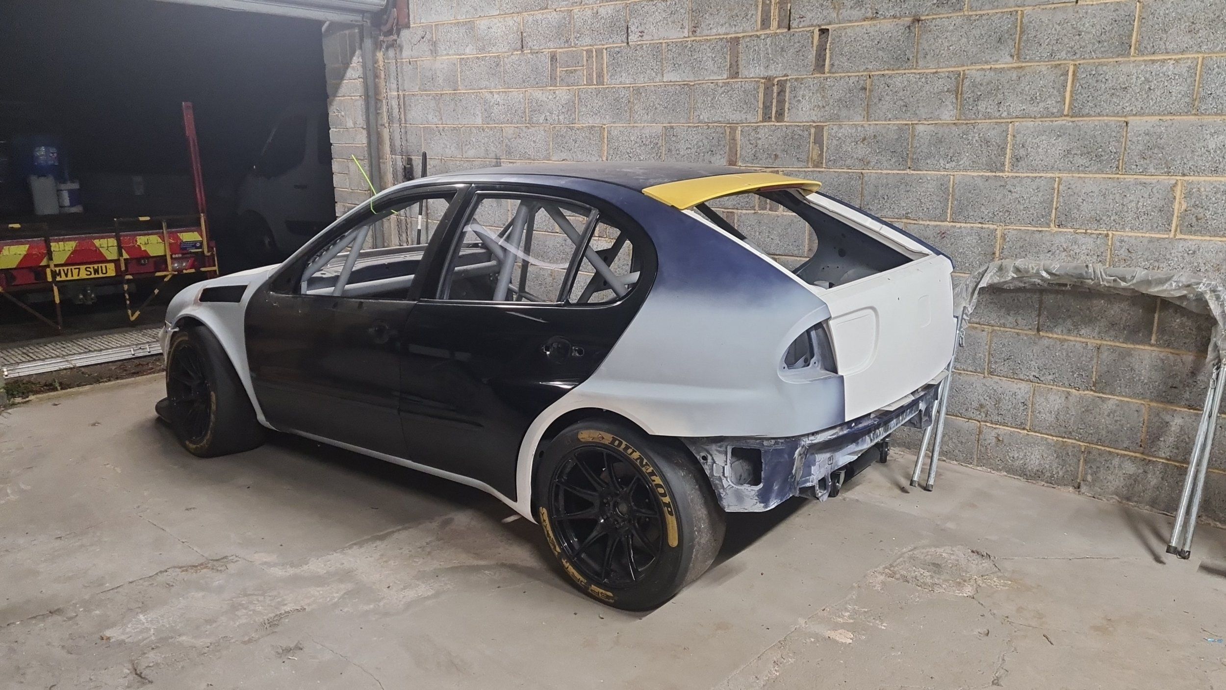

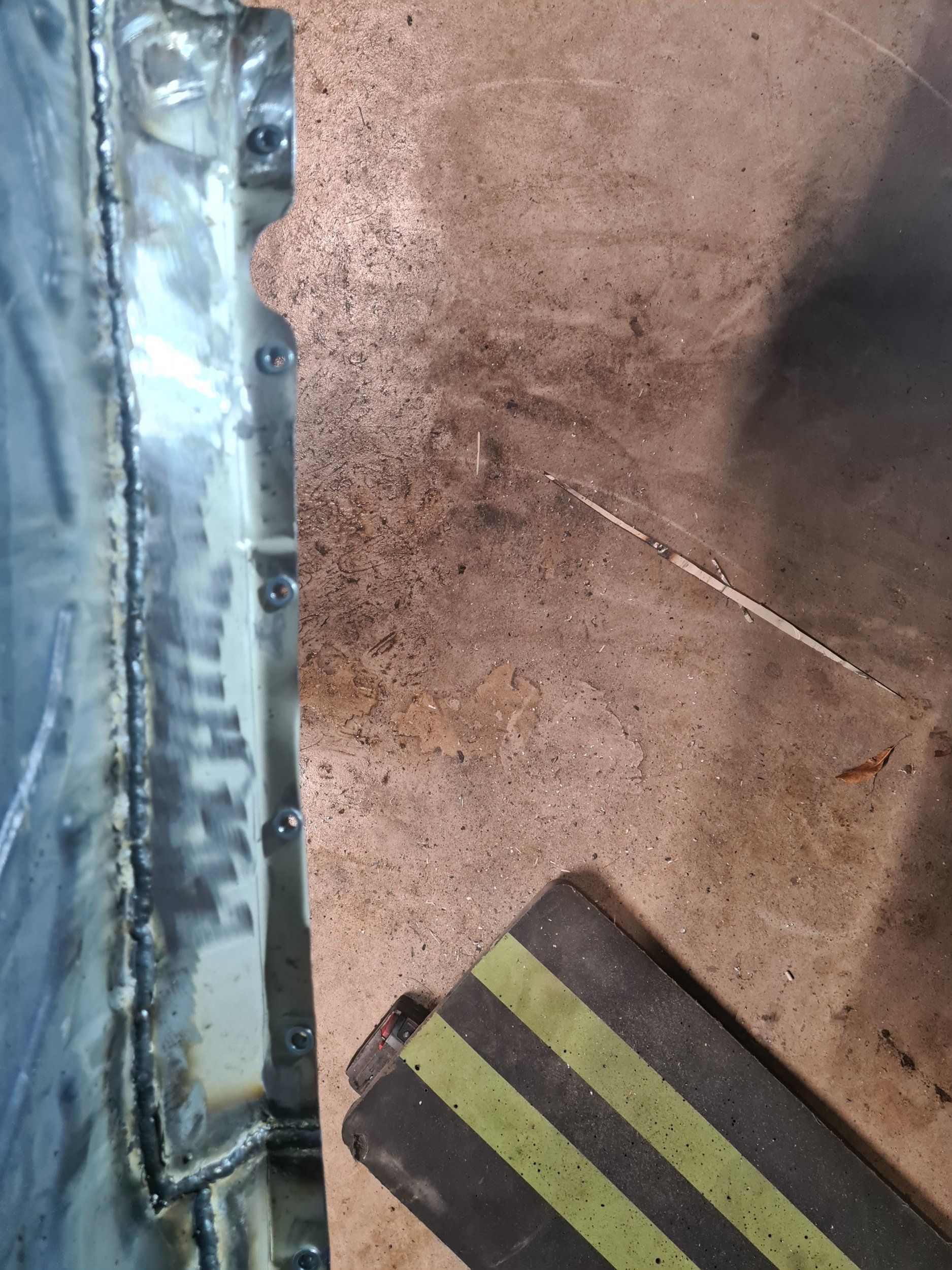

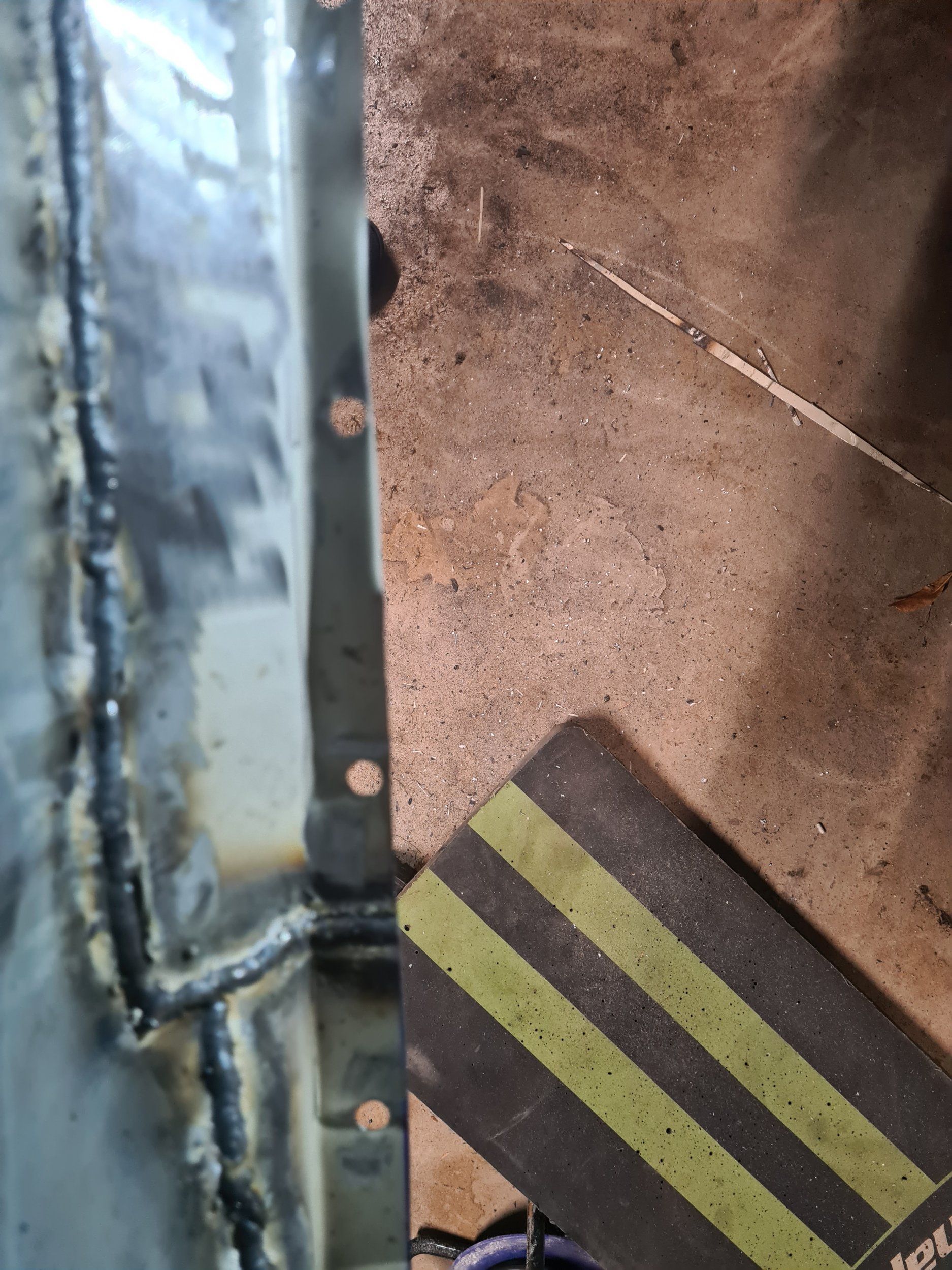

Had a little bit of time and managed to find a scrap leon so cut out a section of back panel and welded it in
Marked out and drilled some 9mm holes.. well center punched then 3mm then 9mm
Then fitted nutserts all the way alongthw folded edge.
Don't look at the welding... I couldn't find my mask so it was eyes closed and feeling withbmy finger as I welded

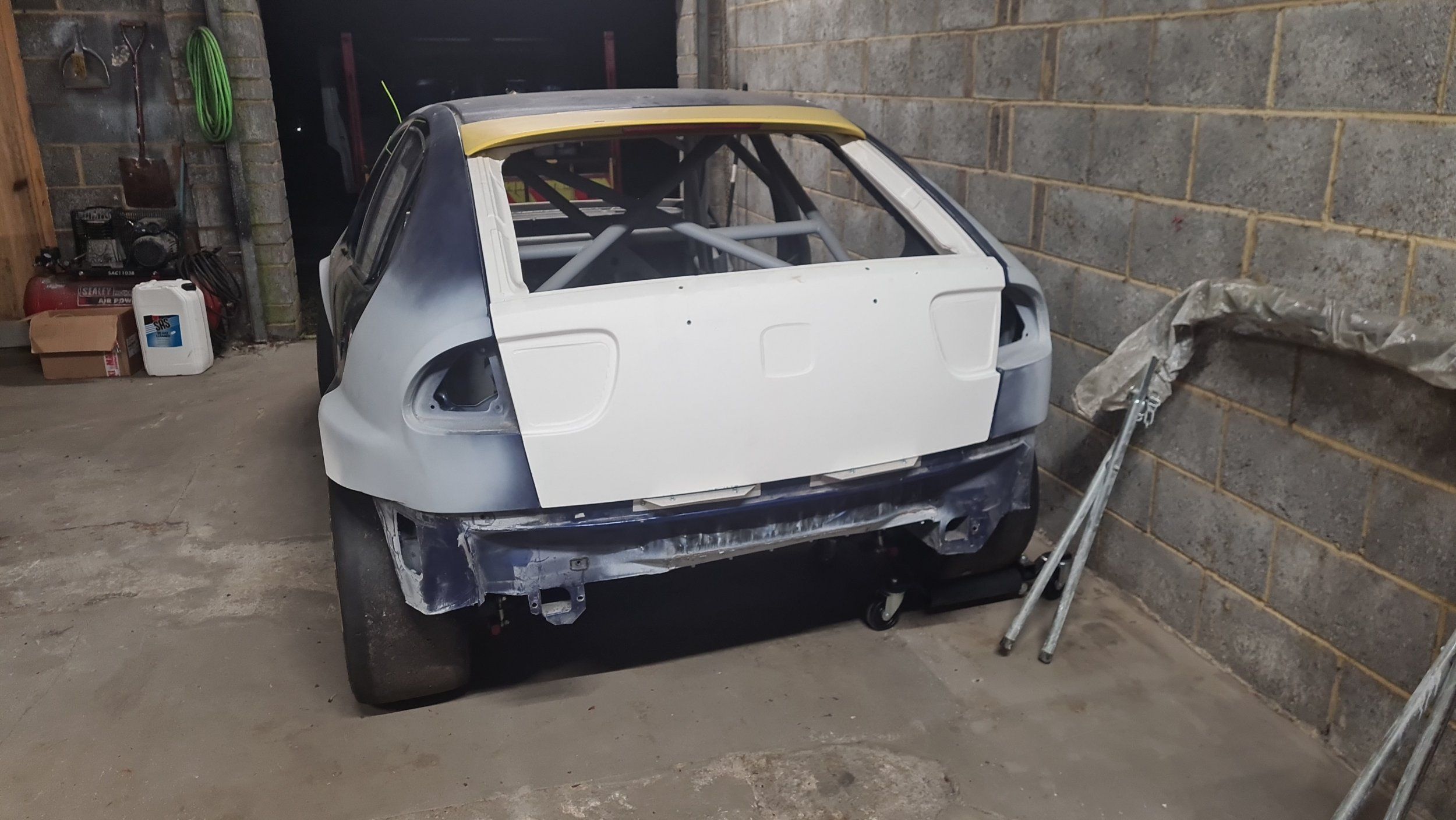

Andy way then a quick test fit of the carbon blank
Next up when health and time allows will be fit and cut rear bumper and defuser

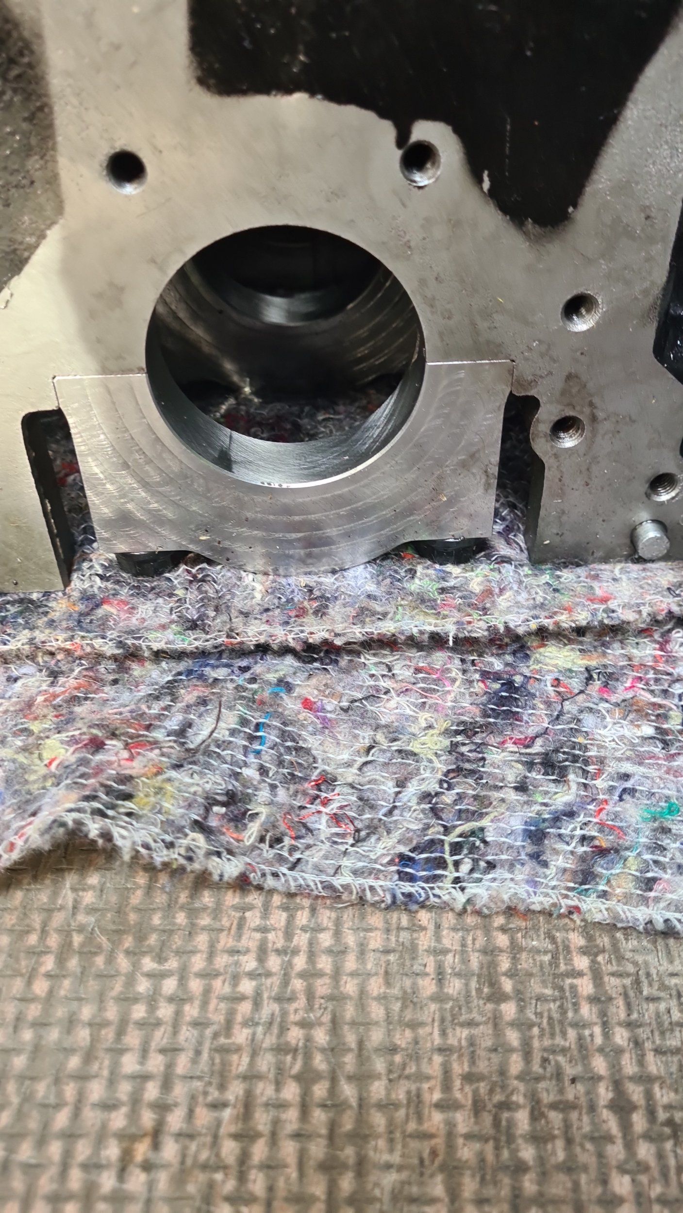

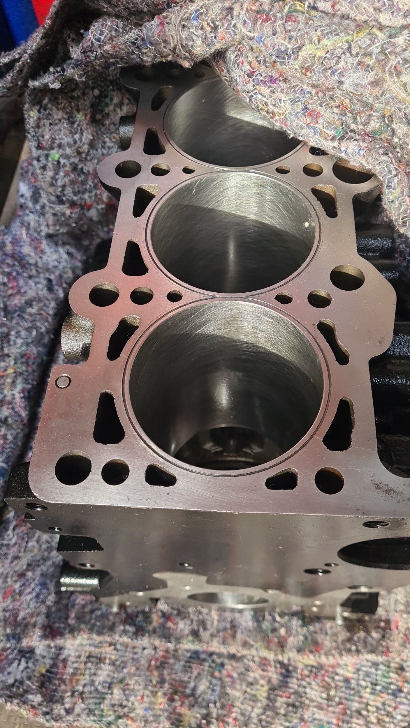

Also the block is back from pro race engineering. It has had billet main end caps fitted with arp stud conversion. Then line bored to suit the tfi 2.0 crank.
Then after a discussion with Stacey at PRE (pro race engineering) we thought to help it would be better to run liners. So the block was bored out then new liners pressed in Then bored and honed to suit the JE stroker pistons.
They have done some amazing work. Have a look threw thier Web site.
They will do any thing from your annual service items up to 1400bhp drag race equipment.

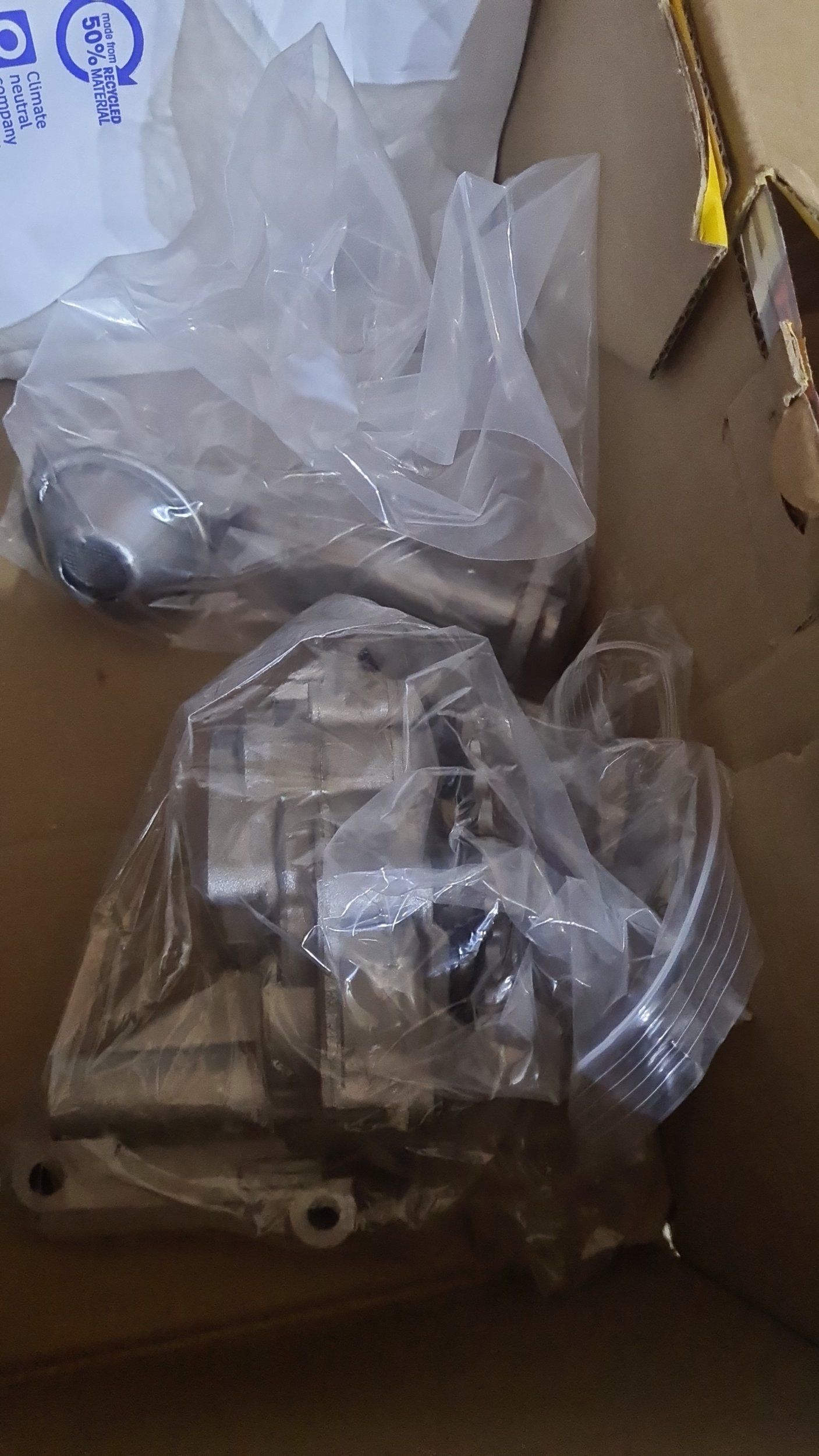

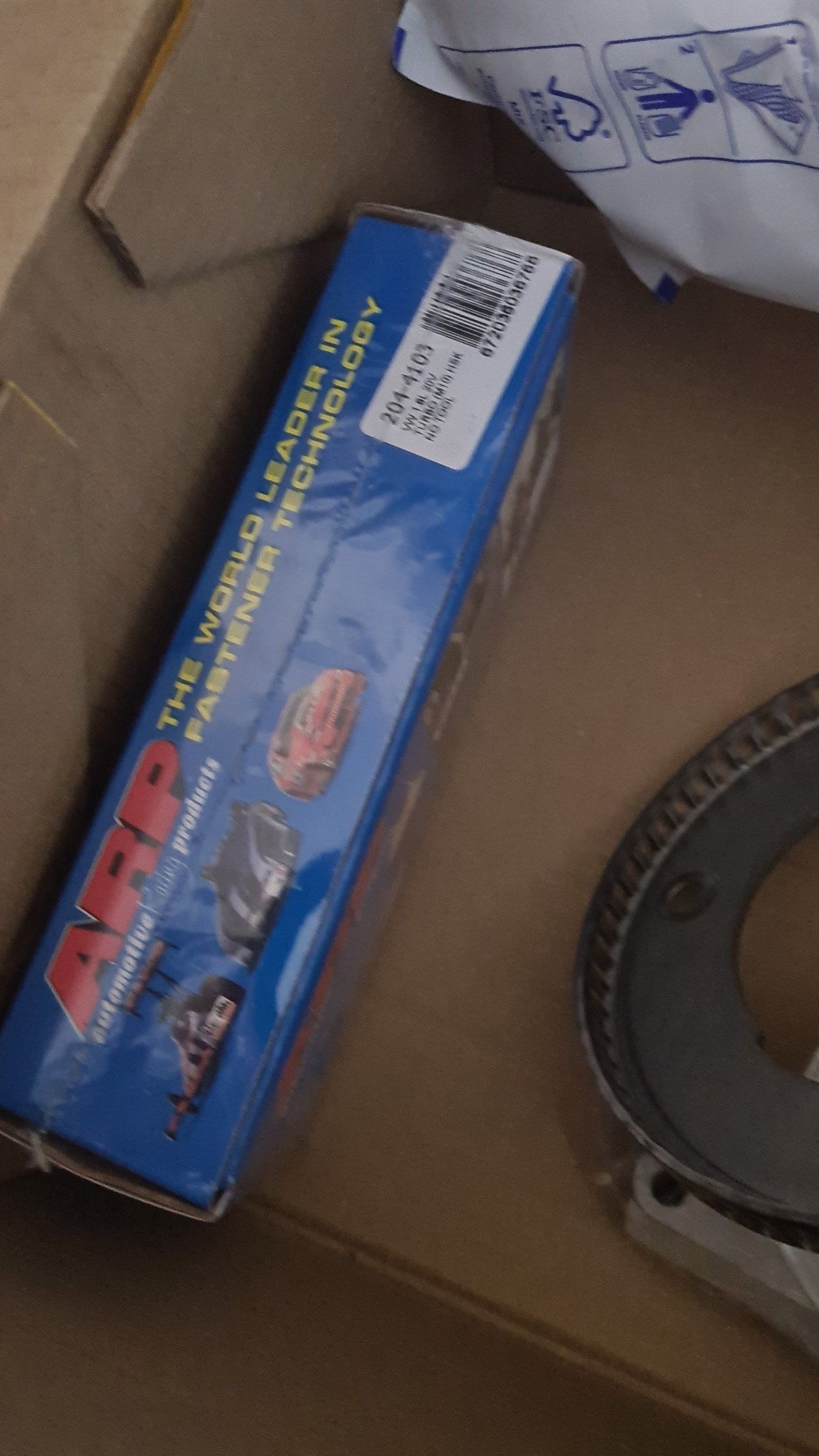

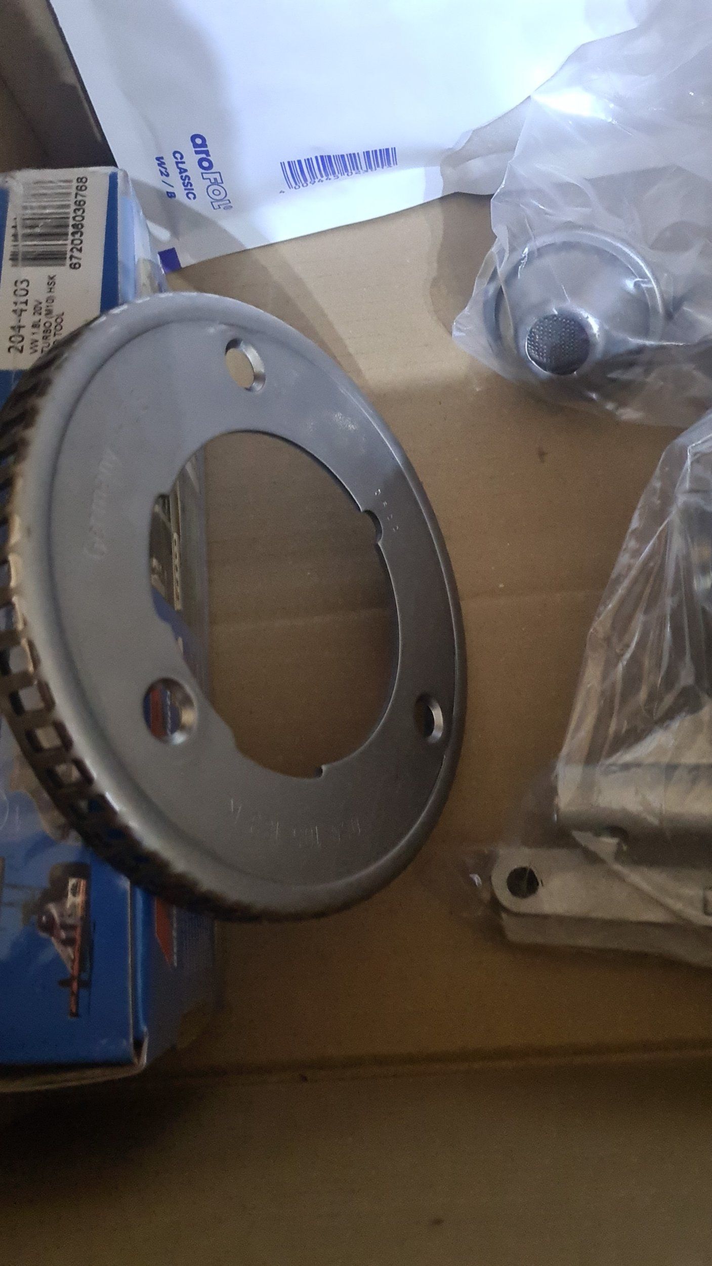

Will do better pictures when I get home. But. Delivered is my new high volume oil pump
A new trigger wheel to go on to the tfsi crank
And an ARP head stud kit as well.
