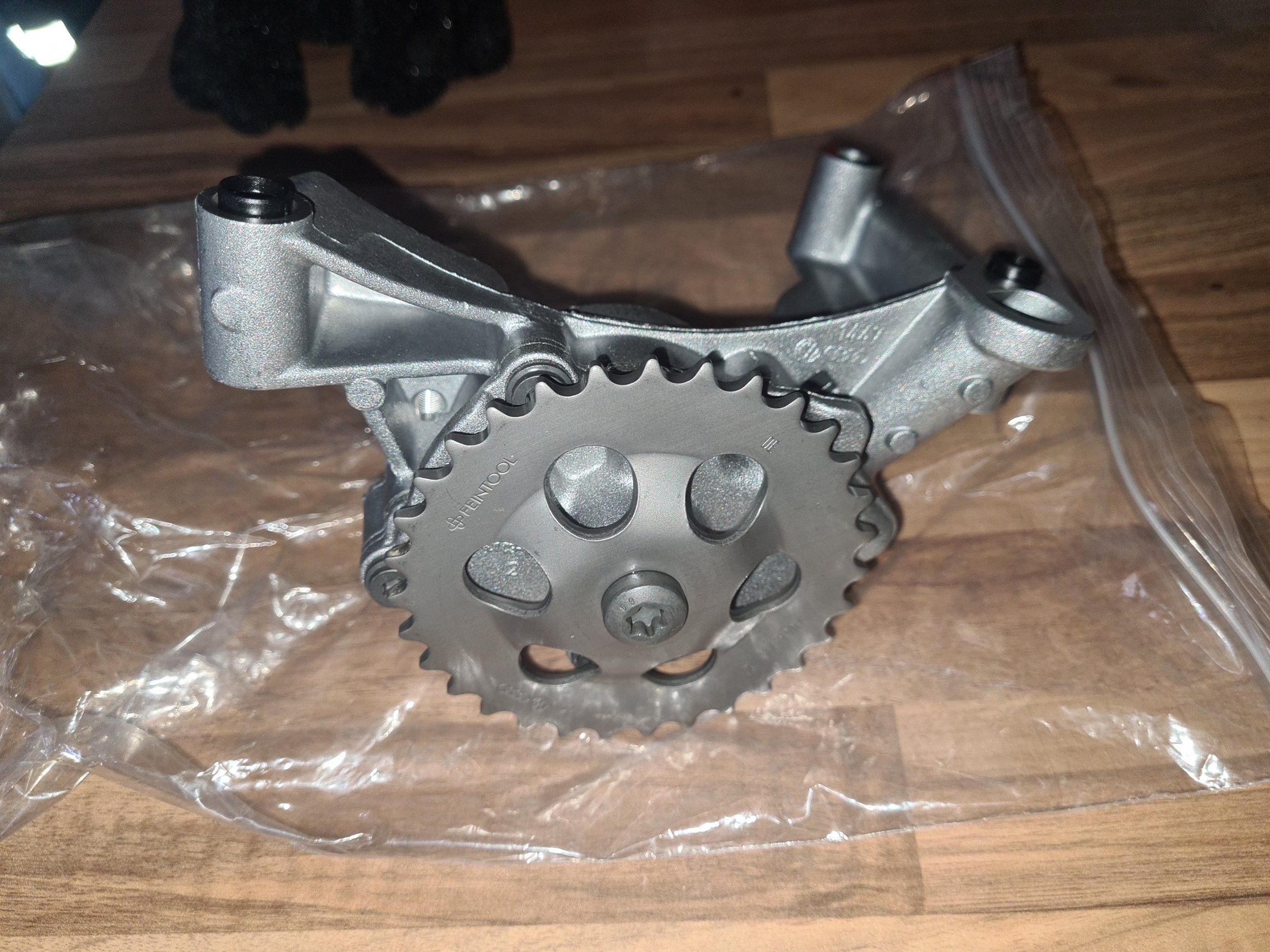

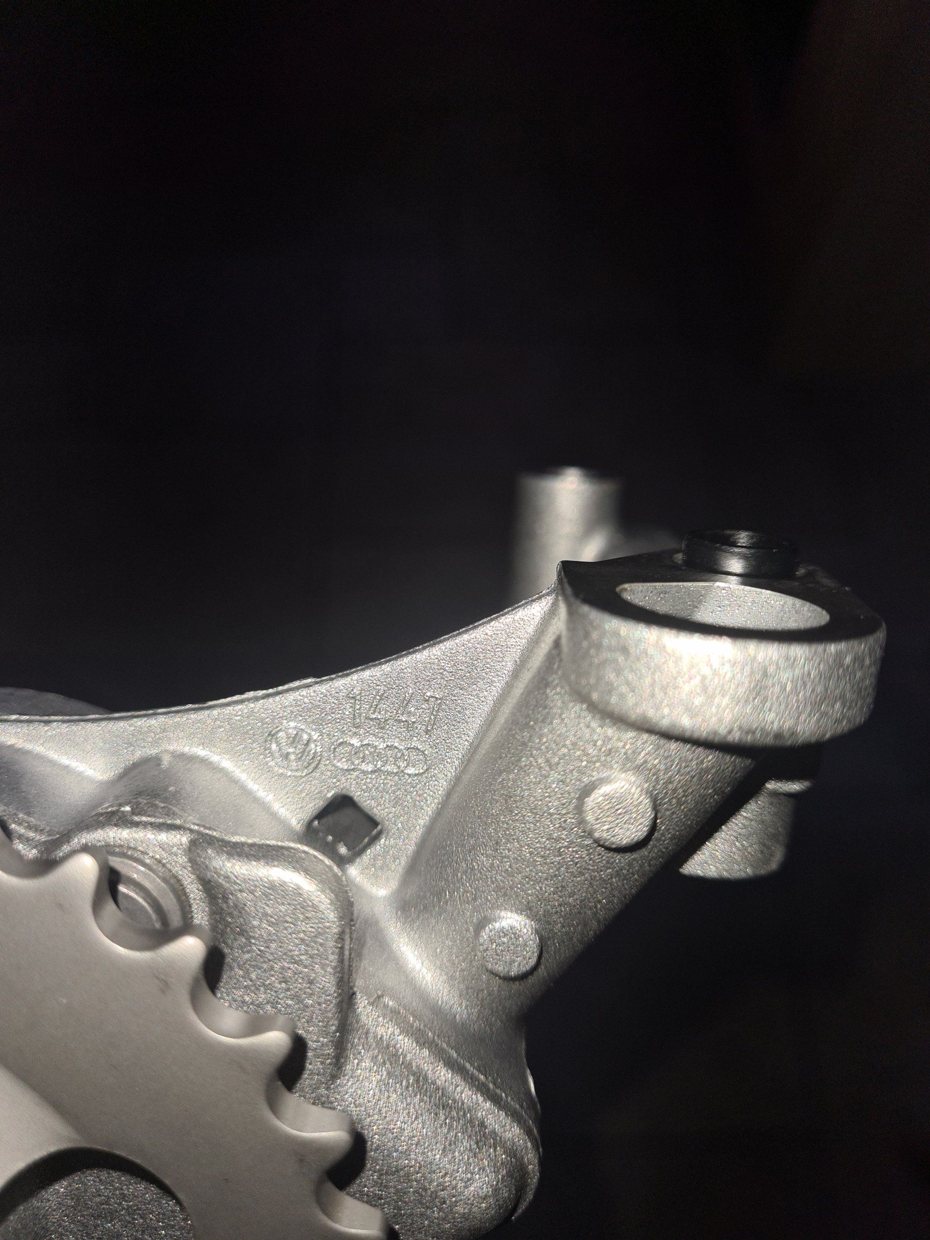

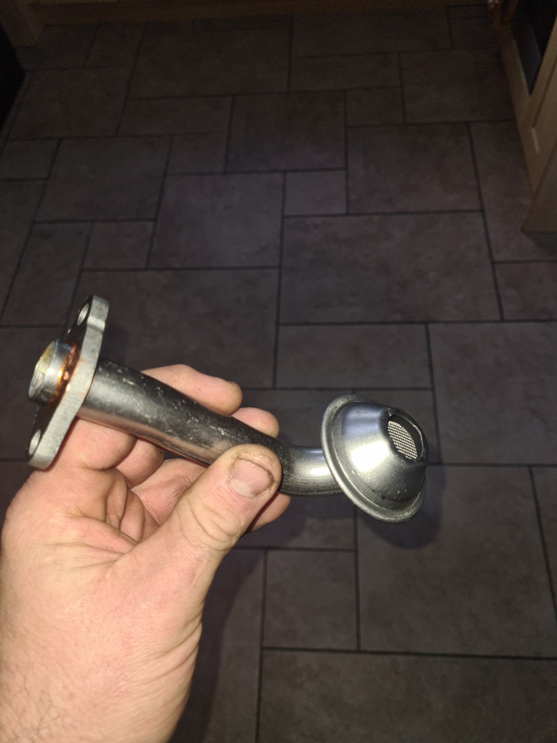

As promised some more pictures. So first of is the high flow pump.
this is a genuine audi vw seat etc etc part. But with extensive testing by PRE they discovered the different flow rates form loads and loads of oil pumps.
I can't remember the rate but it's about 25% over standard 1.8t pumps. Plus brand new strainer

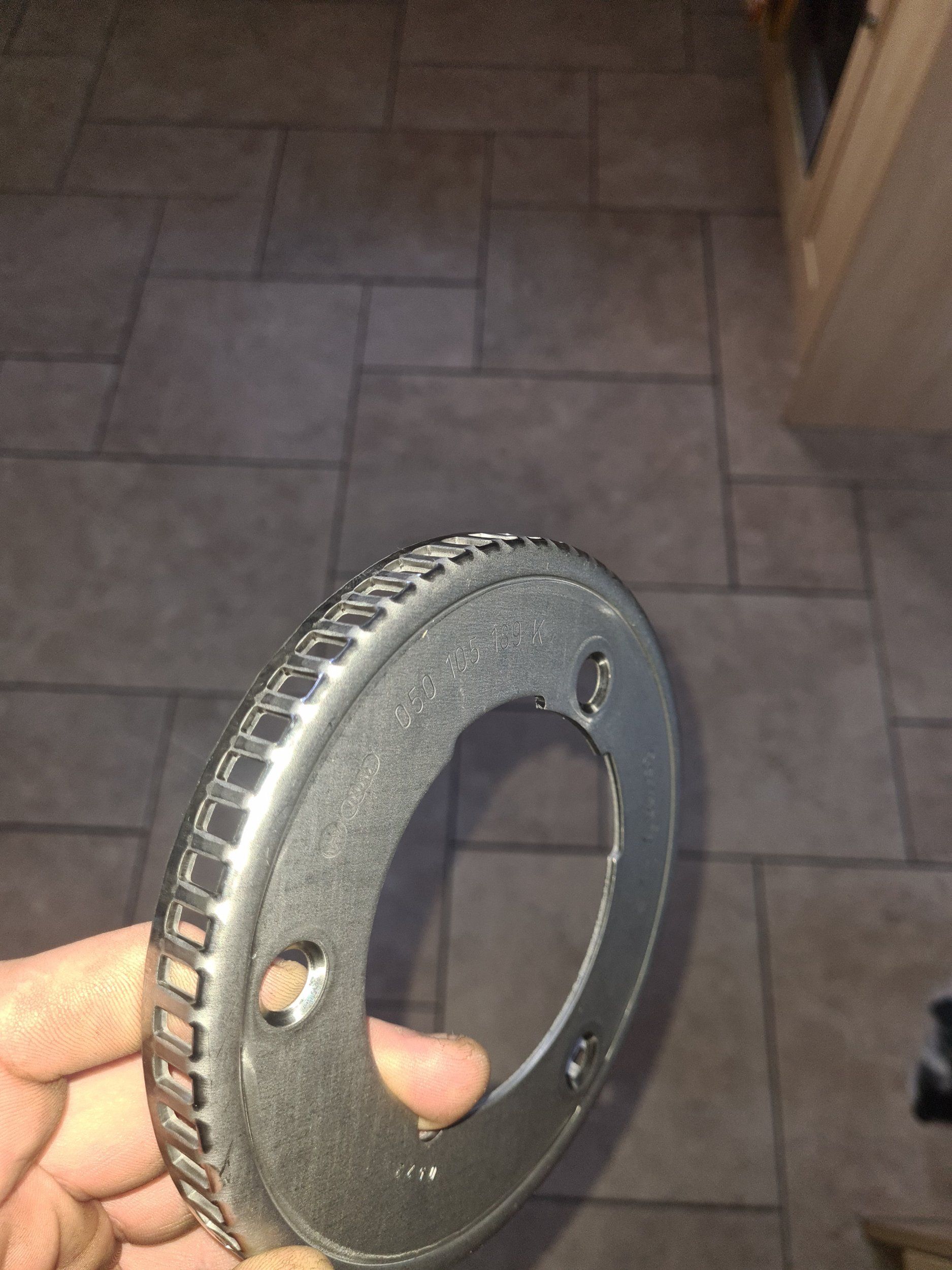

As well all seen befor a new trigger wheel.
I felt best off new one with the build so new wheel and screws.

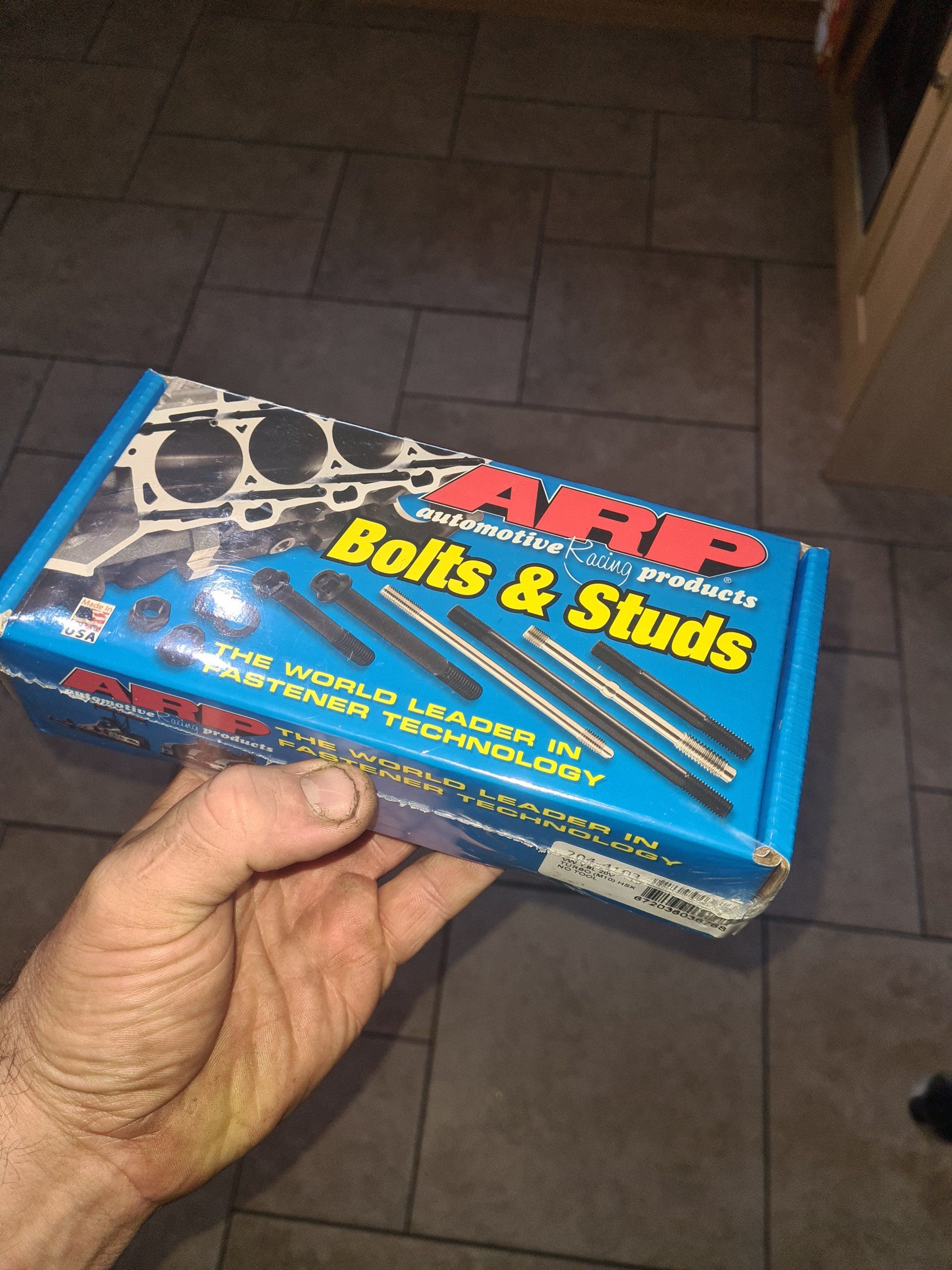

And last of all is the ARP head stud conversion. I will show pics of the studs when I open the packet in the next couple of weeks.

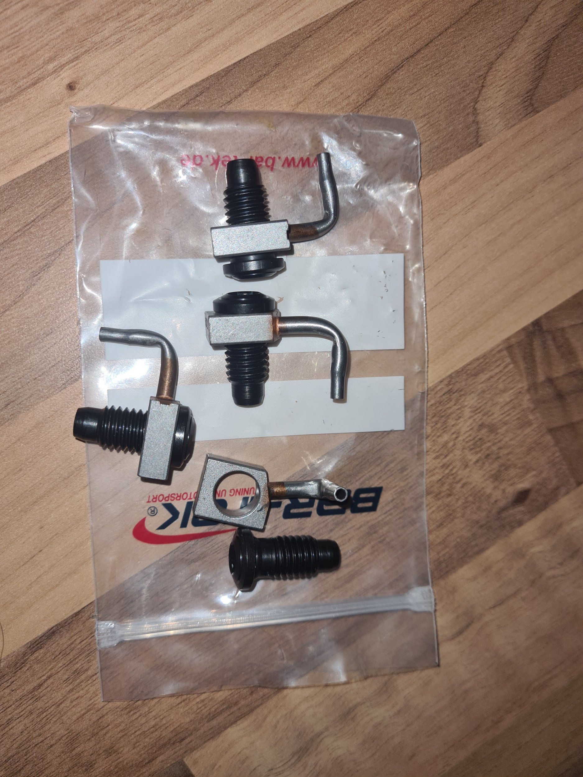

High flow oil squirters, also they are designed for the stroker set up so they miss the corroded.

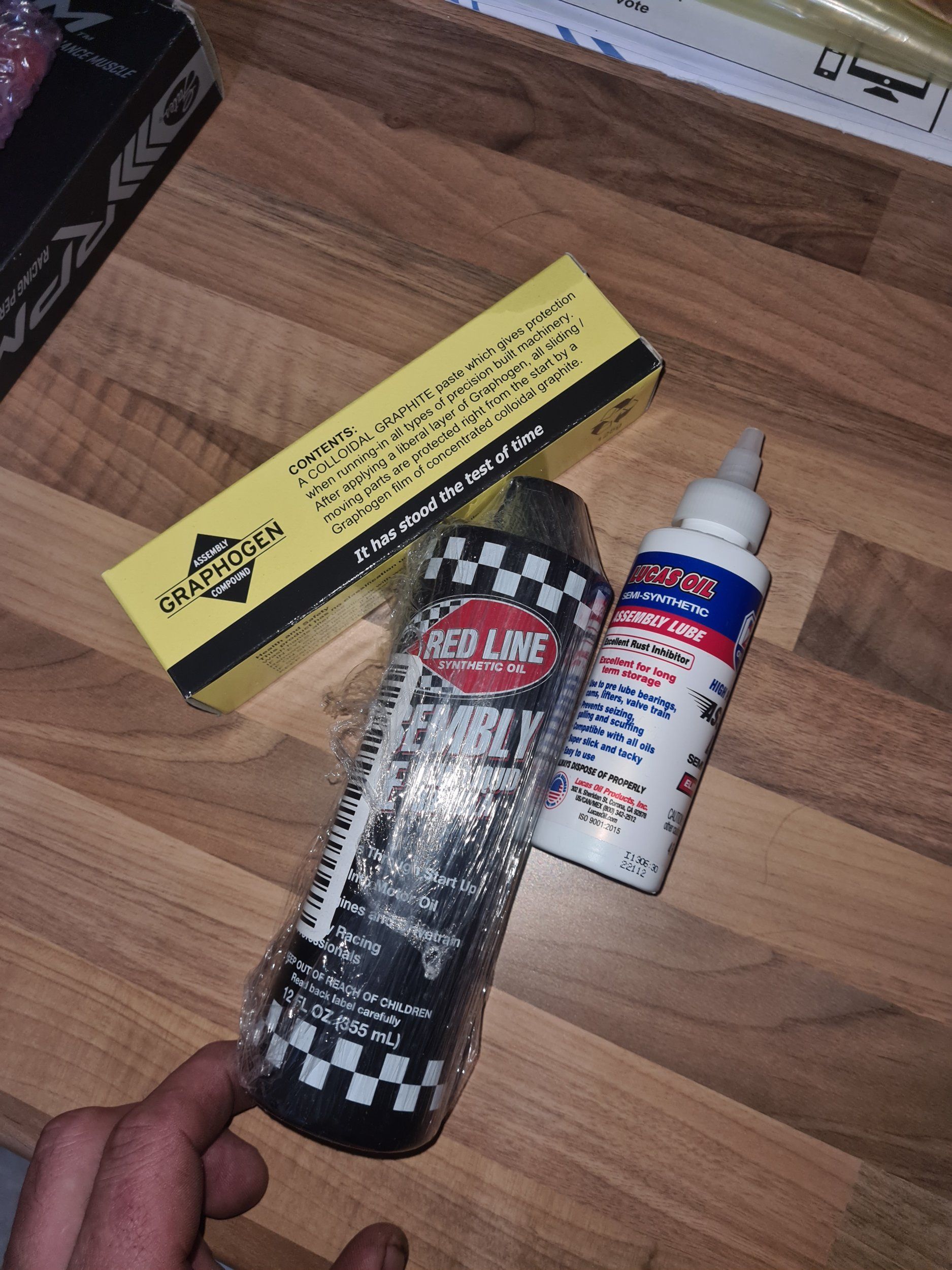

And then the start of a loads of building oils and stuff

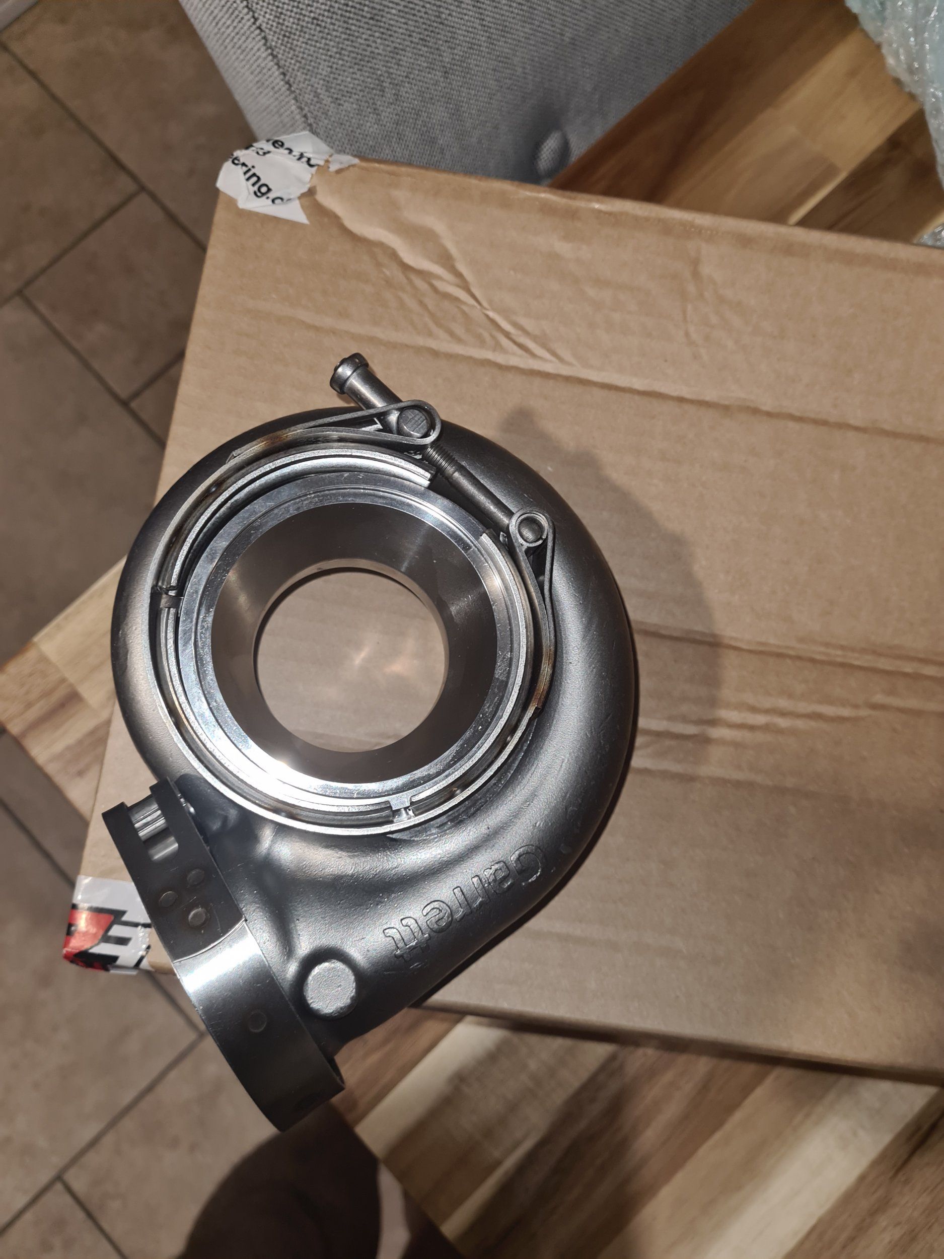

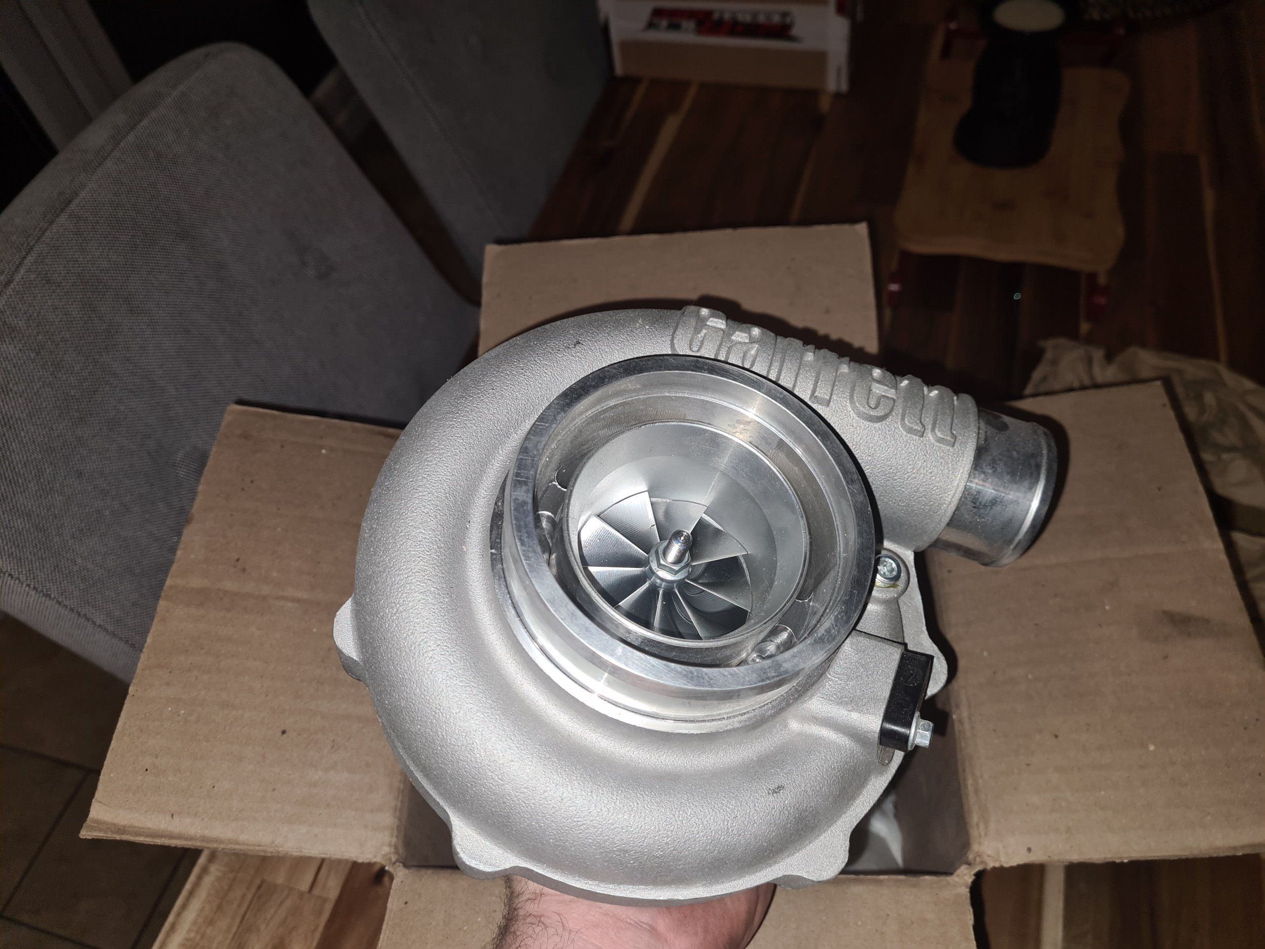

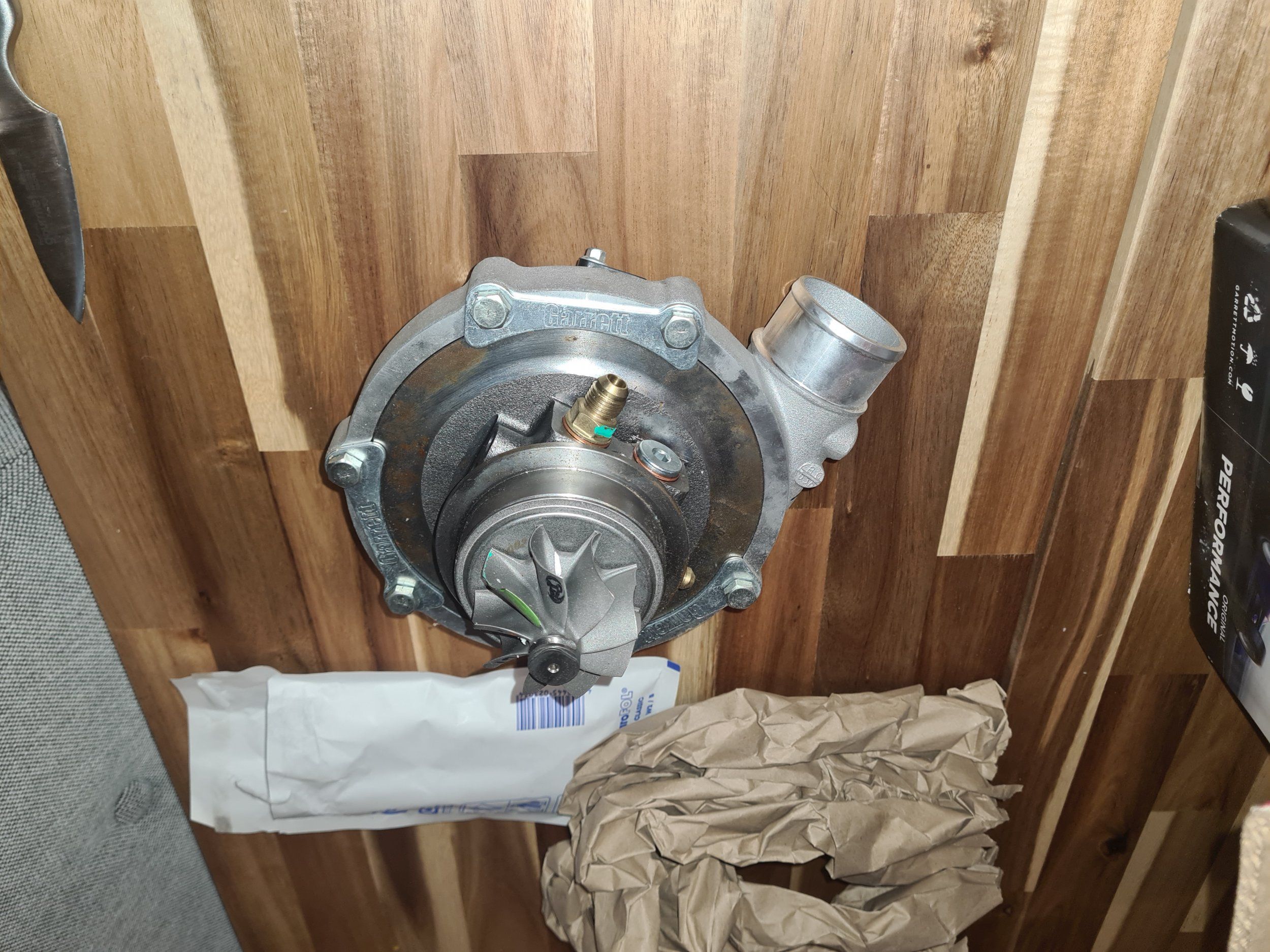

Is a big turbo. A garett g30-770
Lovely casting and machining . Attention to Details like oil feed and water cooling. Etc. .
In the other box.

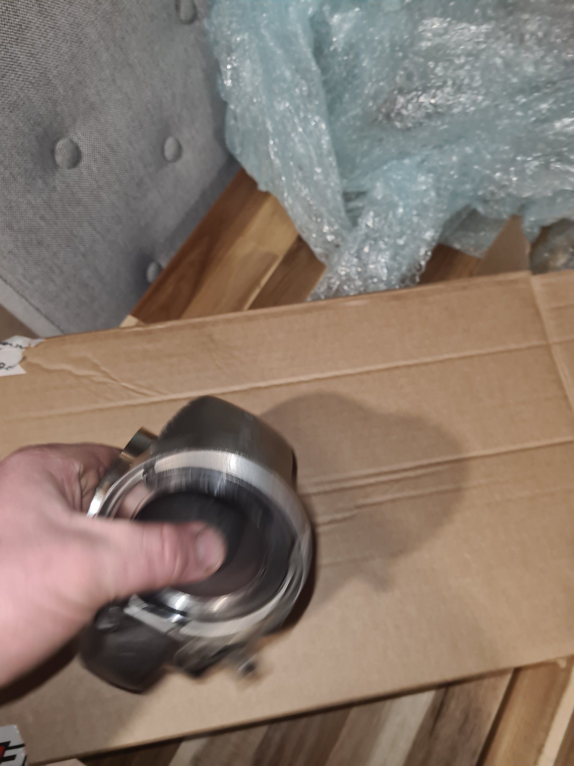

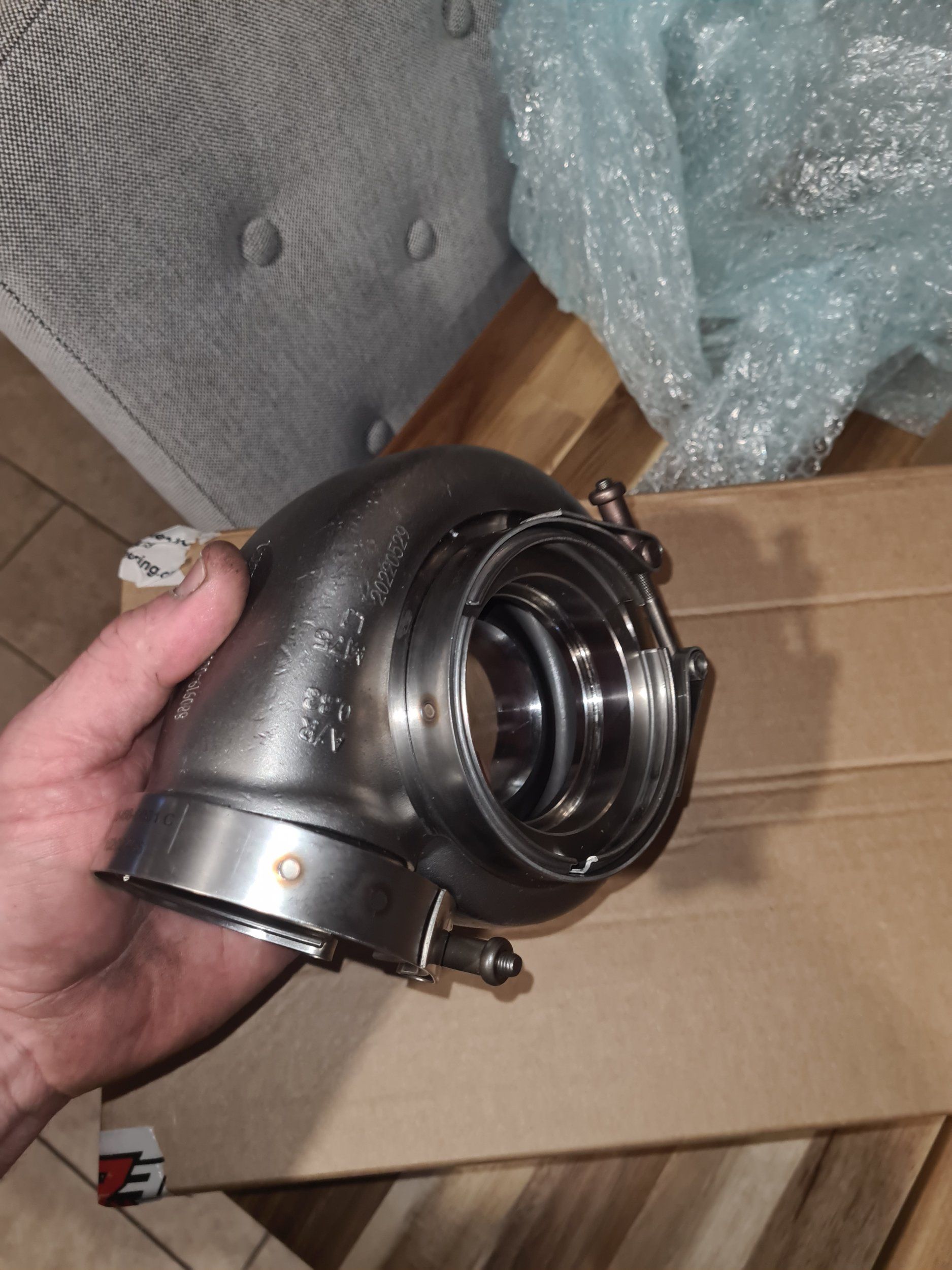

The hot side turbine housing
Quite heavy but all v bands and ready to be put together . More parts on the way. But Christmas is comming so hopefully a bit of time off work so I can do a but and share with you all.
Now thinking of sending off the hot side housing and a manifold when I find one I want to get zirotec ( think its called that )coated to stop heat from escaping .
What manifolds do people recommend. And not recommend. What horror stories has there been
Zircotec is a good call if funds permit it and seeing as this is a race car it'll be under continuous load so its going to do its job.
Nortech is the way to to go with manifolds and downpipes on G series turbos on these cars, it's what I have on mine as well.

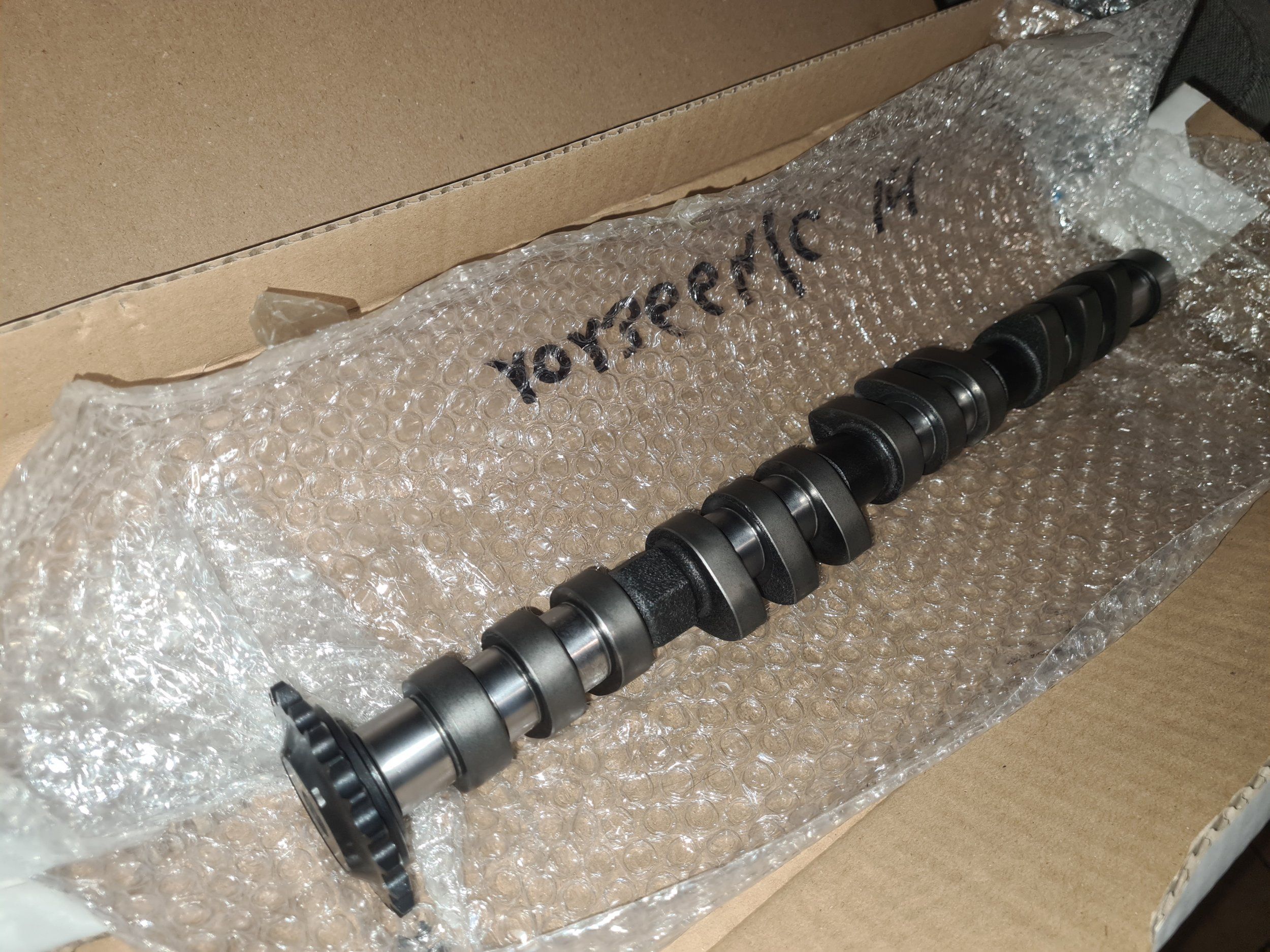

Looky looky. More parts from pro race engineering.
who can guess what it might be

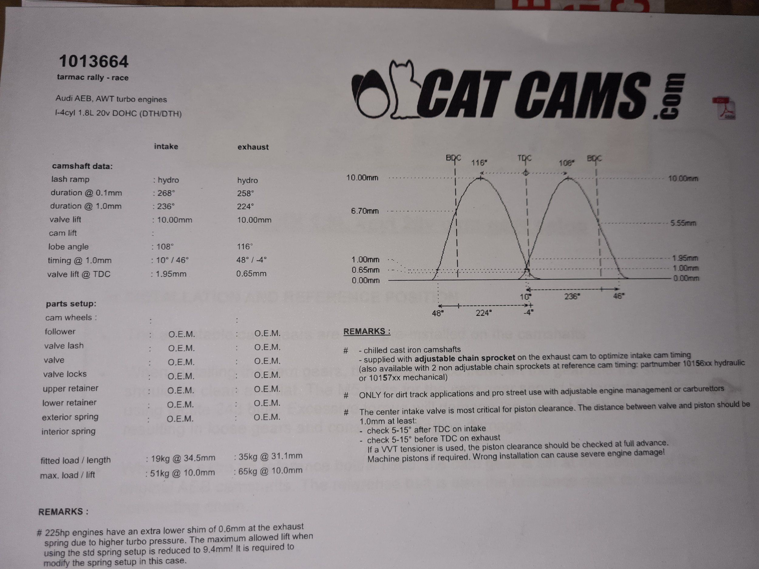

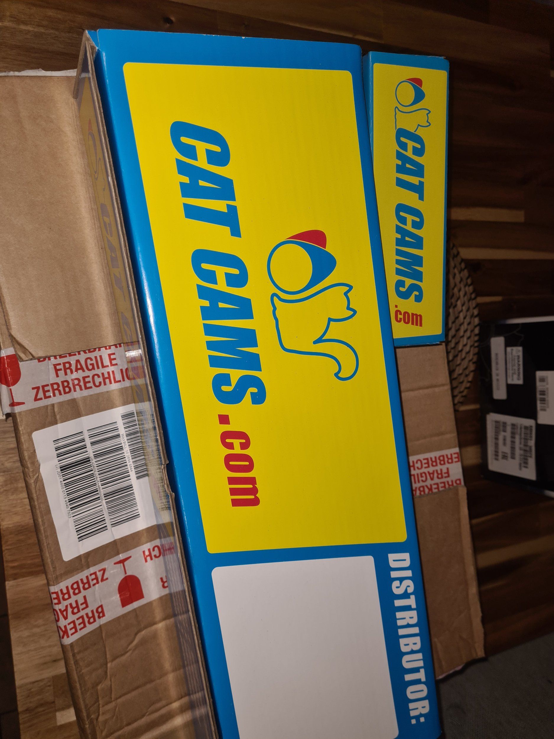

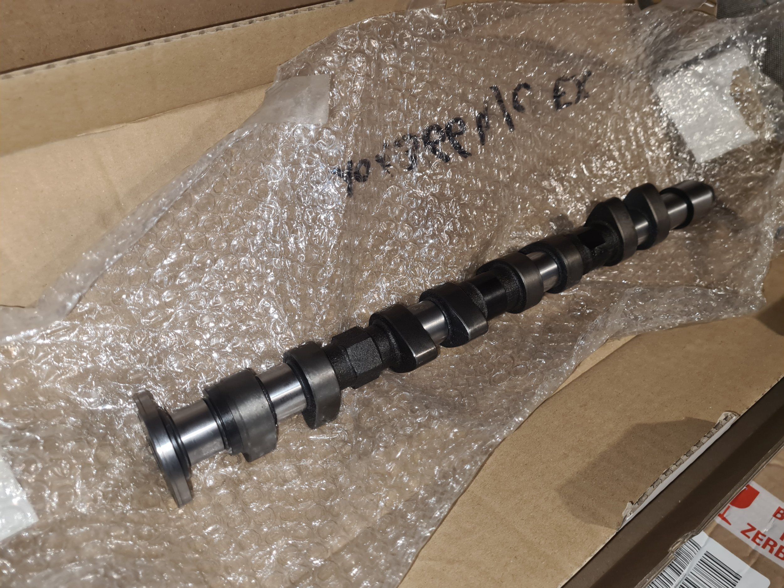

We have a lumpy stick for the inlet .
A not a lumpy stick for the exhaust side of things

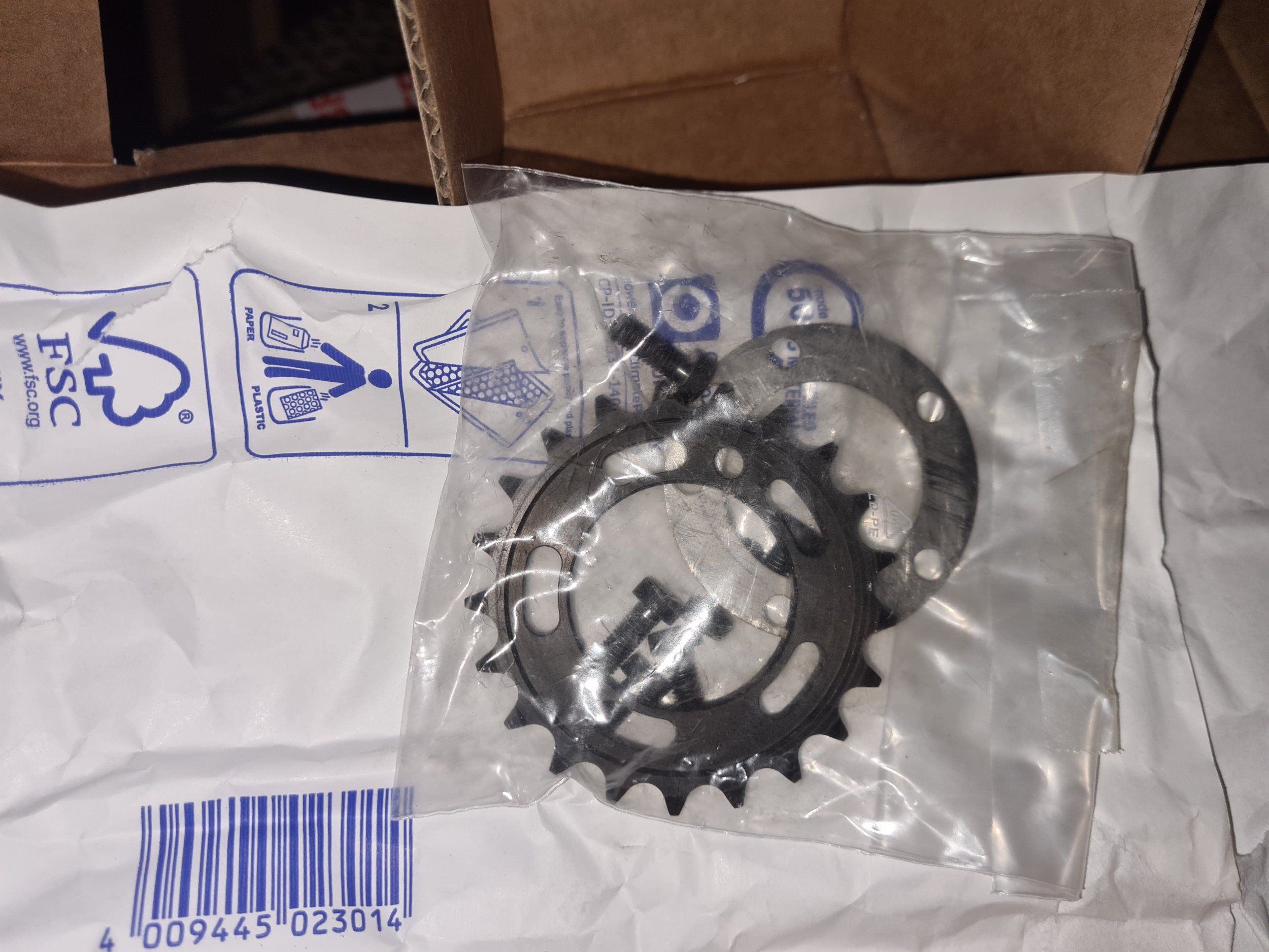

Then the adjustable sprocket
And for those who are intrested this is the details and information of the cam shafts.
Again. All parts can be brought from pro race engineering.
As promised some more pictures. So first of is the high flow pump. View attachment 39340 this is a genuine audi vw seat etc etc part. But with extensive testing by PRE they discovered the different flow rates form loads and loads of oil pumps. I can't remember the rate but it's about 25% over standard 1.8t pumps. Plus brand new strainer
How can you order the oil pump with that higher flow rate? Does it have a specific number other then the OEM number?
If you contact Pro race engineering. They will be able to sell you one. The one I have has the audi vw markings but no actual part number. They have figured it out and know the flow rates of different OEM pumps.
