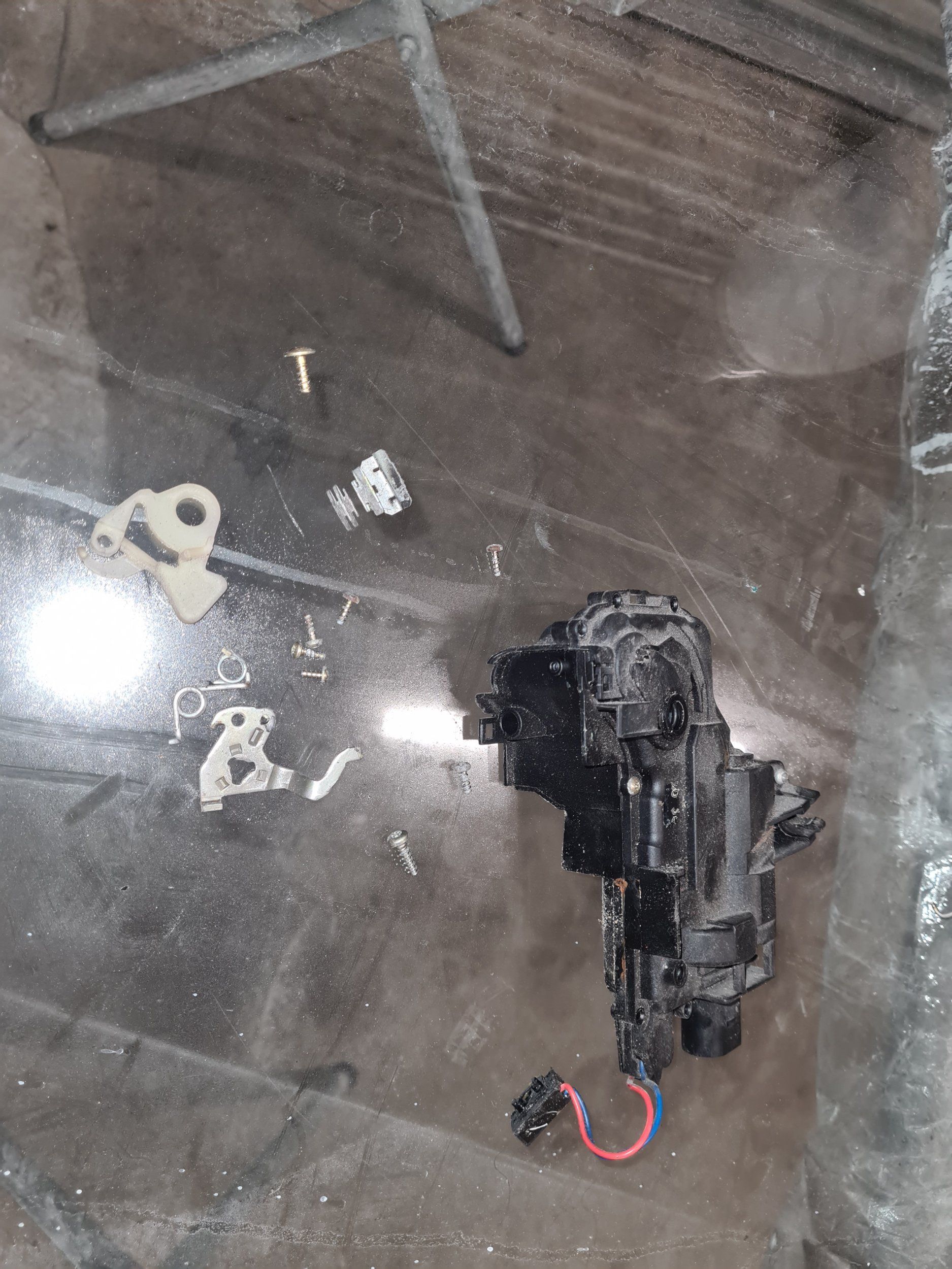

Starting off by stripping door locks so they can't lock.

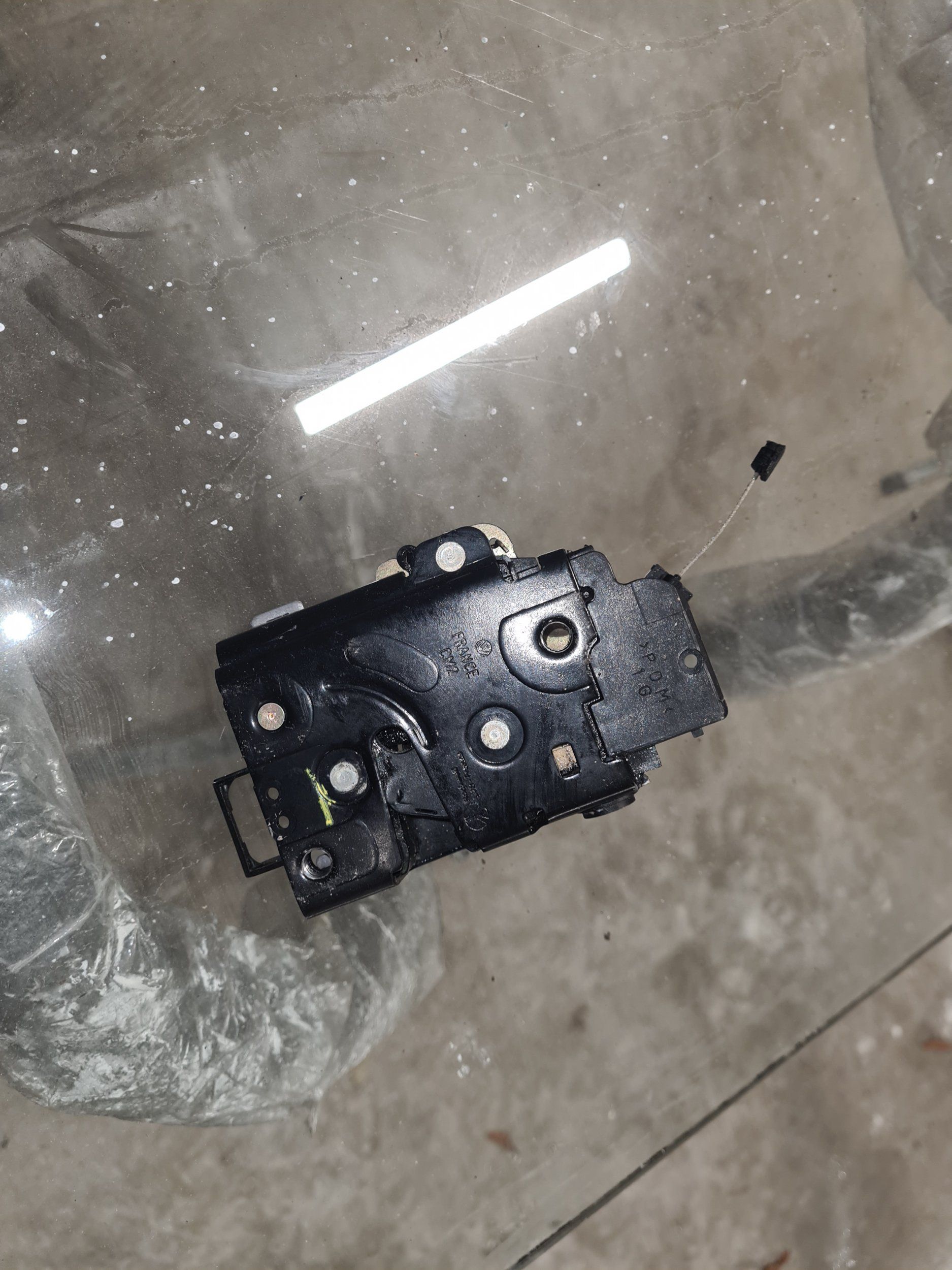

So I removed the electric door locking system. And also the child lock system too.
. So in the end all I had was just the locking system. Also I am not having any internal opening pul as I don't need it . They won't be opened from the inside

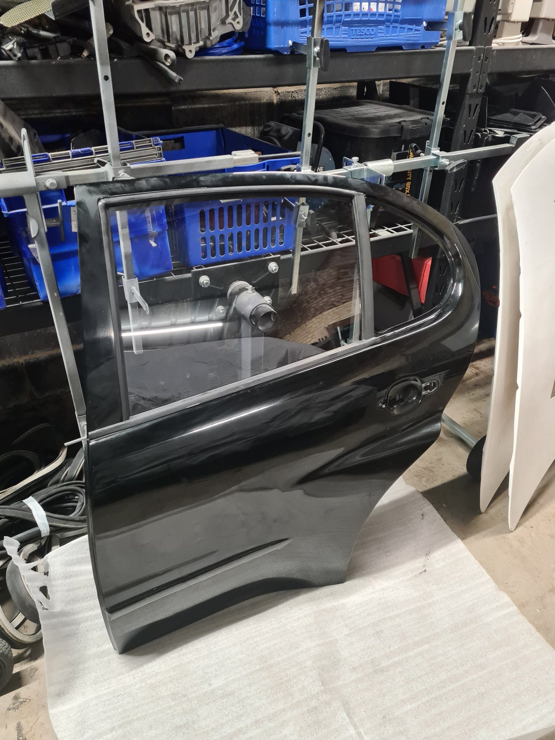

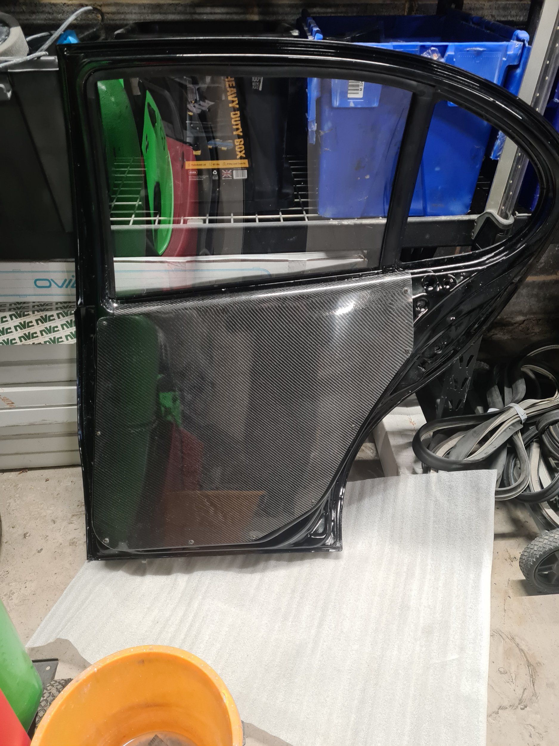

Then on to building the rear doors.
Cleaned the door rubber and the window surround rubber. Then slid in the new polycarbonate window and fitted the window rubbers.
Then screwd the internal carbon fibre panel to the door
I have ordered some m4 nuts and bolts to secure the window in position. Also am writing a shopping list to send to Thai lol
Then screwd the internal carbon fibre panel to the door View attachment 29018

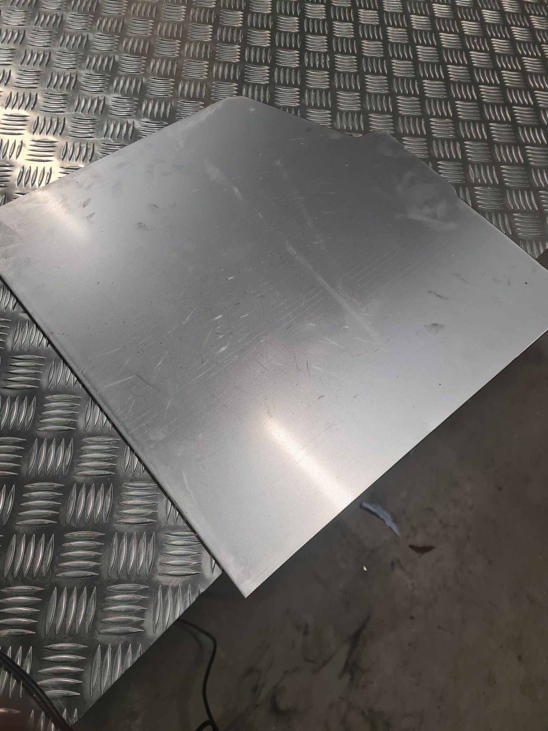

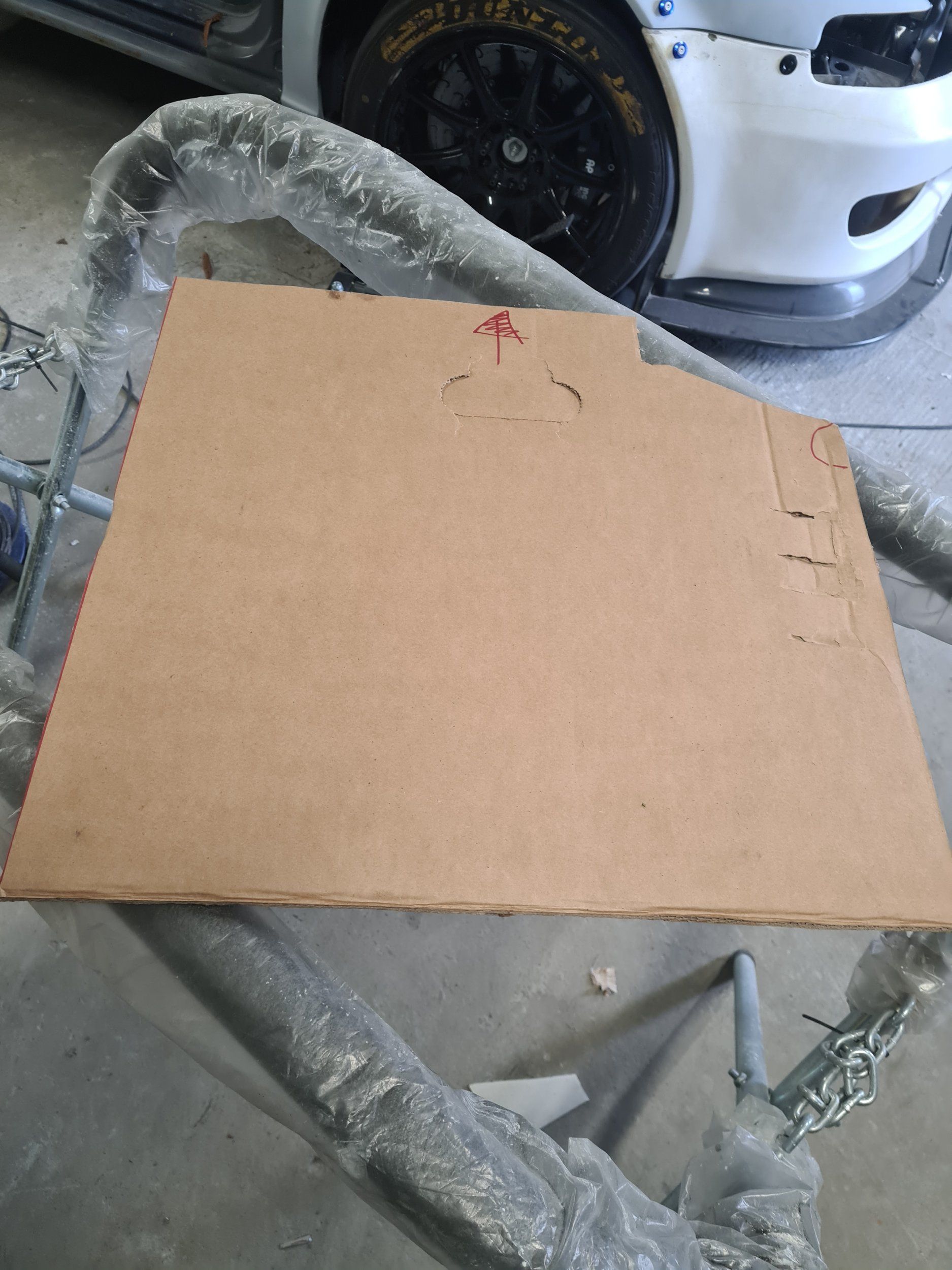

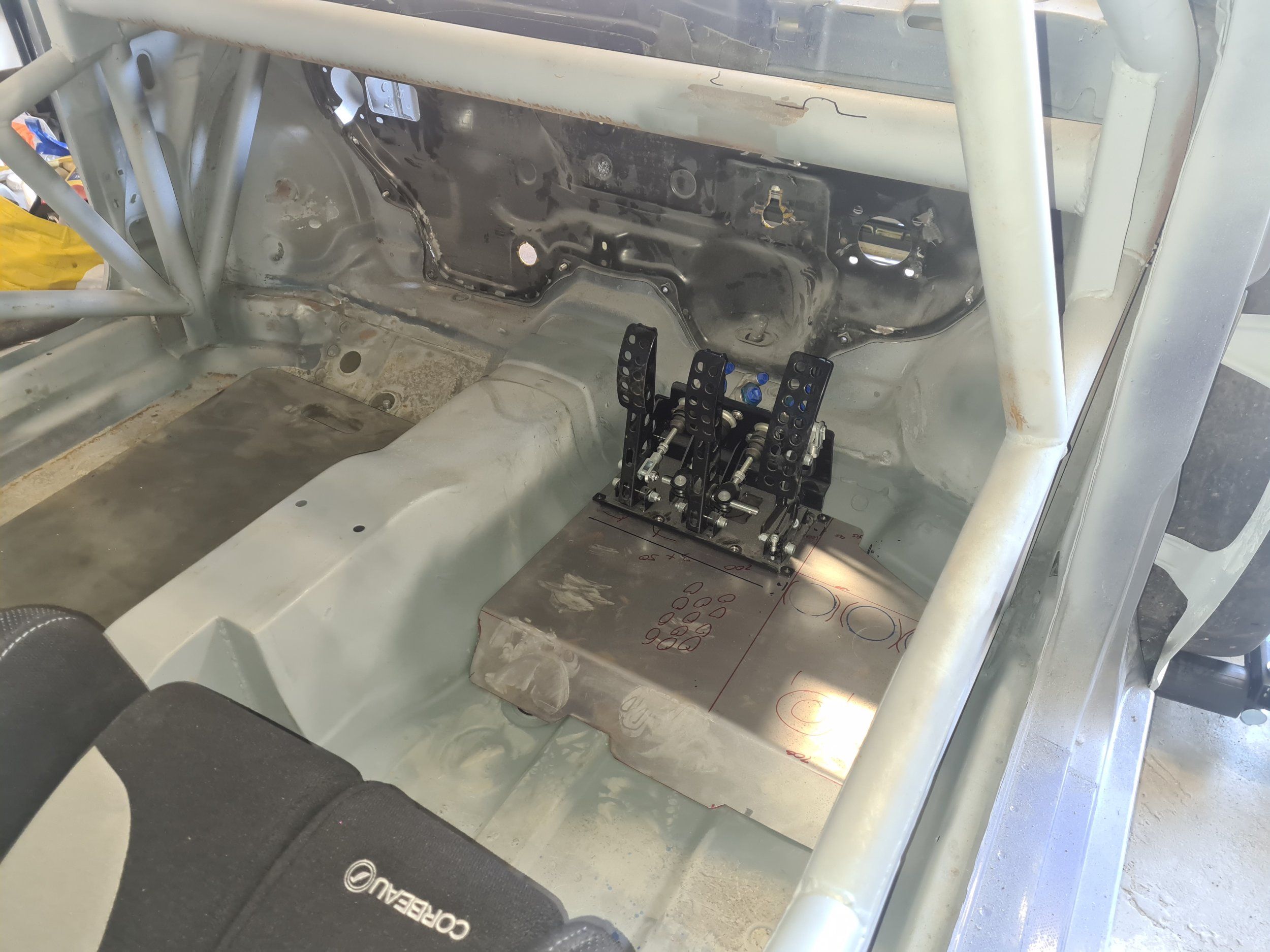

So playing with the pedal box and mounting it. I have now come to the idea of making a faulse floor about 50mm higher so the master cylinders on the back don't hit the bulk head..

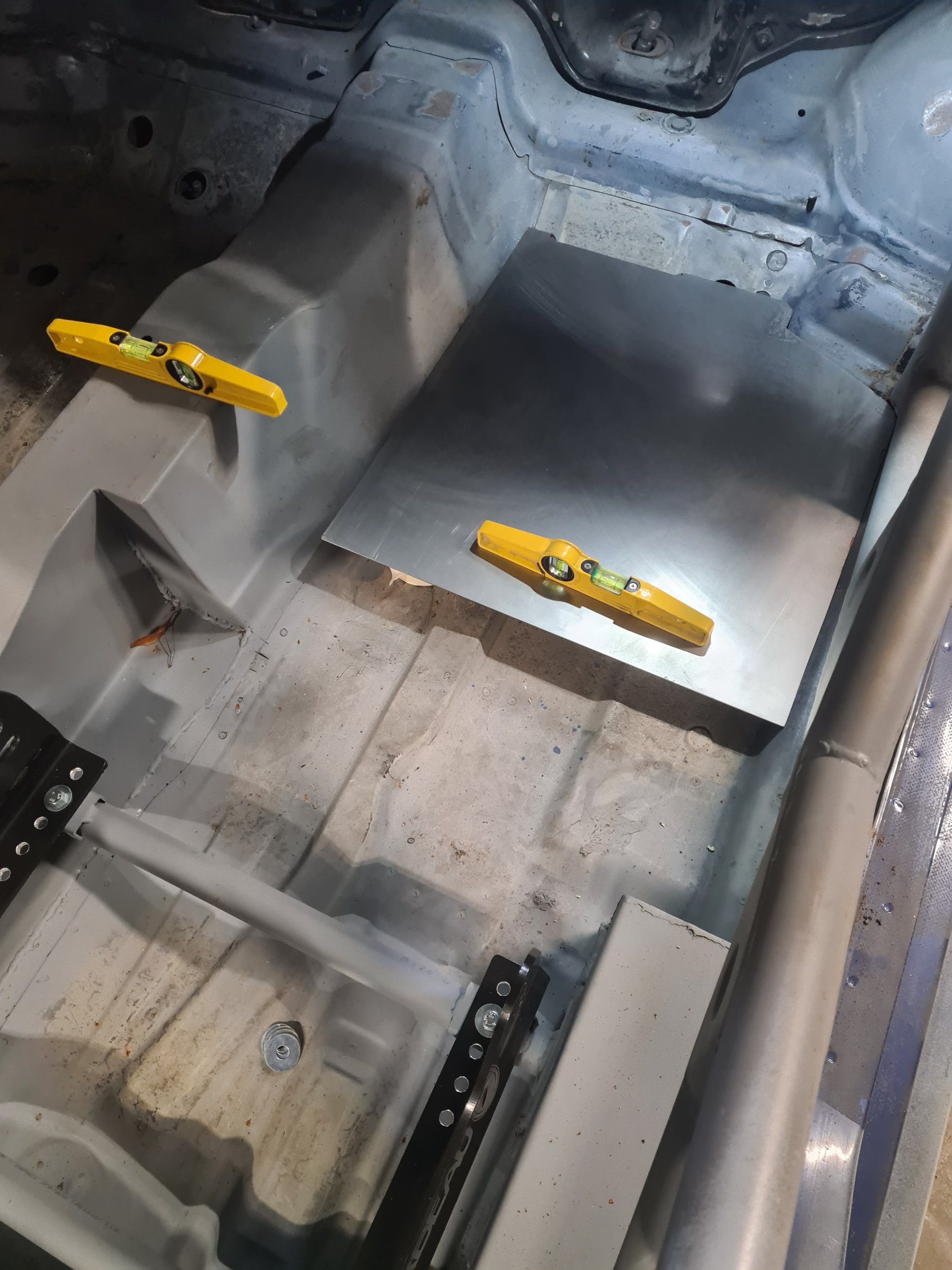

I made a rough card template
Then transfered to 1.5 mm mild steel the cut it out with a grinder.
Then a few more adjustments it sort of fits
But now I am on ebay looking a buying a metal folder as I need to do a 45° bend on the front then make it fit to the floor. . Then position the pedal box.. Mark and drill holes then weld fixing to the back to bolt to. Then punch and sump some homes to lighten Then strengthen the panel.. I will put up pics when that is done. But I got a call out to had to pack up and go to a break down( I am currently on dafaid. That's a 24 hour call out for daf trucks in my area that break down or get faults etc.) Oh the joys.

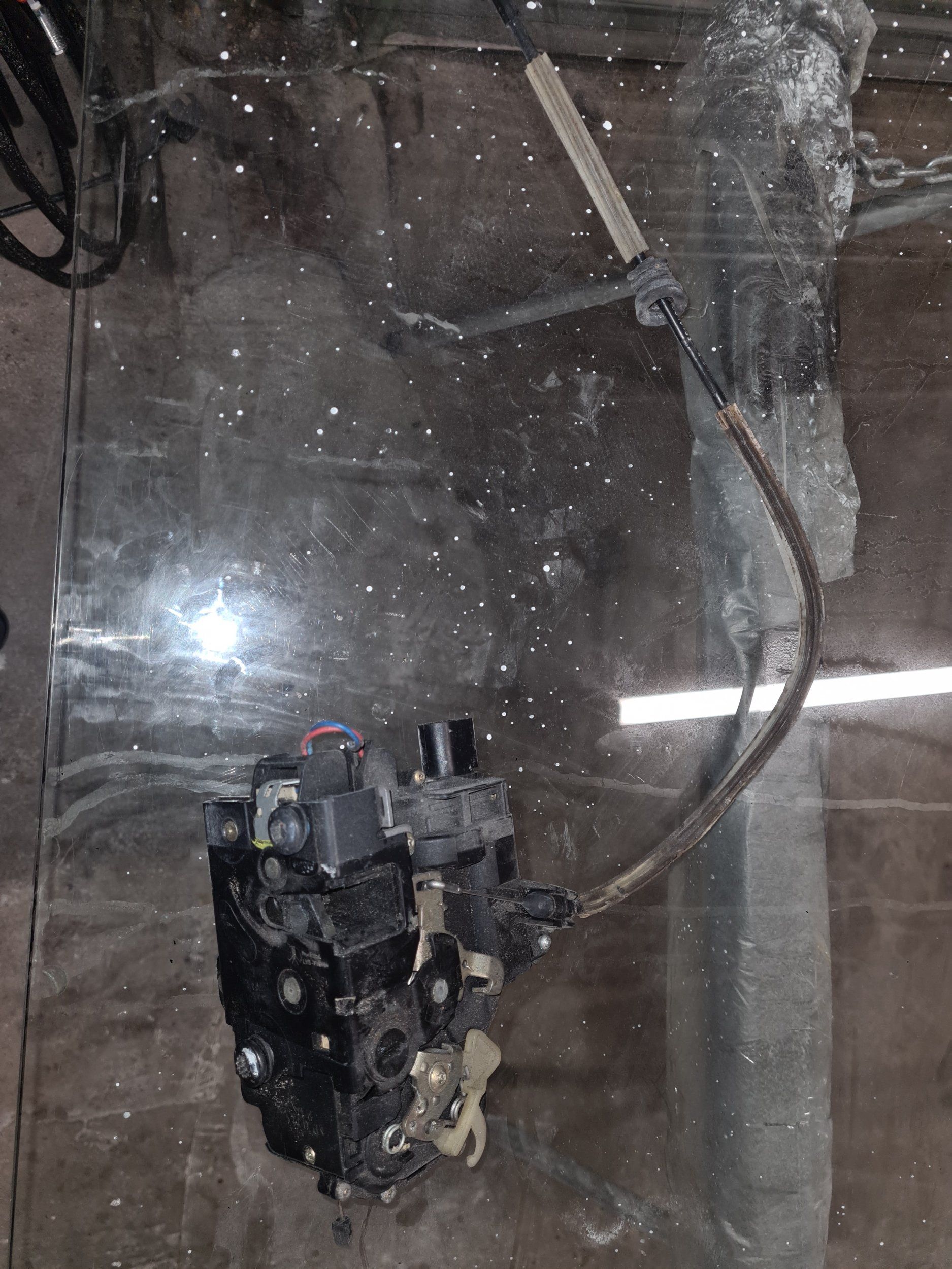

Starting off by stripping door locks so they can't lock. View attachment 29013View attachment 29017

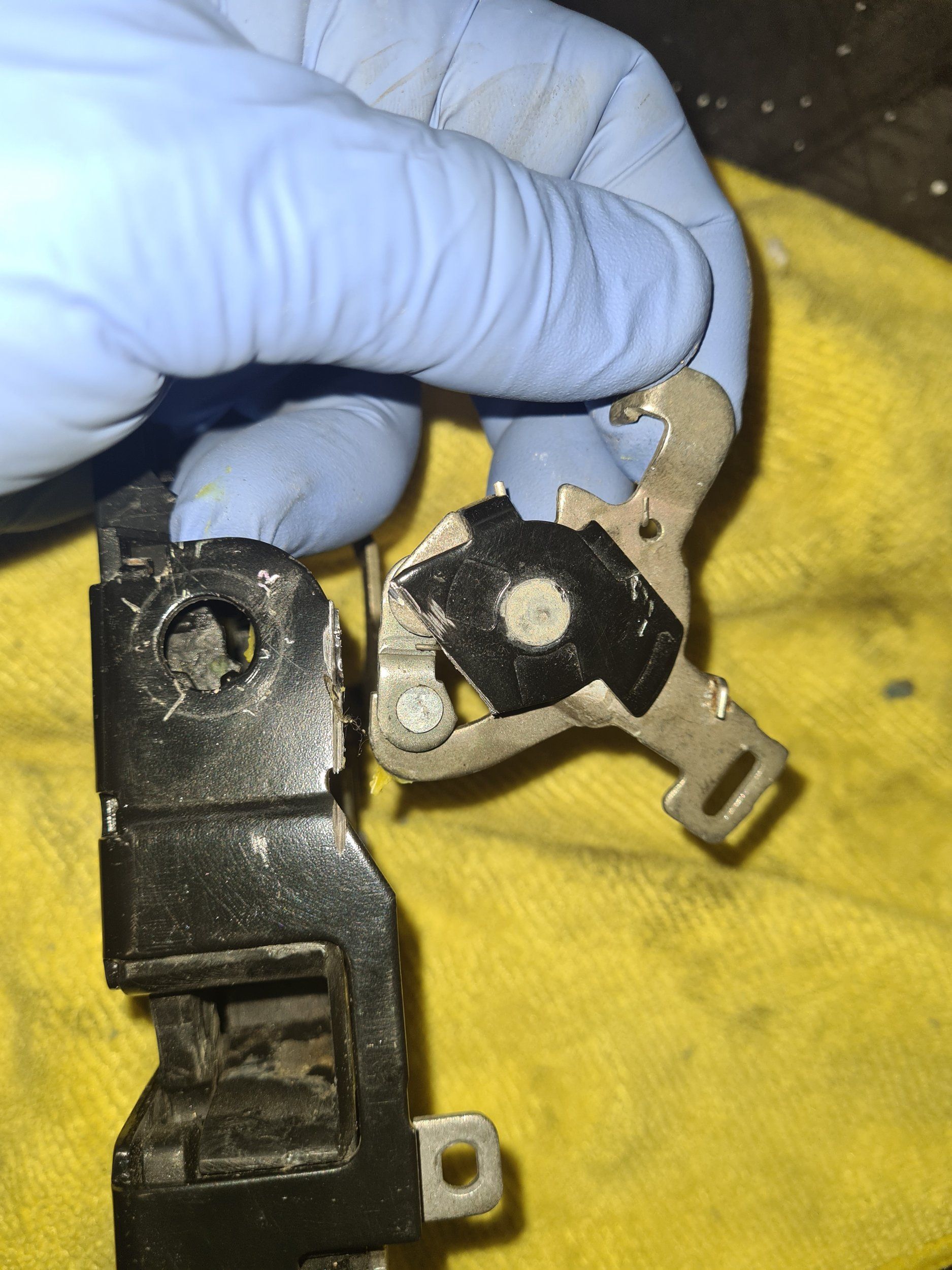

So I removed the electric door locking system. And also the child lock system too. View attachment 29015. So in the end all I had was just the locking system. Also I am not having any internal opening pul as I don't need it . They won't be opened from the insideView attachment 29016

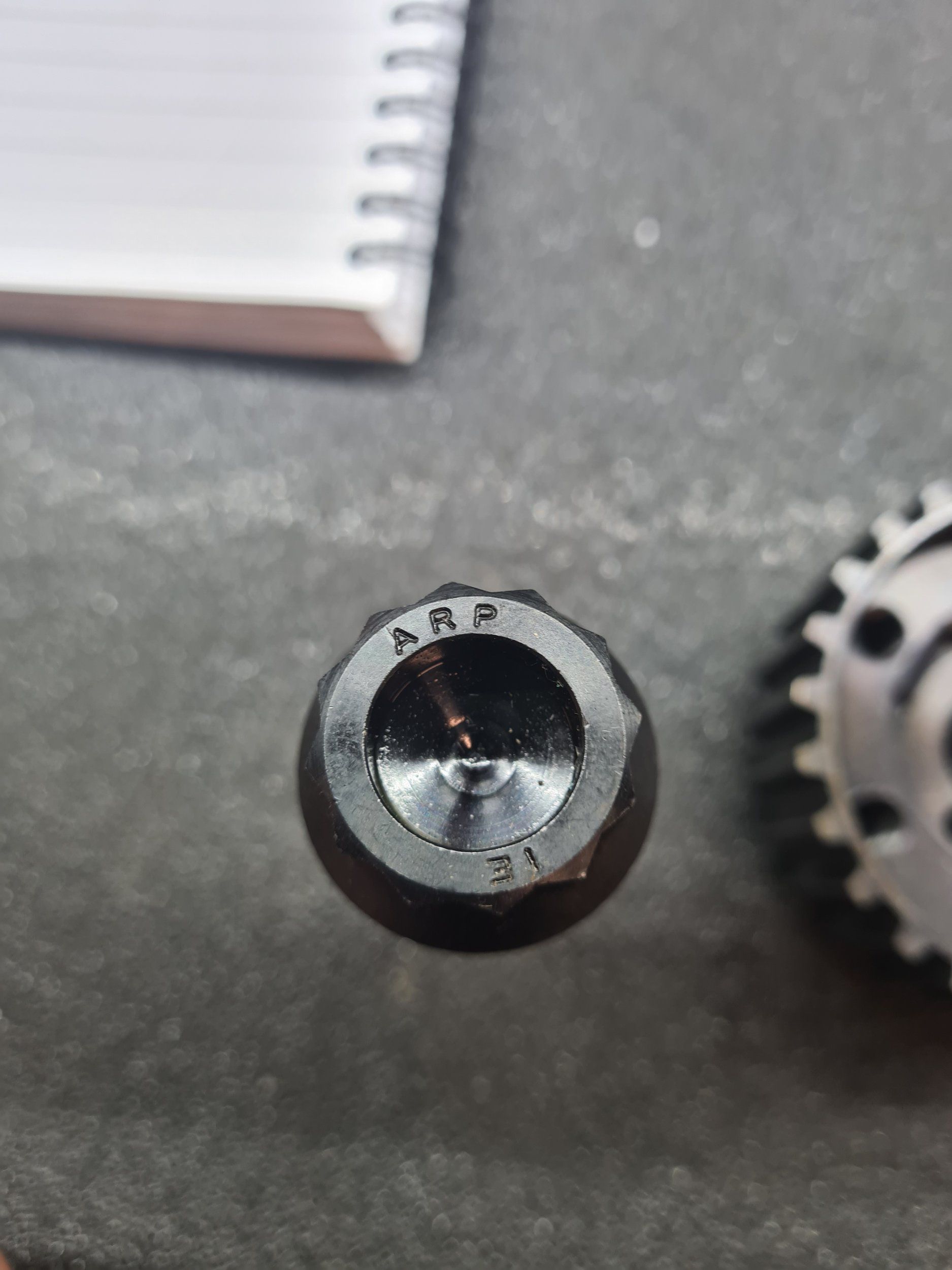

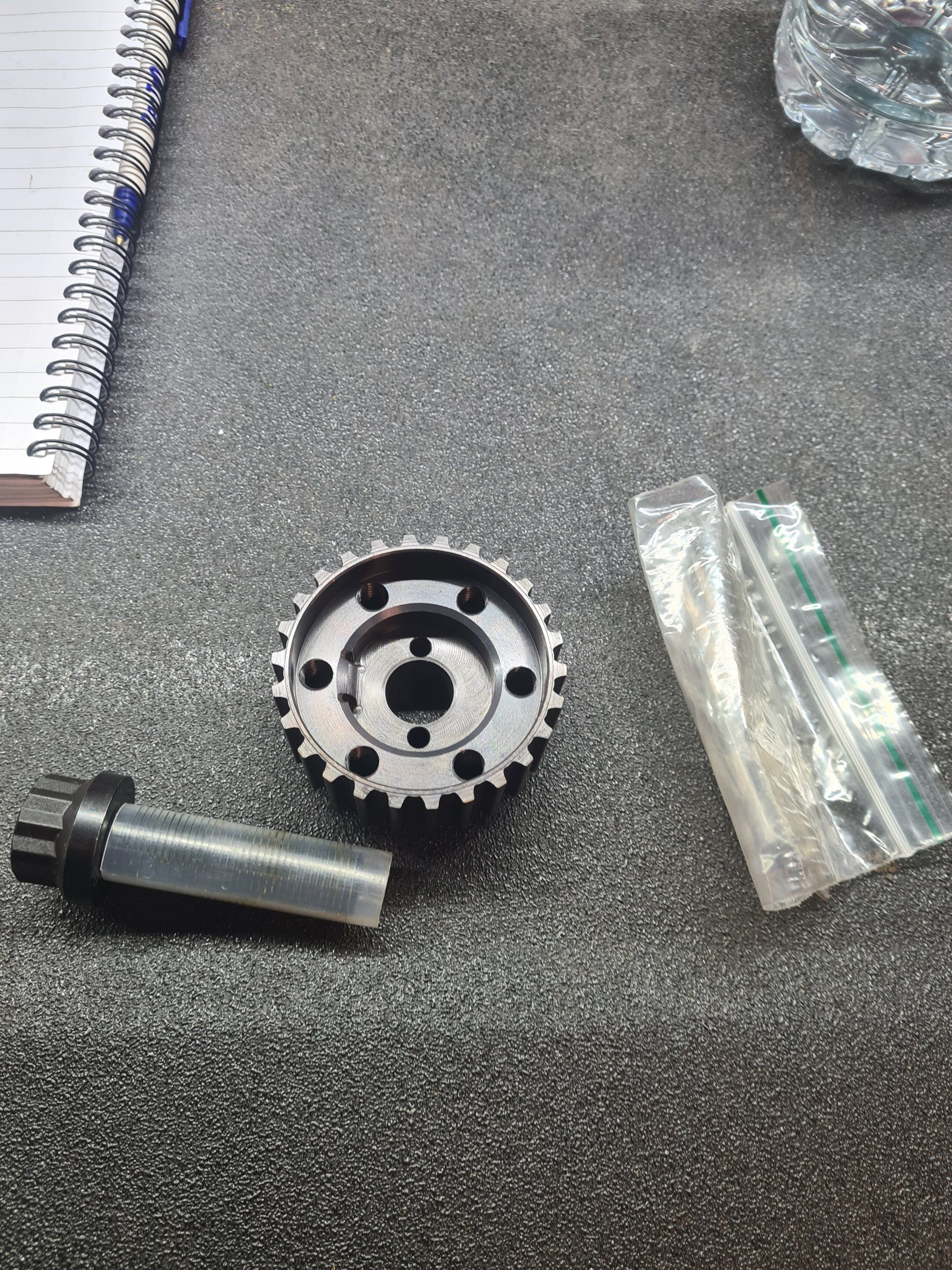

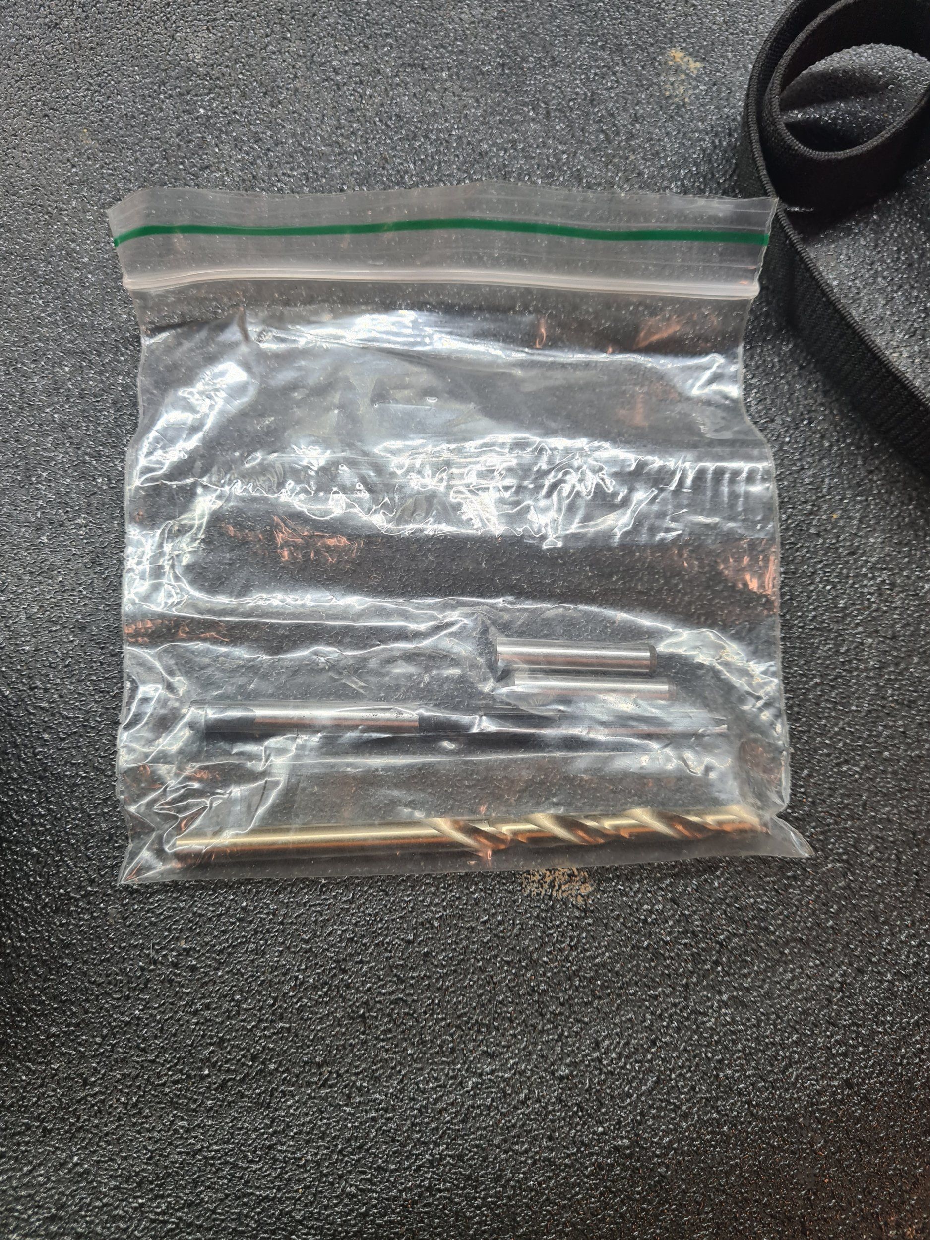

It's supertec valves and twin spring set up. Ported and matched ports to the manifolds. I have got the billing crank pull with pin kit. So bolt in to position ( arp crank pulls bolt) then drill and pin the pully to the crank. This will then help to stop shearing the woodruff key out .
Prorace do a twin pulley set up modification and then with race pec billit catcams. I thing it should have plenty of go in it. 82.5mm stroker pistons and I.e rods . Knife edged and balanced tfsi crank. To give the stroke. Should end up being pretty pokey lol

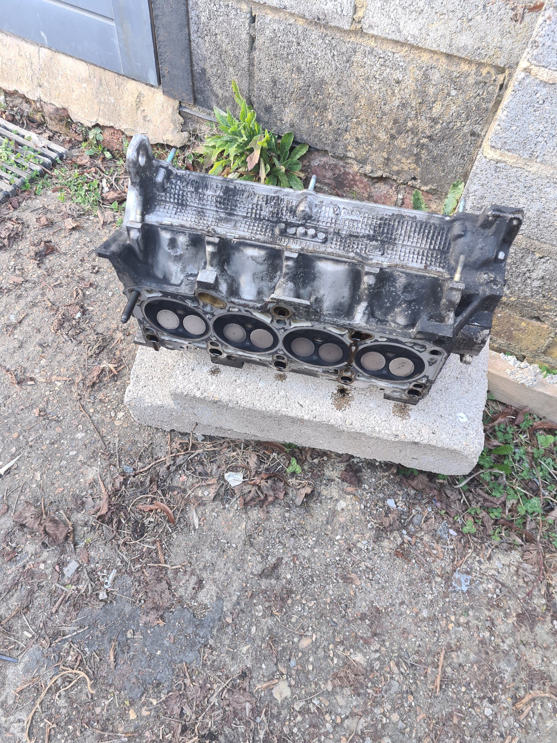

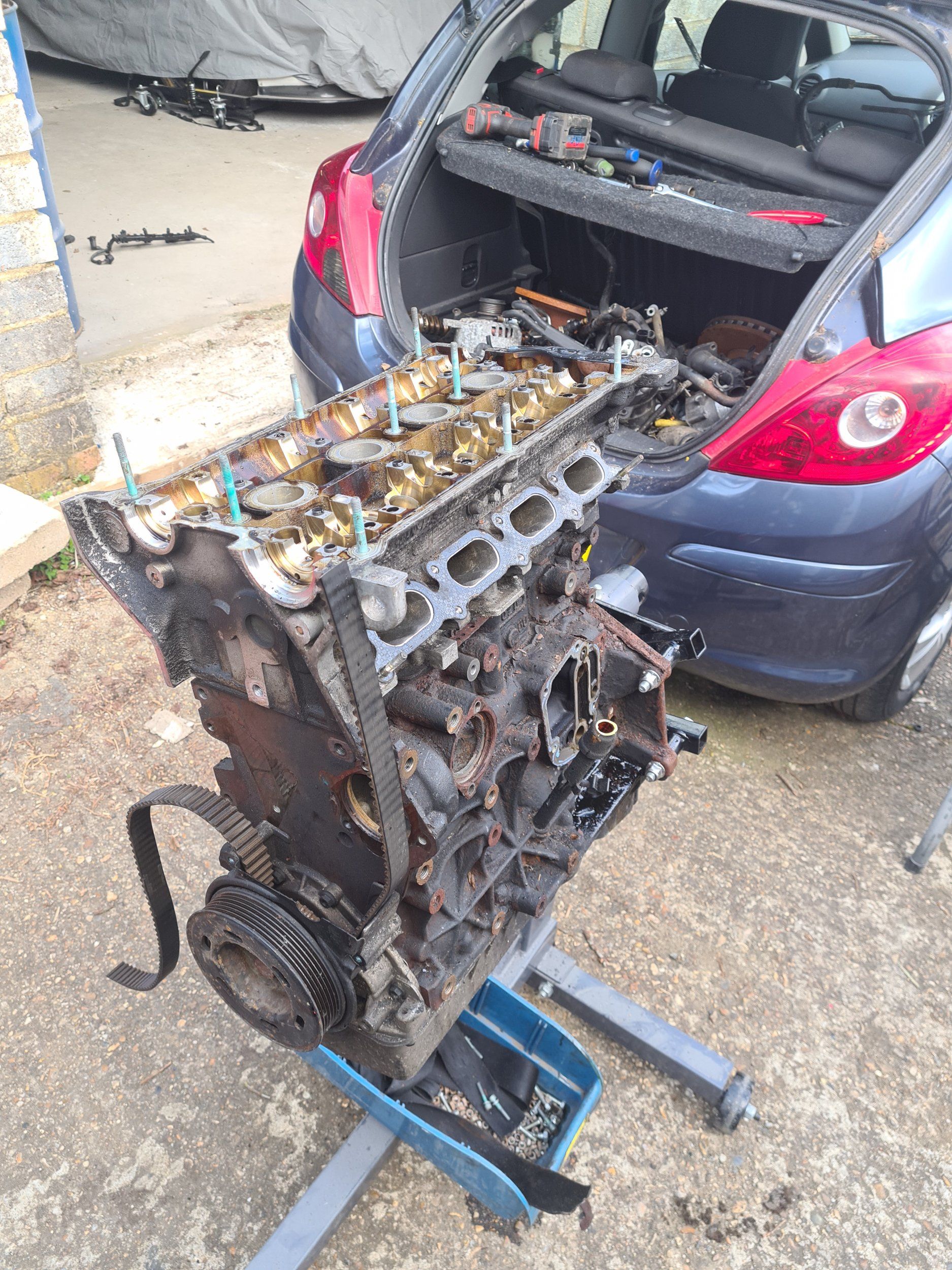

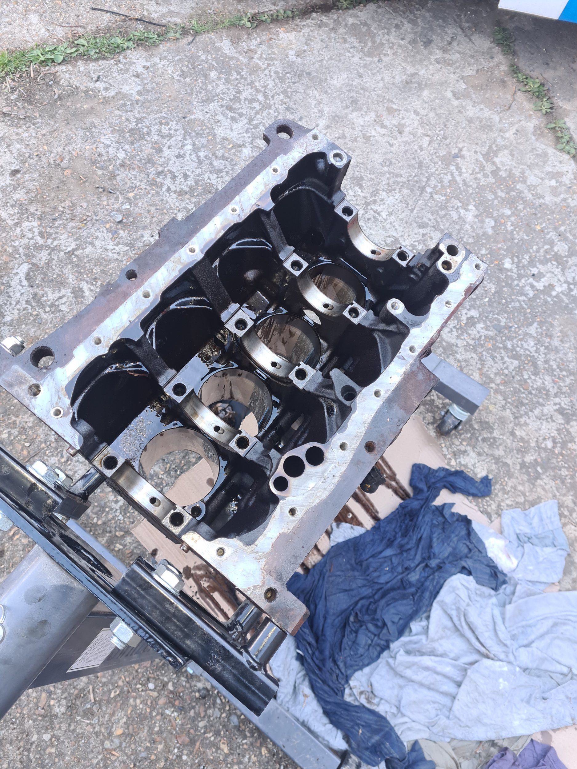

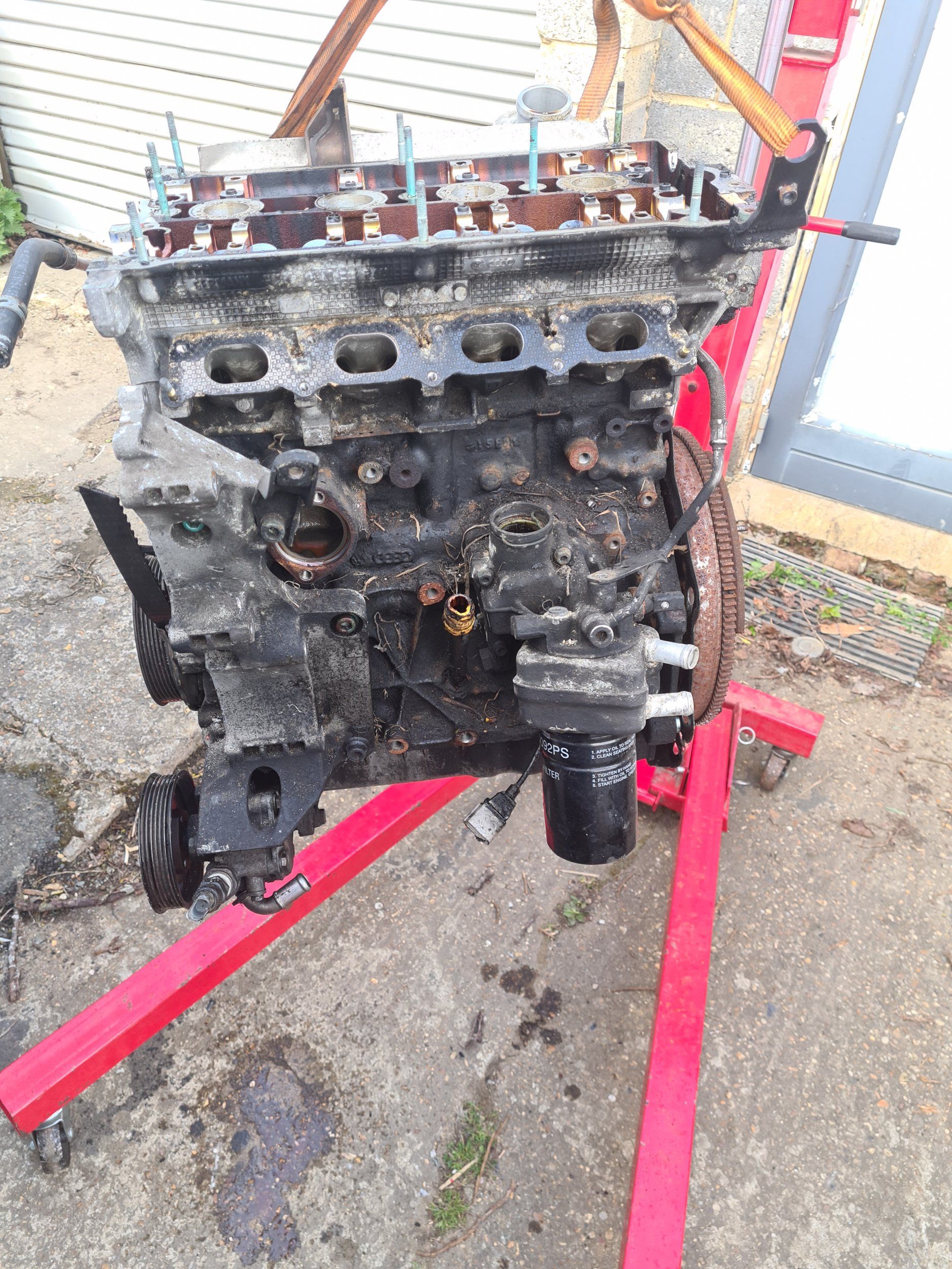

Boring few hours so grabbed the engines and stripped 1 and started to strip the other one. 1 is an AUQ and the other is AUG.
Now to give the block a clean and get it sent off for machining. Going to have 83mm pistons
Got to find some where that does hot washing or even a gental acid bath. Help to clear all oil and water gallery's (ignor the corsa..... its a scrap car I am using a a skip lol.. )
