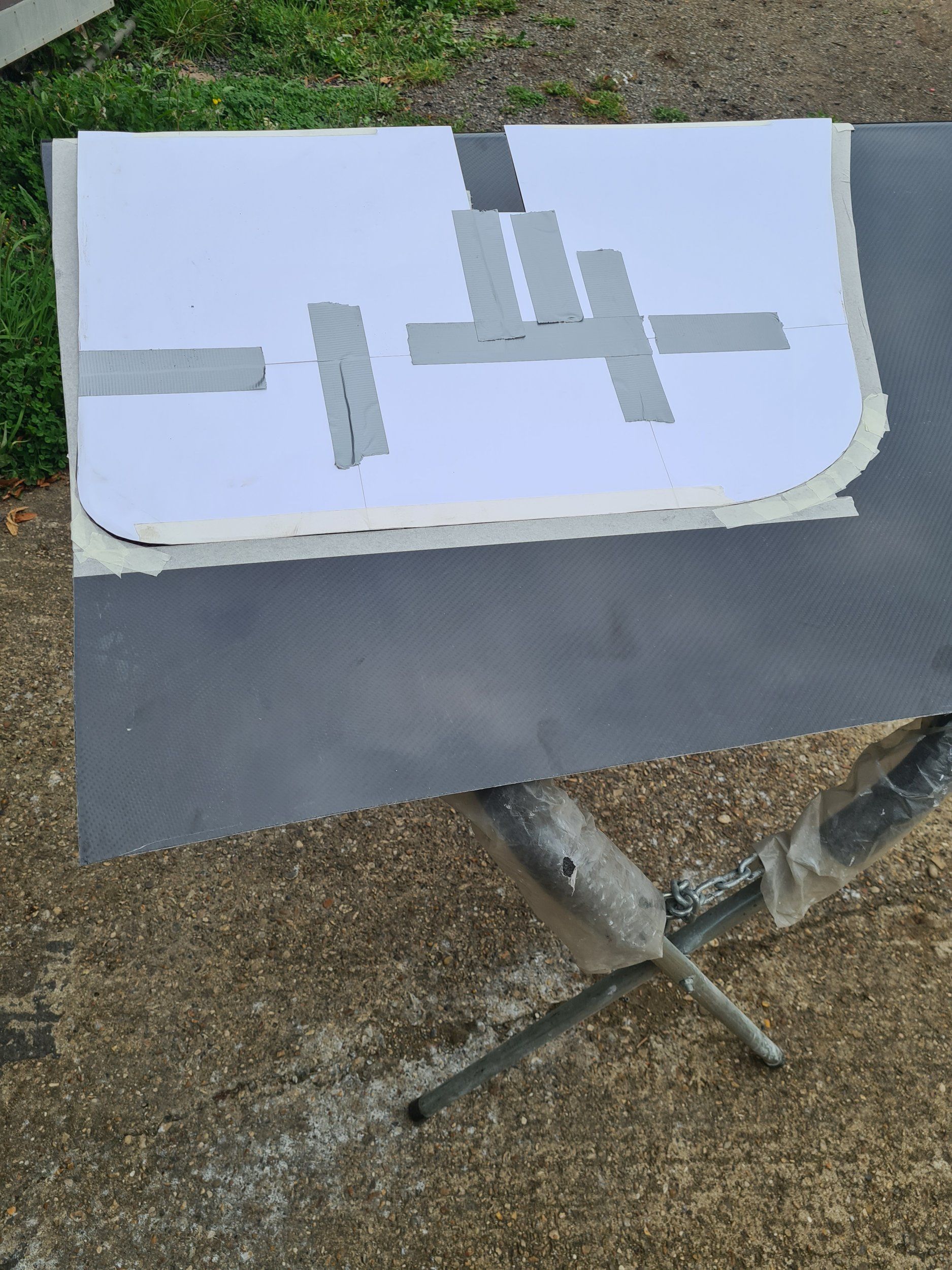

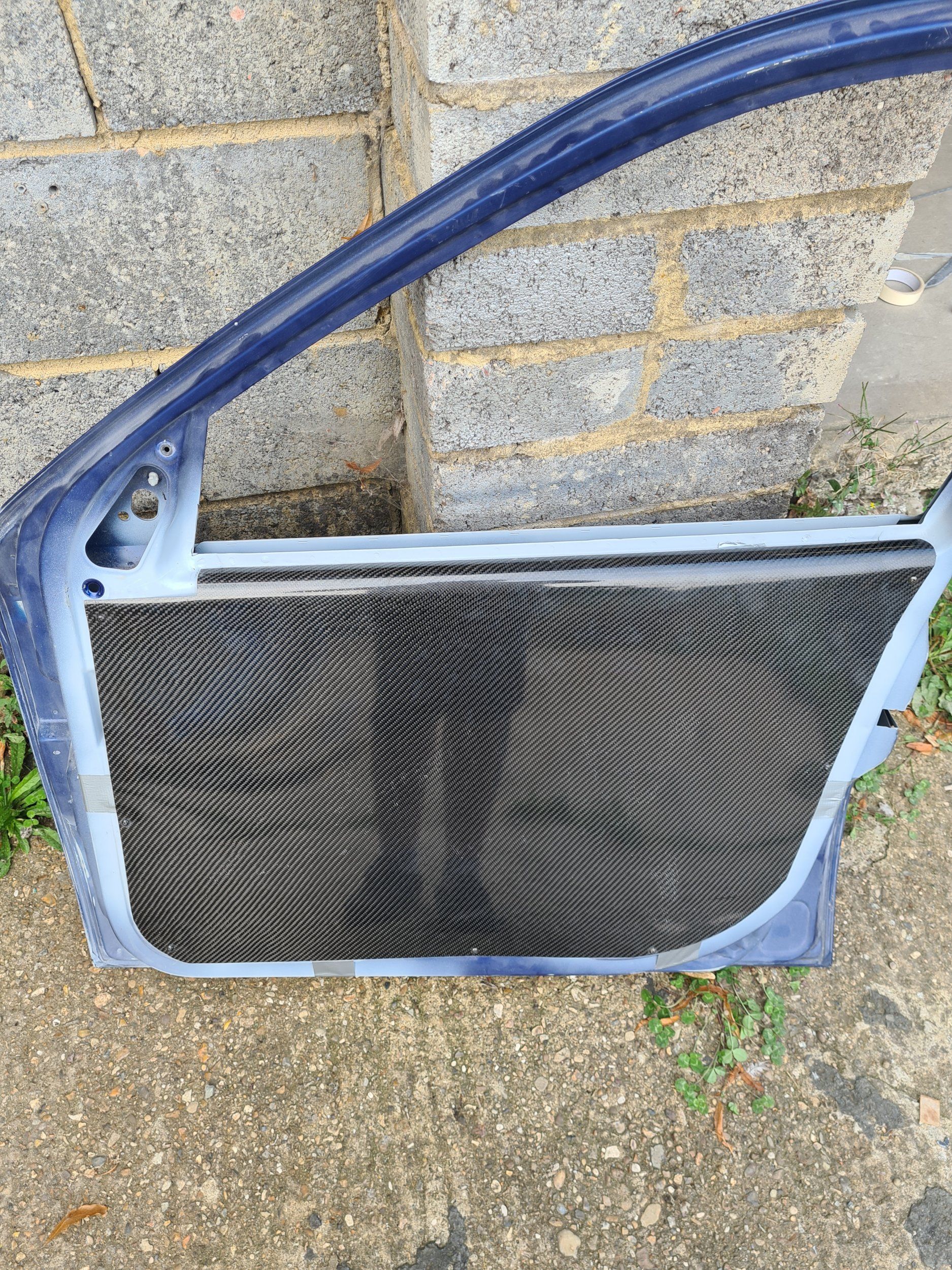

After looking around the workshop and wanting to sort stuff out. I thought I will cut the carbon sheets to make the door card
I had these made at xsport. They are a carbon weave with a fibreglass additions layers for thickness.

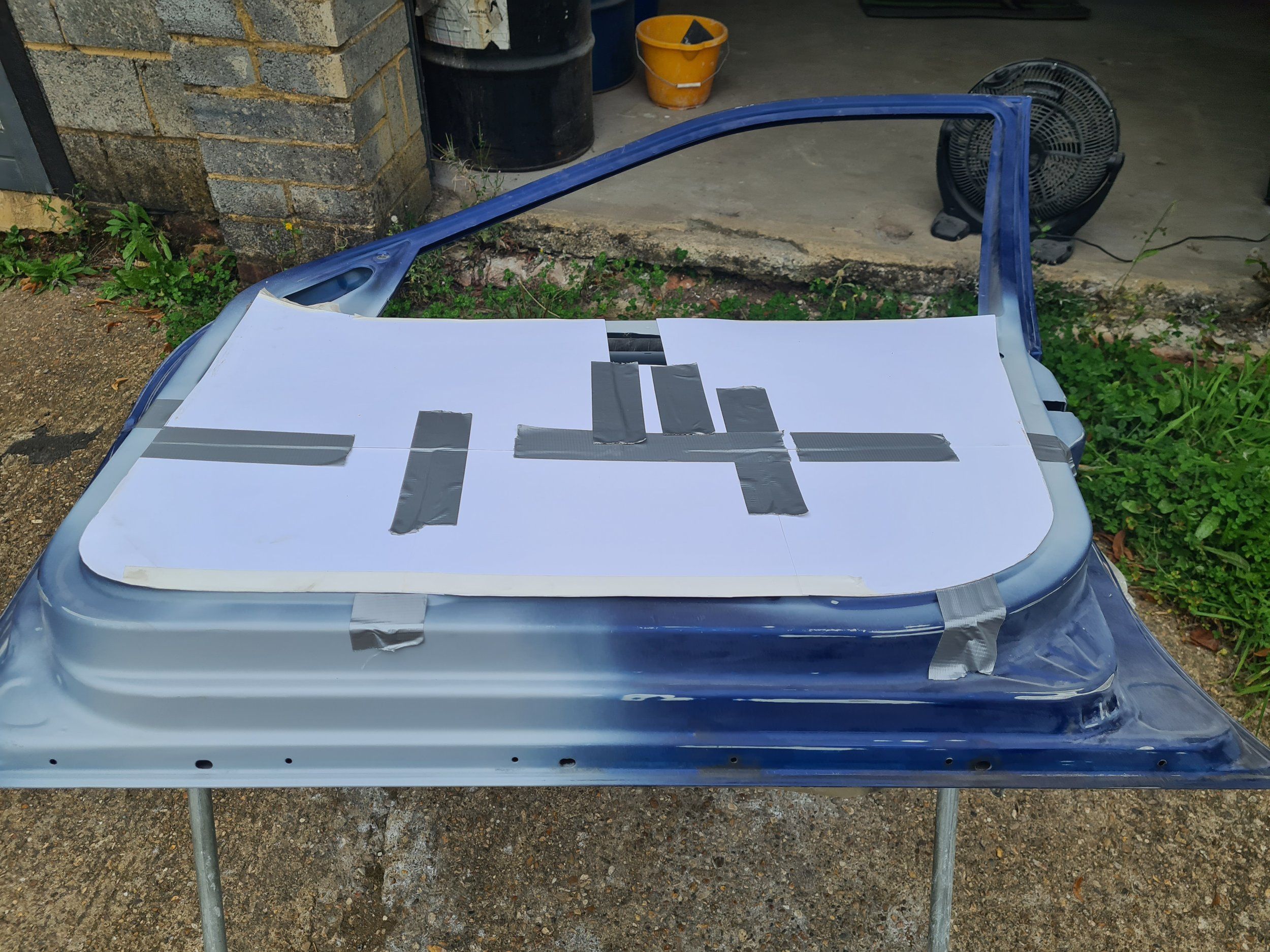

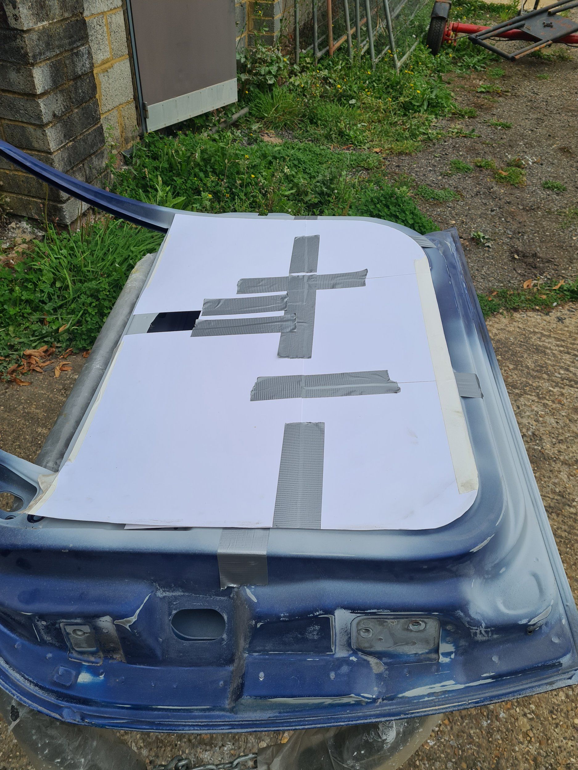

I started off by making a template of what I want from card
Then layer it over the carbon sheet and marked it out.

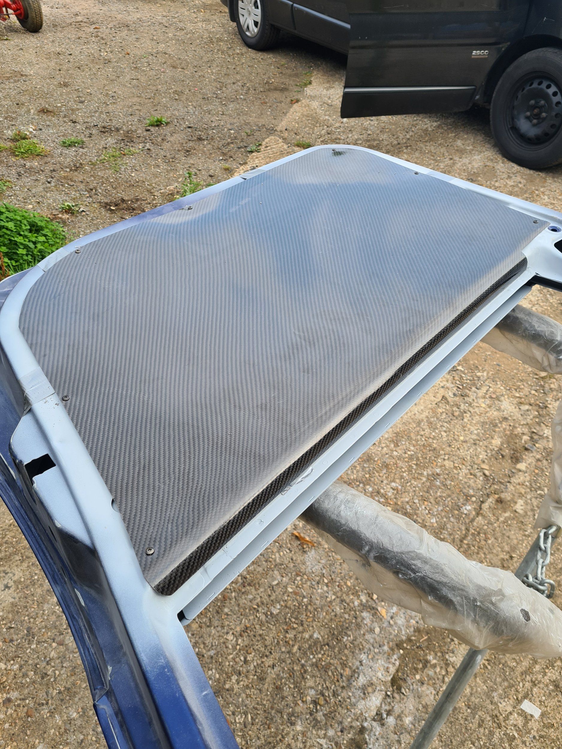

Then done rough cut out So not working with a massive sheet to play with. Then done the near enough cut lol. Then the final sanding and rounding the corners. And the final article..

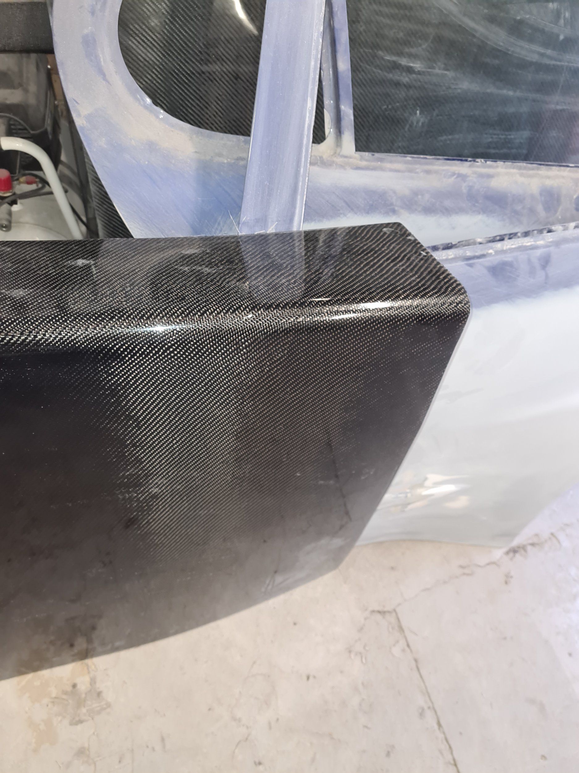

just 3 more to do. I went for the more expensive type with the curve at the top instead of the plane flat sheet.

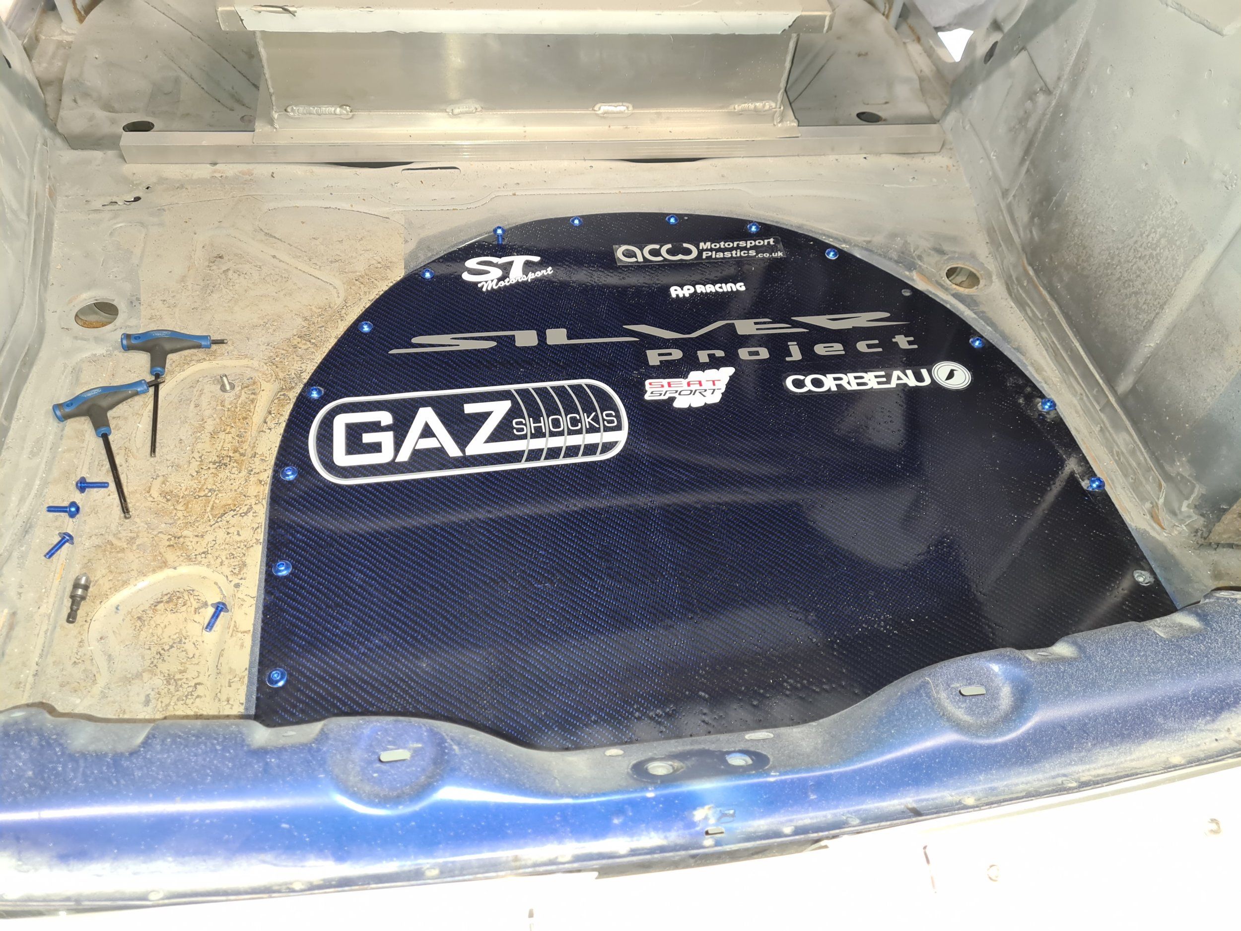

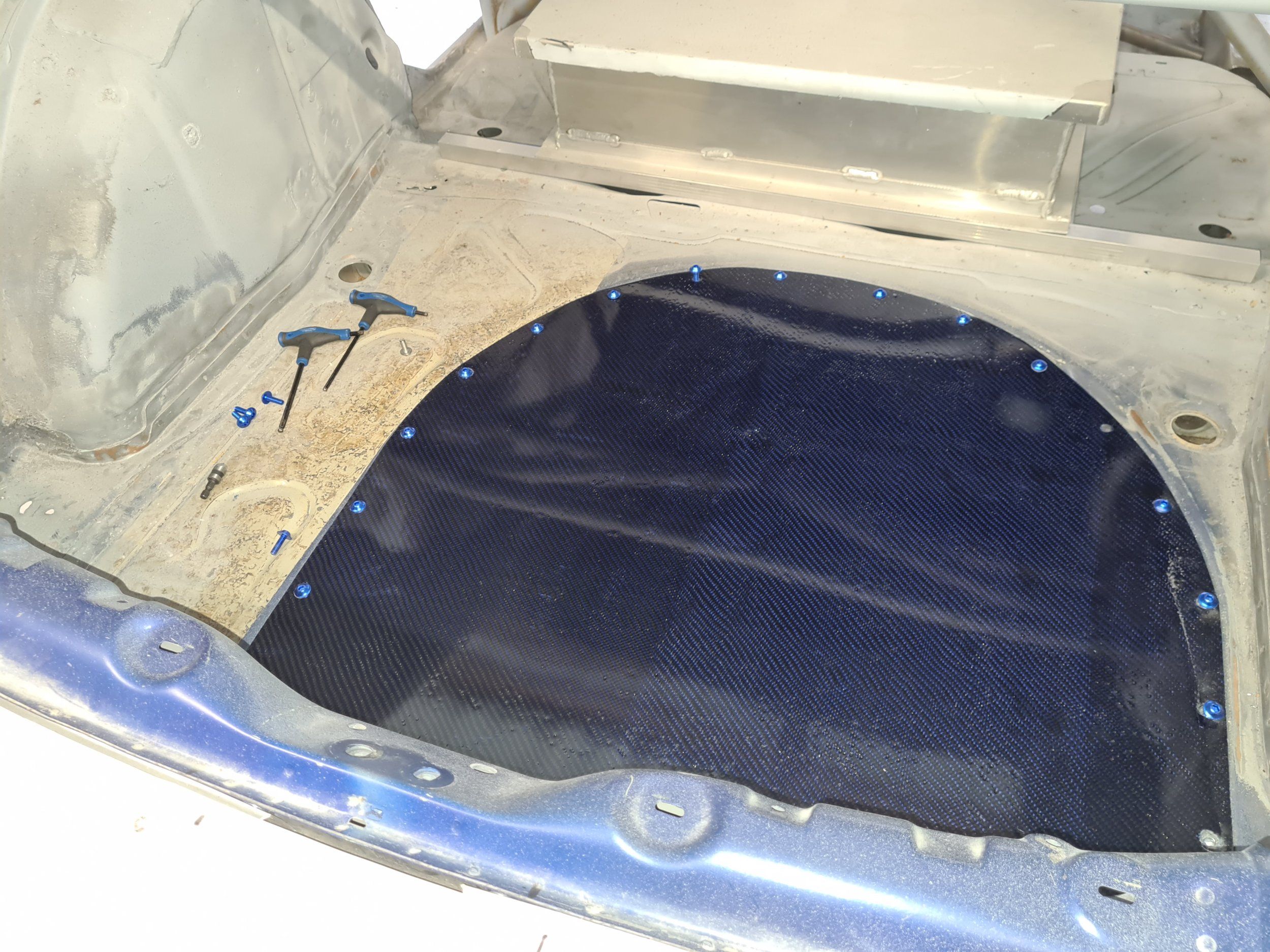

Also now done the rear doors..... and cut out the panel for the boot floor where I have cut out the spare wheel well.
Then put some decals of the company's who have helped us so far...
Plenty of room for more too
Looking good. I’m guessing the weight difference between gutted metal doors and fibreglass isn’t that much, would that be right?
I think the fibreglass ones are still lighter. I was looking at them. But a lot of the build specs for different promotions say doors need to be metal frame and skin construction. So bonnet and boot are OK. But class depending it may well go that way. Or I buy another set of doors and gri d the skin off then I can cut out more from the inside as there is loads of double skinned bits
So gonna go metal doors for the moment.... but depending where I end up lol and where I race I will look in to swapping over. But will get the door skins done in carbonfibre lol.....

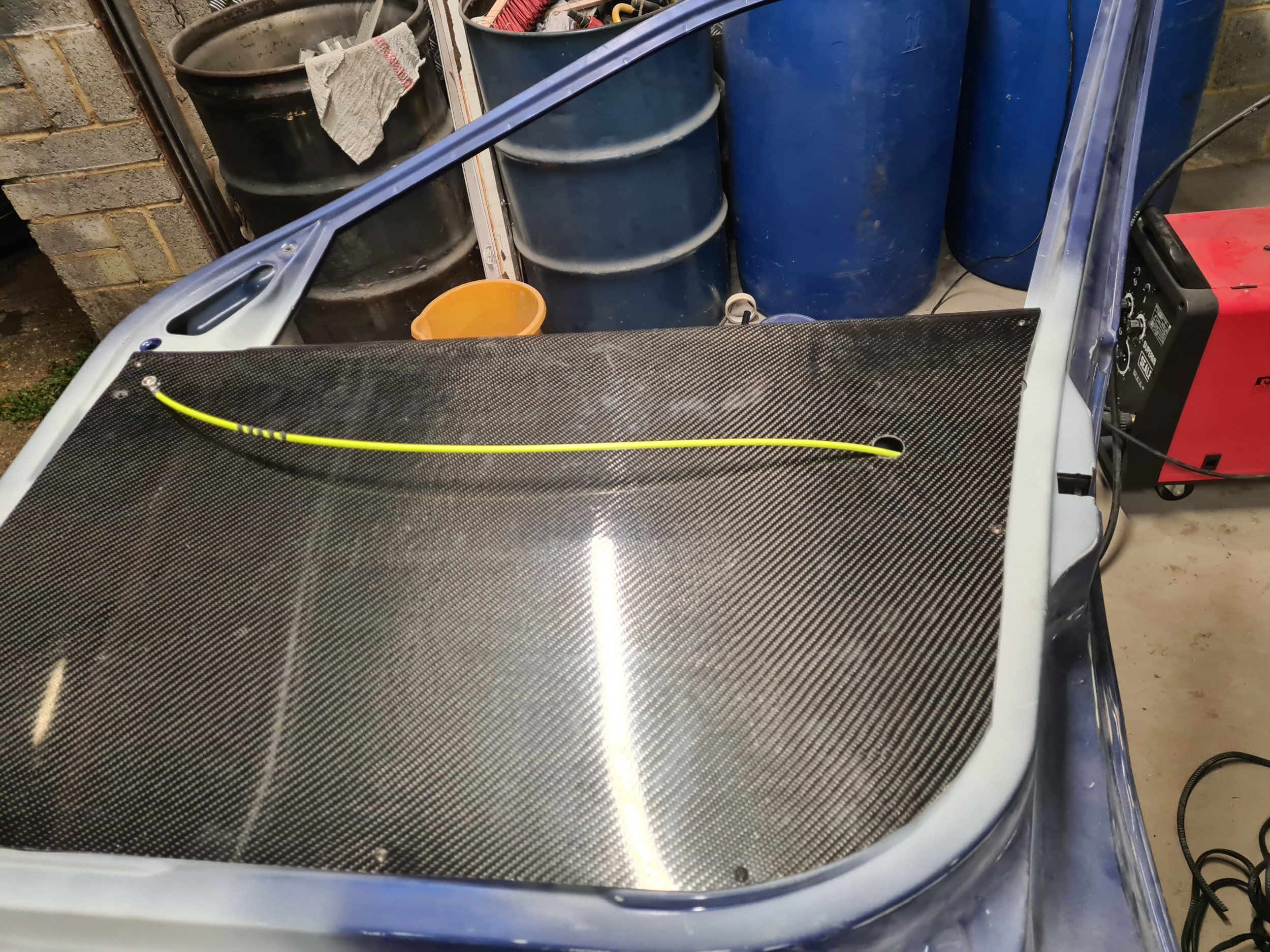

After cutting to doors down to lighten them.

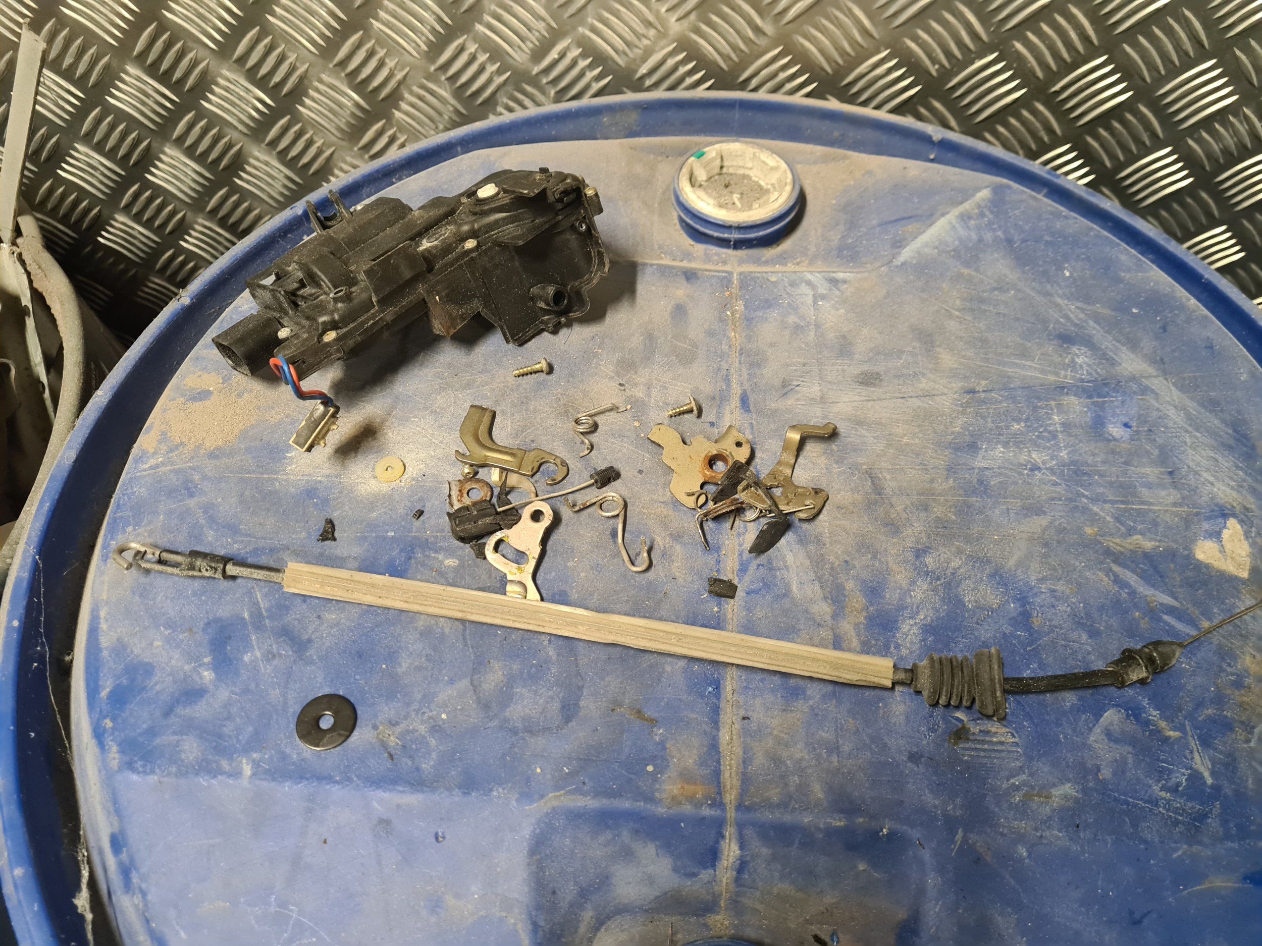

Now there is no where to mount the door pull to open the door.
So bit of head scratching and pondering. I thought about a cable style set up.
So first got the door lock and cut off all I don't need
I searched ebay and bought some mountain bike brake cable and covering. I then put it threw the latch so when pulled it opens. So I cut a hole in the carbon and then using bright covering to make it easy to see.
I then used a nutsert in the door.
Then crimped on a electial terminal with a 6mm ring to bolt threw hole.
Then mounted that
So with a gentle tug it unlocks

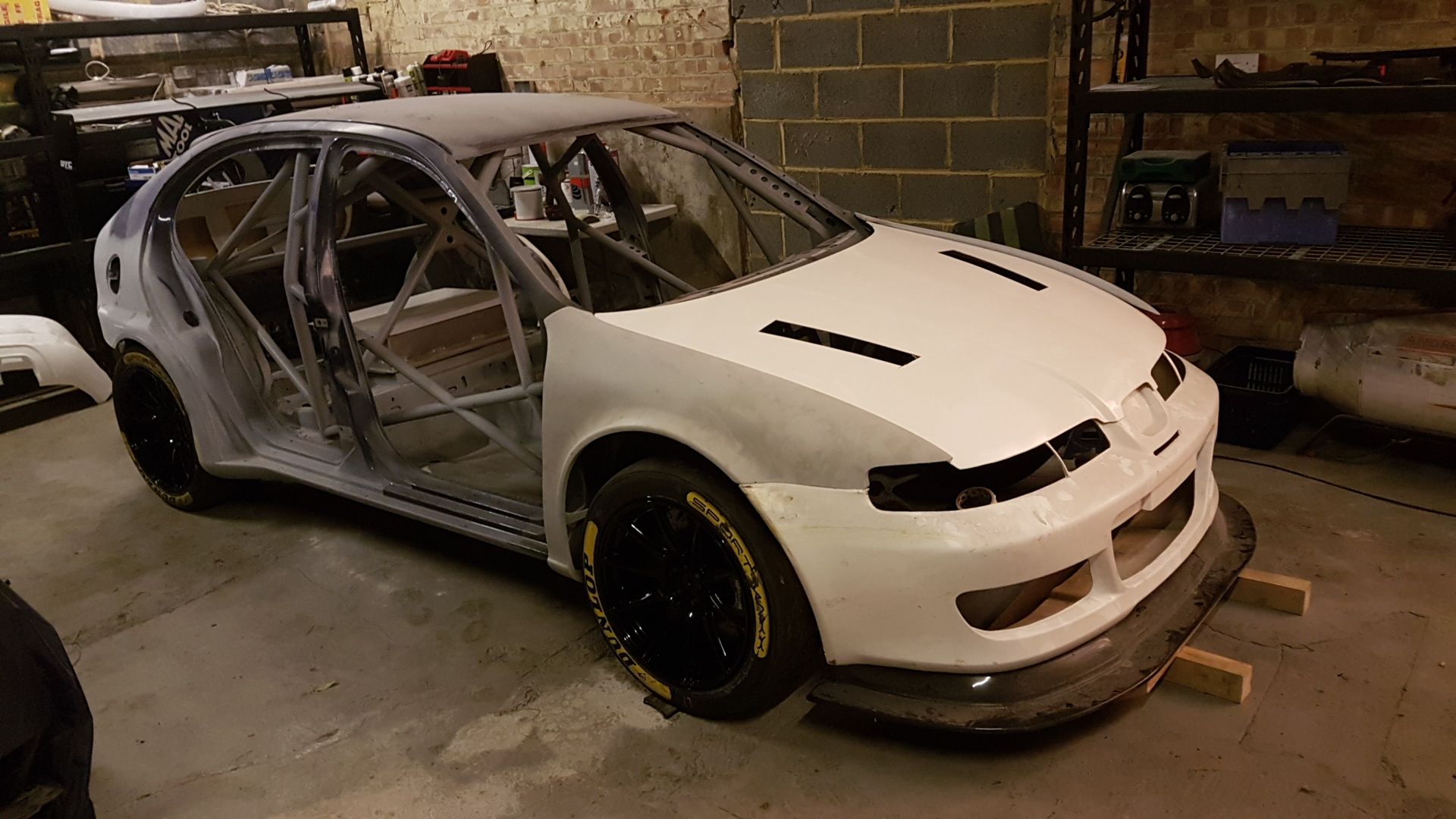

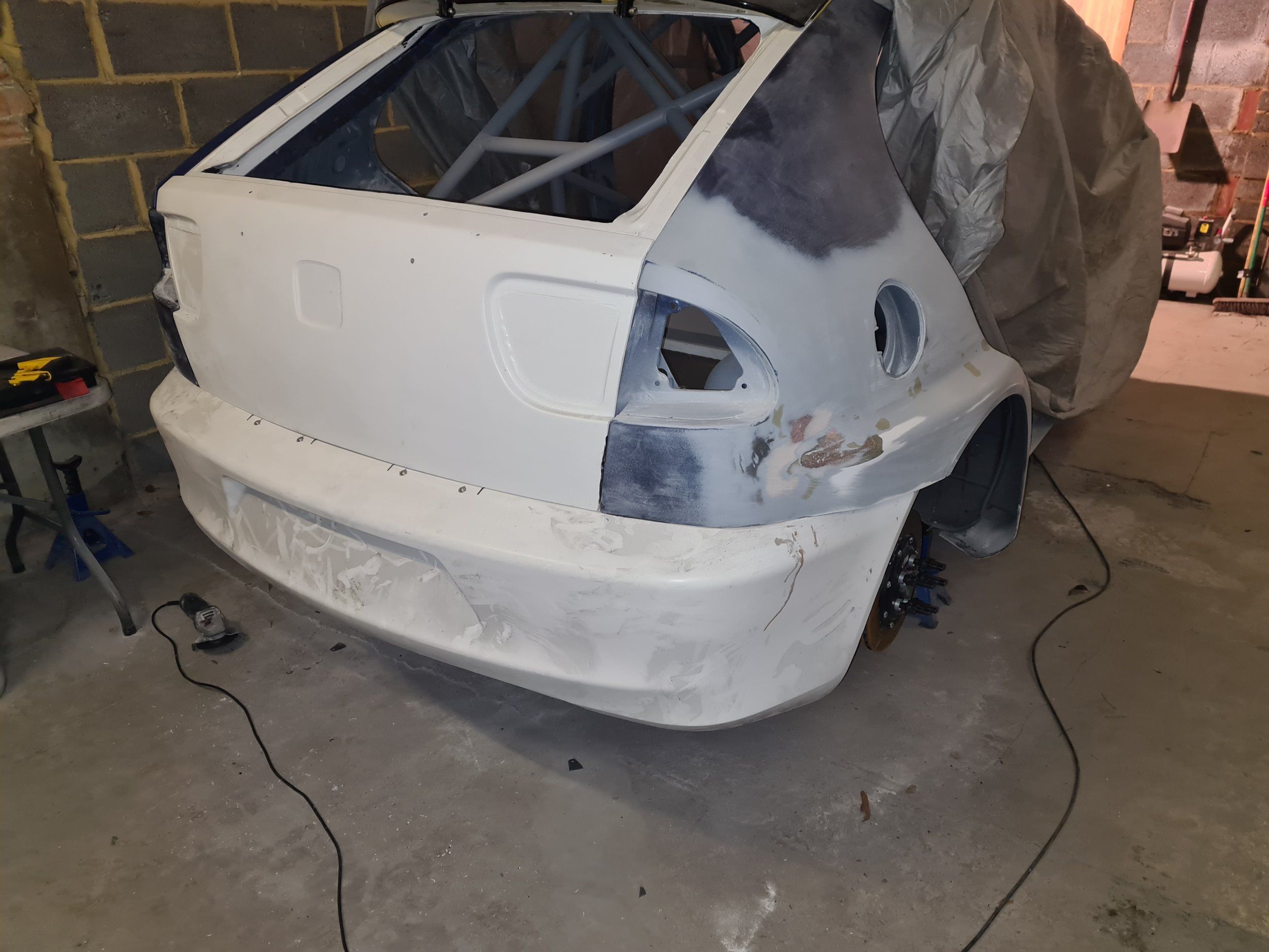

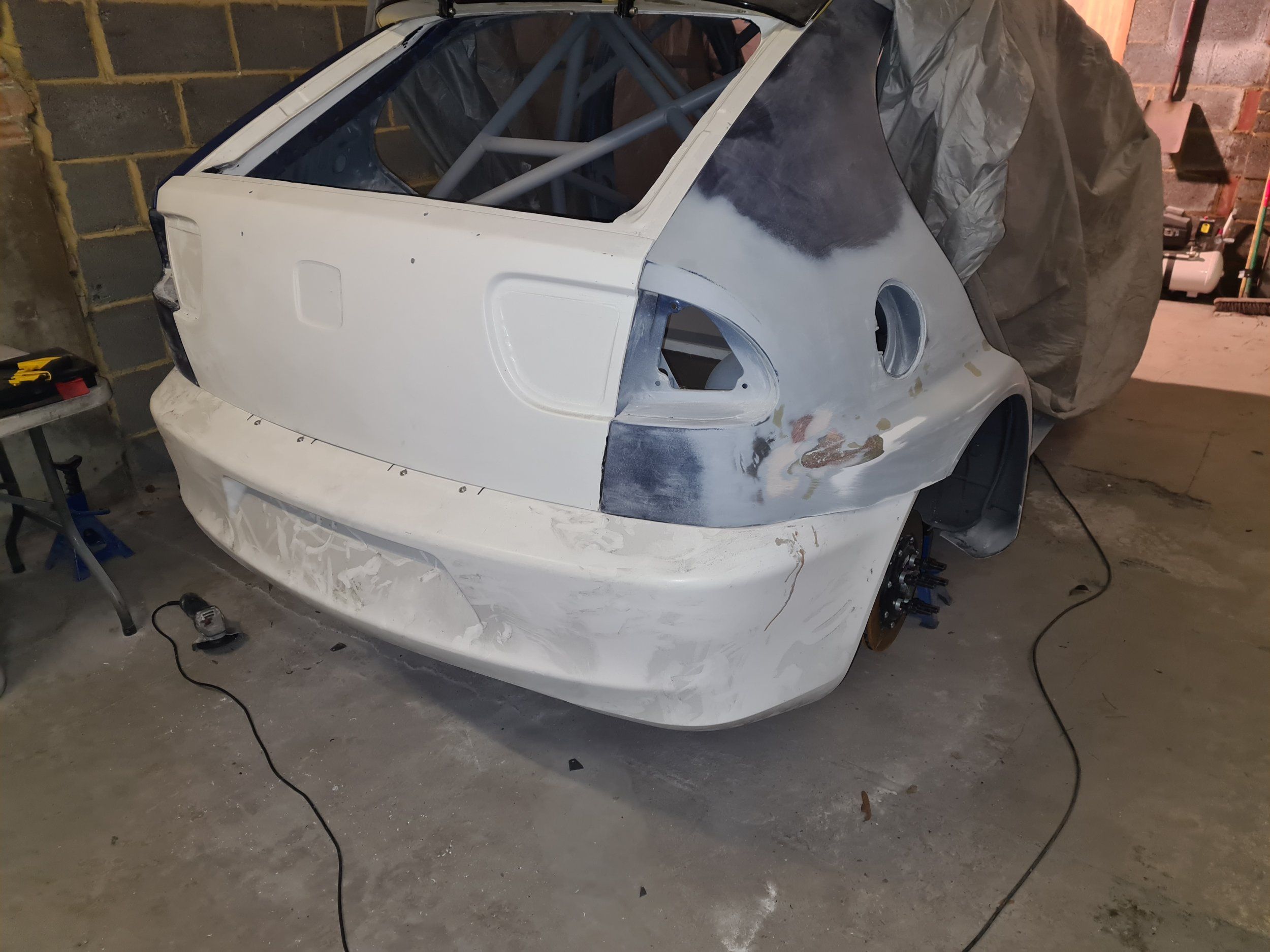

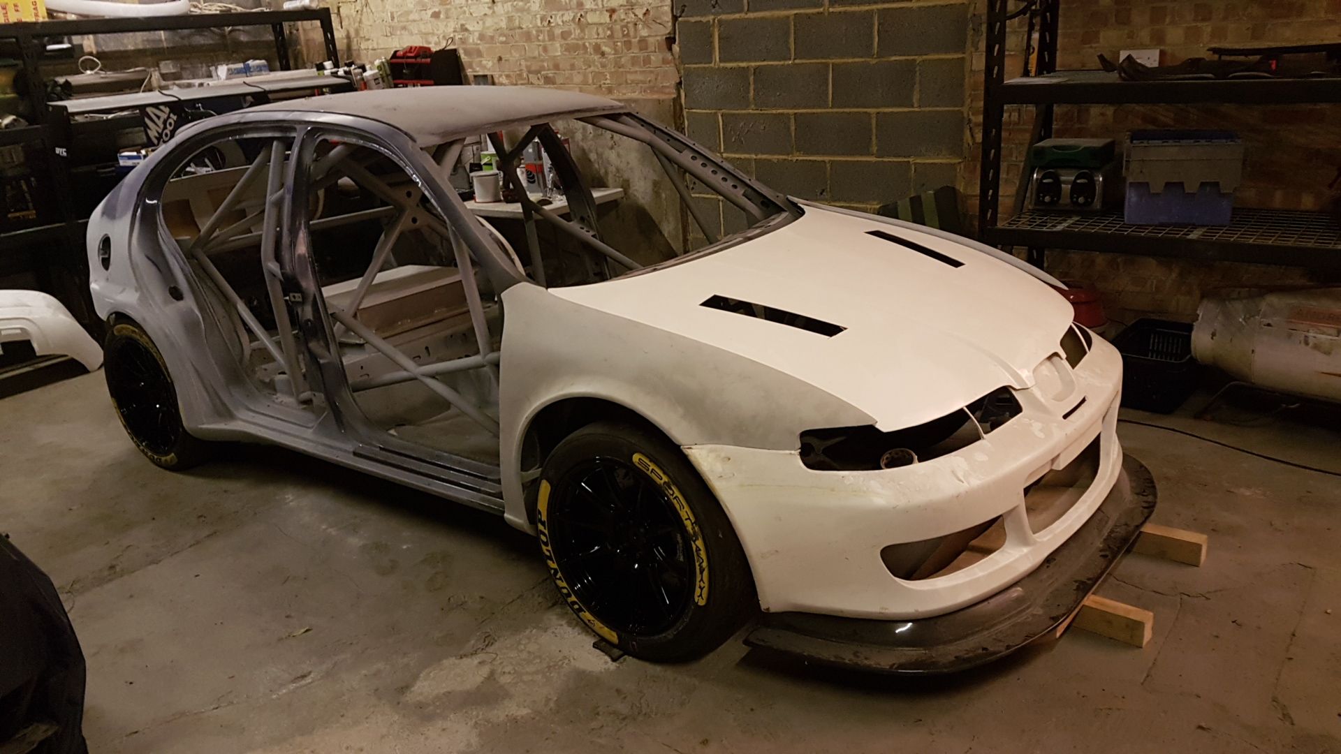

The boot, bonnet, rear bumper, front bumper, splitter and the carbon door cards came from John. The rear quarter and door pods are from abs motorsport.
I am now looking at the fibreglass door skins... possible the complete doors. But problem being I not sure where I am going to race the car so staying metal at the moment till I find a home for it lol.
But I do say xsports stuff is very good and good price too.
The front wings I found on gumtree. I think they are the ones from ebay... the pics show all the panels

Again lack of updates....... but things are going on tho... a 2.0 tfsi crank is off being lightened, knife edged, semi dewebbed and balanced.
The car is booked in to some where to have the seat rails welded in as they seam they could be a batch to do.
My plan is when the car is away I am going to paint all the panels .... but let's see what happens lol
