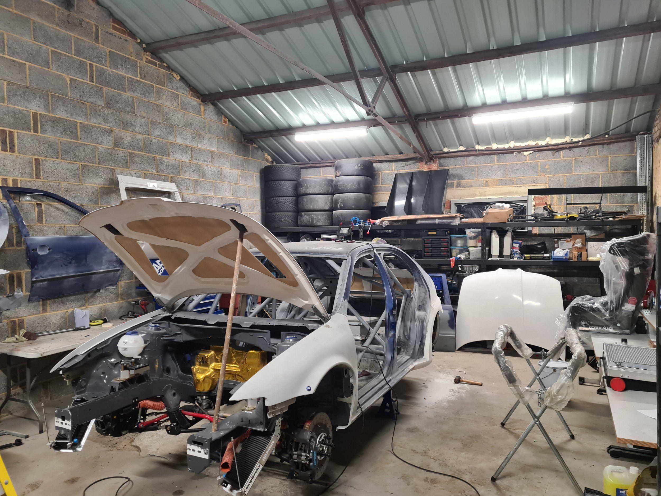

Also had no lights today either. They kept tripping the power. So ripped them all down ran new wiring and fitted 4 new LED strip lights
Can sort of see what's going on now

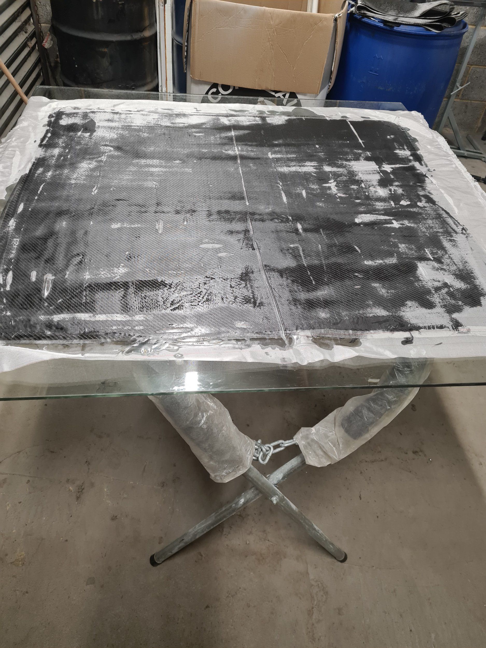

Had an evening at the yard... I thought I would have a go at making a carbonfiber sheet for covering the spare wheel well I have cut out

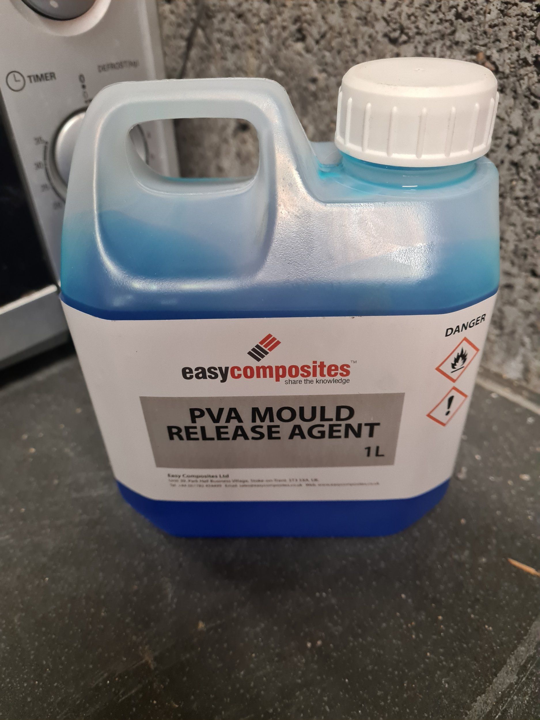

So I started with a sheet of glass. Cleaned it, then used a degrease then polished it.
Then gave it a coat of a PVA release agent.

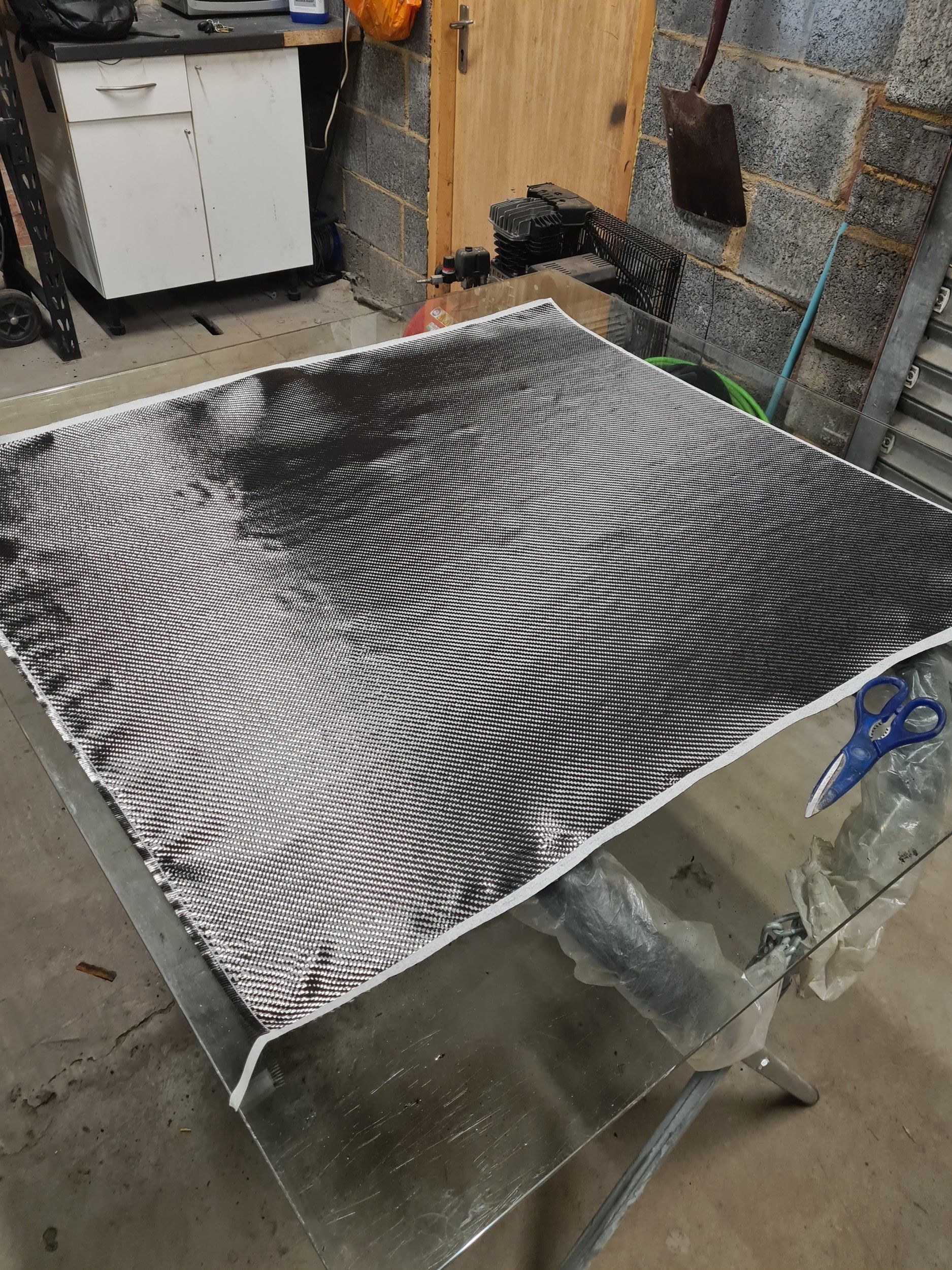

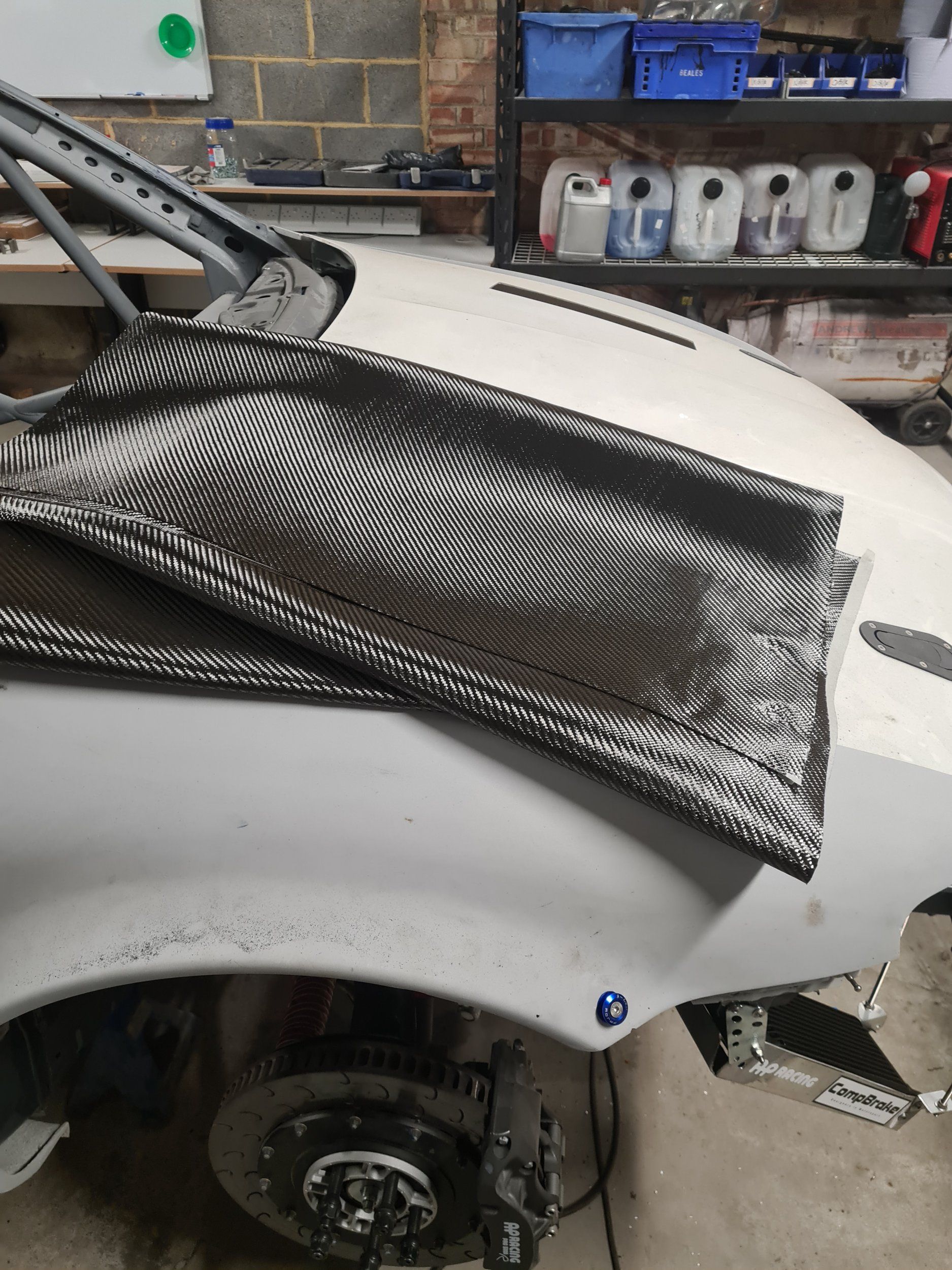

So I had a roll of carbonfibre

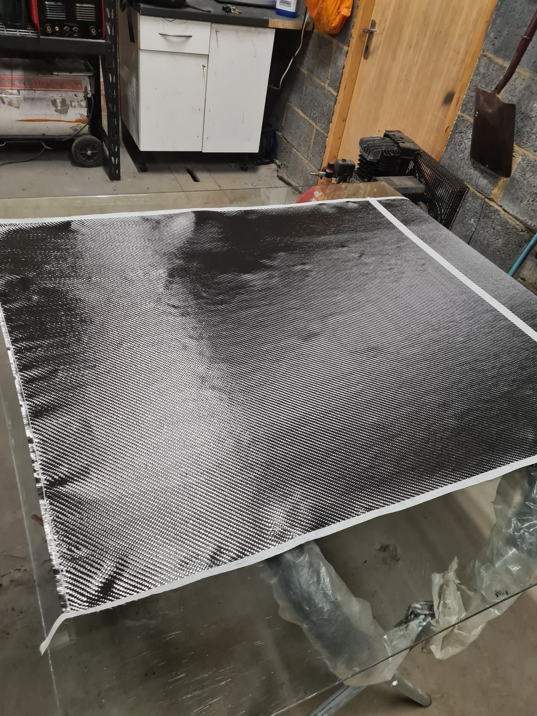

I marked it with masking tape to a rough size of 850mm x 950mm then cut threw the tape this will stop the edges from fraying
Then I cut 4 sheets to layer up ready.
So I layer the first sheet down and squared it up to hopefully look good. As the first sheet down on the glass will be the one on show.
Then repeat. Next layer and then with a paint brush cover the carbon. Then the next and the next
Then I put some thing called peel ply on top. This is ment to soak up the left over resin but it won't stick to the carbon
And this is how it was left in the workshop... tomorrow will be the tell tale if it works or not. So will update tomorrow

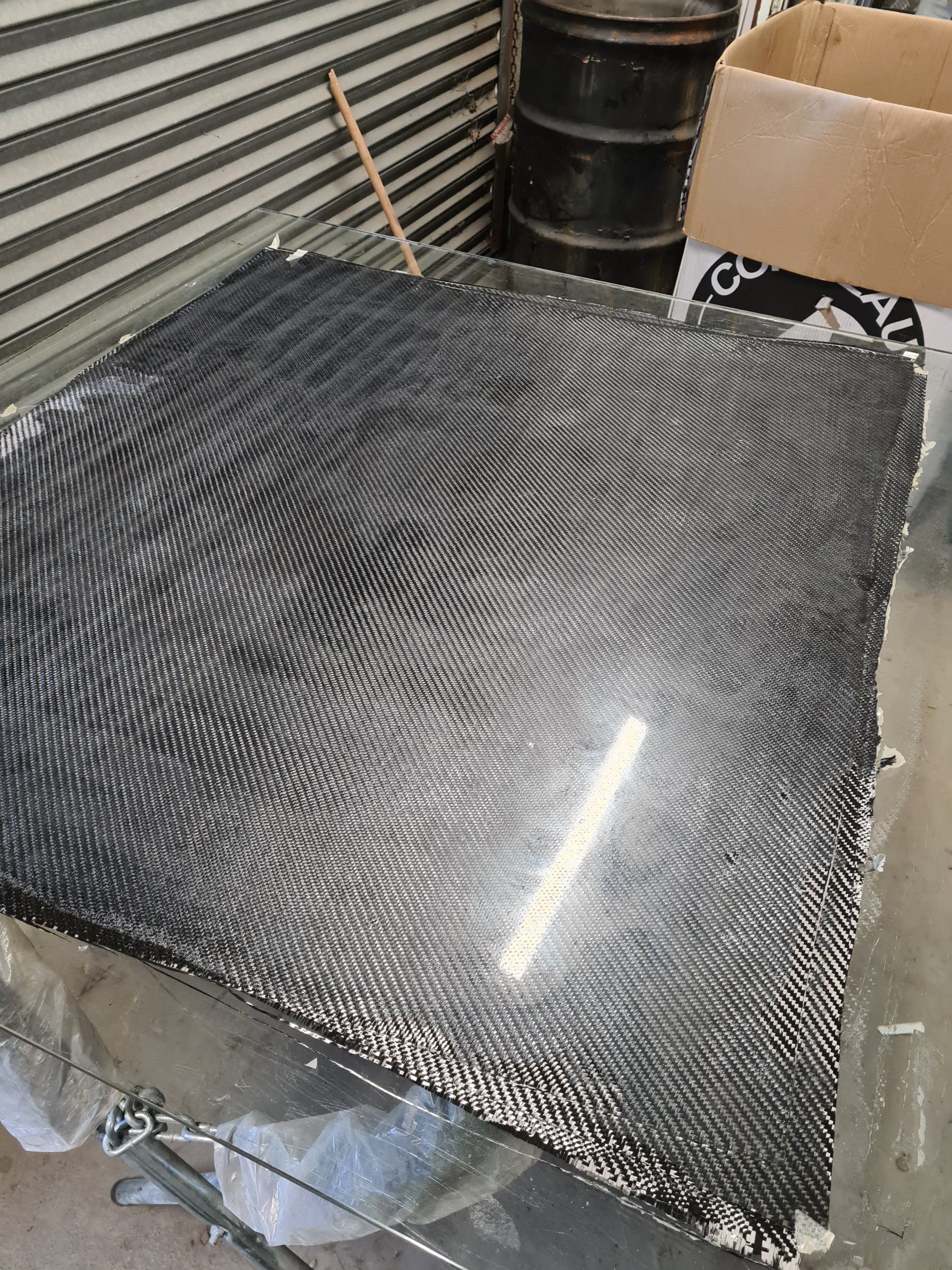

Wellll. It's off the glass...
It's not to bad for a first attempt... think I needed more release agent on the glass. I had to scrap it clean with a razor blade.... right next attemp. Not sure what to make tho... was thinking of doing the splash sheilds in the wheel arch . But do them out of kevlar carbon mix .. any one got any ideas

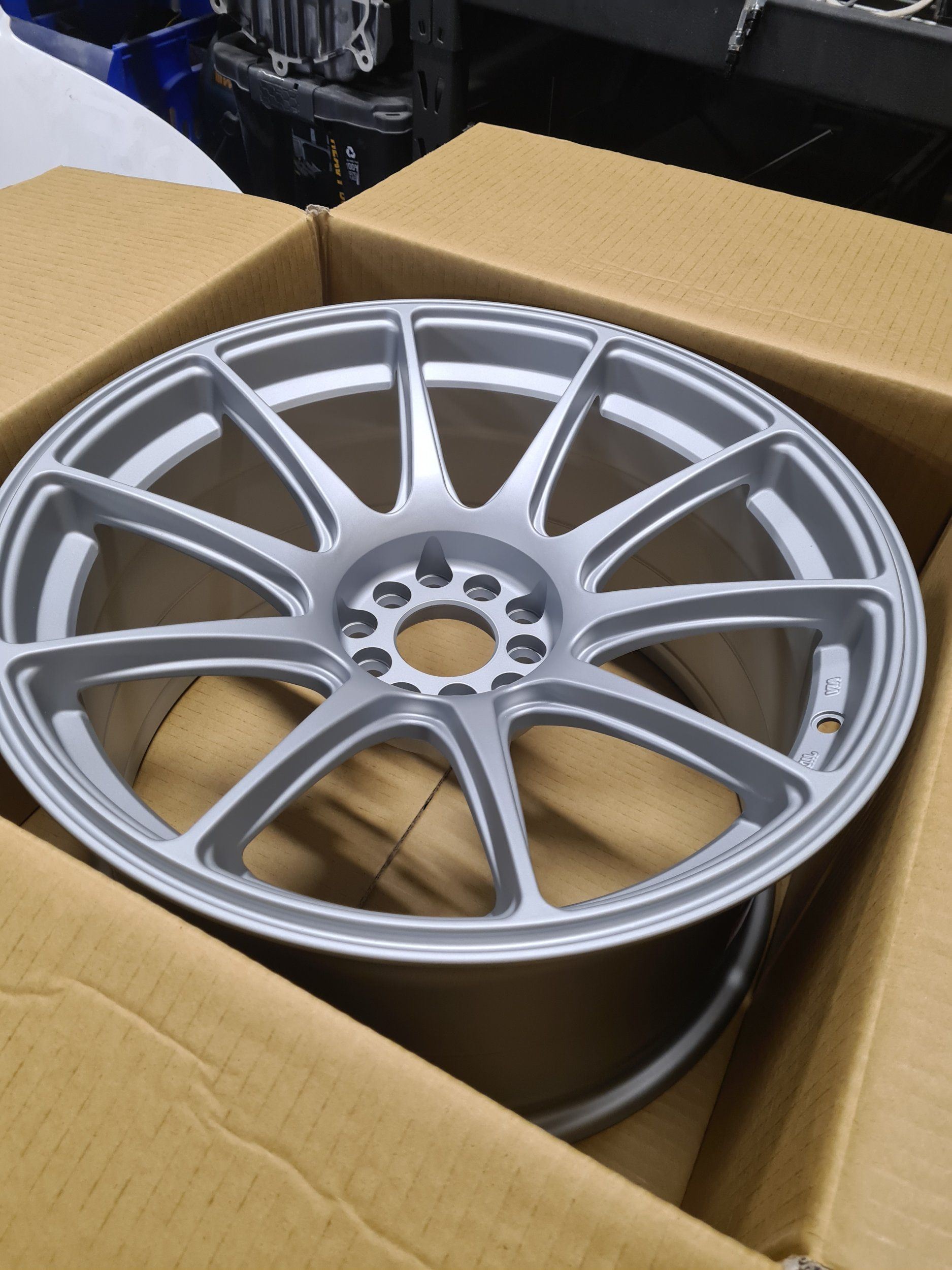

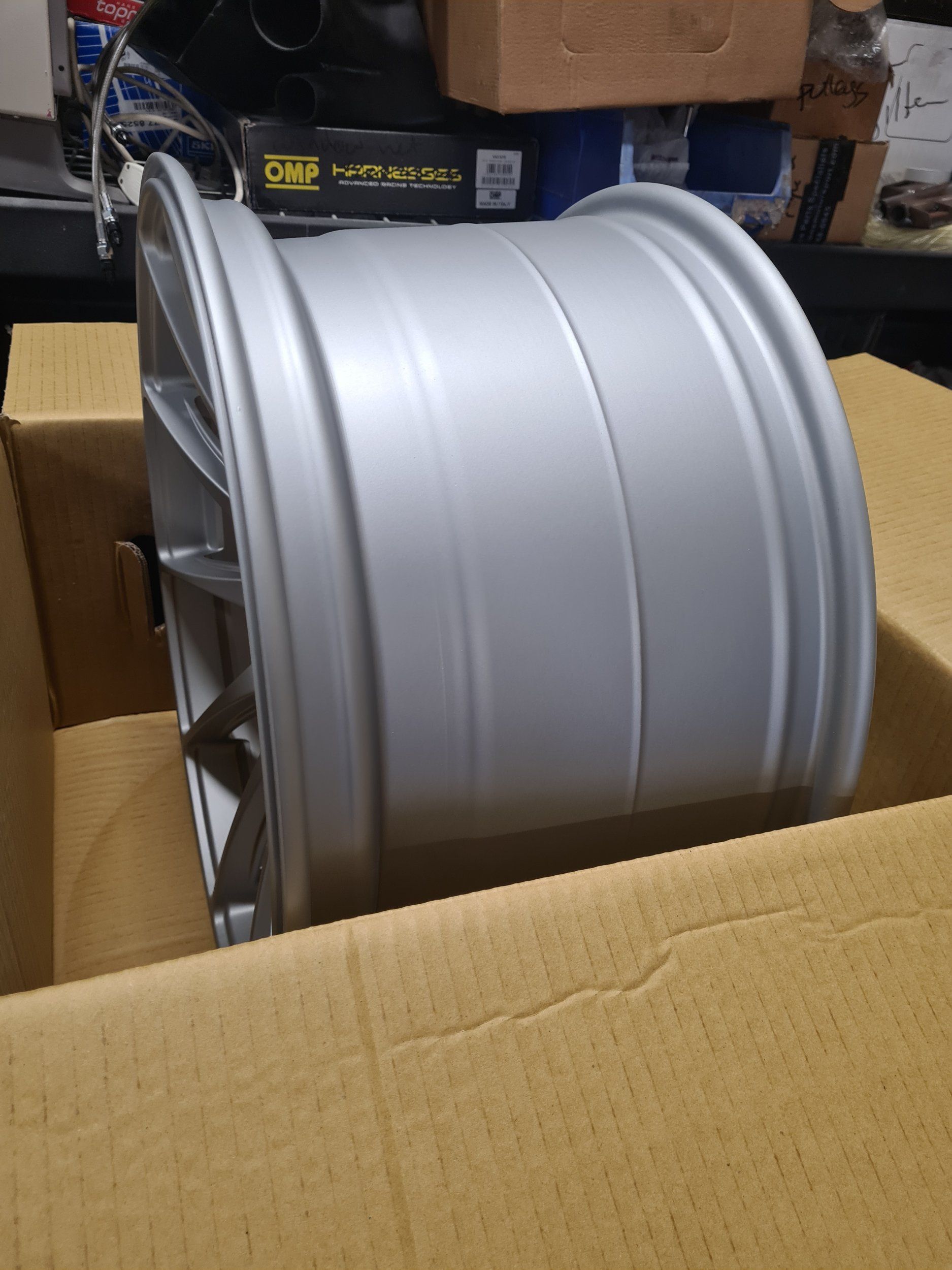

Nice and wide... 9.75 inches.
These are going to used for the wet weather tyres

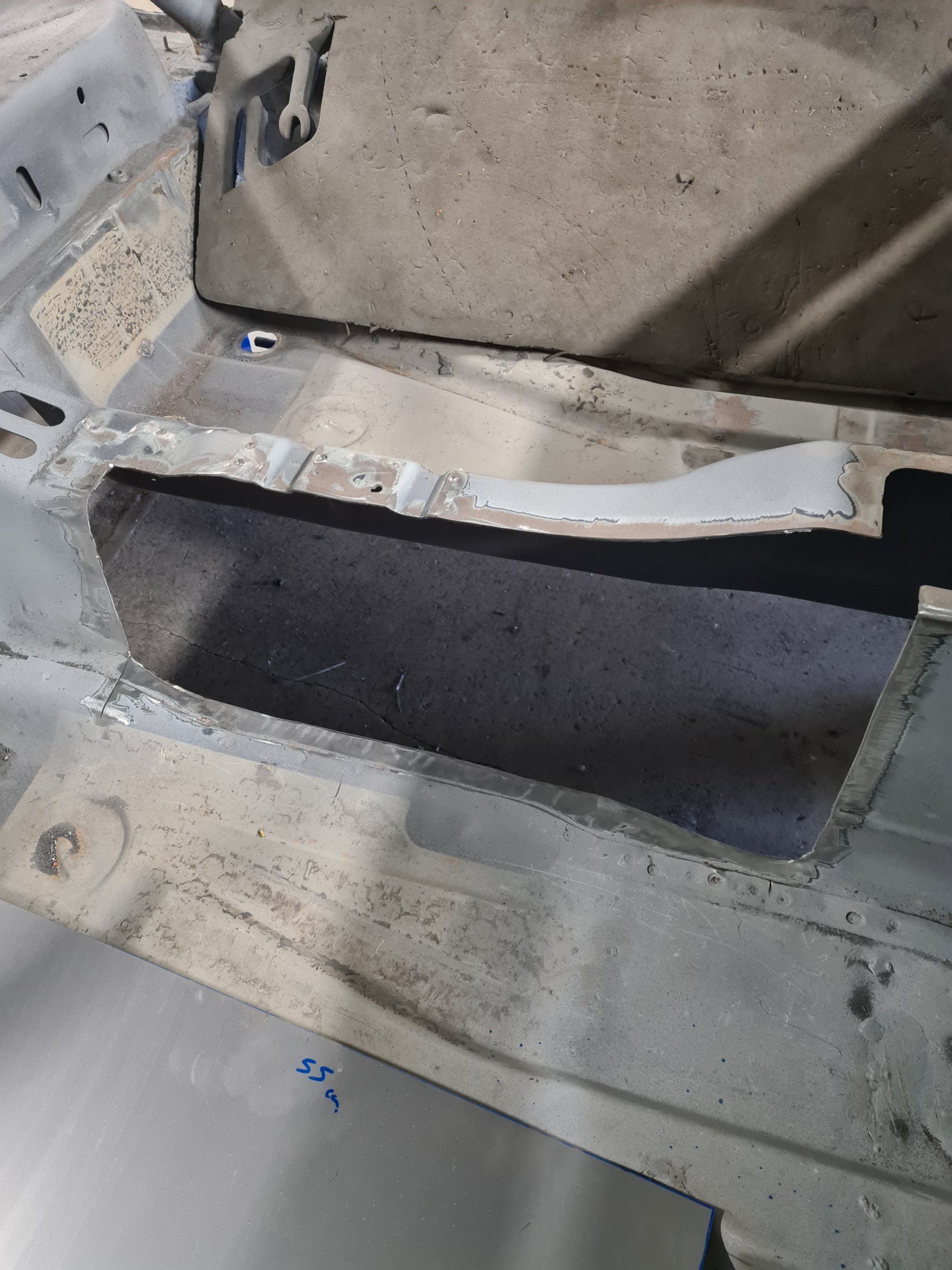

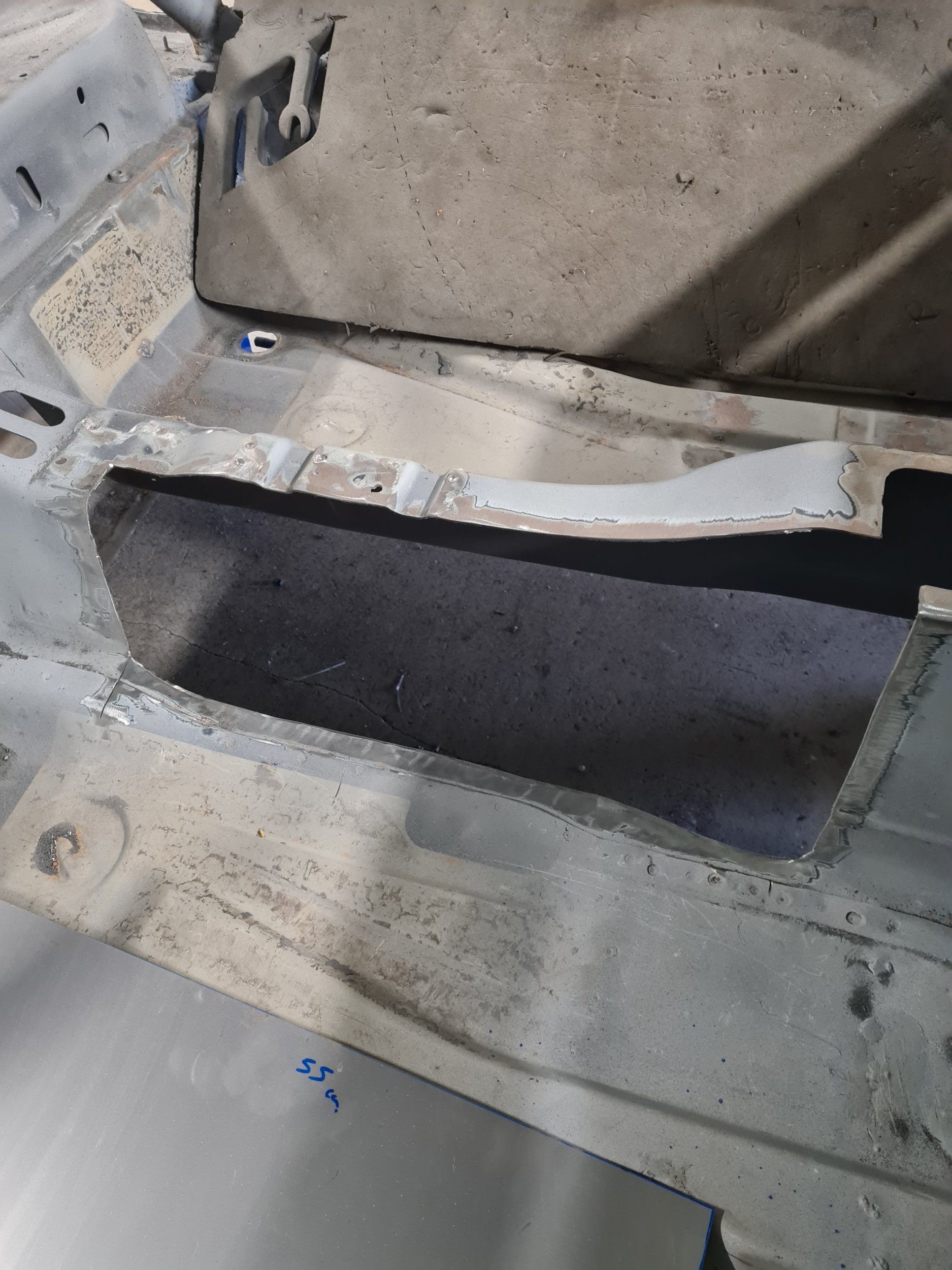

Had the grinder out. Cut the floor ready to start moving the seat over

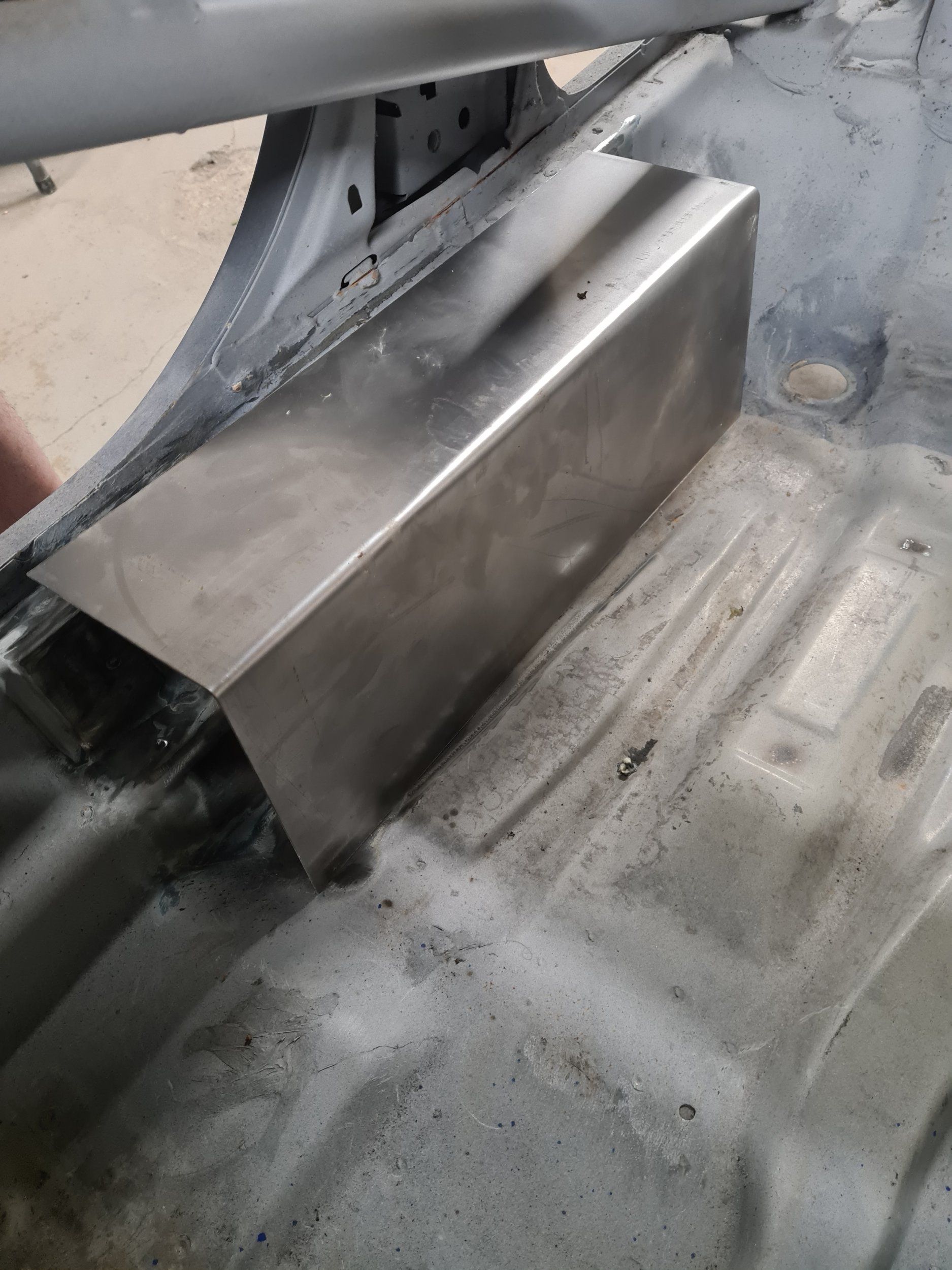

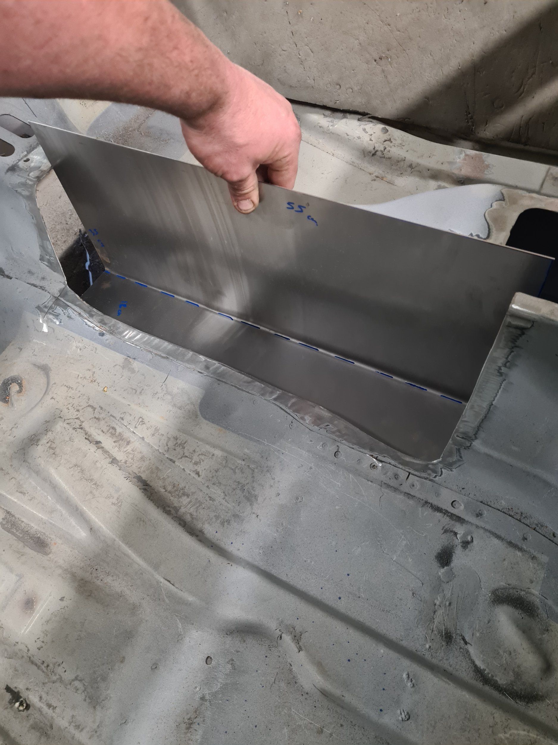

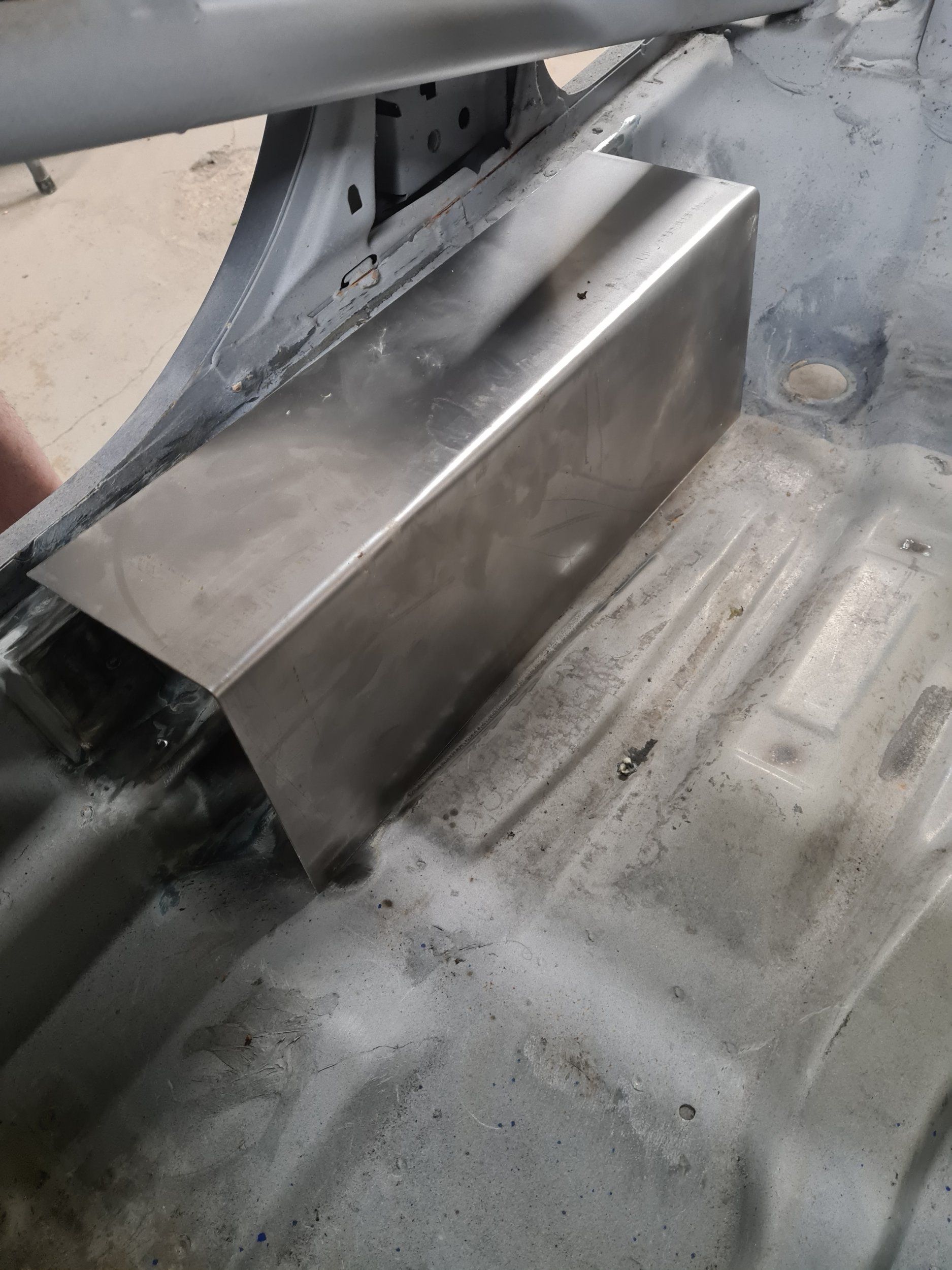

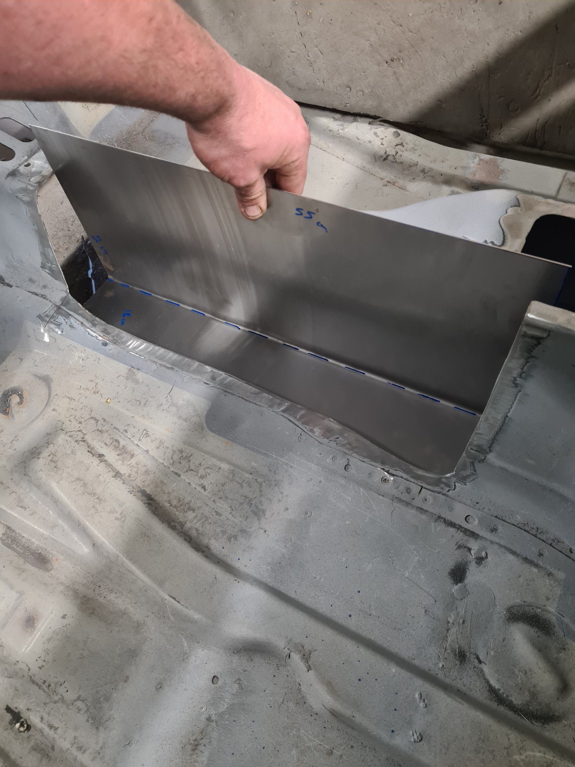

Had some 1.5mm sheet, so cut it over size a bit and bent it to 90° this week end we will shape it more and cut to size
And by doing this and keeping the seat rails shortish to normal lengths and not extending from the door sill to the reshaped tunnel. I am going to box the sill inwards to basically just move across
Then weld in the seat rails. Hopefully this will move the seat over and still stay strong enough.

Had the grinder out. Cut the floor ready to start moving the seat over View attachment 24743
Had some 1.5mm sheet, so cut it over size a bit and bent it to 90° this week end we will shape it more and cut to size View attachment 24744
That must improve also the weight distribution to the center. ?
It seems as a never-ending project as new to do work showing up in the list. I personally would feel overwhelmed by this :help:. Congrats for the work.
