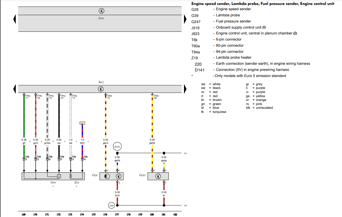

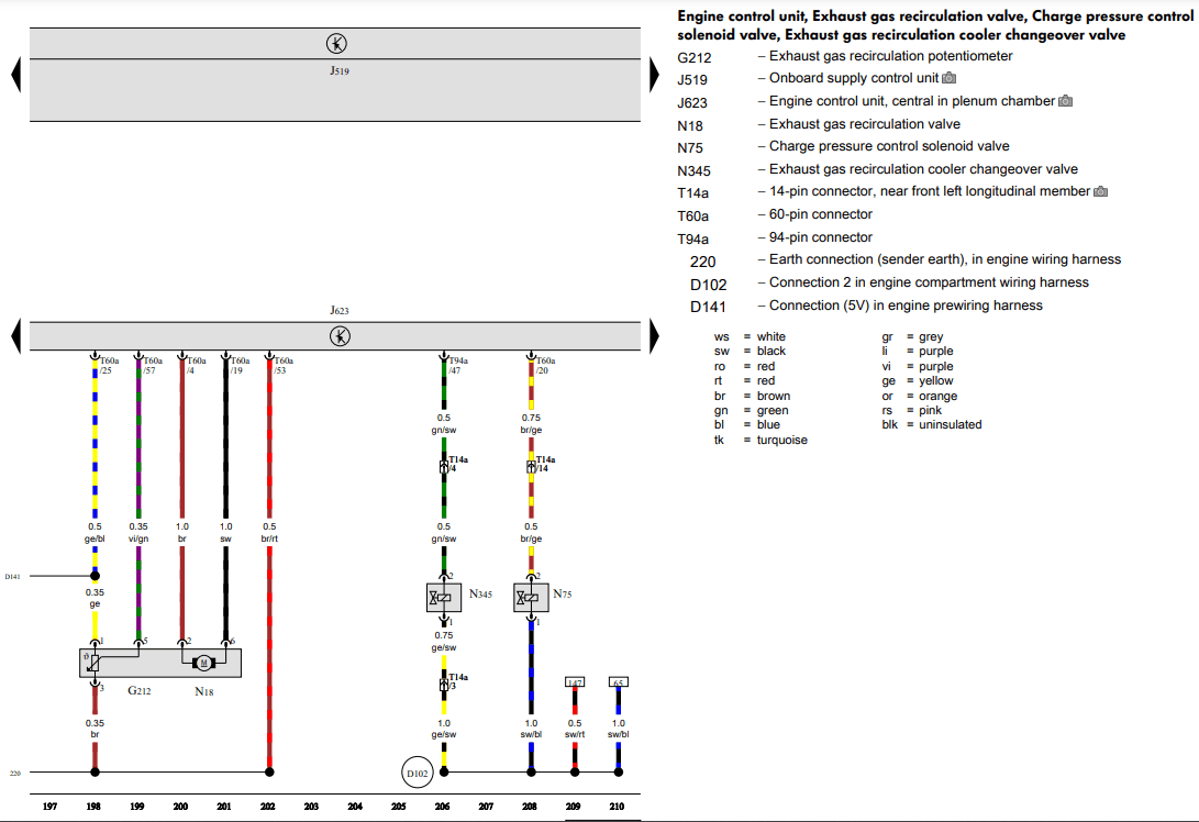

I've gone through the current flow diagrams and located the 5v wire. The sensors that are connected, Engine speed sender, Throttle valve potentiometer/throttle valve module, postion sender for the charge pressure positioner, EGR potentiometer/ EGR valve.
I've con-checked from the ECU plug to each sensor via that wire and all are good.

I've also attached the wiring diagram.

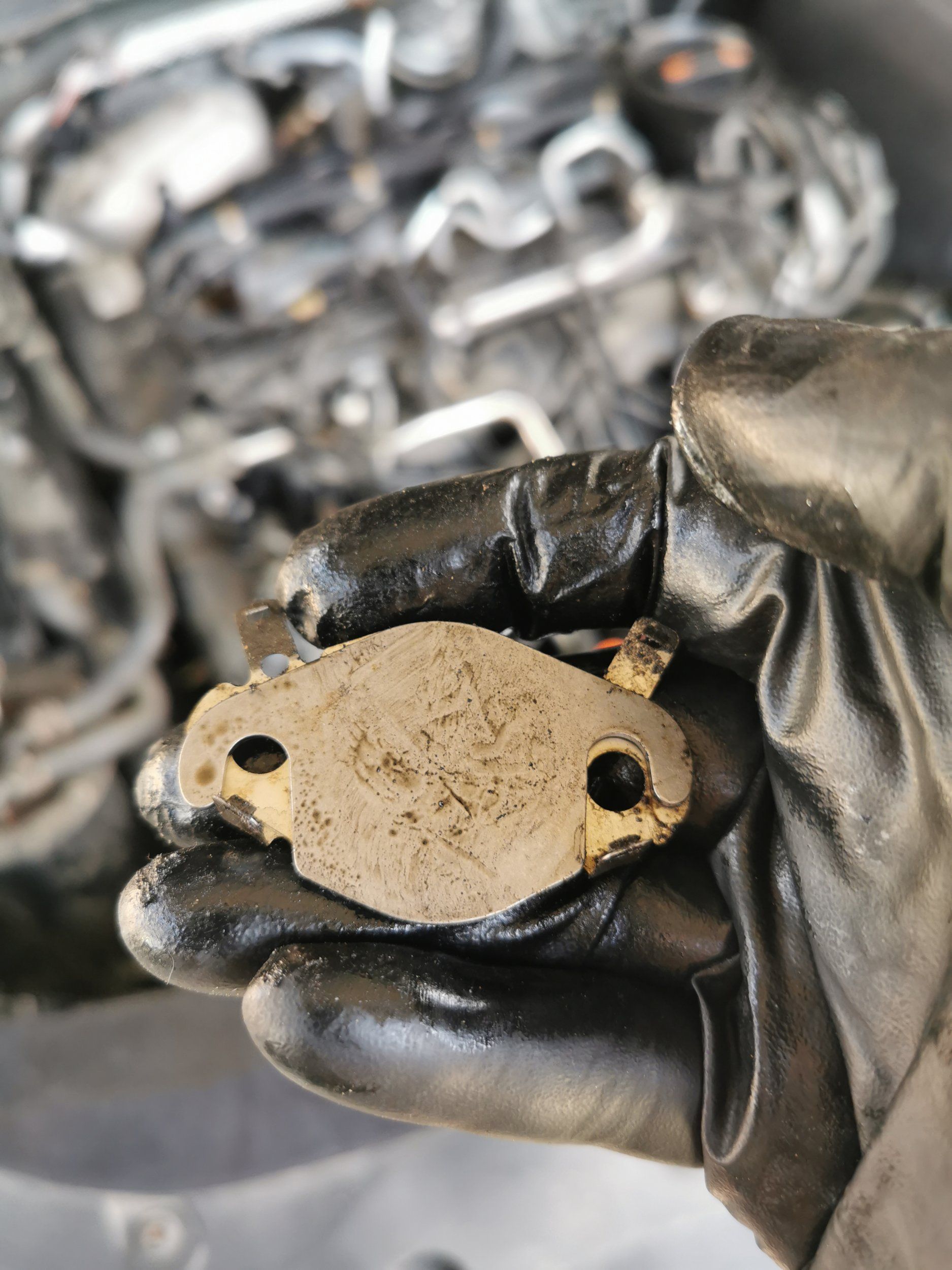

I've just noticed a blanking plate on the block side of the EGR pipe that runs from tbe throttle body to the block.
I have no history regarding the EGR being blanked. I had the car for 2 years before any issues. Any chance, (if this wasn't mapped out) this could be an issue? Feels like it would of flagged up sooner if it was an issue.

It sounds like you're doing a good job in checking everything that needs to be checked mate. These kind of intermittent faults are the worst to troubleshoot. Not sure what else to suggest really. In my experience it's usually the wiring and components that get hot that are most likely to be at fault, but when you have so many sensors on one reference it's difficult.
If you know someone that has VCDS then could be worth plugging it into that and seeing if there are any more detailed codes which may help. The P codes are generic OBD2 codes, whereas VW have 5 digit codes that can be more specific.
Edit re EGR: Like you say though i wouldn't have thought the actual deletion would be the issue, but if the EGR has been deleted and it's wiring plug is not connected to anything, that would be a prime suspect for some sort of corrosion/water ingress issue etc. If the plug still has a 'live' 5 volt reference in the connector, there is a chance that it's finding a high resistance path to ground. Not enough to blow the fuse, but enough to pull the voltage low etc. Worth a look for sure.

The EGR sensor was plugged in. Everything looked fine with the plug side. Couldn't see the sensor side.

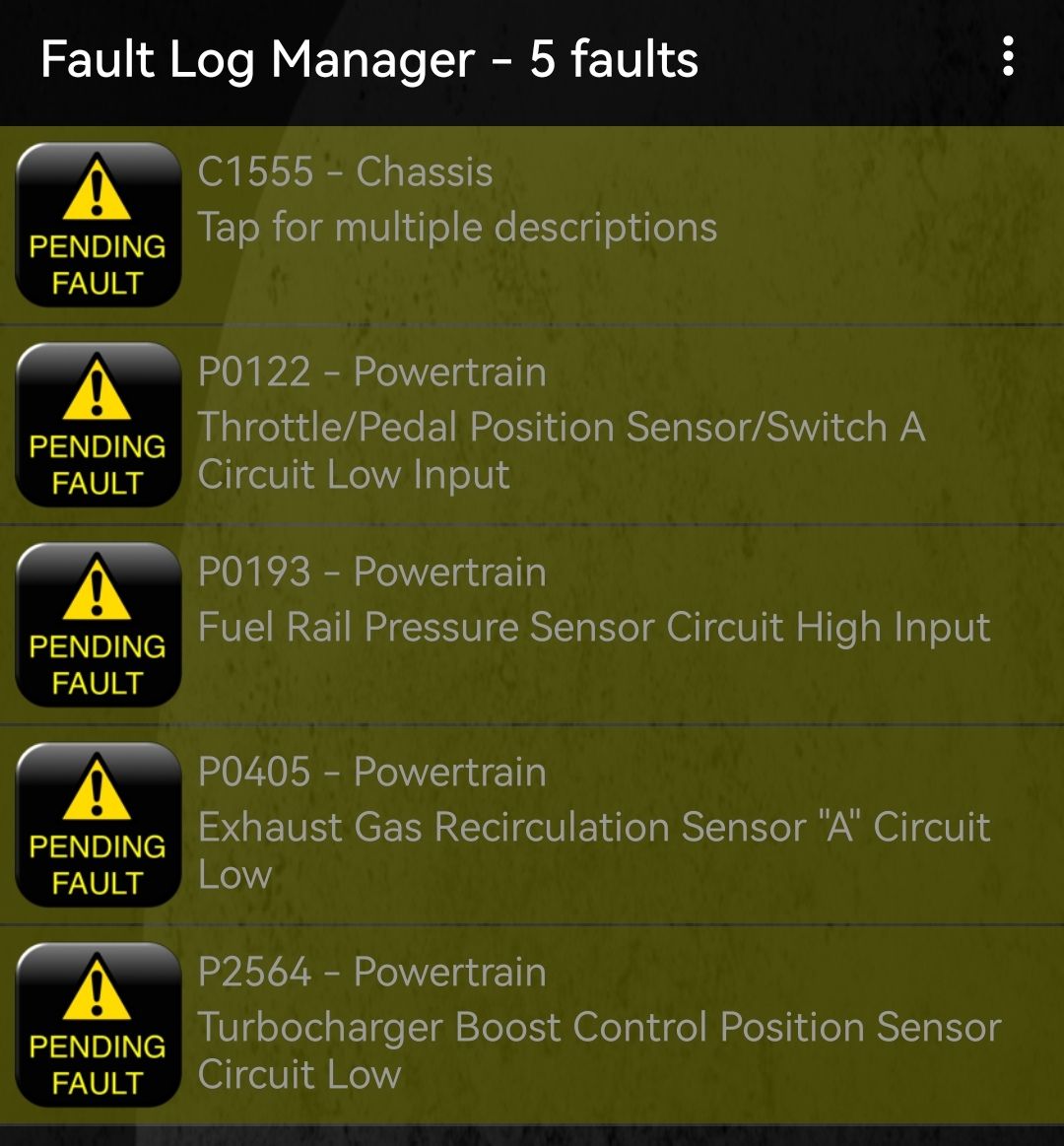

Another update. I've put everything back together. Cleaned up the throttle body. Cleared the codes. Noticed theres a throttle postion gauge on the obd app. Its reading 1.57% with the engine running and off. Moving it with my fingers doesn't change the value either. Guessing this is shot? Or could it still be the wiring/ ecu?
I'm now getting these codes instead of the P0641(psb). I'm unable to clear them as well. All these are on the 5v ref circuit.

It would normally see battery voltage. In the diagrams above its the purple wire and purple brown wire going from ecu to throttle valve potentiometer and the purple green wire going from ecu to the egr sensor.
Hmmm, that's a difficult one mate. Given the various fault codes, (some high, some low) plus that fluctuating voltage on what should be 12v, makes me wonder if you have some sort of short between the 5v reference and the 12v from the battery? Maybe disconnect all the power and measure the resistance between the 5v ref and that wire that should be 12v, and see if you have a short between the 2 somewhere.
As for the throttle sensor readings, are you sure if it's the pedal potentiometer position, or the one on the throttle body? Sometimes the labels aren't correct on live data. Even if you are sure it's the right one, then without the 5 volt reference being correct/present then you could get all sorts of weird readings or none at all.
Only other thing i would suggest is maybe unpluging each sensor that uses the 5v ref one at a time, then seeing if you can delete the codes etc. If the fault is with a sensor rather than the wiring, then hopefully the rest of it will come back online when the bad sensor is unplugged. Obvs you'll get other fault codes relating to the sensor that is unplugged, but if the 5v reference codes disappear that is the key.

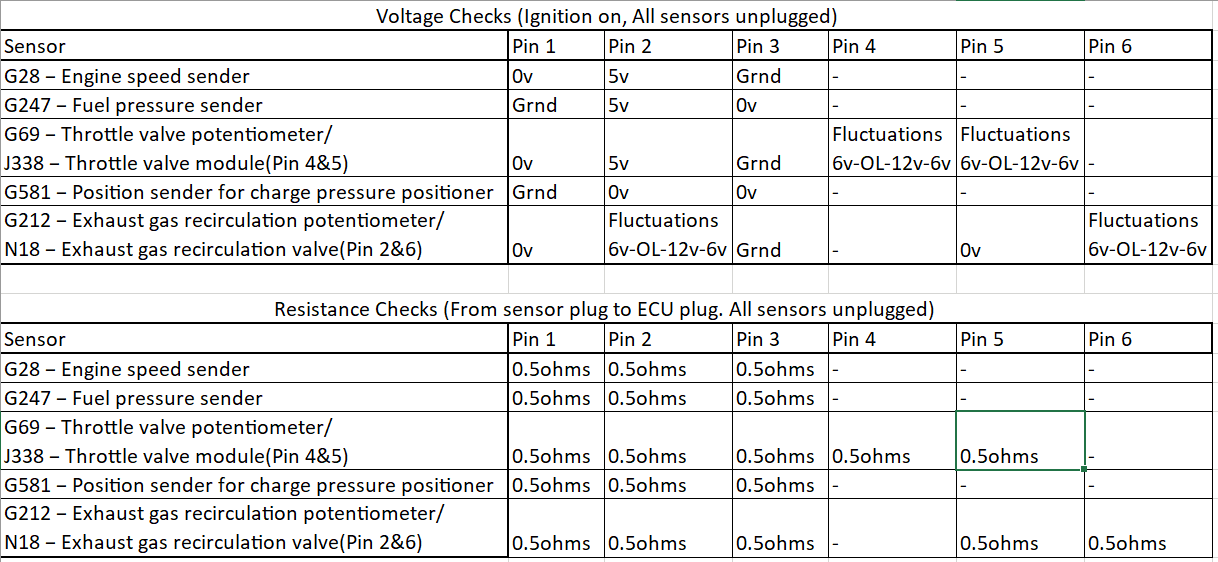

I've gone back through all my checks. Con-checking everything wire from sensor plug to ecu on all 5 sensors on the 5v ref circuit. They are all fine, 0.5ohms.
I've con-checked the grounds from plug to ecu and ecu to chassis. They are all fine as well.
I've checked the voltage at each plug. Egr, Throttle, Fuel and speed sender all receive 5v. The Turbo does not. None of the 5 sensors receive 5v at the 5v ref wire.
I'm still getting the fluctuations on the EGR and throttle sensors at what normally read Bat voltage. These are also the only sensors that are more than 3 wires.
On vcds I opened up each sensor to view what voltage they are displaying. With ignition on, the fuels showing 4800.2mV, Throttle 92.6mV, EGR and turbo 0.0mV.
When unplug the throttle sensor that jumps to 4999.8mV.
That's all the evidence I've collected. The original fault codes gone now and its been replaced with all these other codes. With the addition of the fuel one.

No continuity issues between different wires.
Managed to clear all the faults except the fuel pressure sensor that wont budge. When I start the car all the other faults come back.
Belows the codes that now appear. All still the same sensors on the 5v ref, but the speed sensors coming up now.

Summary:
Initial fault P0641 Sensor Reference Voltage “A” Circuit/Open.
Wiring diagrams:
Checks carried out and results:
Put everything back together, plugged in VCDS. The original fault has been replaced by all 5 sensors on A circuit. Test results are attached.
Decided to test the motor on the ASV. As shown on the spread sheet, here and the egr motor give me weird voltage fluctuations. See thjs video: https://youtube.com/shorts/D-cEnCqN6Mo?si=UjP9GSjzSsDpDKjB I’m unable to output test anything due to ‘refused by control module’ message on VCDS. Actuating by hand cases do not change readings on the multi-meter, across the variable resistor. The flap is also fully open and fails to move under any circumstance.
Im struggling to makes much of all this. I feel like im chasing my tail at this point.
If anyone has anymore suggestions, please fire them my way!
