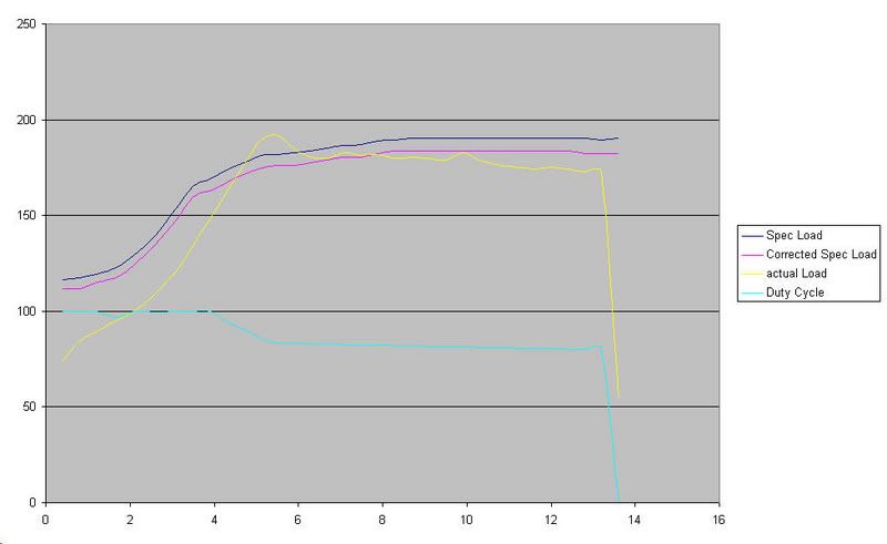

114 Plot
You can see that it's making more than the ecu is asking for, at which point the wastegate duty cycle drops as it gets pulled back.
Overfuelling, but Phil's already said that.
