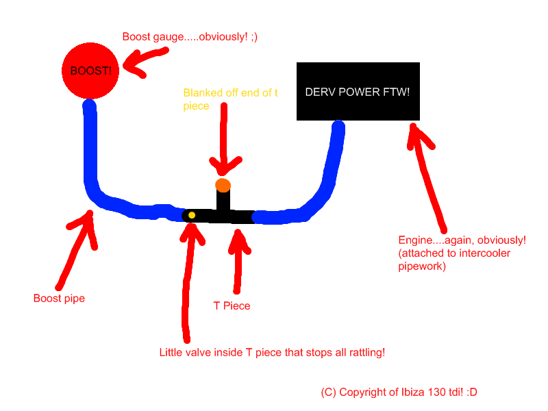

Anyone got a picture of this restrictor to stop the buzzing?? Wheres the best place to put it?? do you simply just cut the pipe from gauge to boost pipe and join it in??
Correct. Basically you have one boost pipe. Along that line somewhere, cut it and put the T piece in. Block off one end of the T piece and just connect the pipe to the other two - making it one complete pipe again. It's best to put it somewhere where you can get to it if you have problems with it in the future. Like I say, I've run my boost pipe from drivers side of the engine bay, through the passenger side bulkhead and back to the drivers side. I've got my boost pipe going behind the dash and put the T-piece behind the glove box.

I may sound dumb but im kinda lost lol. Someone must have a picture or diagram or can draw one quickly in paint lol
Do all t pieces have this valve thing inside? cheers for the picture mate :)
I'll be doing that tommorow to get rid of my annoying buzz sound lol. Nice drawing mate, I wish I had your artistic skills :p
i took my gauge back to halfords today after realising it didnt come with a tpiece, new t piece now fitted and no buzz, horay i can enjoy driving again
the Halfords Autogauge comes with a T-Piece with a brass inline valve.

iv been drivin round with out the t piece in for ages then i found it in my tool box at work now iv fitted it and its so much better.
iv put mine behind the pocket on the drivers side so its easy to get to
