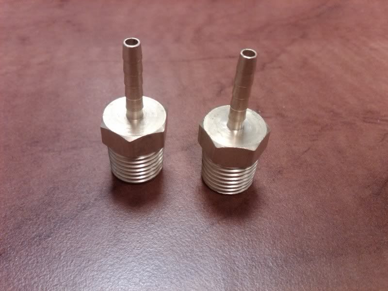

You have to take the intercooler pipework off Andy and drill a hole through, then tap a nipple into it so you can connect the boost gauge. It's not just a plug and play thing. Then you have to find a way for the boost pipe to get into the cabin from the engine bay and feed it all through....
Bought these today.....
i intended to buy one but as they were overcharging me (the manager) the guy at the desk told me to take two lol
so if anyone needs one give me a shout
