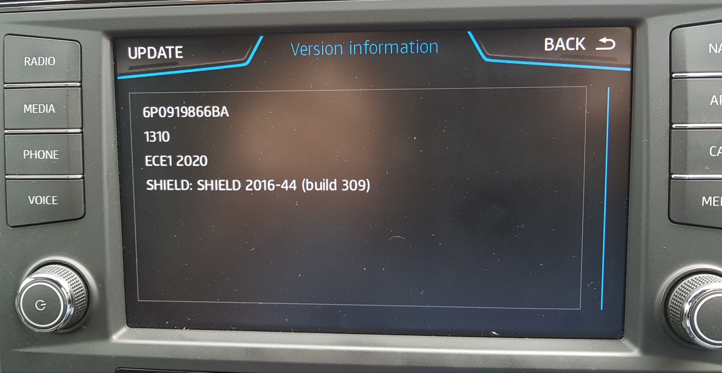

Bedlam, yes it was off the seat site as per Stupras link 6PO euroup 1 I then unzipped it direct into my formatted seat card and replaced the overall.nds with the one from my original map and bobs your uncle I have 1310 on my sat nav. You try it.
Tell
Full Member
My sat nav after upgrade following Stupras instructions View attachment 8657
Did you reboot before you put the SD card back in so it didn't generate an SVM error ? ;). Probably not, that was never in Exciter's original instructions that became apparent when people ran VCDS checks later. Works with the error but better not to get it in the first place since garages won't clear it and it's fiddly to do yourself. Some people never manage to get rid of the error once they get it.
That's the zone 1 European map. I recommend sticking to the all Europe download so you replace like with like rather than the zones.
Thanks but I have been rolling with 1310 since 20th of June
