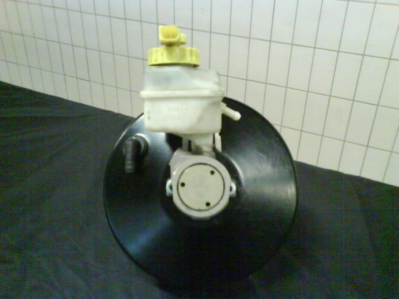

Built this up today at work ;)
Together with the 9" servo it should work well.

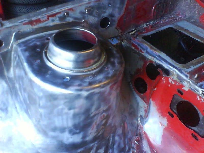

the front of the res rubs slightly on the suspension turret so i ground a couple of mm off to help but it still fits, take it this is for a hydro pedal box etc...

I may well mod the turret a little if needs be as its kinda in a state where it could be done.
But yes i am converting to hydraulic but was also looking for a better clearance as mentioned by yourself. The chap who built the car ground a bit off the original master cylinder which looked awful.
Is it the cylinder body or the reservoir that is the issue?

its 23.8mm 2 ports left hand side its a stubbie master cylinder.. and its from a mk3 ibiza cupra 1.8 20vt 2000 - 2002 not sure what else its on ..
