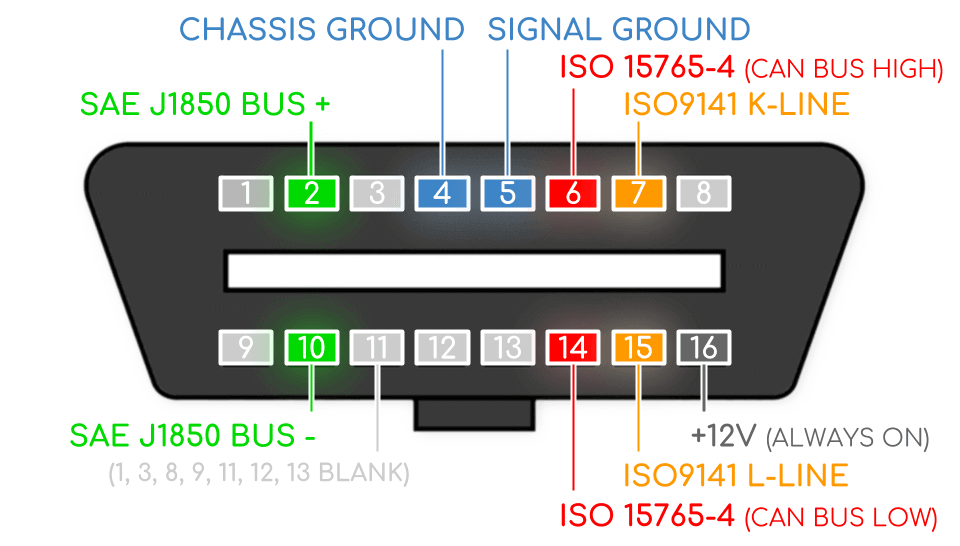

Usually I would say its definitely related to the fact the scanner won't connect, but then if you have sparks at the plugs, i really don't see how taht can be the case. Do you have voltage at pin 16 of the OBD 2 socket? Will the scanner not connect to anything, or just not the ecu?

Plug in scanner/reader and it just fails to talk to anything, nothing... its all alive and stuff on the screen and you can select what ya like BUT as soon as tou go to Scan or any bloody thing....
“Connection/link error“
