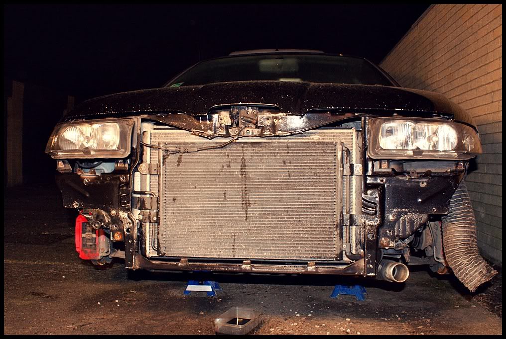

Bumper off
You can't see it that well in this pic, but the samco is definitely kinked

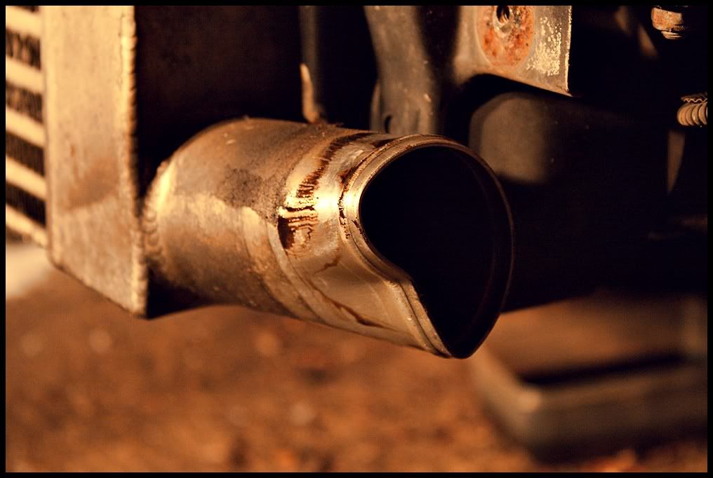

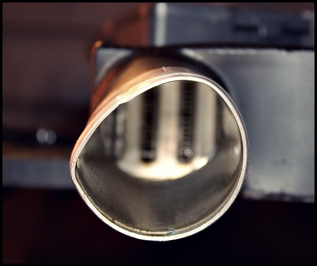

Then I found this. Now the front bumper had a crack in it, but I thought that was the only damage...obviously not, and it was hiding this surprise for me
either tempted to take off the FMIC and get it rolled out, OR get a hammer and see if I can bang it out, but the risk of cracked the weld. I can fit the samco over the bent part, as past this dent the end tank goes back to being round...so does it cause that much of a problem, but being me, this will really bother me

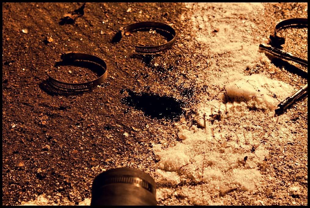

I knew there was oil in the pipes, but there was quite a lot which spilled out. Another key reason why I wanted to pull this all apart to remove the oil

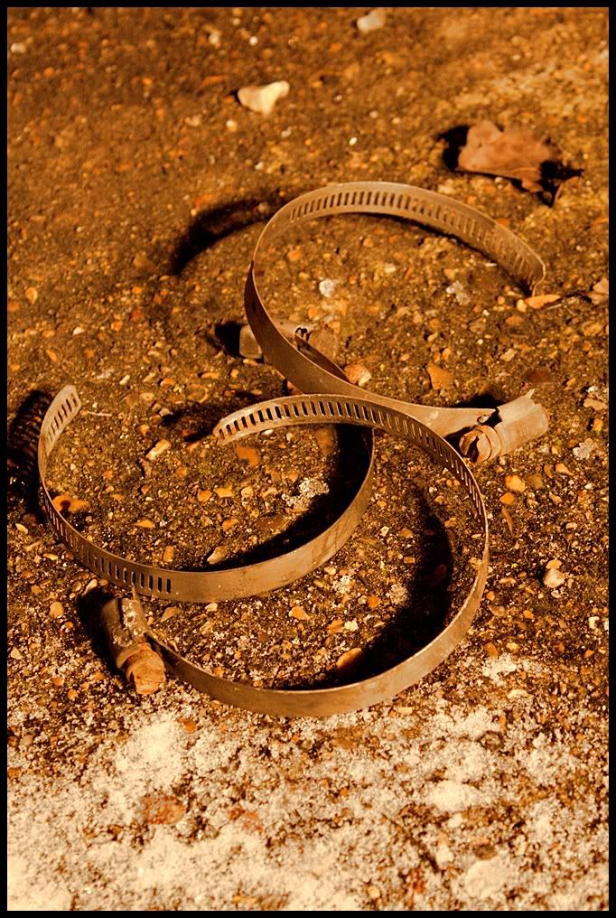

I wanted the bumper off, to be able to replace these with some proper tbolt clamps, as these have seen better days (cheap and nasty also)

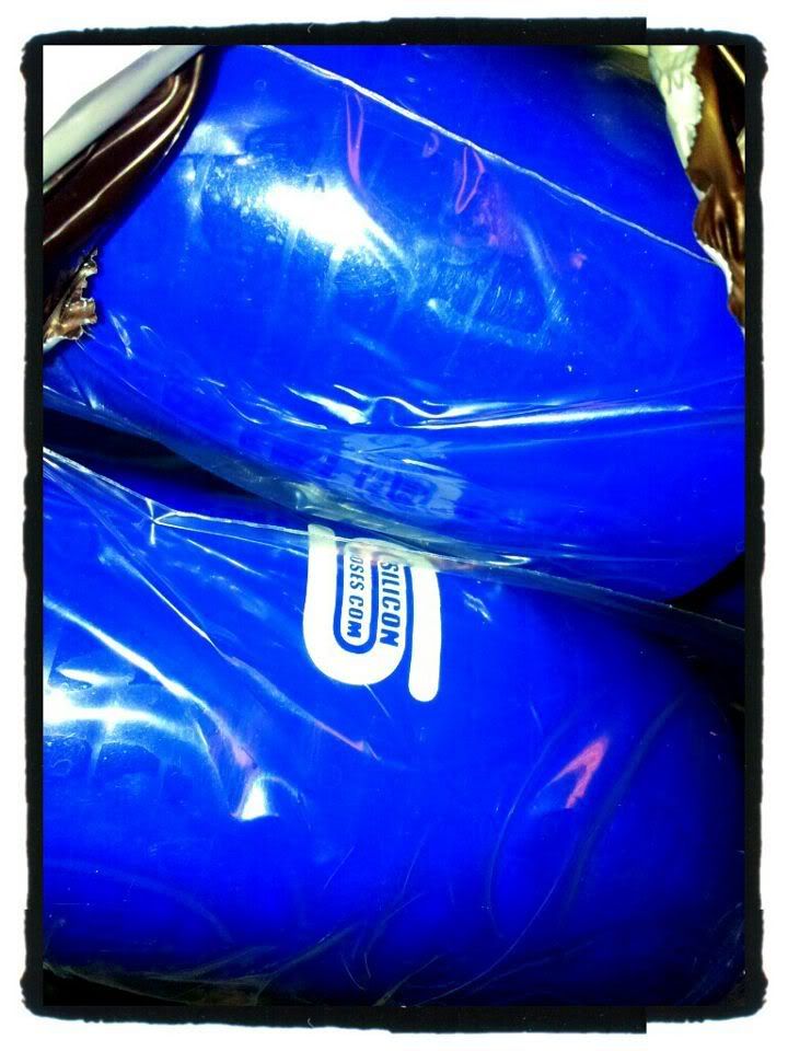

Finally, now these are all off, the other phase is to cut the inside of the bumper back as its rubbing on the pipes. Pro Alloy also fitted some pretty shitty hoses which are very soft, so these will be replaced with some decent blue forge ones

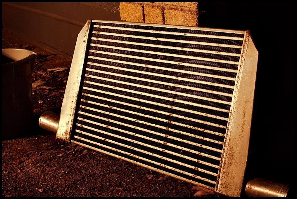

So now with the bumper off, I could separate the FMIC and the crash bar, ready for painting (just awaiting the paint to turn up....hopefully it will be here tomorrow)
FMIC During cleaning
Cleaned...about the best its going to get, but 99% of the dirt was off it, and its going to be sprayed black anyhow with special radiator paint

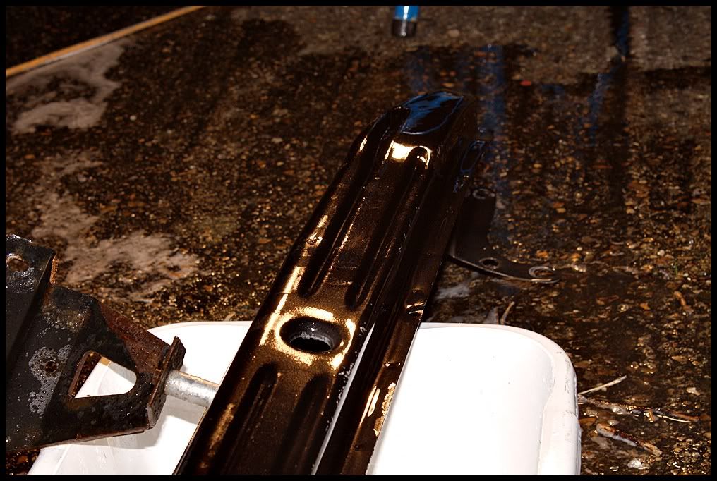

Dirty Crash bar
Clean Crash bar (debating whether to paint or seal this)

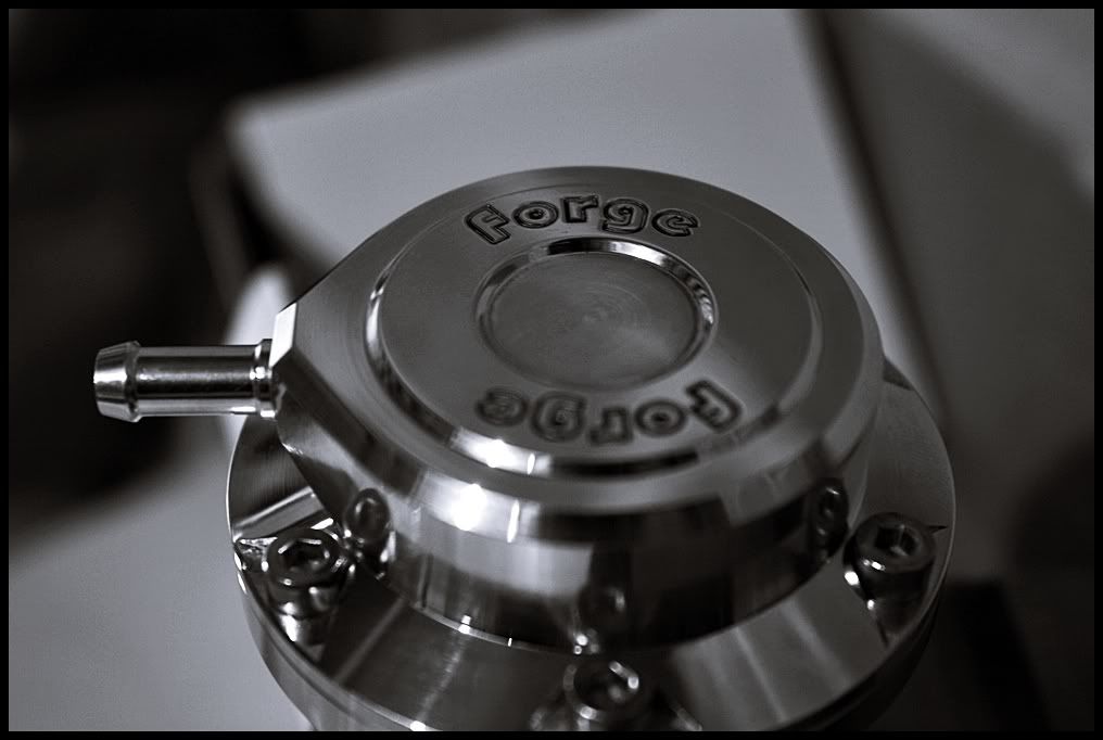

SO.....the paint arrived today, and so did my Forge actuator (despite being told it would take 2 weeks to arrive, it was delivered in a couple of days)

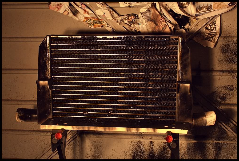

Special radiator paint, which does not clog the fins on the radiator like generic paint, so perfect for the FMIC. Got some more crinkle paint to finish off the mani, battery cover and charge pipe.

Forge Actuator

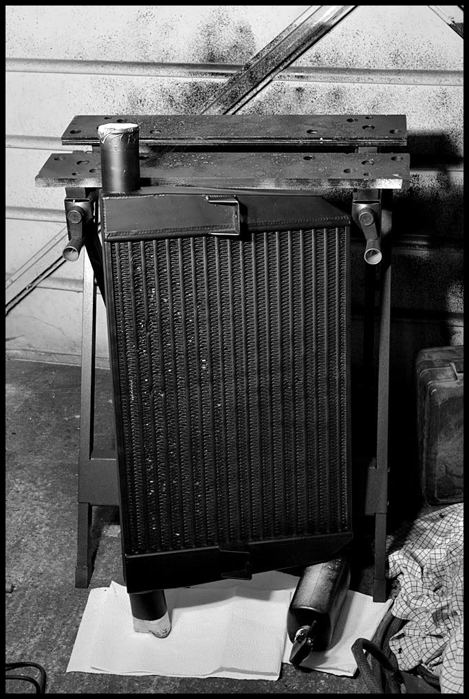

Now for the FMIC
Before
First coat (patchy)

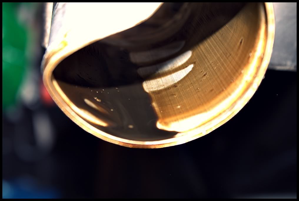

I then noticed a crap load of oil still in the FMIC
So to try and get the last out of it, I have just turned it on its side and left it to drain, hopefully some might come out
Ordered the last parts from Seat today as well, so hopefully now all the parts are sprayed and ready for the engine bay, I can start putting it back together
Looks like it was worth sitting the FMIC on its side to drain it
leaving it to drain some more tonight as well

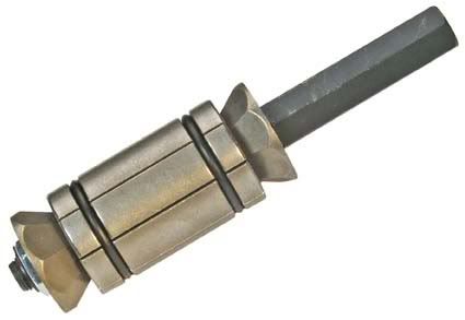

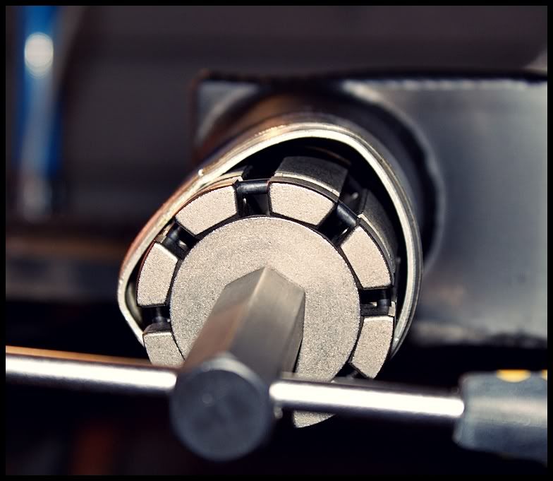

so...to solve this issue
I bought this today - £16 from Germany
Pipe expander 34-64mm
I could have just heated it up and hammered it back out, but I would have never of got a round finish to the end tank, and as this is where a hose is going to be connected, it needs to be in a decent round shape, so the hose grips properly and there are no leaks
so with the pipe shaper arriving, I got round to reforming the FMIC end tank
During
After - The end of it is not perfectly round, but it is a lot more round. You can't see it in the picture, but the centre of the pipe has now been properly reformed, and not at a sharp angle

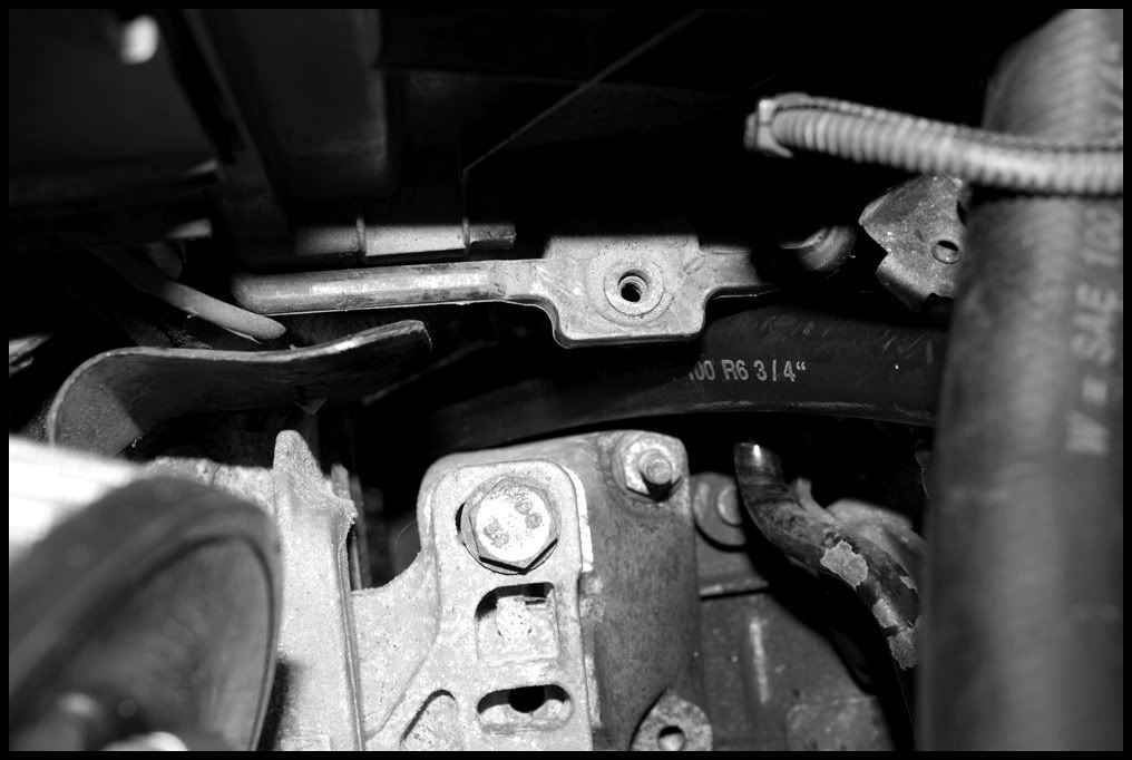

While I was looking to get the oil filter off (which I couldn't do in the end...so thats another thing to do) I noticed this pipe had a massive dent in it, so as well as the previous owner denting the end tank on the FMIC, he managed to do this
Before
After - end is not perfect, but the centre has now been properly reformed as it was almost squashed in half

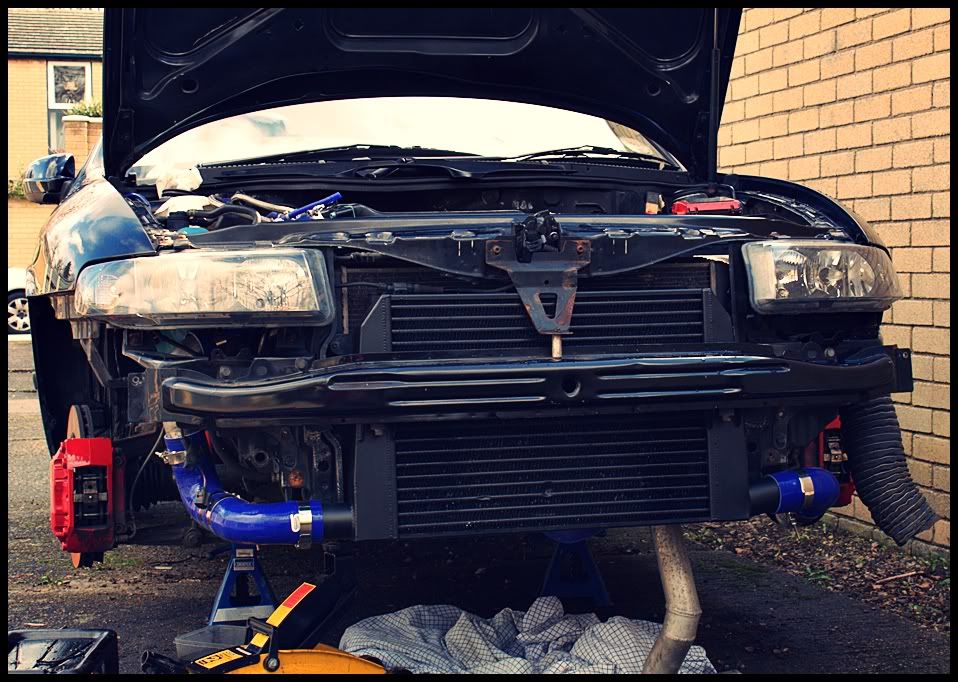

I then got round to mounting the FMIC and crash bar back on
Before:
After:

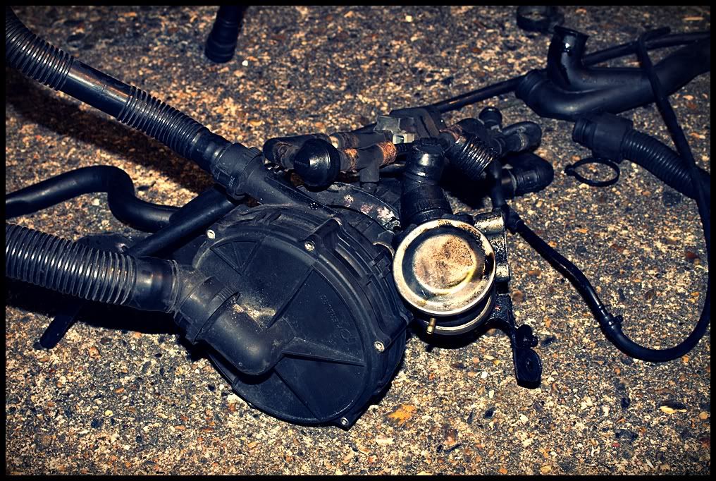

Engine bay junk has now been binned. Engine bay looks so much tidier already with the SAI pump all removed, and the mass of old pipes underneath the manifold have been removed as well (major cause for boost leaks)

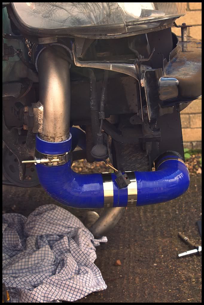

So I thought I would get the FMIC pipework back on, and the bumper. I also got one arch liner back on, but need to get the arch liner clips from Seat to secure the lining
Also got the inlet mani back on the other night (it aint pretty, but its functional and black looking)
Fresh clean pipework

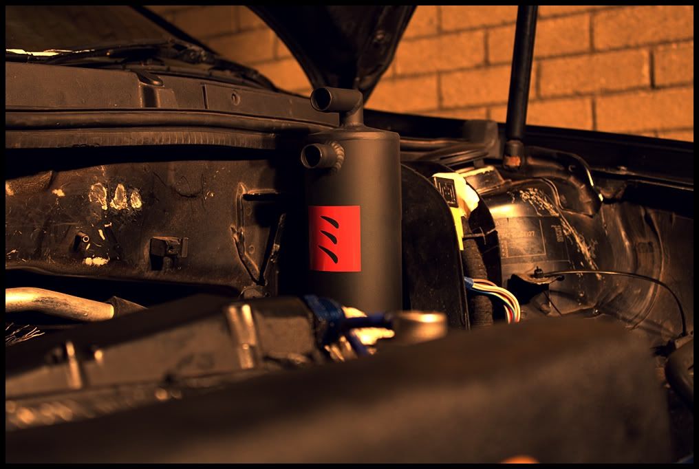

installed the catch can....although then released its sitting too high so I will have to remount this

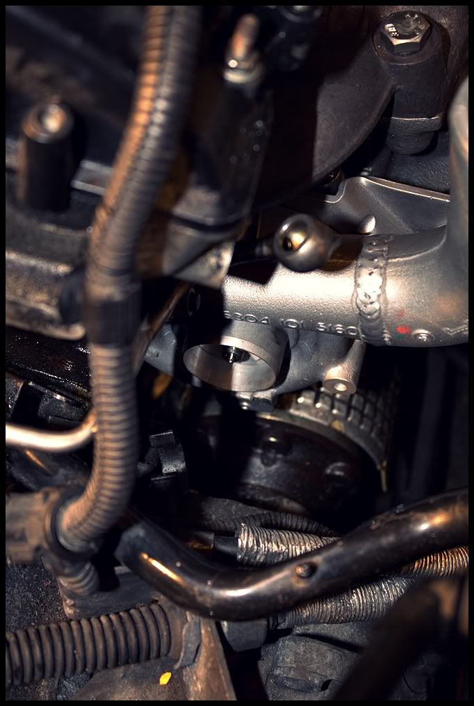

turbo, downpipe, and TIP are now all properly screwed in. Not far to go now

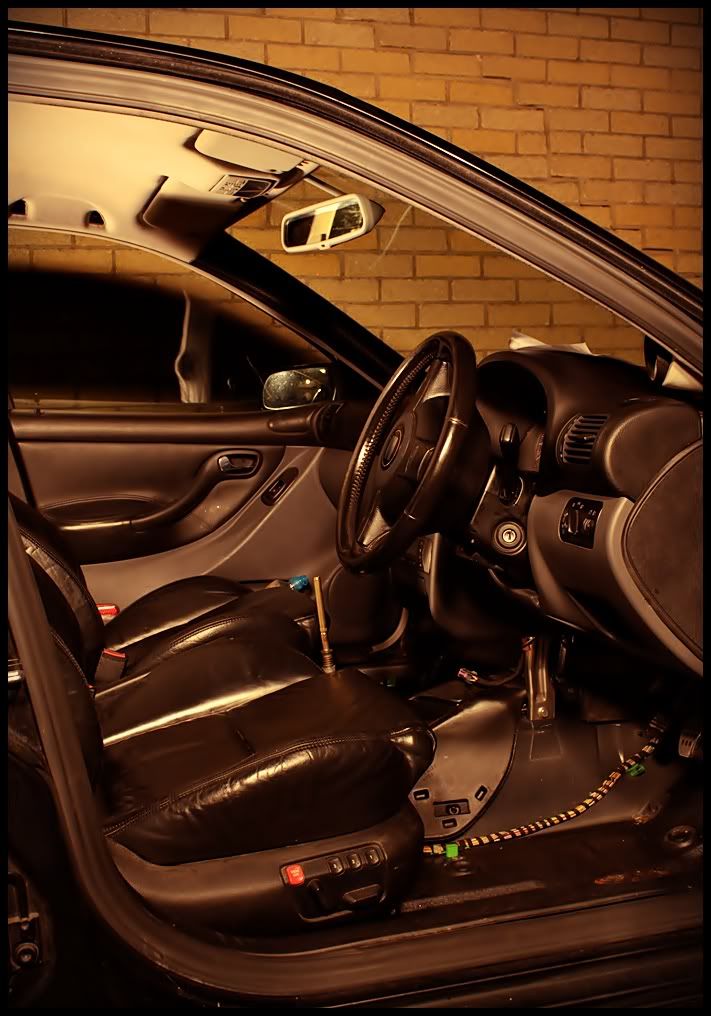

so got round to cleaning the interior tonight and cleaning off all the mould!
Used autoglym interior cleaner, really good stuff
Then took out the plastic centre that surrounded the handbrake. Unfortunately my knob was so mouldy I had to pull it off
Front seats back in finally
The front looking a lot cleaner

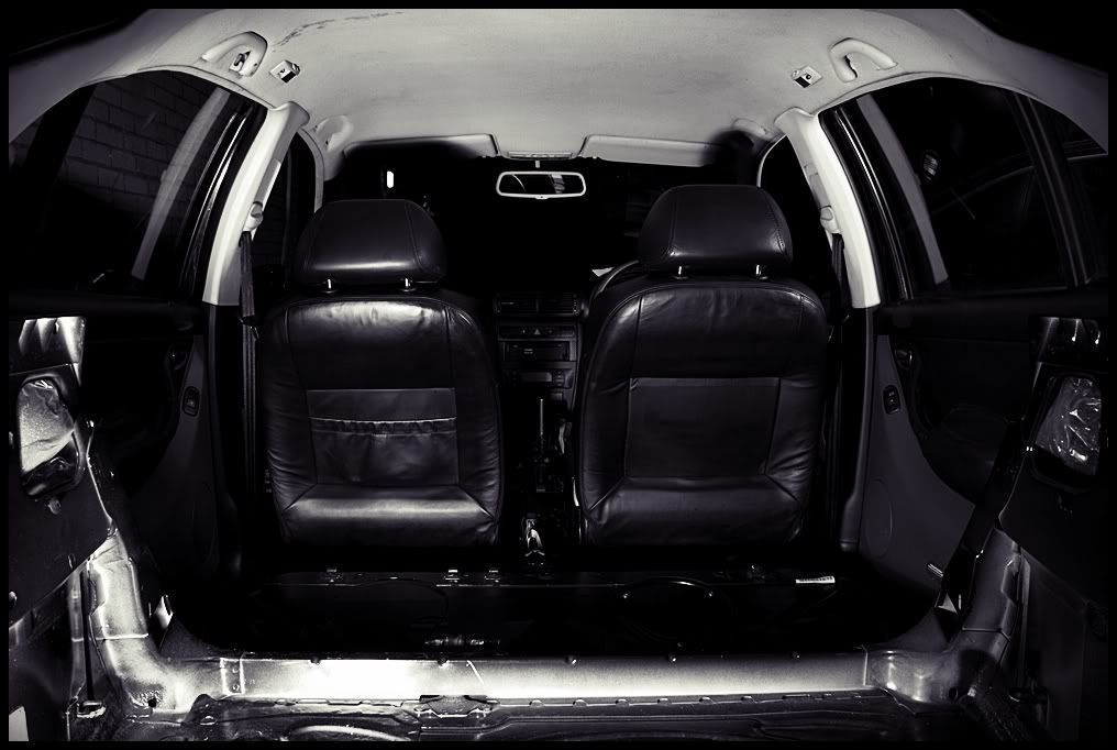

Got round to ripping the final bits out of the back, the plastic lining near the rear pillars, plastic covering around the boot, and removed the rear door cards and speakers

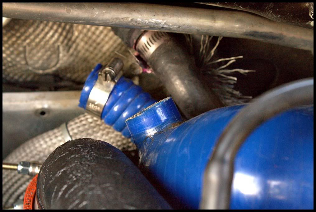

The DV is too tight and sits right up against the metal pipe, and it is also kinking the silicon hose onto it, so I am going to run a 45 degree metal joiner and move the DV away from the TIP, so the silicon is not kinked
Split OEM pipe has finally had its day, but it got me through the MOT (probably explain why the engine management light came on)

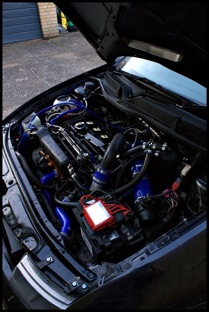

and finally the money shot
so, finally finished off the catch can tonight. I orginally ordered an AN12 finisher, but it was a straight one and I then realised because of the stiff piping, it was kinking which was my fault and I didn't think about this
so I then had to buy another AN12 connector but with a 45 degree bend, fitted nice and tight
The catch can is venting to air, and I found a perfect place to lay the pipe which sits between the engine mount and the battery block

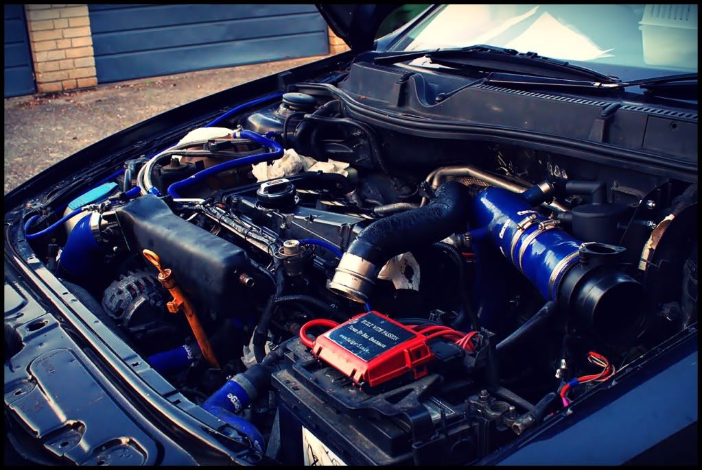

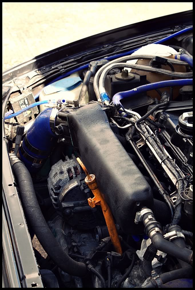

I bought some engine bay cleaner earlier today and gave the engine a quick once over. Lots to do still and things to tidy up but this is how it stands at the moment

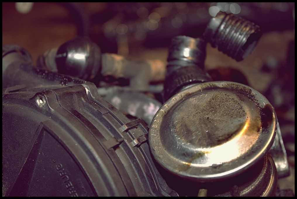

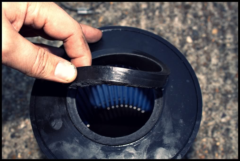

While cleaning, I then found this...
fecking wank filter. Got to contact them now, as filters can take a while to arrive I find, and its not far off the 8th June. Worst case scenario I have a crap filter that came on the car when I bought it back
Think I will just fork out the money and buy a green or proper Jetex filter off Bill
