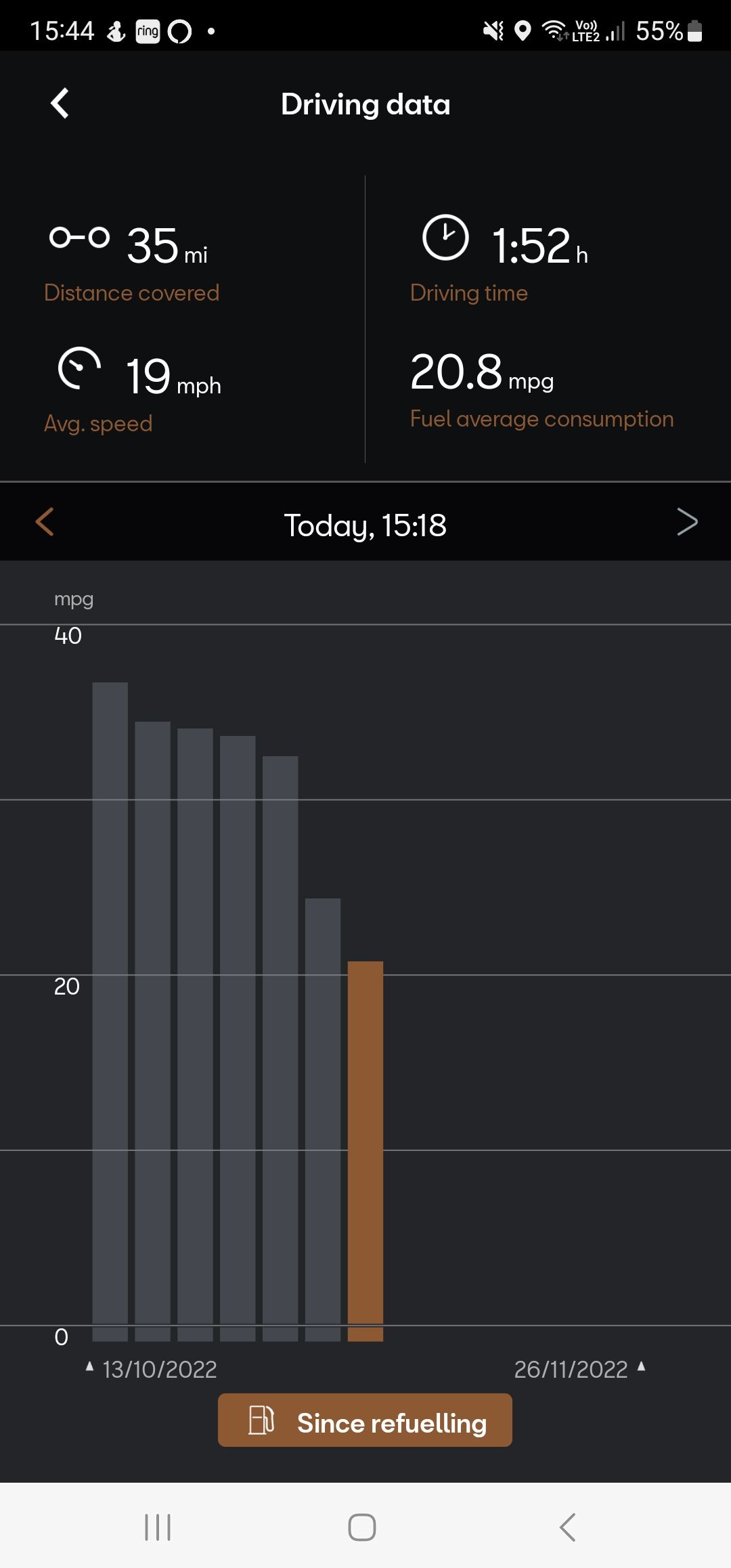

Has anyone had an issue with sudden rise in fuel consumption? Happened after I filled up this week, with range on full tank dropping from 455miles to 355 and then 280 after I tried to clear the issue by filling again, but seems to make it eorde
Car is MY22 Formentor V2 190, 15000miles and is otherwise driving fine. My driving style hasn't changed.
Screen shot shows my average mpg for each refuel..the last 2 stand out somewhat!!
I am presuming a problem with sender unit?

Thanks for the responses. Would my car even have a particulate filter though ( being petrol). It happened instantly after refuelling and did 2 journeys that day of 70miles (90minutes) so that would have been enoigh time if that was the case (according to my experience of previous diesel car)
I agree re colder weather but a drop from 35mpg to sub 25mpg seems VERY extreme
Just to add further. The car is driving fine with no obviois difference in feel/sound. When I filled up to see if it would correct things it said I had mpg of around 24 but the amount it took to fiill worked out to 30mpg (still worse than usual but j)had been stuck in traffic for ages)

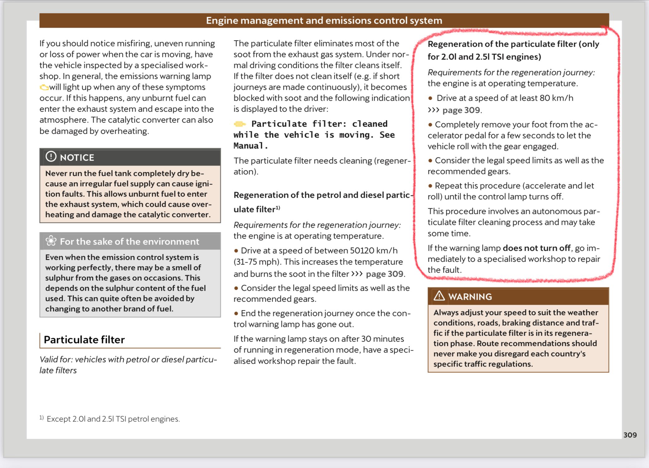

All sorted!!!! Thanks to SRGTD and others for pointing me in the right direction. I filled up this morning again and my MPG was still low 20s but then a 2hour blast down the M62 with some foot off the pedal episodes has given me a very respectable 39mpg for the journey. I looked up the 'issue' in the Formentor manual where it details exactly this process.
In hindsight, perhaps my driving style to work and back (20minutes mostly at 30mph) and with mrs in car (constantly reminding me what the speed limit is and having a fit if feels ANY acceleration) doesn't really allow me to get the car warmed up enough to burn off.

I periodically do the ‘foot off the pedal episodes’ in my car when the engine’s fully up to temperature. From discussions on one of the VW forums it was said that as the car decelerates with the foot off the pedal, excess oxygen is drawn in via the exhaust which helps aid the process of burning off the soot in the GPF.

So this IS ACTUALLY a thing it seems, certainly something to bear in mind??
You've lost me now. Foot off the pedal process in the manual?
Where in the manual will I find it, had a look and cant seem to see it.

It’s under ‘Particulate Filter’ in the owner’s manual - page 309 in the June 2022 edition. If yours is a different print date, the particulate filter section might be on a different page, so check the index at the back of the manual for the page number.
