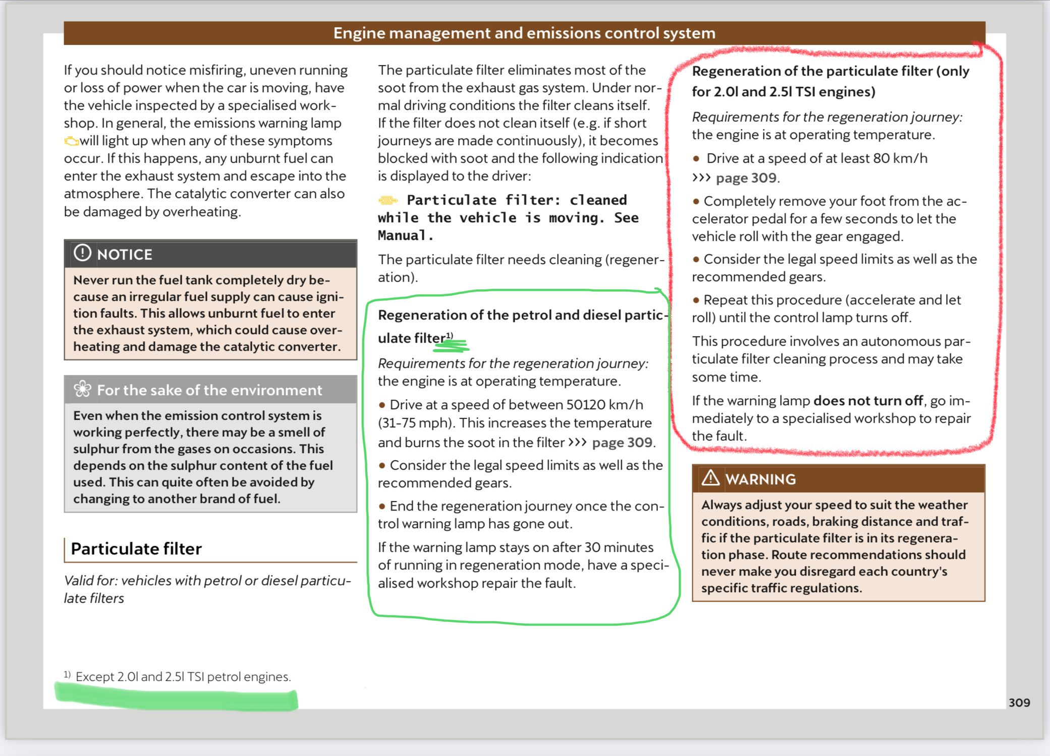

Glad you posted this, being on a "Poverty entry" 1.5 I'm guessing this is nothing for me to bother about😆👍
The process circled in red on the screen shot above is for 2.0 and 2.5 litre TSI petrol engines. There’s a different process for other engines - circled in green on the screen shot below;
Reactions: Doogle

It’s under ‘Particulate Filter’ in the owner’s manual - page 309 in the June 2022 edition. If yours is a different print date, the particulate filter section might be on a different page, so check the index at the back of the manual for the page number.
Thanks I really never knew petrol engined cars have particulate filters!!
Page 326 on my manual. Mines a 1.5 so the foot off pedal bit not applying to me only the regular drive at steady speed routine if ever needed.
