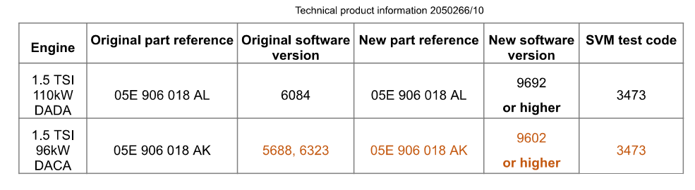

Anyway, I paid for an hour access to Erwin this morning and came across the Technical Service Bulletin section. There is a Service Bulletin with a release date of 11/10/19 called:
2470: Jerking while warming up when accelerating/releasing accelerator (only 1st to 3rd gears - EA211evo 1.5 l TSI)
This is obviously the well documented claim of kangerooing / jerking / hesitation etc
It states the 150 bhp Leon 5F engine 1.5 TSI 110kW DADA has a new software version available to the dealers in response to this issue:
Original part reference: 05E 906 018 AL
Original software version: 6084
New part reference: 05E 906 018 AL
New software version: 9692 or higher
Those with the 130 bhp Leon 5F 1.5 TSI 96kW DACA (like me) will have to wait as the status shows "in preparation phase".
Anyone had this update done or been contacted by a dealer? Personally I can feel hesitation while the engine is cold and it is amplified when the ACT activates until the engine gets warm.

Got a Seat Leon 1.5 TSI that I bought a few weeks ago and it seems ok for kangarooing, drives a lot better than my VW T-Roc that had the same engine and bad kangarooing. Booked my T-Roc in for a software update last week, wife says she hasn't noticed kangarooing since the update and when I was driving it home from the garage it felt a lot smoother, and better acceleration, through all the gears (more like my Leon that doesn't have the issue). So initial thoughts are that a software update is helping
That is good news and it would have been interesting maybe for others to know what the initial version of S/W was and what it is now - something you would need VCDS or OBDeleven to check.
Sorry don't have access to any of that so can't confirm. I would also assume the software update across the VW group should be the same (as it is the same engine?). I also noticed the engineer comments on the worksheet I was handed back said they had replicated the issue and it was "incorrect software installed" and the correct software installed as a resolution. Might be nothing, but I found the use of the word "incorrect" to be a bit unusual, rather than saying it was outdated or something like that.
There is a list somewhere with "current" update version against engine codes and what was loaded into that engine codes ECU at maybe certain build dates - some of that might not be too accurate, but that is roughly what has been presented in these forums.
The S/W will not be static for too many reasons some insignificant, some significant, this will always be a "changing thing" and so the updates need to reflect that - and yes typically all marques will use the same versions of S/W and the point that engines were placed in the market place will dictate which marque started with which version initially.
Edit:- the improvement is what counts as some people in some forums have been reporting things being made worse by a S/W update that VW Group were not interested in reversing - that is for these 1.5TSI engines - and that will always remain a worry for those suffering this rough running/drivability.
Both 9602 and 9692 have not solved the juddering. It's a farce as so many people have waited a long time for them to be released.
