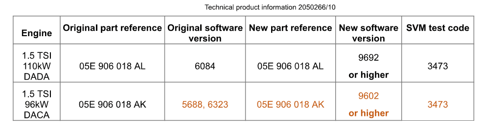

Both 9602 and 9692 have not solved the juddering. It's a farce as so many people have waited a long time for them to be released.
MrsMaypacks 1.5 TSI EVO 150hp FR Black Edition has an Engine Code of DPCA and is showing Software Version 9596 against the Engine Control Module when scanned with OBDeleven.
This differs from the info shown above.
Does anyone know the difference in the Engine Codes?
I'm certain that the newer 1.5 150bhp DPCA is not an affected engine. It seems to be the DACA and DADA versions.
If the newer engine is not affected, what is the difference between it and the older engines that stops the issue occurring?
That's a good question. I've been searching Google but not found a definite answer. I only found out there was a new version of the engine last week.

My 130 I picked up at weekend is a DPBA (not lifted the bonnet since i got it to check that corresponds to what's stamped on the engine) on the V5. Haven't felt anything since i collected it, theres a piece of paper in the glovebox in Spanish dated 9.1.20, maybe a build date or QC date? But I know my car landed in grimsby somewhere around the 24th Jan. So not sure when they started shipping this motor....
Hmm so both 130 and 150 varients swapped out for newer engines within the year, this paints a clear picture i would say
Shame they will never be honest with the customers and deny all knowledge
Absolutely. There is very little chance that an admission would be made that would risk a complete recall of so many vehicles and a reputation disaster. So what they have done is start discreetly rolling out a modified engine. I wouldn't know where to start to try and work out what has changed exactly. I will chuck another tenner at SEAT tomorrow morning and access Erwin to see if there are any updated docs for the 1.5 TSI engine. I can't see it being anything obvious though and certainly no documents will be released on the public facing side of Erwin that could cause VWAG some headaches.

A quick Google shows a forum post (I've not verified the information) where the changeover for vw was probably over summer shutdown as the engine appears to have entered use in July 19....so when did Seat start shipping cars with it?
