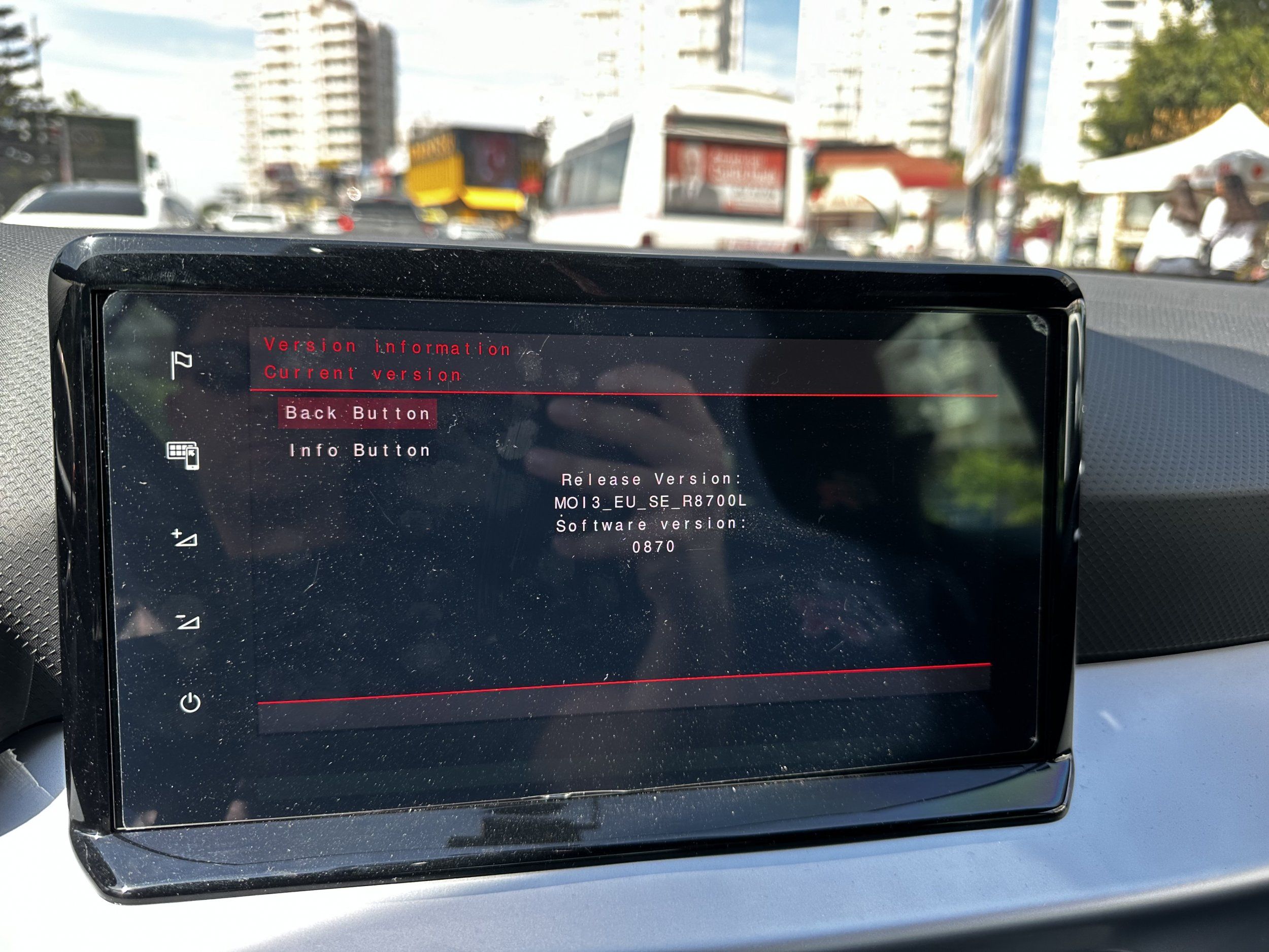

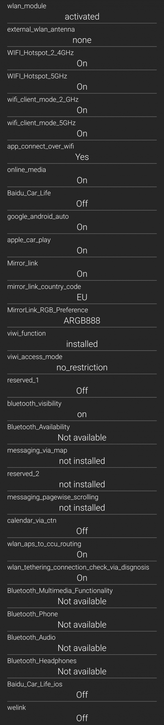

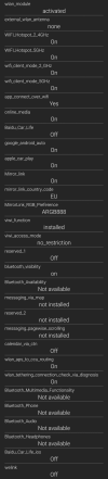

Hallo. I have a 2024 Seat Arona and mib3 unit. Making the encodings required for wireless Carplay activation with obd11 pro, but it warns that 'the connection could not be established'. Where am I making a mistake? Can you help with wireless carplay?

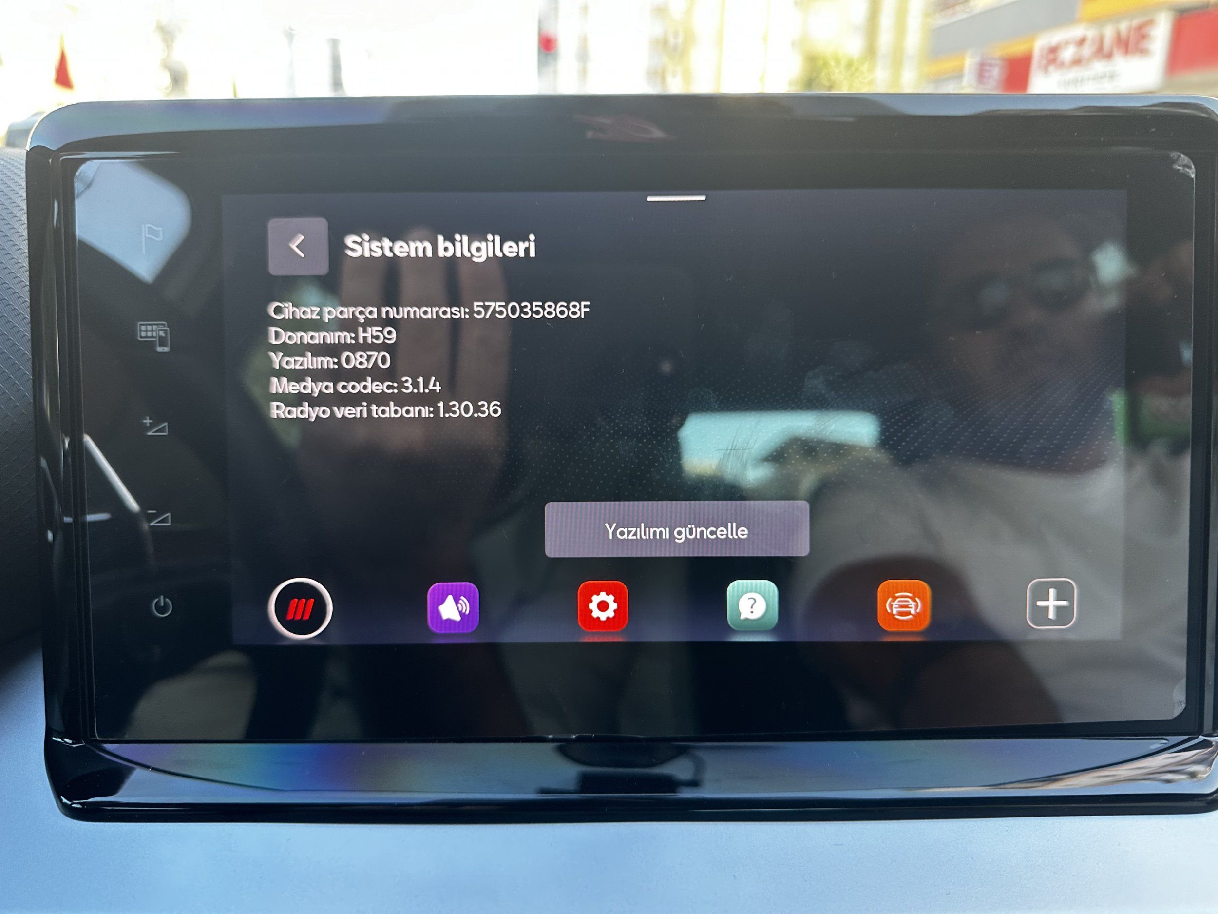

Did you do a reboot of the unit ?. Yours is an H59. The original poster said H57 and H58. They might have altered what you can do now. Any H59 people out there ?.
Yes of course I restarted it many times with many changes.
Is there no wifi in the H59 unit? Or is there a missing swap code?

I don't have swap codes 00040100 & 00071c00.
What is the meaning of these missing codes? Can I register these swap codes with Obd11? Or can I do it with odis-e?
You won't be able to do it with obd11. The swap / FeC codes are how Vag protects it's income. It's like buying a 4k TV but they disable 4k and you pay the difference between HD and 4k to get it turned on if you need it. Its under software control.

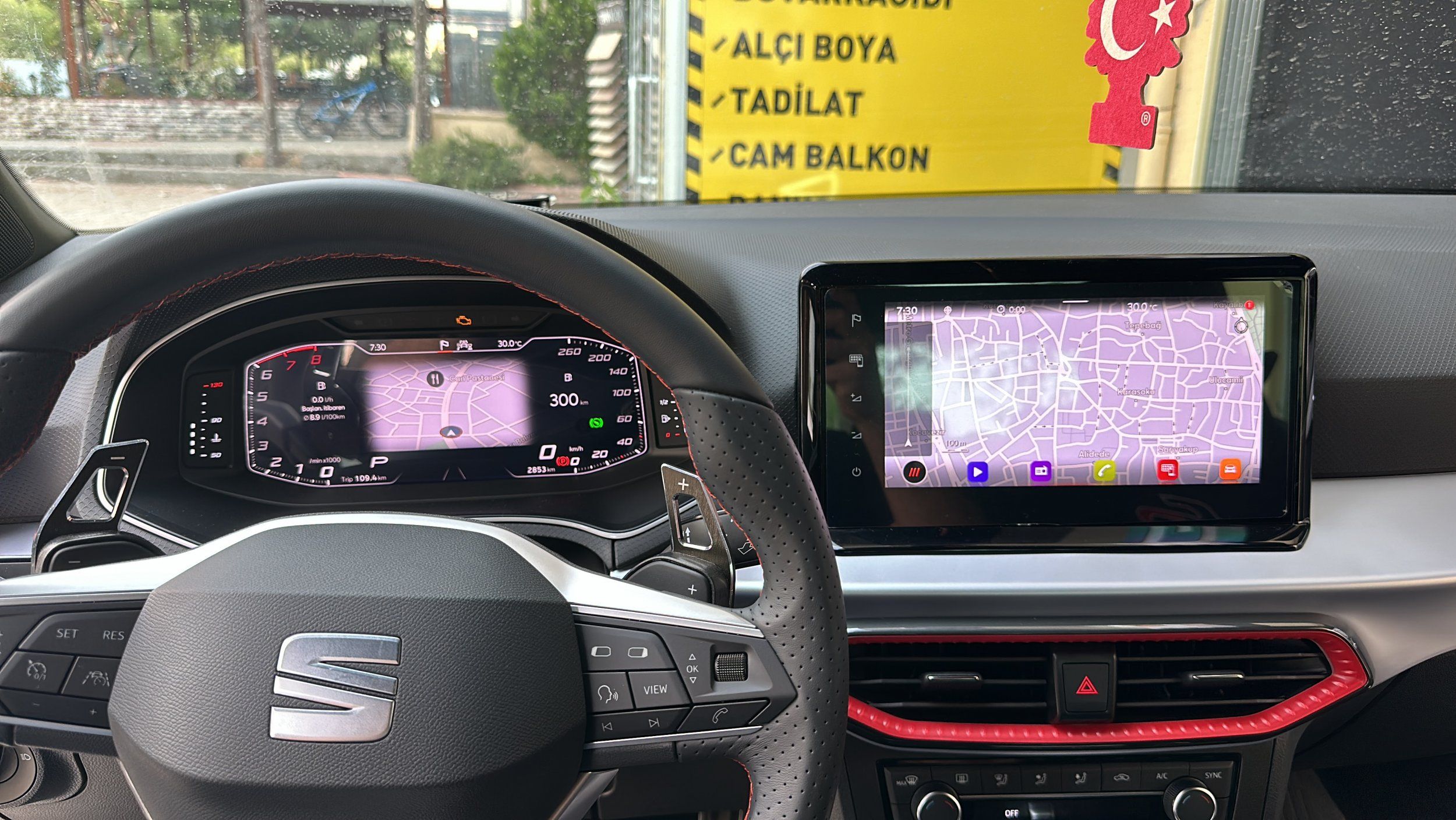

We hacked the unit and solved the problem. Both the wifi was active and we activated the original navigation.
