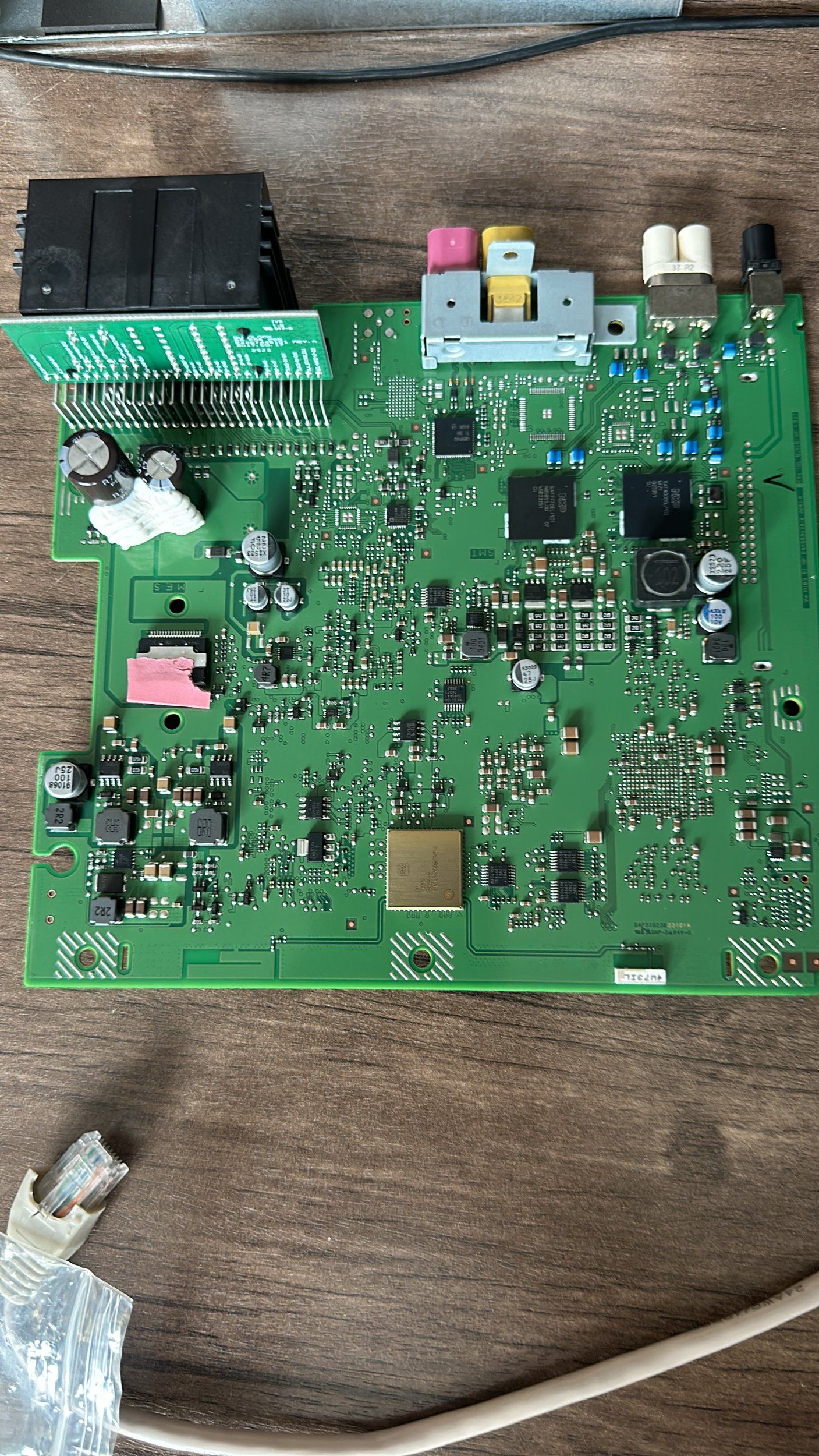

It is necessary to open the inside of the device and make an electronic operation. A new rom is flashing. However, the original navigation and wireless fulllink feature come.

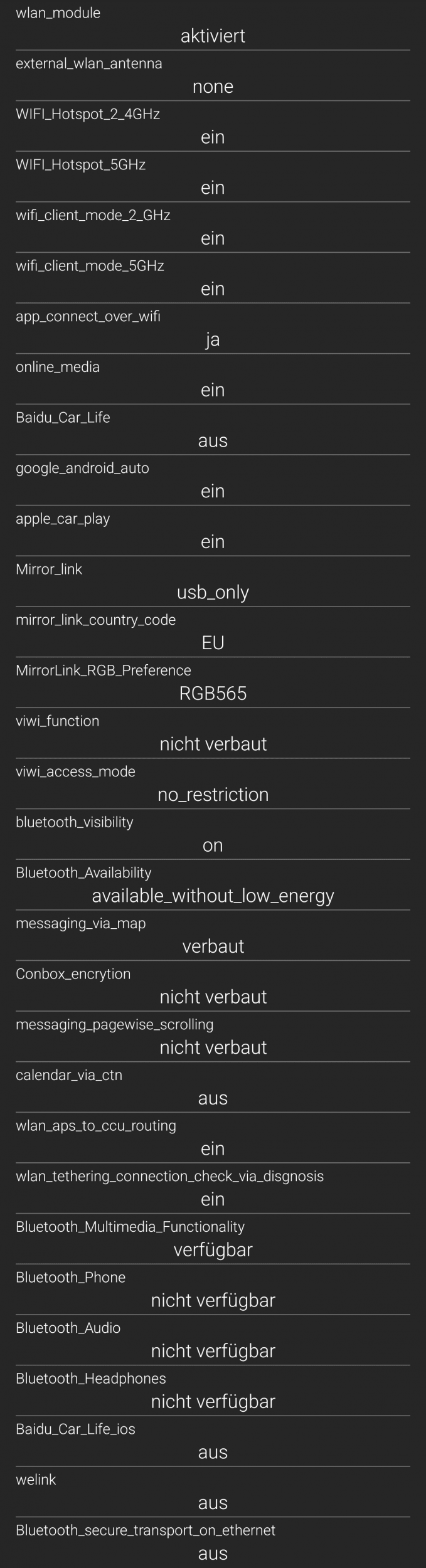

the important settings
Reactions: Tell
Could be the one where @East Yorkshire Retrofits said carefull with this. It may not always work. Vag closing down things which were free. I seem to recall it was a curiosity of early Seat / Cupras. Where they say it's now a SWaP/Fecs code.
i think it's not a swap , as some guys already activated , but there is one clue i am missing , Note: i don't have NaV
This one I'm thinking of
Reactions: Tell
