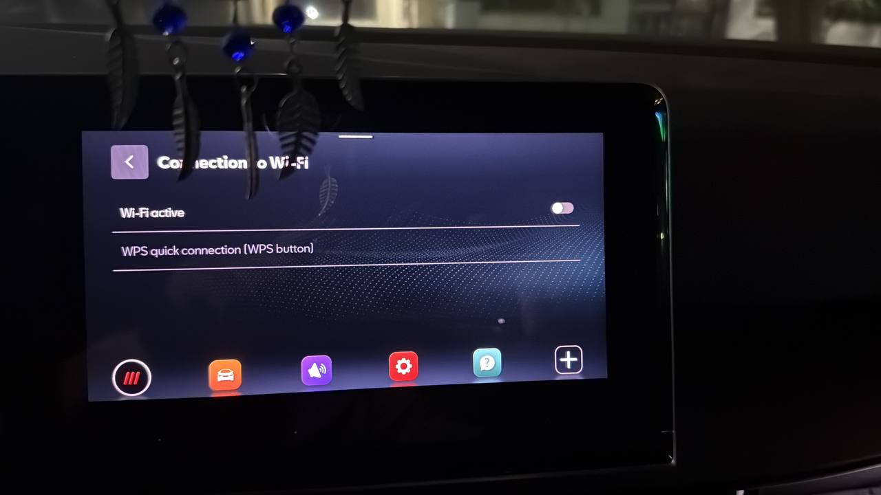

also Wifi is always disabled, once click, it return to disable again
I would try loading the factory settings
did a factory reset & soft reboot but still Wifi / hotspot greyed

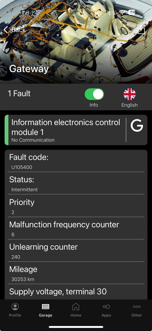

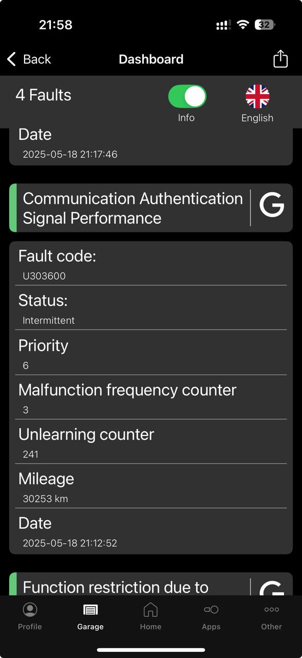

also worth mention that 2 errors received in dashboard / gateway

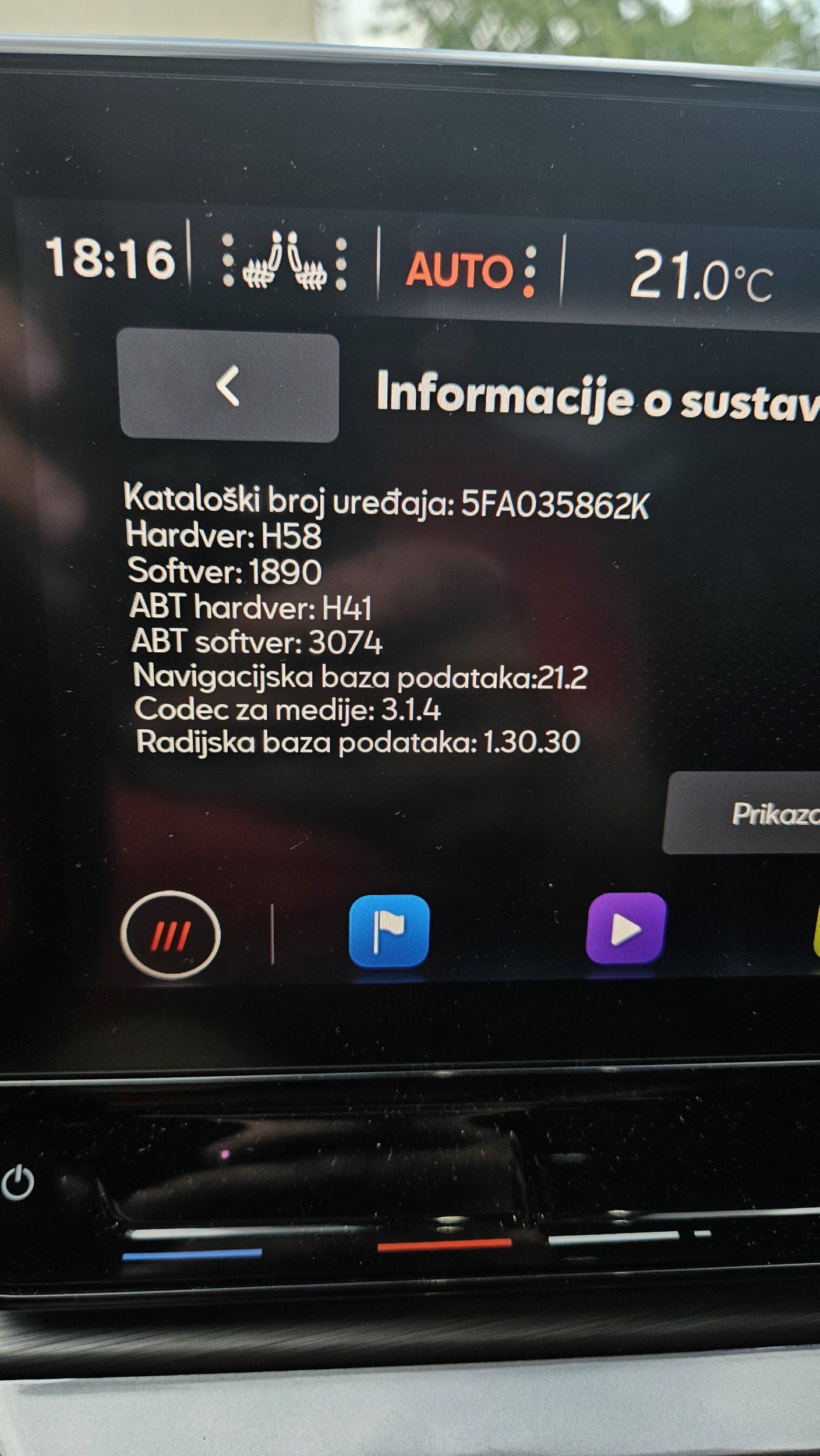

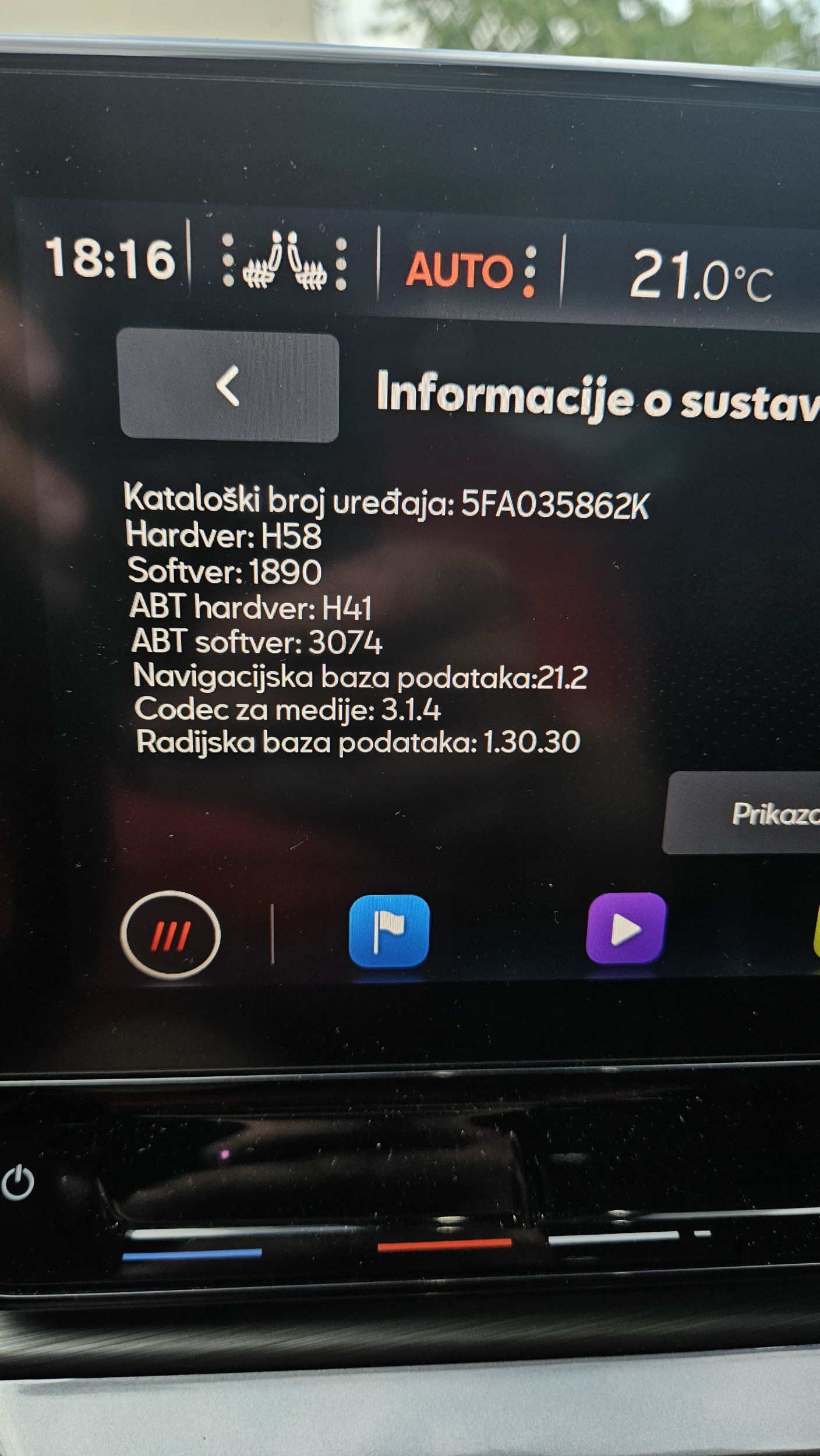

Software configuration changes required, I won't repeat them as it's all mentioned in this thread. If it isn't working then it likely isn't configured properly as your car does support it
The thread only applied to H56 and H57 units. Yours is H58. Any changing of the units licences can only be done with Vag equipment via a licence as mentioned on the thread. You need to find a retrofitter using fully licenced Vag equipment. Dealers are unlikely to touch it since it's outside their remit. Your VIN number would be used to identify which unit you actually have installed but the picture does reveal. Unofficial hacking of MIB units stopped with the introduction of mib3 then tightened up.
