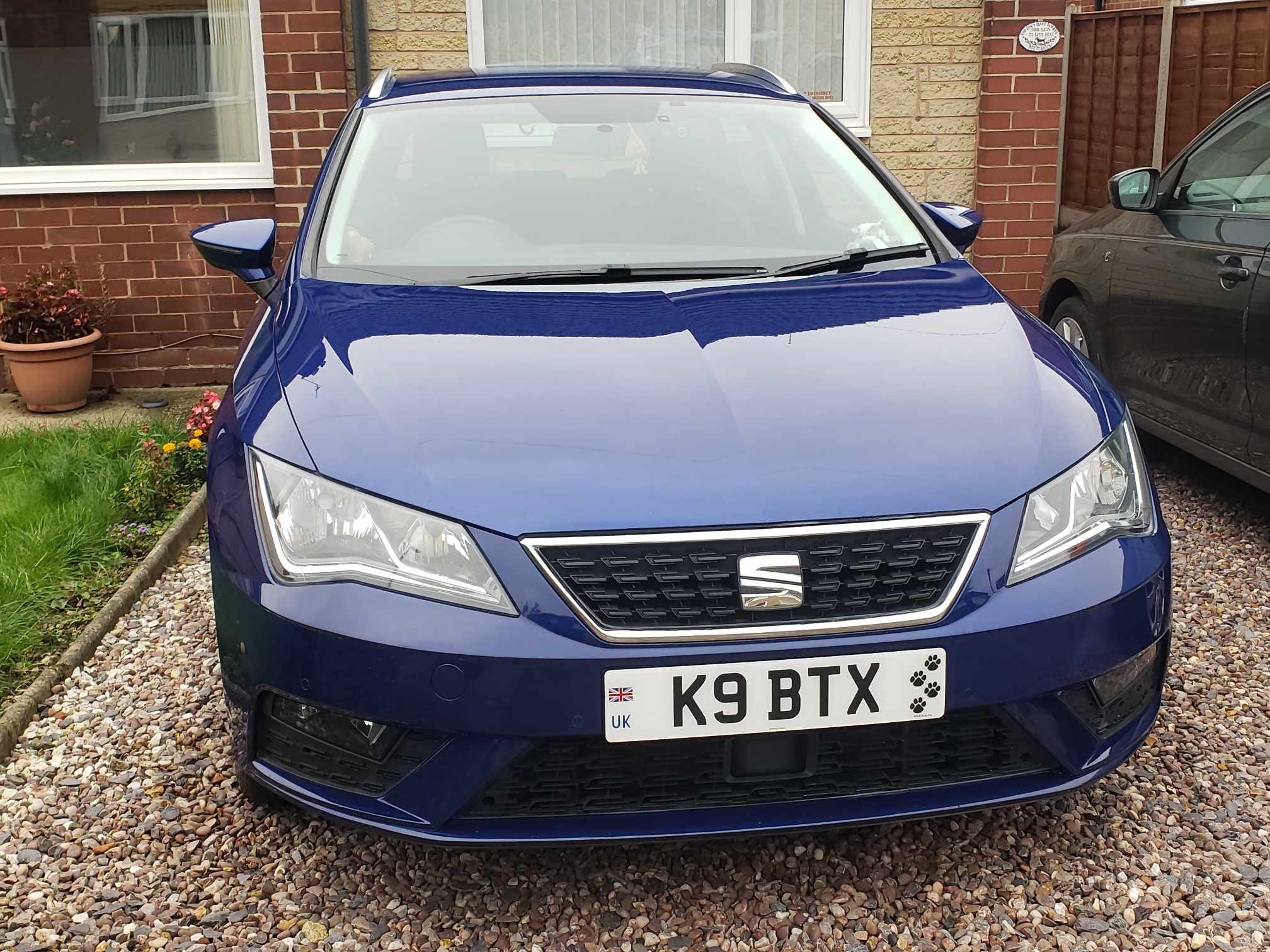

Granted, the LEDs are a lovely crisp pure white, but light output is disappointing, especially on the pre-facelift models up to 2017ish. The halogens are more yellow by nature, but as said, I've had both LEDs and halogens, and the light output on the halogens is much better, especially if you change the standard bulbs to the upgraded Philips ones available. I tried pure white LED bulbs, but took them out almost immediately as they were absolutely atrocious compared to standard bulbs... as well as a very poor light spread, there was no beam pattern whatsoever with them. Photos below of the earlier white 64 plate with LEDs, and my current blue 19 plate with halogens
